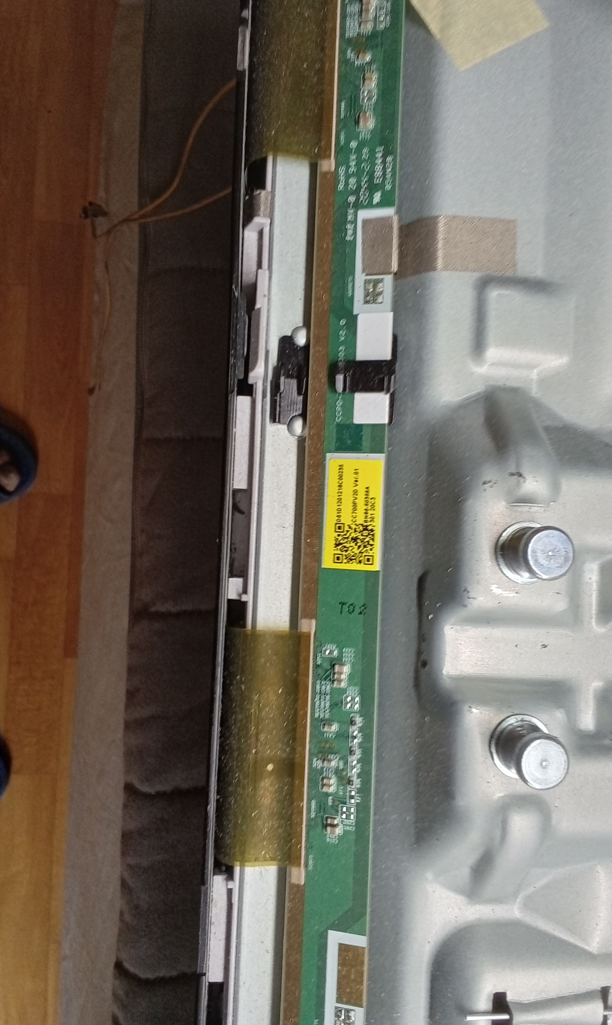

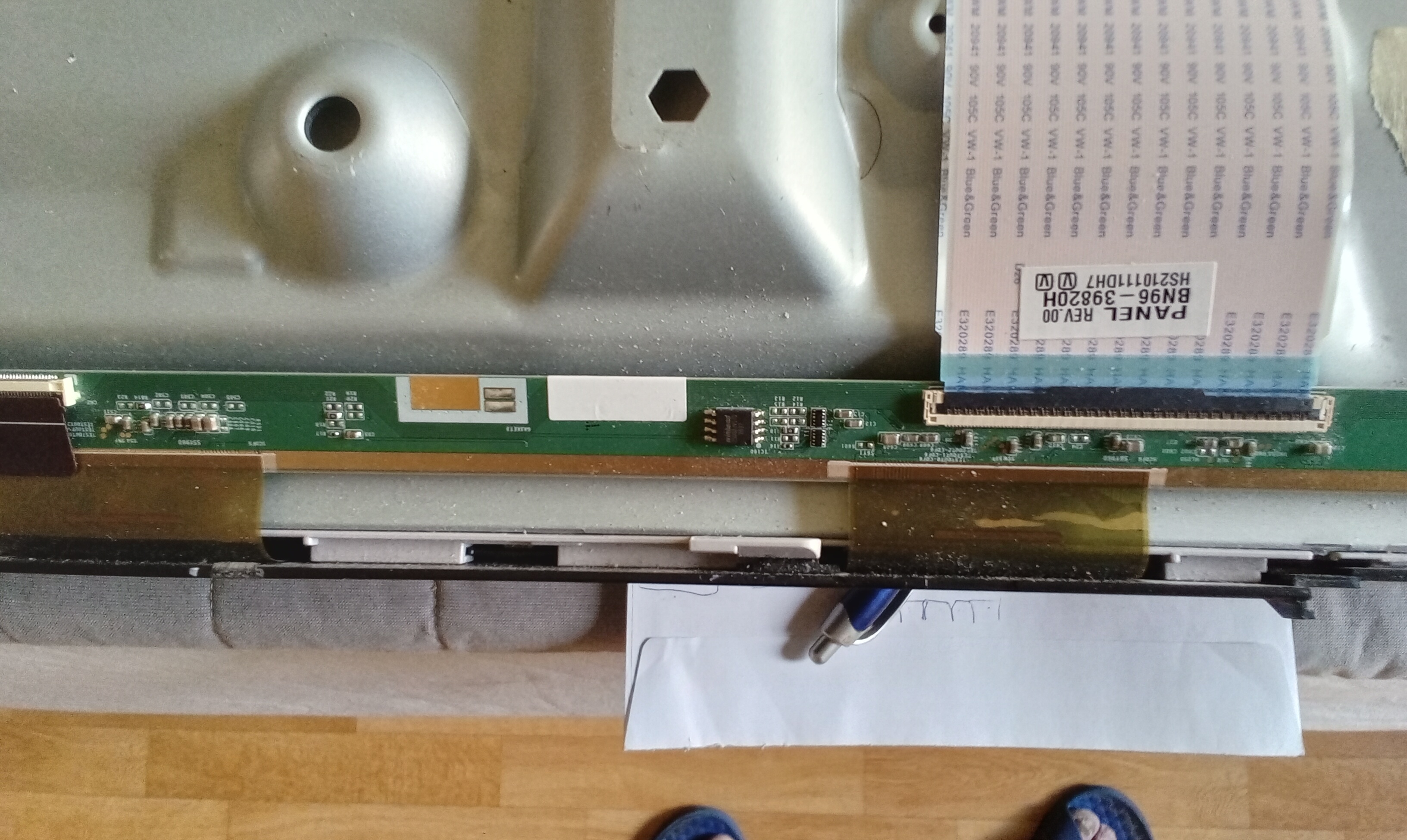

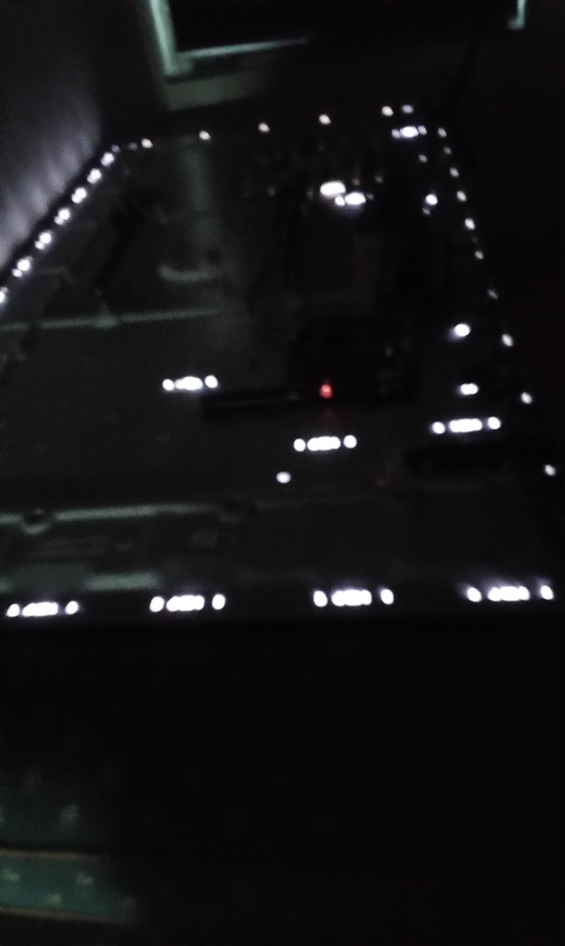

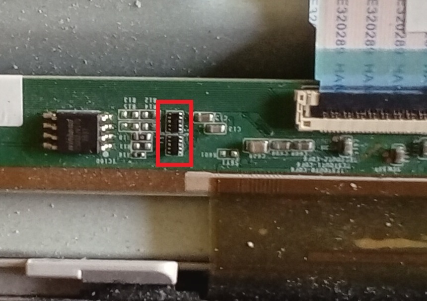

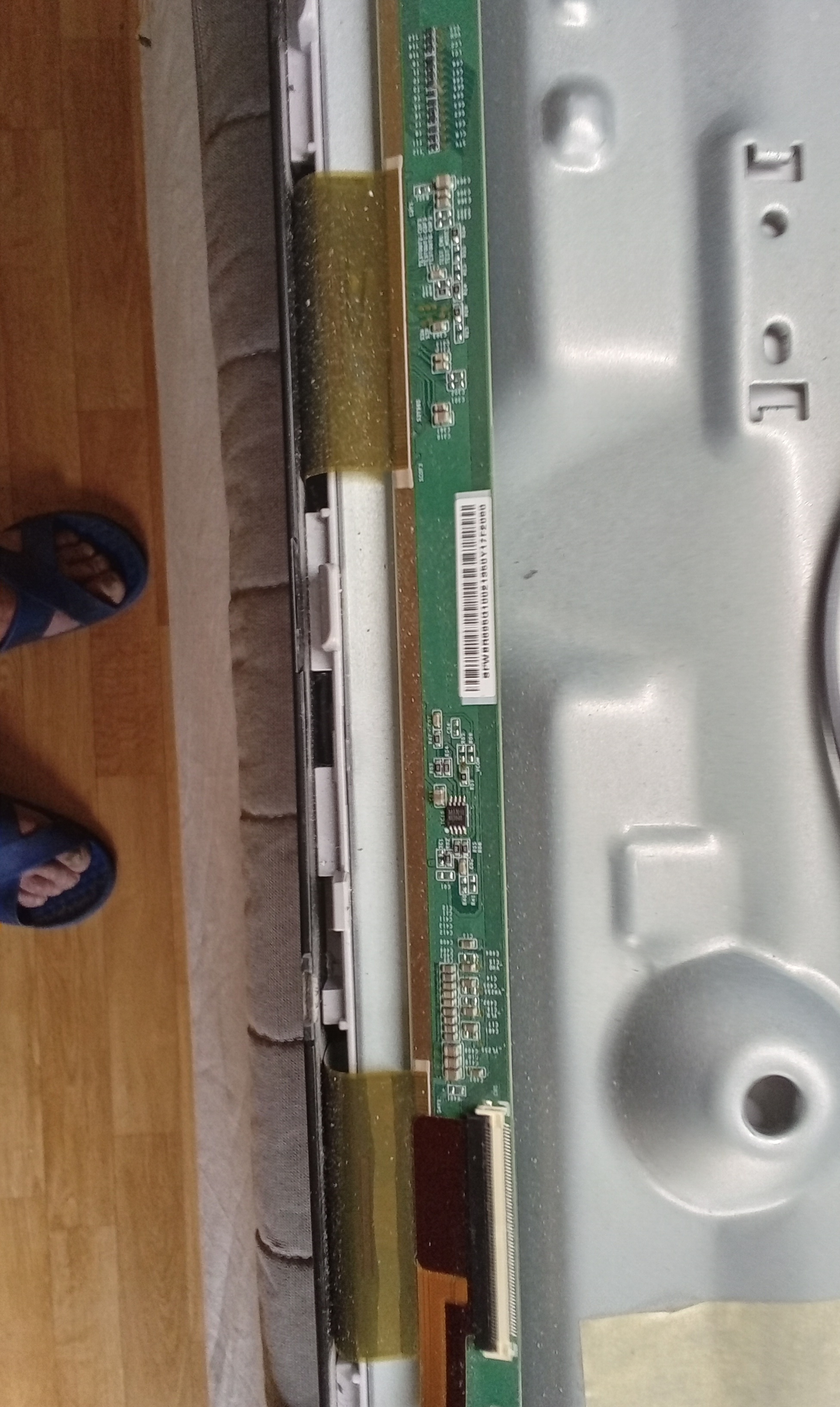

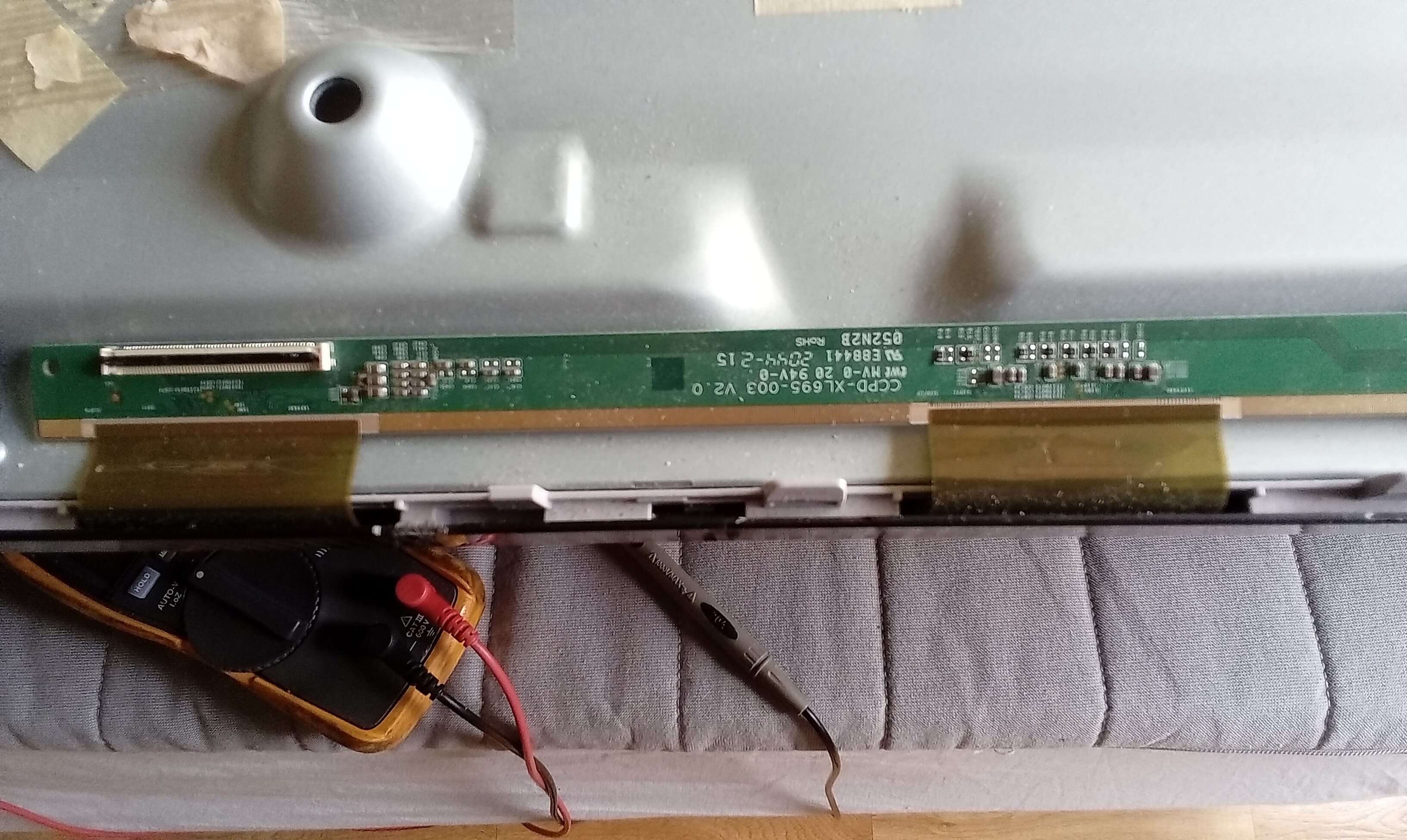

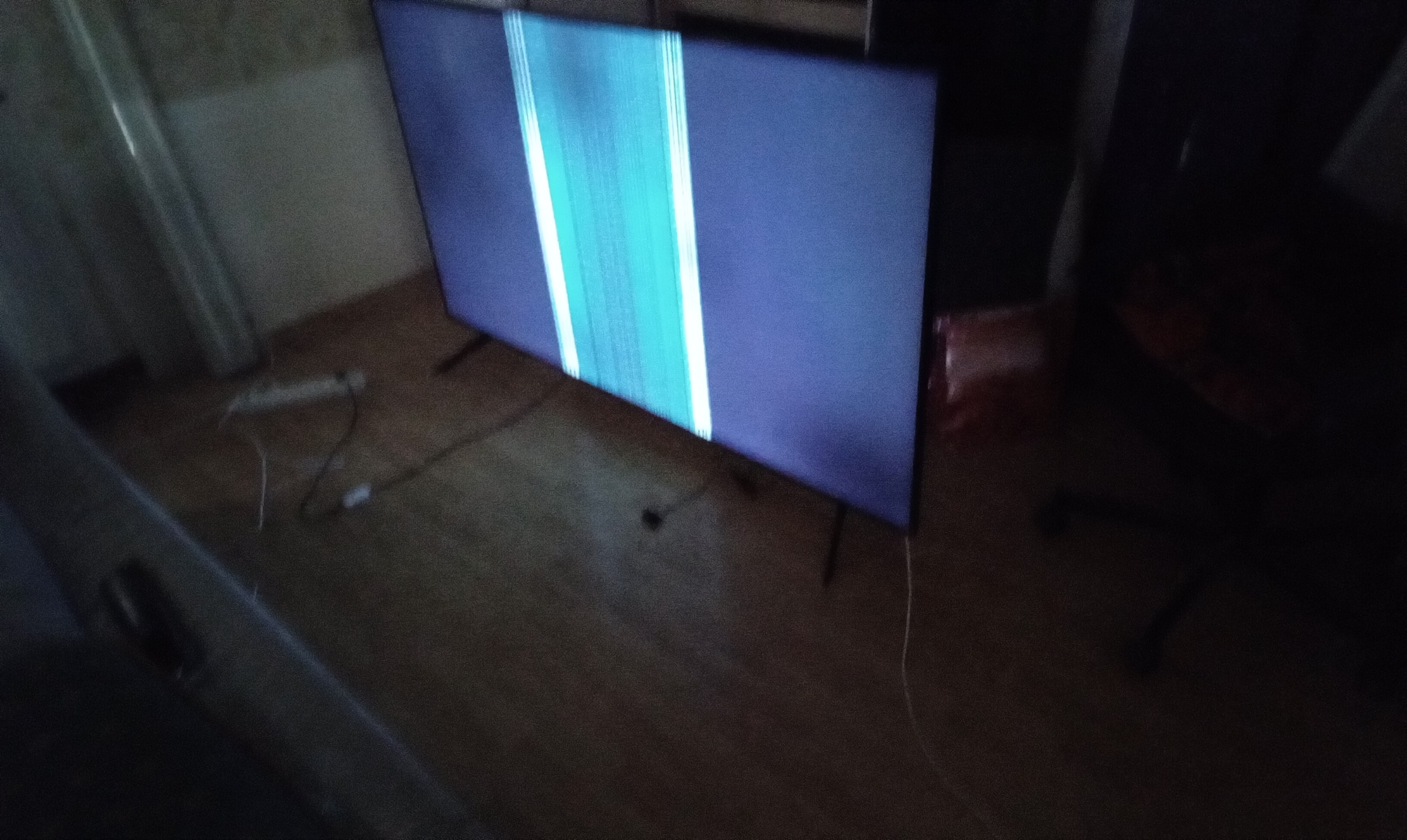

Samsung UE70TU6905 BACKLIGHTS AND SOUND ON NO PICTURES BUT SCREEN NOT DARK
This topic has been answered.
  • bohaboha
    replied
    Originally posted by lotas
    Yes, there were never any problems with them, here in the photo there are control points, check the resistance with a multimeter between them (between 1 and 2, between 1 and 3,...., between 2 and 3, between 2 and 4, and so on) and between the ground, there should not be low resistance.
    Hi Lotas if I have understood correctly i should measure the points between them, that is, 1 against 2,3,4 to number 14
    Then all the points in the same way.
    test the points to the GND from left to right:
    266.5k ohms most points except 2 which is 3325.6k ohms
    The points in between are quite mixed very hard to report everything here from: 09895mH, 1.755m ohms this for the first point against the others.
    If you want me to report everything I'll find to record values without typing one by one and then write here
    Or maybe a few points are enough. thank you
    Last edited by bohaboha; 05-05-2025, 08:52 AM.
    Leave a comment:
  • lotas
    replied
    Originally posted by bohaboha
    yes now i understand thank you. now how to test those 2 esd diod Diah " 5R2P " pointed in the pics and no component get warm all over the buffer boards
    Yes, there were never any problems with them, here in the photo there are control points, check the resistance with a multimeter between them (between 1 and 2, between 1 and 3,...., between 2 and 3, between 2 and 4, and so on) and between the ground, there should not be low resistance.
    Leave a comment:
  • bohaboha
    replied
    Originally posted by lotas
    Because without the LVDS cable the motherboard does not see the panel and blocks all output voltages to the panel, that is why the jumper is installed (panel - motherboard feedback (T-CON)).
    yes now i understand thank you. now how to test those 2 esd diod Diah " 5R2P " pointed in the pics and no component get warm all over the buffer boards
    Leave a comment:
  • lotas
    replied
    Originally posted by bohaboha
    Hi without a jumber the backlight is on black (bleue) screen no pictures but no loop anymore and no components get hot on the screen ribbon even the esd diodes . the set do not respond to the RC yet..
    Because without the LVDS cable the motherboard does not see the panel and blocks all output voltages to the panel, that is why the jumper is installed (panel - motherboard feedback (T-CON)).
    Leave a comment:
  • bohaboha
    replied
    Hi without a jumber the backlight is on black (bleue) screen no pictures but no loop anymore and no components get hot on the screen ribbon even the esd diodes . the set do not respond to the RC yet..
    Leave a comment:
  • bohaboha
    replied
    Originally posted by Diah
    remove the jumper and do same test.. see if the screen show ... keep it in loop so you can check the esd diode if one of them got warm
    with jumper and a smal tape on the left U ribcon it shows a picture on all the Screen for 3 second then loop. the esd diode never get warm in any situation with or with out a Jumper but maybe that IC near it or a capacitor are bad but no heat on them.
    I am having problem to get into the Forum site from home i am answering from Bibliotek att home i get "connection not private " and not secure site ,
    hope i will fix it soon.
    i realy do not know what to do next maybe i ll go on with tape trying .but is ist problem with jumper and tape or i have to remouve the jumper to try the tape ?
    thank you very much for your help
    Last edited by bohaboha; 05-02-2025, 08:14 AM.
    Leave a comment:
  • Diah
    replied
    Originally posted by bohaboha
    with ANA_DIM pin in place and the jumper and the left and middle side connected the TVn shows the logo then start loop
    remove the jumper and do same test.. see if the screen show ... keep it in loop so you can check the esd diode if one of them got warm
    Leave a comment:
  • bohaboha
    replied
    Originally posted by Diah
    all work now with jumper.. later after the issue cleared u can remove it
    2 esd
Name:	20250430_134759.jpg
Views:	90
Size:	129.2 KB
ID:	3626784
    with ANA_DIM pin in place and the jumper and the left and middle side connected the TVn shows the logo then start loop
    Leave a comment:
  • Diah
    replied
    all work now with jumper.. later after the issue cleared u can remove it
    2 esd
Name:	20250430_134759.jpg
Views:	90
Size:	129.2 KB
ID:	3626784
    Leave a comment:
  • bohaboha
    replied
    Originally posted by Diah
    we said put back ANA_DIM. and connect the left and middle side only.. see if there loop or not
    ok sorry and with or without the jumper on feed back points? did you find that esd Diode on buffert board
    Last edited by bohaboha; 04-30-2025, 11:50 AM.
    Leave a comment:
  • Diah
    replied
    we said put back ANA_DIM. and connect the left and middle side only.. see if there loop or not
    Leave a comment:
  • bohaboha
    replied
    Originally posted by Diah
    the part of panel at yours last test which didnt show picture are shorted.... you need to show here the buffer boards of this part if there any esd diode installed on it
    Hello new day new attempts. I have done new tests with ANA_DIM pin 2 disconnected and with jumper on feed back points.
    looking to the screen
    1) The left buffer board removed = no picture backlight on the TV goes in start loop and STB flash 3 times 3 flash.
    2)the middle and the left buffer board connected start with the logo for two to 3 seconds, then no picture but backlight on, then goes in the start loop with STB flash 3 times 3 flash.
    3)only middle buffer board attached = see attached picture no loop and no STB flash​ .
    Diah here some pictures of the buffer board as you asked
    pictures order from left to right 135133,135122,13508,134759,134708,134551 and 134502
    Leave a comment:
  • Diah
    replied
    the part of panel at yours last test which didnt show picture are shorted.... you need to show here the buffer boards of this part if there any esd diode installed on it
    Leave a comment:
  • bohaboha
    replied
    Originally posted by Diah
    also put back the cable ANA_DIM in the socket.,
    the feed back points are marked by lotas post#77
    I made the test with jumper on those point market By Lotas and Pin2 unhooked . what do you think that result i get in my last post ?
    Leave a comment:
  • Diah
    replied
    also put back the cable ANA_DIM in the socket.,
    the feed back points are marked by lotas post#77
    Leave a comment:
  • Diah
    replied
    i wrote you need to install the jumper on 2 feedback points on mainboards ... did you ?
    Leave a comment:
  • bohaboha
    replied
    Originally posted by Diah
    same result as original MB.. right? optic port lit red?
    install the jumper of feed back points on the MB, and disconnect U ribbon from half one by one
    the response of RC could be the front IR on TV had different out put as yours.. you can disconnect it also if wifi disconnect it too
    not really same result on the original i did have sound and the RC working in the beginning then something happened .yes the optic lit red. ok looking to the Tv the left U Ribbon unhooked the result is the screen is same as in post 97. the U Ribbon unhooked from the right side always looking to the screen big difference first it shows Logon Smart TV and some apps over 3 quarter of the screen but just for 3Seconds and then start looping but no picture this time and the standby lit 3 times 2 flashes
    Leave a comment:
  • Diah
    replied
    same result as original MB.. right? optic port lit red?
    install the jumper of feed back points on the MB, and disconnect U ribbon from half one by one
    the response of RC could be the front IR on TV had different out put as yours.. you can disconnect it also if wifi disconnect it too
    Leave a comment:
  • bohaboha
    replied
    Originally posted by Diah
    remove pin2 from the socket and connect the replacement MB to PSU, be sure to compare the socket on MB are same component and circuit as the original,
    main function you have A13V will be round 7.5V at standby and then go high after MB send Power_on and the BL to turn on when MB send BLU_ON. , if you got screen and optic port lit red we can deal with ANA_DIM
    yes both of them are on but no pictures and TV not reacting for RC .pin 2 is removed
    Leave a comment:
  • Diah
    replied
    remove pin2 from the socket and connect the replacement MB to PSU, be sure to compare the socket on MB are same component and circuit as the original,
    main function you have A13V will be round 7.5V at standby and then go high after MB send Power_on and the BL to turn on when MB send BLU_ON. , if you got screen and optic port lit red we can deal with ANA_DIM
    Leave a comment:
  • Mgiffune
    by Mgiffune
    06-09-2024, 10:28 AM
  • mrtek
    Samsung UN65js8500F, no sound, blank screen and T-Con board with one LED on
    by mrtek
    Hi I am new to this kind of repairs but I want to learn..I have a Samsung UN65JS8500F. the TV used to work and I tried to fix darker areas in the middle only ( img 1,2,3). I thought the led strip were bad..not the case. I did not research in advance what kind and where the LED were located. In this model they are located vertically on right and left side. Took the TV apart and put it back together. Now the tv shows no welcome screen and no sound is available thru the speakers. ..just a black screen..Backlight LED do turn on...also noticed a 5 blink code , not sure if that was there before. I can...
    11-26-2024, 09:58 AM
  • mecha1166
    KDL-60EX500. Comes on fine, sound is fine, backlights come on. Blank screen.
    by mecha1166
    KDL-60EX500. Comes on fine, sound is fine, backlights come on. Blank screen. Already tried reset POWER/VOL-. Anyone else have this problem? Possibly bad T-Con RUNTK4244ZZ or panel? Could main or power supply cause this? There were 2 blown 560u 35v on power going to backlights but they were still working fine. Thanks for your help.
    11-25-2024, 05:22 PM
  • stinger
    Samsung UN70TU6980FXZA no sound no picture but does have backlights
    by stinger
    When I turn tv on, the backlights come on but there is no sound or picture. I have read that these tv's have problems with the panels going bad but the "no sound" has me questioning if the main board is bad. Is there a way to troubleshoot the main board to determine if that is the problem?
    04-17-2024, 03:06 PM
  • mar1in
    Samsung TU8000, backlight and sound on, stuck in blue screen
    by mar1in
    Hi everyone,
    I've got this Samsung here that would be stuck in a boot loop.
    After opening up and doing the tape block method, I was able to get it to turn on and play sound from the HDMI input, but with a blue screen.
    Does that mean there is another combination of pins that I need to block in order to get a picture, or is there something more serious, faulty mainboard or faulty panel?
    Thanks in advance
    11-08-2023, 05:43 PM
