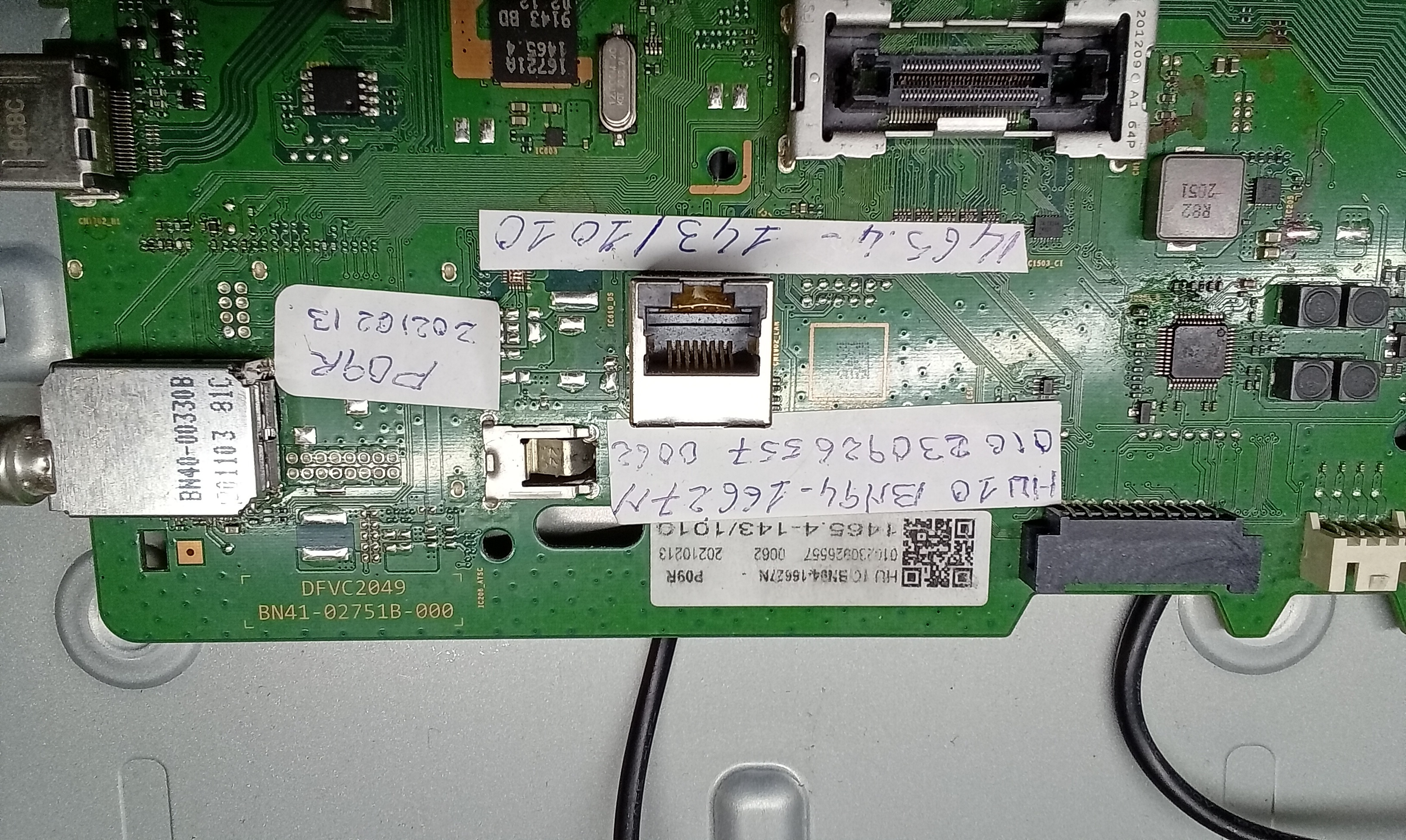

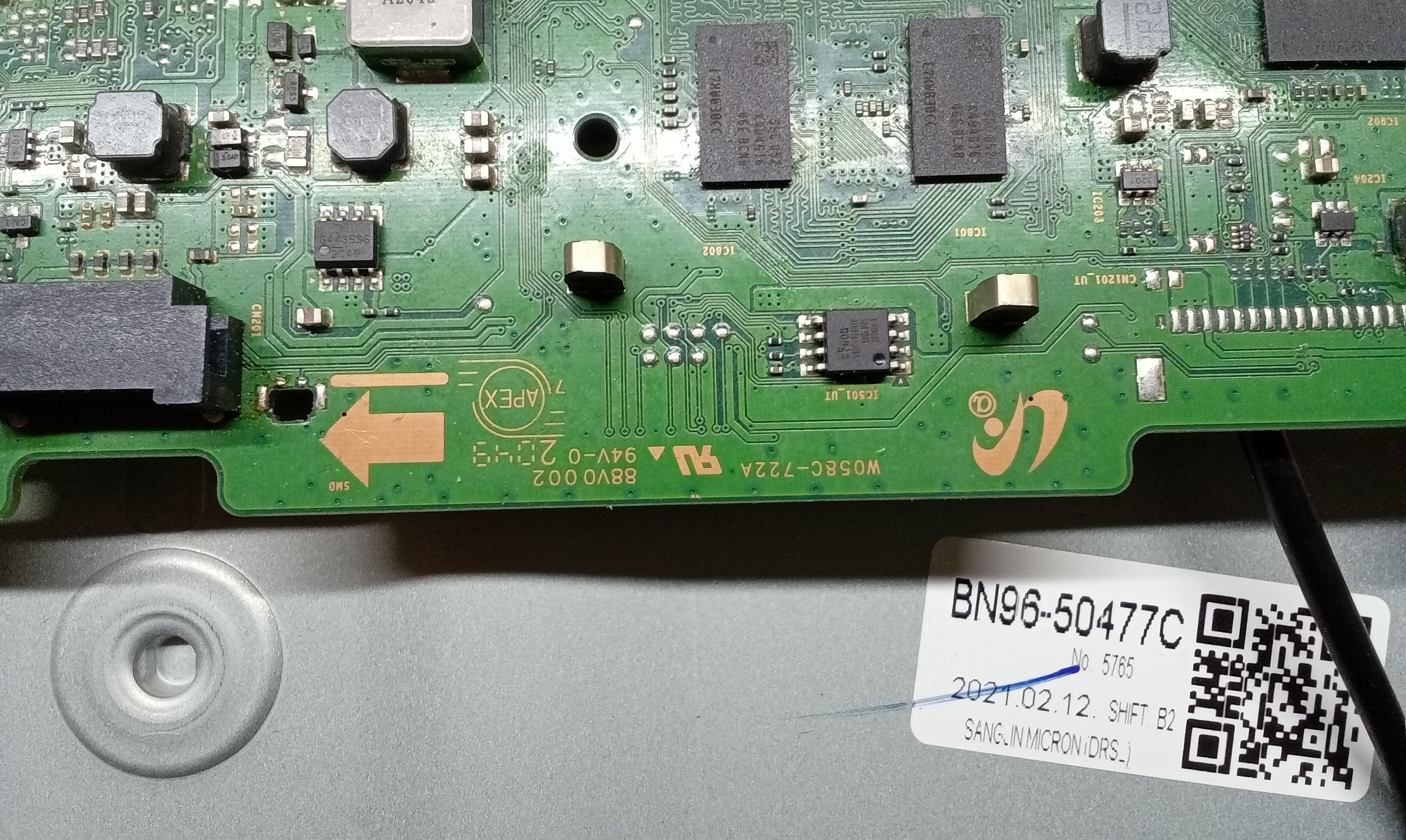

Samsung UE70TU6905 BACKLIGHTS AND SOUND ON NO PICTURES BUT SCREEN NOT DARK
This topic has been answered.
  • Diah
    replied
    from start before you missed with 70MB, you have the issue on Panel,
    70, and the one you said 65 they have only T-C Tuner, the 58 have T-C-S Tuner, i i did wrote before its had different at function, could be the wiring of IR socket different too this why no RC function.
    you can try 65 with out jumpers bur disconnect the left and right U ribbon., to avoid Panel short effected the MB
    Leave a comment:
  • bohaboha
    replied
    Hi again here the pictures of the 3 Mainboards they are almost identical only the 65 inches which differs with the others with socket on the upper left corner and it is active but probably they are not compatible as the 58 inches dealt with in this thread does not correspond to this Screen and neither for the remote control maybe it needs to be reprogrammed (region issue )
    Leave a comment:
  • bohaboha
    replied
    Originally posted by lotas
    Yes, there were never any problems with them, here in the photo there are control points, check the resistance with a multimeter between them (between 1 and 2, between 1 and 3,...., between 2 and 3, between 2 and 4, and so on) and between the ground, there should not be low resistance.
    Hi lotas​ am waiting your response about my answer very curious how the test should be done thank you
    Leave a comment:
  • bohaboha
    replied
    Originally posted by Diah
    zoom in the photo.. you will see 2 pins are like connected together,, u need to clean them.... also remove the jumpers totally u don't need it any more.... work on the panel , masking or scrap it
    no Diah it is not a short some particule on it it is clean now and it looks ok. instead of scraping the set why not move some component from 58 inches board to the 70 inches like the DC to DC chip and try the old board this is if it is not possible to use this one on the 70 inches .
    and i do have a board for 65 inches that have only one LVDS to the Screen it looks identical to the 70 inches
    i ll post some pictures of them all to se the differences
    Leave a comment:
  • Diah
    replied
    zoom in the photo.. you will see 2 pins are like connected together,, u need to clean them.... also remove the jumpers totally u don't need it any more.... work on the panel , masking or scrap it
    Leave a comment:
  • bohaboha
    replied
    Originally posted by Diah
    you have panel issue ....... check the LVDS socket ( red circle ) if there short contact !.. after you clear this, do only masking on the blue marked area..
Name:	20250505_210902[1].jpg
Views:	84
Size:	256.4 KB
ID:	3630751
    the test is between those 2 red point or to ground ?
    Leave a comment:
  • bohaboha
    replied
    Originally posted by Diah
    keep it in this test mode... just disconnect half screen a time
    Left U ribbon disconnected loop with lite Screen then black every start is with lite screen.
    same with the right U ribbon disconnected
    but with only the middle connected without the left and right side that part is steady no more loop you can se the picture in post 104
    Leave a comment:
  • Diah
    replied
    you have panel issue ....... check the LVDS socket ( red circle ) if there short contact !.. after you clear this, do only masking on the blue marked area..
Name:	20250505_210902[1].jpg
Views:	84
Size:	256.4 KB
ID:	3630751
    Leave a comment:
  • Diah
    replied
    keep it in this test mode... just disconnect half screen a time
    Leave a comment:
  • bohaboha
    replied
    Originally posted by Diah
    MB with jumpers, connected only to power boards and screen.... no other sockets of wifi or front LED indicator IR FB
    resolt : The set starts with backlight on Screen black then loop the screen get a bit clear like if it wants to clunch then black and so on
    Last edited by bohaboha; 05-06-2025, 07:38 AM.
    Leave a comment:
  • Diah
    replied
    MB with jumpers, connected only to power boards and screen.... no other sockets of wifi or front LED indicator IR FB
    Leave a comment:
  • bohaboha
    replied
    Originally posted by Diah
    as i know TU even size MB have only one LVDS, the odd have 2.
    however i would like you start the TV with out any socket of WIFI and front IR, let us testing in such condition only.. the jumpers must be in place
    Sorry Diah i do not understand what do you mean with "start the TV with out any socket of WIFI and front IR," take away the wifi connection and the jumper it is ok but the other ????
    Leave a comment:
  • Diah
    replied
    as i know TU even size MB have only one LVDS, the odd have 2.
    however i would like you start the TV with out any socket of WIFI and front IR, let us testing in such condition only.. the jumpers must be in place
    Leave a comment:
  • bohaboha
    replied
    Originally posted by Diah
    then you have different between the 2 boards function.
    somehow it have to be some difference it is a board for 58inch and mine is a 70 inches as you know but i follow your recommendations you said any even number should work i know it is not a guaranty but do you think it will work ?.
    Leave a comment:
  • Diah
    replied
    Originally posted by bohaboha
    no i dit not solder anything on the board and the jumper i desoldered one side of it but leave it there for further test if it needs.
    is the pictures good for your request?
    then you have different between the 2 boards function.
    Leave a comment:
  • bohaboha
    replied
    Originally posted by Diah
    did you soldered out part from the original boards close to the LAN port? its look huge short caused at it which effected the IR boards..
    by the way yours jumpers don't let with chassis in contact
    no i dit not solder anything on the board and the jumper i desoldered one side of it but leave it there for further test if it needs.
    is the pictures good for your request?
    Leave a comment:
  • Diah
    replied
    Jumpers should solder in 90° of points not from side.
    Leave a comment:
  • Diah
    replied
    did you soldered out part from the original boards close to the LAN port? its look huge short caused at it which effected the IR boards..
    by the way yours jumpers don't let with chassis in contact
    Leave a comment:
  • bohaboha
    replied
    Originally posted by Diah
    post photos with remark on yours original MB and the replacement only on LVDS socket and front IR-LED indicator socket and WIFI socket
    Hi Diah here some pictures of both boards the native one has hand written notes on it
    the first row of pictures is the old one
    Last edited by bohaboha; 05-05-2025, 01:42 PM.
    Leave a comment:
  • Diah
    replied
    post photos with remark on yours original MB and the replacement only on LVDS socket and front IR-LED indicator socket and WIFI socket
    Leave a comment:
  • Mgiffune
    by Mgiffune
    06-09-2024, 10:28 AM
  • mrtek
    Samsung UN65js8500F, no sound, blank screen and T-Con board with one LED on
    by mrtek
    Hi I am new to this kind of repairs but I want to learn..I have a Samsung UN65JS8500F. the TV used to work and I tried to fix darker areas in the middle only ( img 1,2,3). I thought the led strip were bad..not the case. I did not research in advance what kind and where the LED were located. In this model they are located vertically on right and left side. Took the TV apart and put it back together. Now the tv shows no welcome screen and no sound is available thru the speakers. ..just a black screen..Backlight LED do turn on...also noticed a 5 blink code , not sure if that was there before. I can...
    11-26-2024, 09:58 AM
  • mecha1166
    KDL-60EX500. Comes on fine, sound is fine, backlights come on. Blank screen.
    by mecha1166
    KDL-60EX500. Comes on fine, sound is fine, backlights come on. Blank screen. Already tried reset POWER/VOL-. Anyone else have this problem? Possibly bad T-Con RUNTK4244ZZ or panel? Could main or power supply cause this? There were 2 blown 560u 35v on power going to backlights but they were still working fine. Thanks for your help.
    11-25-2024, 05:22 PM
  • stinger
    Samsung UN70TU6980FXZA no sound no picture but does have backlights
    by stinger
    When I turn tv on, the backlights come on but there is no sound or picture. I have read that these tv's have problems with the panels going bad but the "no sound" has me questioning if the main board is bad. Is there a way to troubleshoot the main board to determine if that is the problem?
    04-17-2024, 03:06 PM
  • mar1in
    Samsung TU8000, backlight and sound on, stuck in blue screen
    by mar1in
    Hi everyone,
    I've got this Samsung here that would be stuck in a boot loop.
    After opening up and doing the tape block method, I was able to get it to turn on and play sound from the HDMI input, but with a blue screen.
    Does that mean there is another combination of pins that I need to block in order to get a picture, or is there something more serious, faulty mainboard or faulty panel?
    Thanks in advance
    11-08-2023, 05:43 PM
