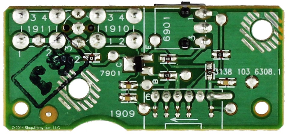

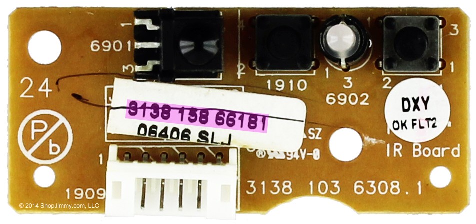

                          There are two momentary switches that sit on either side of the main indicator LED, the IR sensor for the remote, the connector for the ribbon cable, and a few resistors that I can see. I did double check the ribbon cable that feeds this board, and that seems to check out ok, no breaks, shorts, etc.
                          For the cost of the board assembly, I think its easier to replace it than to try fixing it. Here's a link to the part in question, pics below as well: http://www.encompassparts.com/item/6...5866181/Cba_Ir

                            Boy it's hard to believe that board would cause those symptoms,
                            But I can't disagree with you, at that cost, even if it doesn't fix it, it's still worth the price of knowing that's not the problem!
