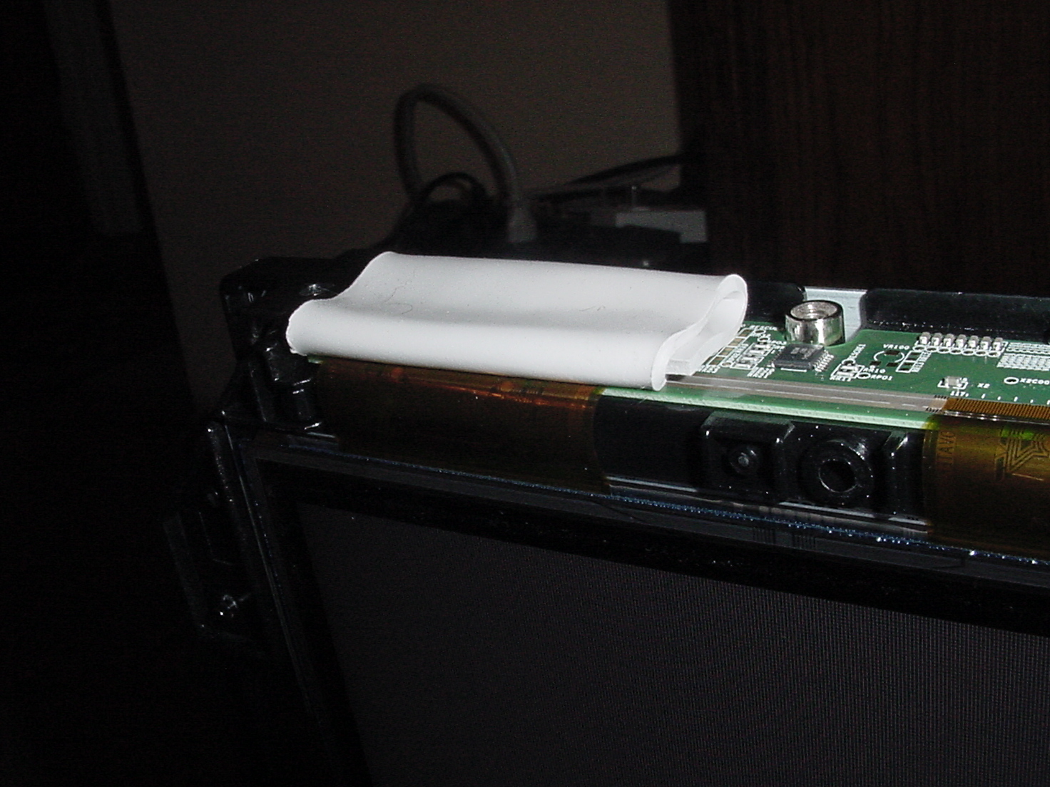

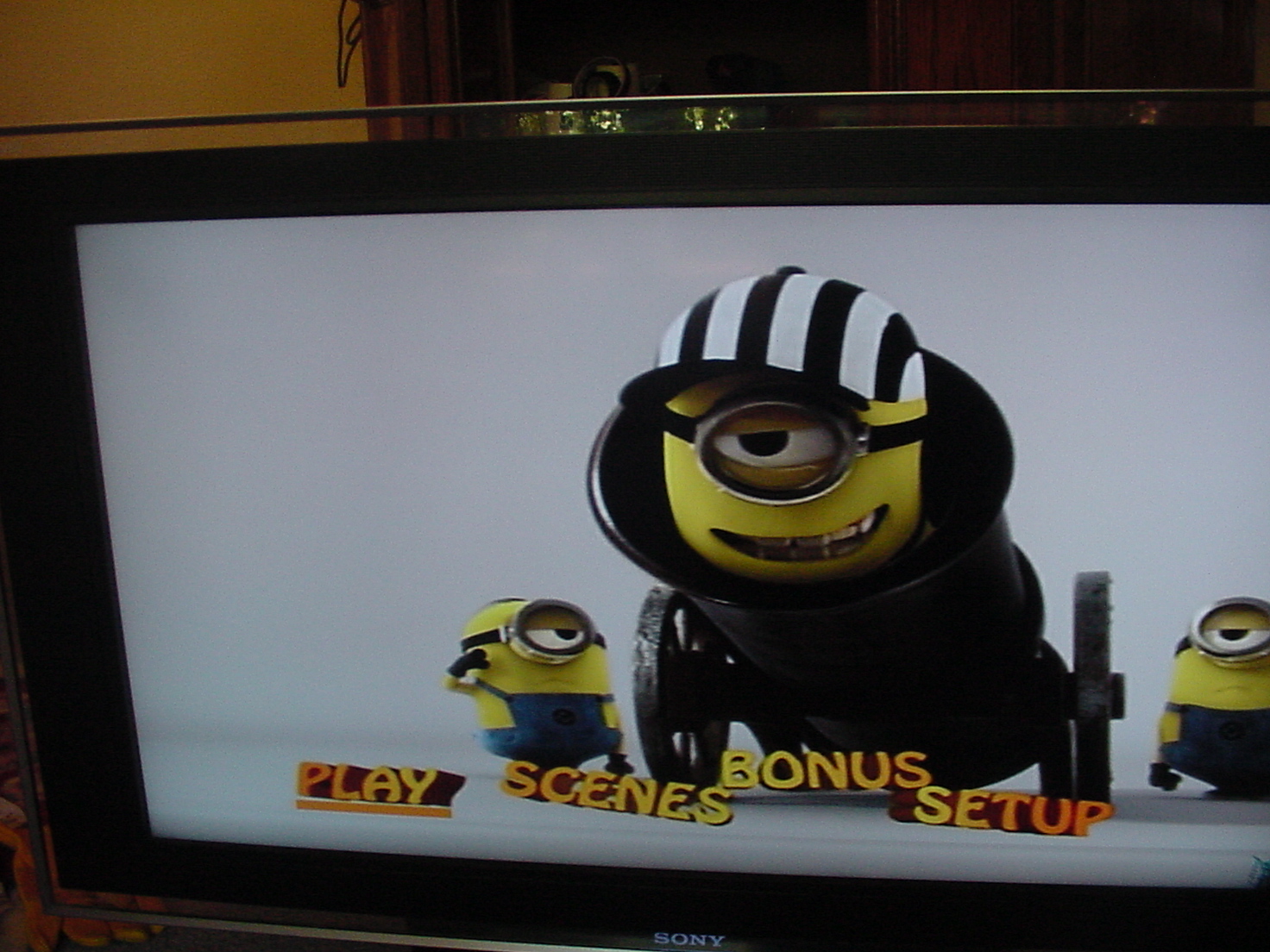

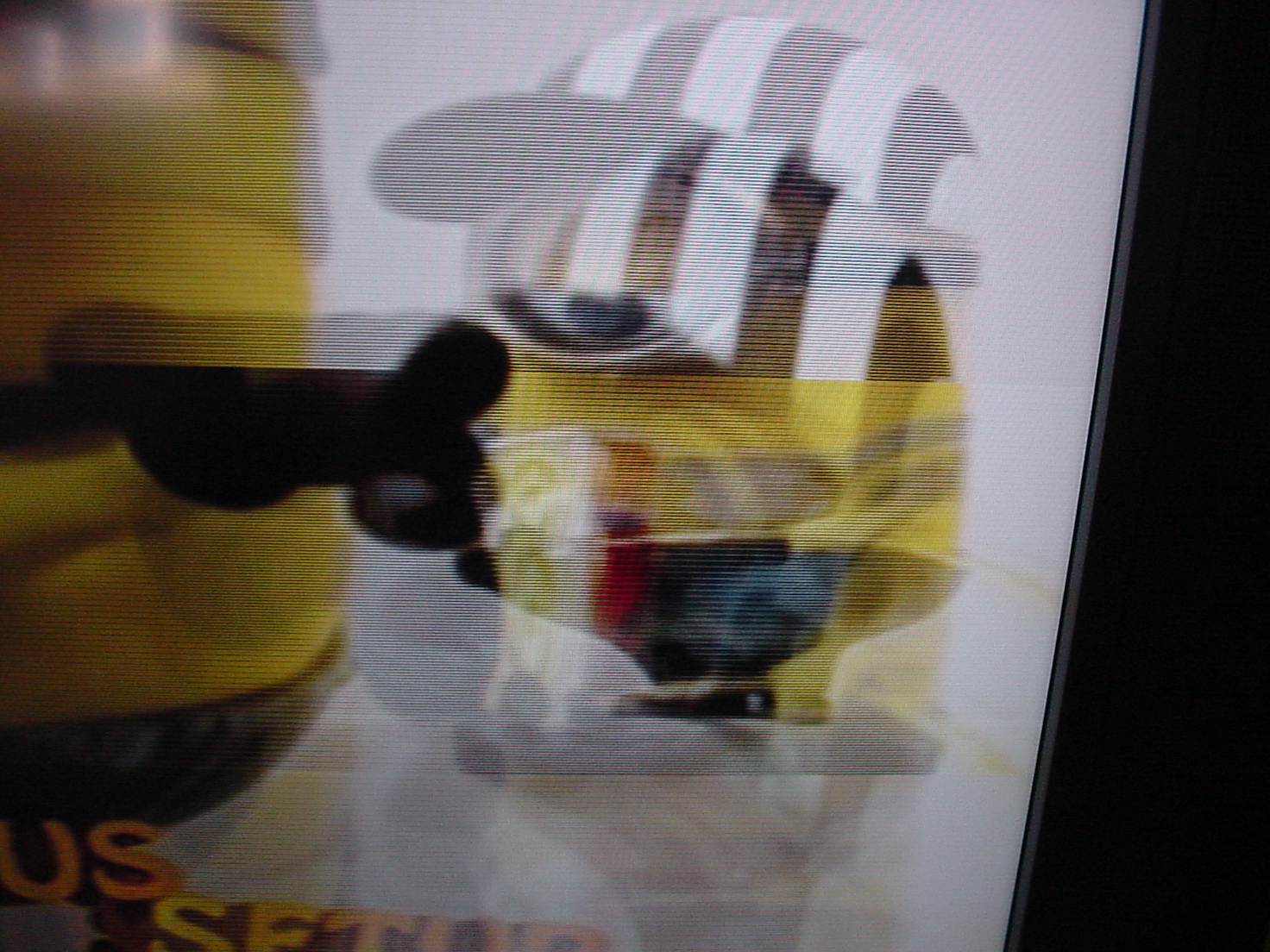

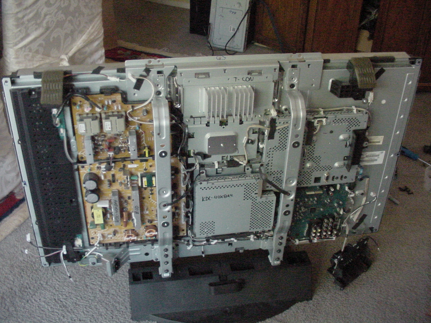

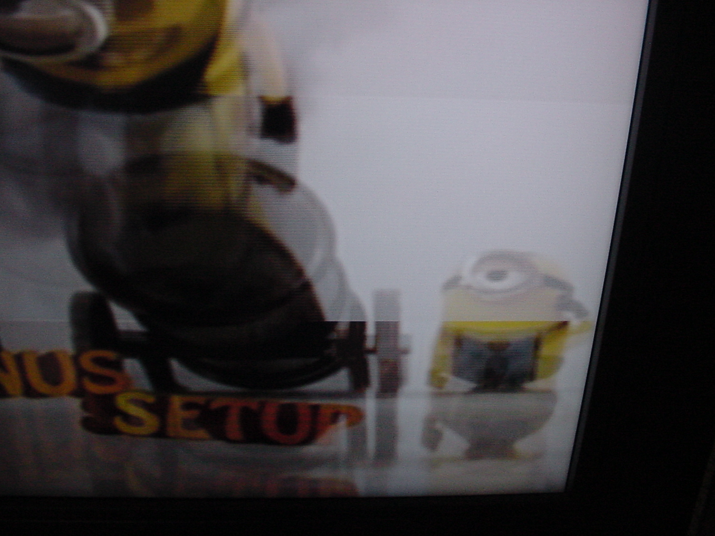

SONY KDL-40XBR4 Tab bonding repair

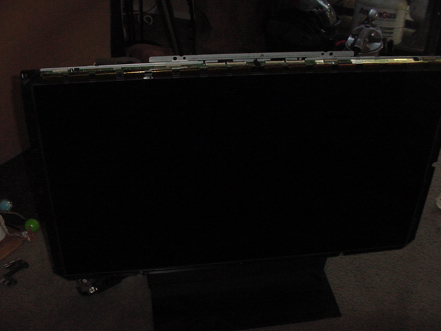

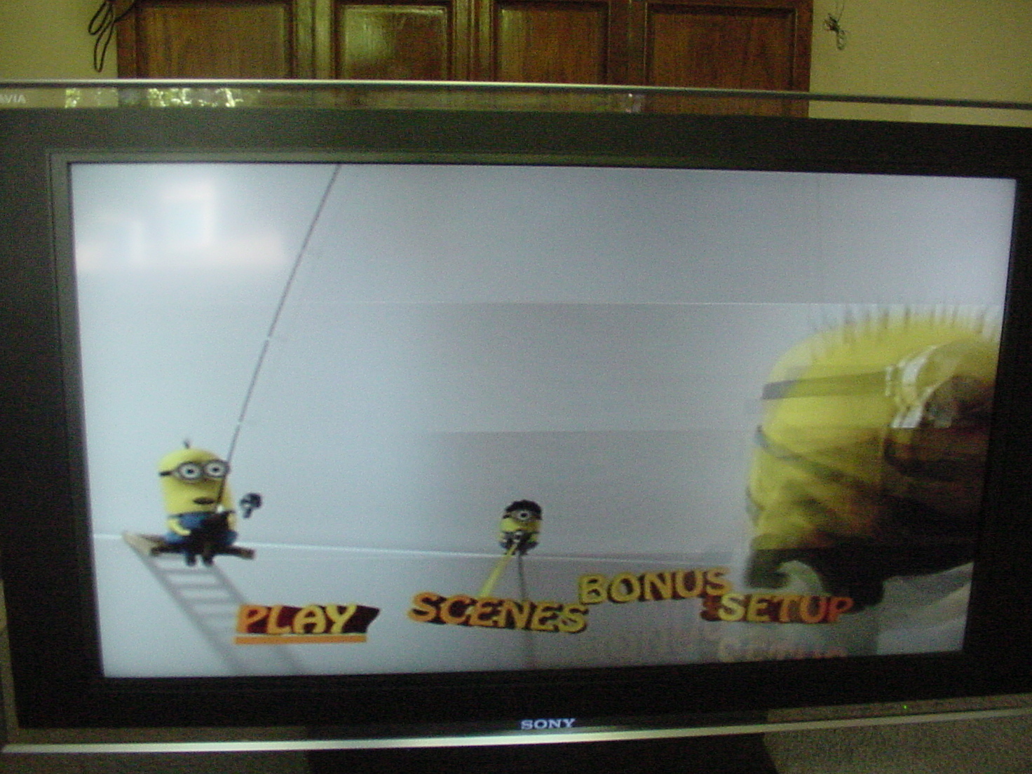

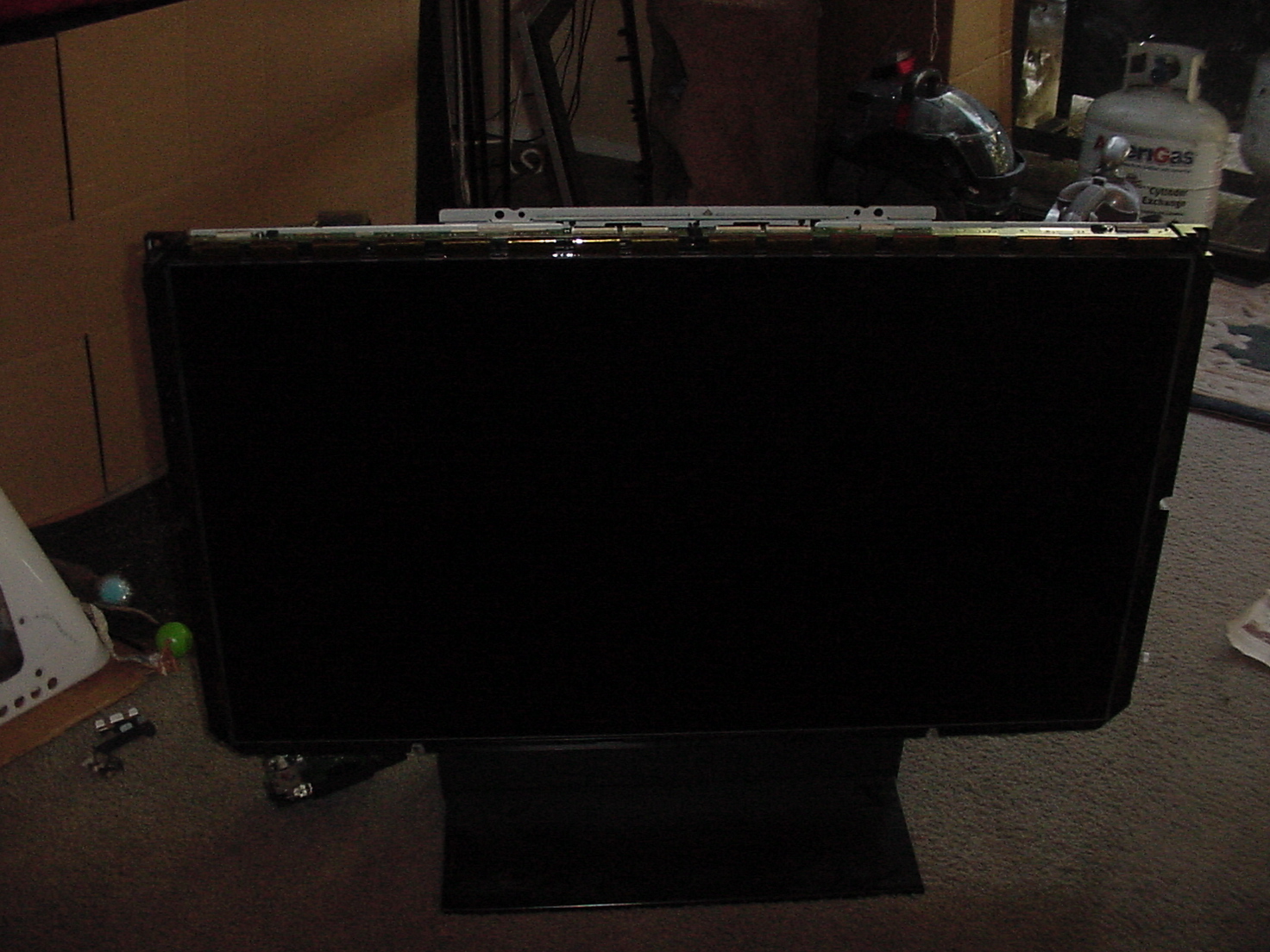

    Second one today, bad bonding on the top right.

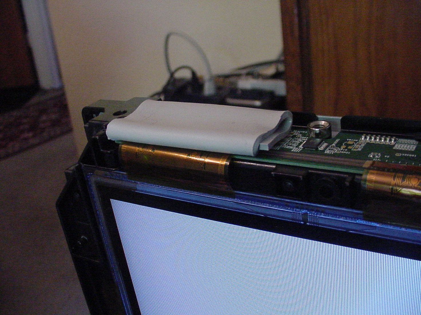

    Using Dealextreme thermal pad.

        Re: SONY KDL-40XBR4 Tab bonding repair

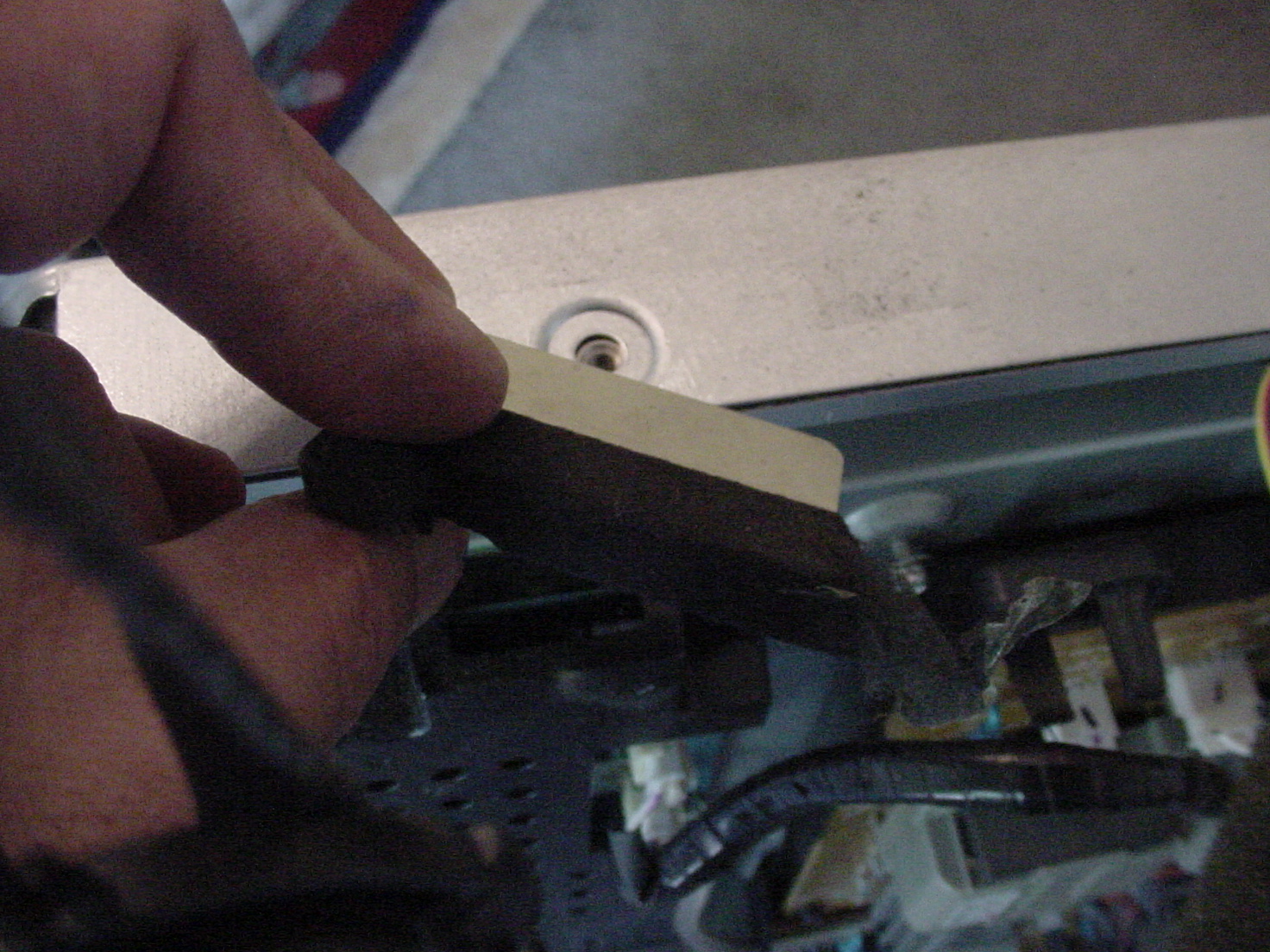

        I find your repair to be ok ,but i have also found this will not last as the material you used will eventually release the pressure on the tab
        I have used much harder material eg silicon tubing or tape that does not loose the tension over time .anyway good luck in repairing these tvs
          It lasts 2 years so far.
            Crap bud, I know the answer is buried in your posts somewhere but could you tell me what thickness of pads you got from Dealextreme ?
              I just bought a kit with multiple thicknesses 0.5mm up to 3mm, as I use the stuff for other things too.
                Good for you budm I do my bonds standing up also , better to work on.. I have a kdl-46xbr5 almost two years and still working good..
                    Thanks bud, I guess the most important criteria is to cover the gap enough to put pressure on the bonds. I'm having a different problem, I have two cof's that are causing artifacts because they are running too hot. I've verified this by giving them a short burst of cold spray. Either the
                      (cat stepped on the keyboard lol...)
                      Either the pad is not effective for this from the front or it simply cannot remove enough heat.
                      I'm going to try a piece in BEHIND the ribbon and then again from the top to make a COF sandwich, see if that helps.
                        Yes you can behind the ribbon to transfer the heat from IC to the chassis, but I think the IC will eventually fail, they do run hot.
                          Yes I think it is too late for this one. I just put a strip behind the ribbon and a couple over it and it definitely is improved but not cured. It's running too hot to be cooled this way.
