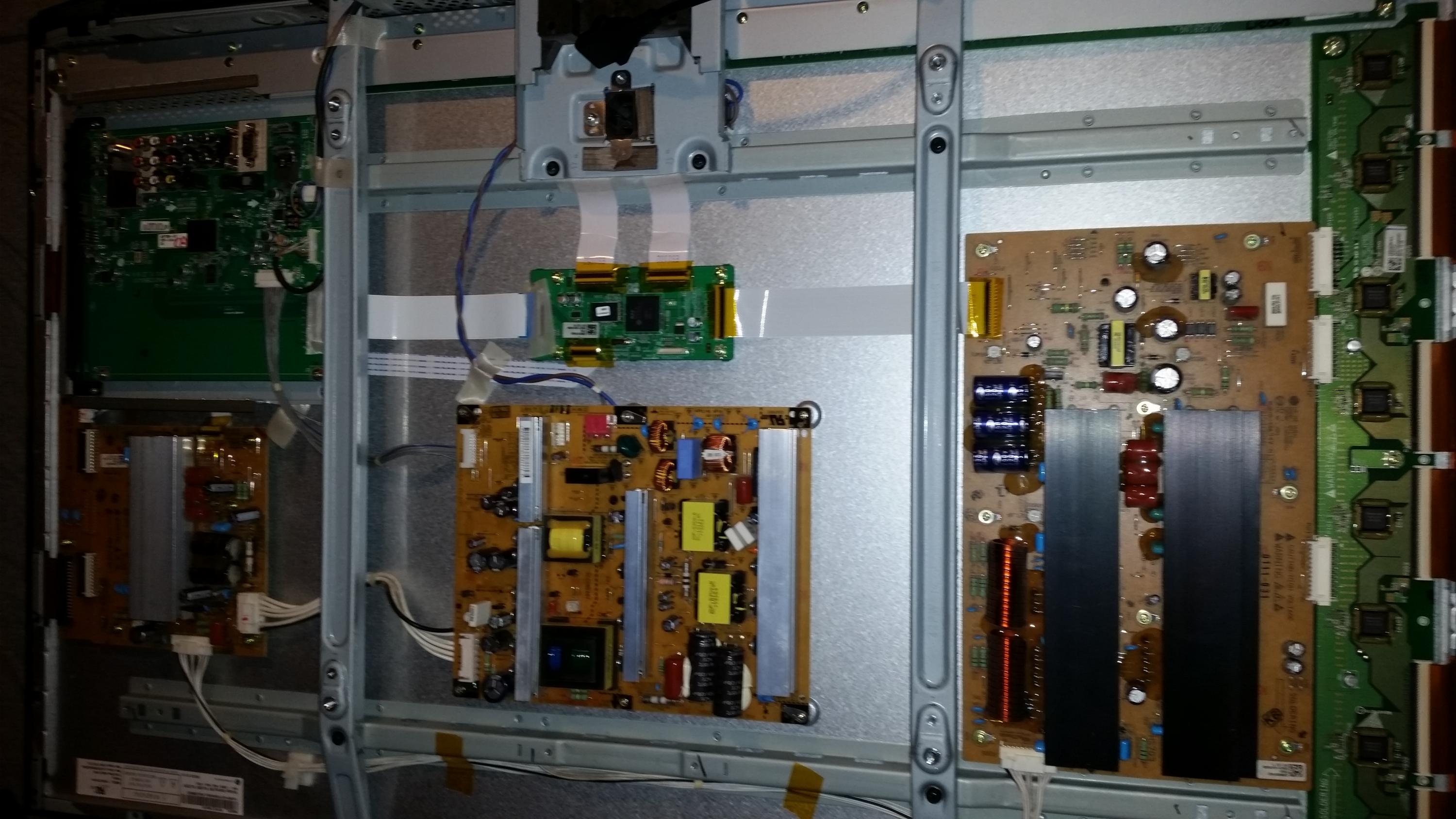

    Hello everyone, I'm new to the site.
    I have a LG plasma 42pt350 tv. It's from 2011, when powering on you can hear the relay click but then it turns off. So I looked for bad caps, didn't find anything. So I tried something else. I unplugged everything from the power board but the power cord going to it. The relay clicks faster when everything is unplugged from it. I'm very busy so I haven't been able to check more out on it. Can someone point me in the right direction.
    Thanks E
    Re: LG plasma 42pt350 relay just clicking.
    Do you happen to have a digital multimeter, and a camera to take pictures?
    Could you take pictures of the chassis layout so we can see what the board layout is like.

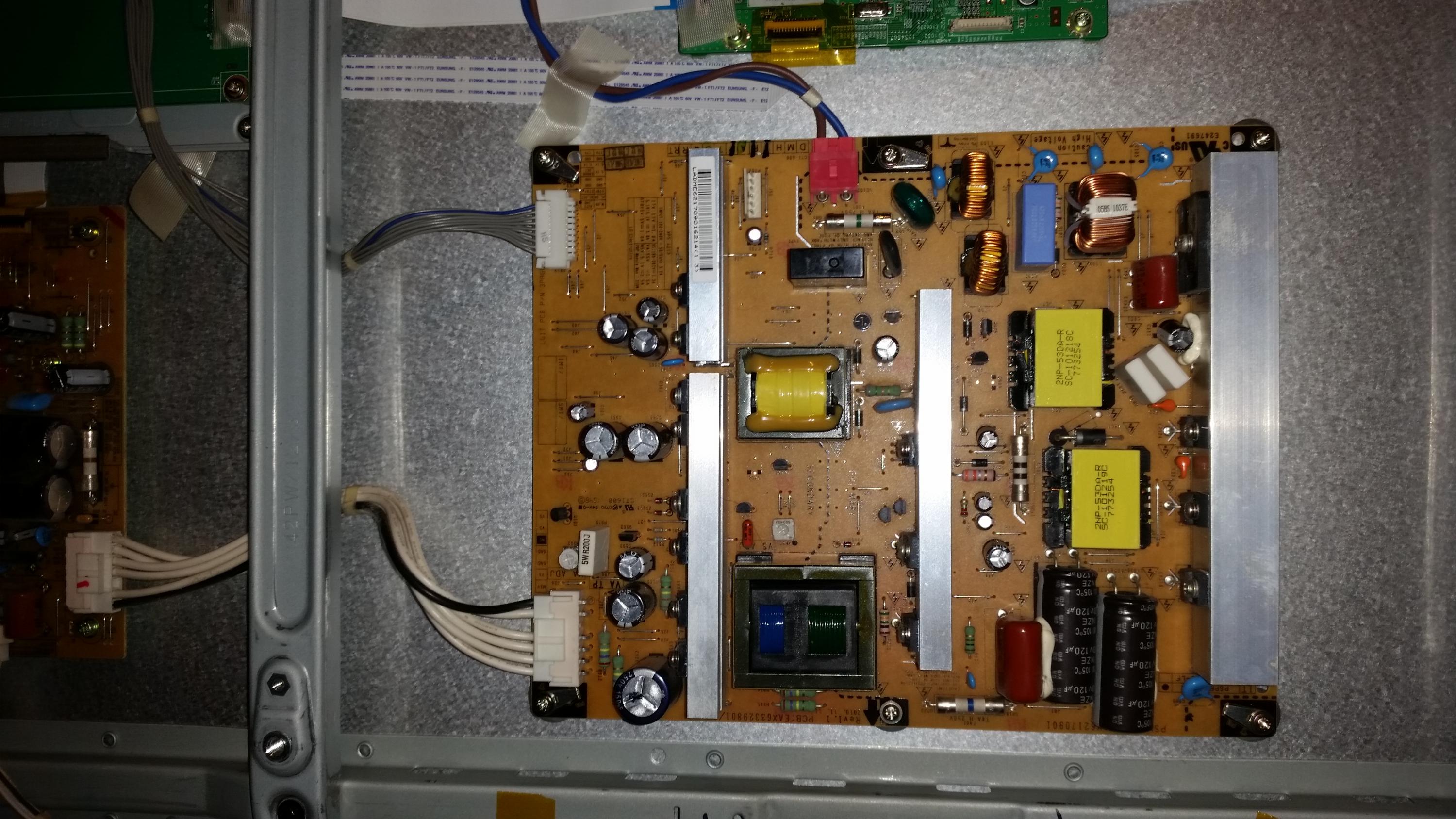

      I do have a digital volt meter and I will post a picture.
          updated with pictures.
              OK in this (upside down) picture
              https://www.badcaps.net/forum/attach...1&d=1400982012
              Right board is Y-sustain
              Left board is Z-sustain
              Y-buffer connects to Y-sustain which connects to plasma panel orange ribbons.
              Z-sustain connects directly to plasma panel. Z-sustain chains power to Y-sustain.
              Please disconnect the Z-sustain power, but leave all other connectors hooked up, and confirm if the relay continues to click, or if it clicks only a few times then stops. (No picture should appear on the plasma panel.)

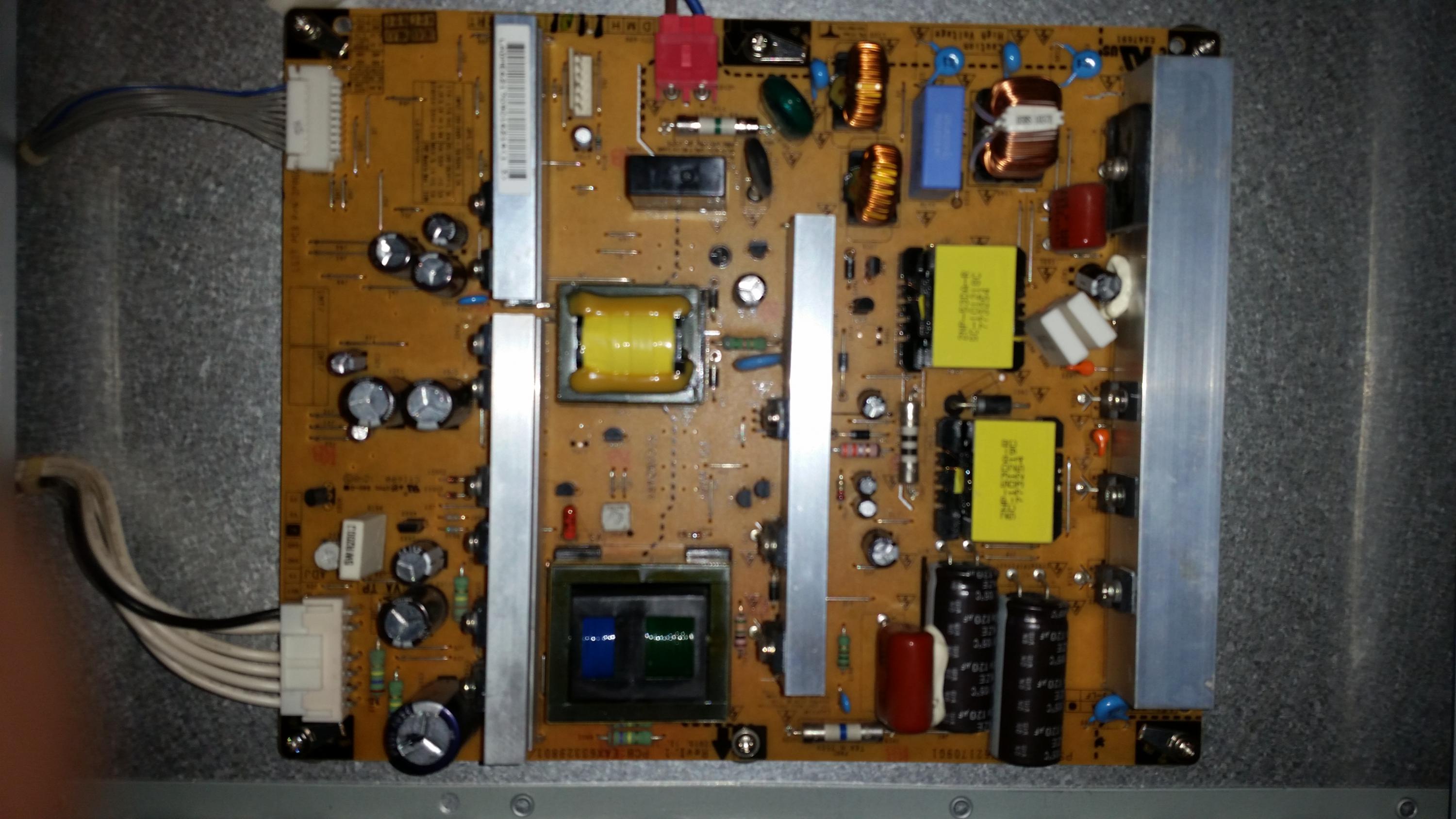

                  Update
                  I did a little more testing/looking at the TV.
                  With everything plugged in I get 3 relay clicks.
                  First relay click red light flashes(red light on) then it starts to fade out, once out relay clicks again red light still is off. then relay clicks again and red light comes back on. Its like it turn on. then off, then goes in stand by mode.
                  I disconnected the y-sus cable from the z-sus board and there is no difference. 3 relay clicks.
                  I even disconnected the power going to the z-sus board and I get the same 3 relay clicks.
                  When I disconnect everything but the power in going to the power board the relay clicks faster and it doesn't stop, the relay clicks about every 4 seconds.
                  • dkneyle
                    • Dec 2013
                    • 445
                    Here's a few YouTube clips that might help: https://www.youtube.com/watch?v=_UyXfxG5LyE That's the typical caps that fail - typically you'll notice if they have bulged tops and some black electrolytic gunk coming out.
                    https://www.youtube.com/watch?v=I9wF0OLyV0k This clip and the (second part clip) describes the typical active and passive components that fail.
                    Given that you have disconnected y and X Sus boards I think we can assume it's a power supply failure.
                    (I'm putting money on that regulator device!)
                    Don't be too concerned that your power supply board is not exactly the same. Similar sets will have very similar circuits for the SMPS with some minor variations.
                    Let us know how you go.
                      I've charged tons of bad caps before. These caps look very good, But there are 2 that look pushed in. not sure what the means. these are the NXB 50v 220uf location c365 and c377.
                      Im thinking the samething, the voltage regulator.
                      Im going to test the diode and the resistor he pointed out in the video.
                      • erickeri1234
                        • May 2013
                        • 98
                        • usa
                        Well I tested some diodes and found 2 of them bad. One is reading .213 and the other one is just plan shorted.
                        The one that is shorted is marked VA9 IN5408
                        The other one is SR104 that one is reading .213
                        I replaced the shorted one but I didn't replace the SR104 ( cause Im not to sure if it is really bad) But Im still getting the same clicking relay.
