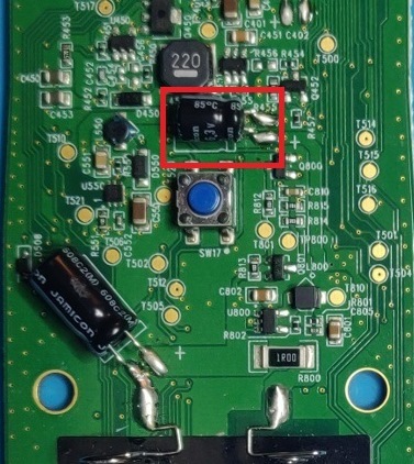

              other things this is hand work nor robot !!
                  This was me, adding a cap in parallel for testing. Doesn't look that bad in reality

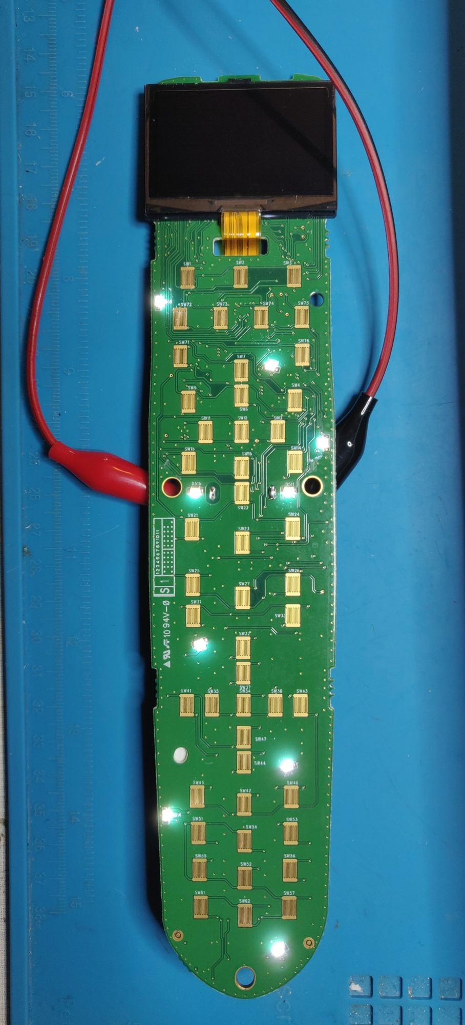

                                  Yes, after removing the white foil I tested all keys - they are all NO and closing every single one of them causes a wake up. The current draw looks fine for me - about 5 ma on start up, about 3 ma when awake and almost zero when asleep.
                                  I noticed another strange behavior. There a light switch on the buttom side, which turns on LED Backlight of the keypad and also wakes up the MCU. This wakeup works always, the LEDs however sometimes don't react.
                                    can you show it here with focused clear photo
                                      You mean the push button itself?
                                      • Diah
                                        • Feb 2013
                                        • 6494
                                        just remark it on yours photo which it show all BL working with out pressing any key
