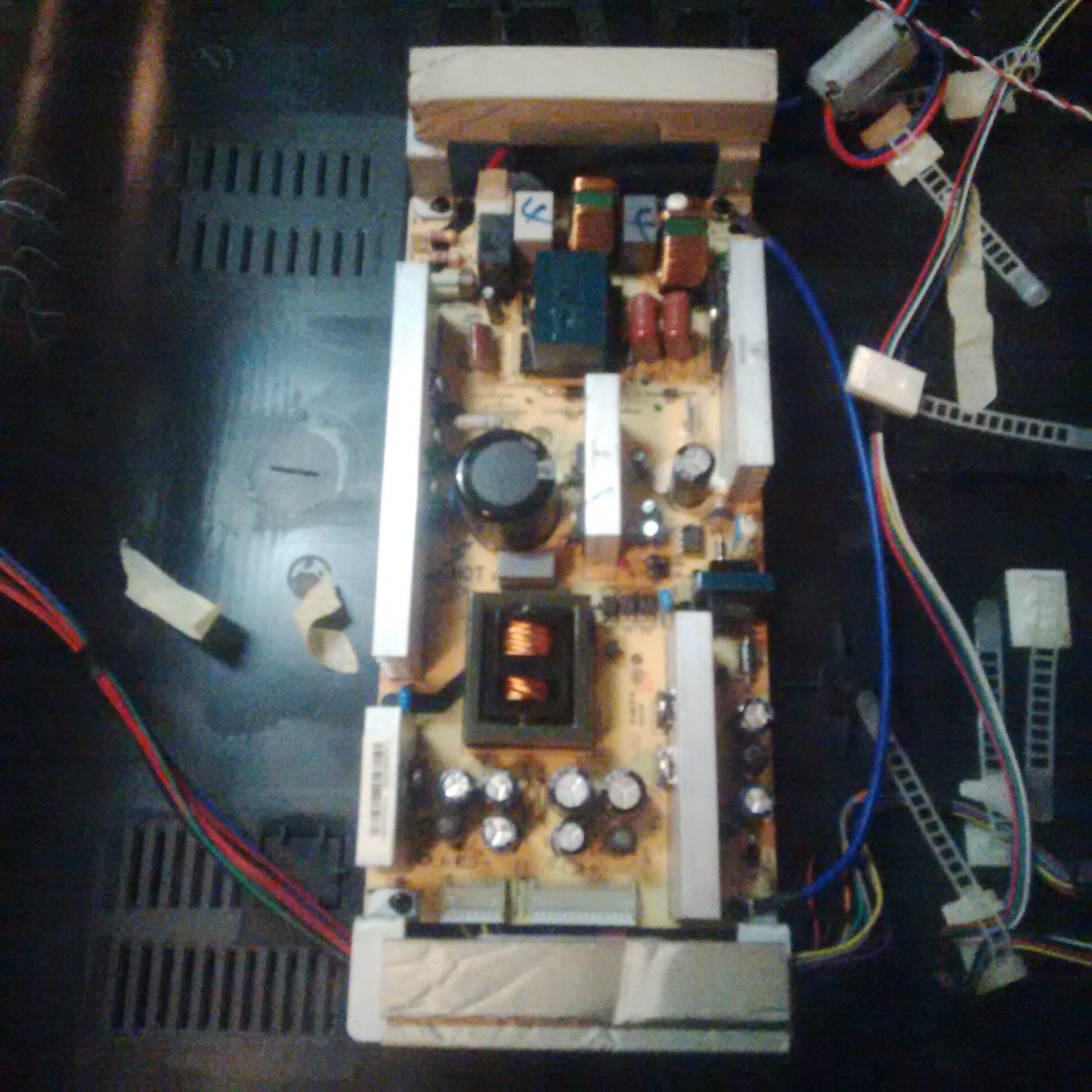

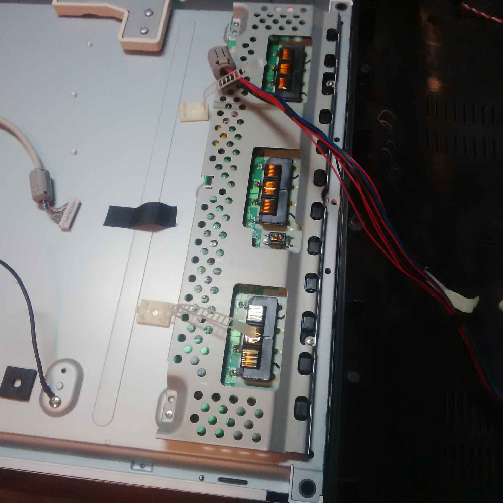

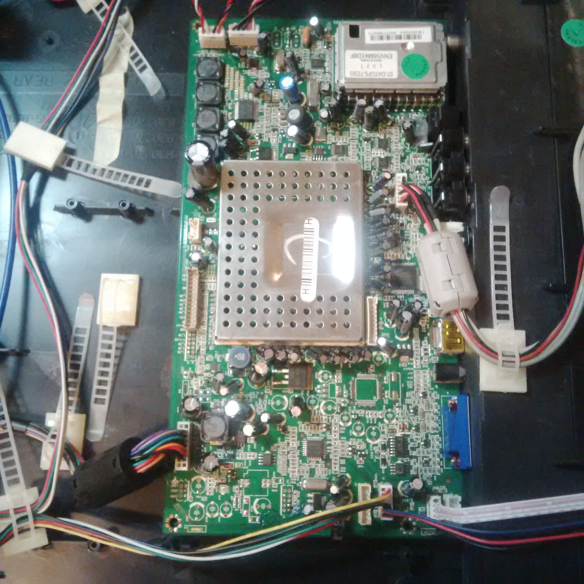

        • dcapper
          • Dec 2013
          • 496
          Re: Rca l32hd31yx13
          Here is some pics from the power supply, mainboard, and inverter. I am getting 24v at the inverter.
            • 30977
            Re: Rca l32hd31yx13
            you need to power-up the psu& mainboard & meter the voltages on the connectors between the psu & mainboard to see if your getting 5&12v
            and then look at the mainboard voltage regulators - see if they all have outputs.
            • dcapper
              • Dec 2013
              • 496
              Re: Rca l32hd31yx13
              Metered all my points. All reading voltages. I removed my inverter board and metered where it goes to the panel and there is no voltage or before the steup transformers. I have the 24v coming in but dies somewhere on the board. Getting a short across a diode but I tested it out of circuit and it's fine. Tested all the diodes and transistors so far and no fault found.
