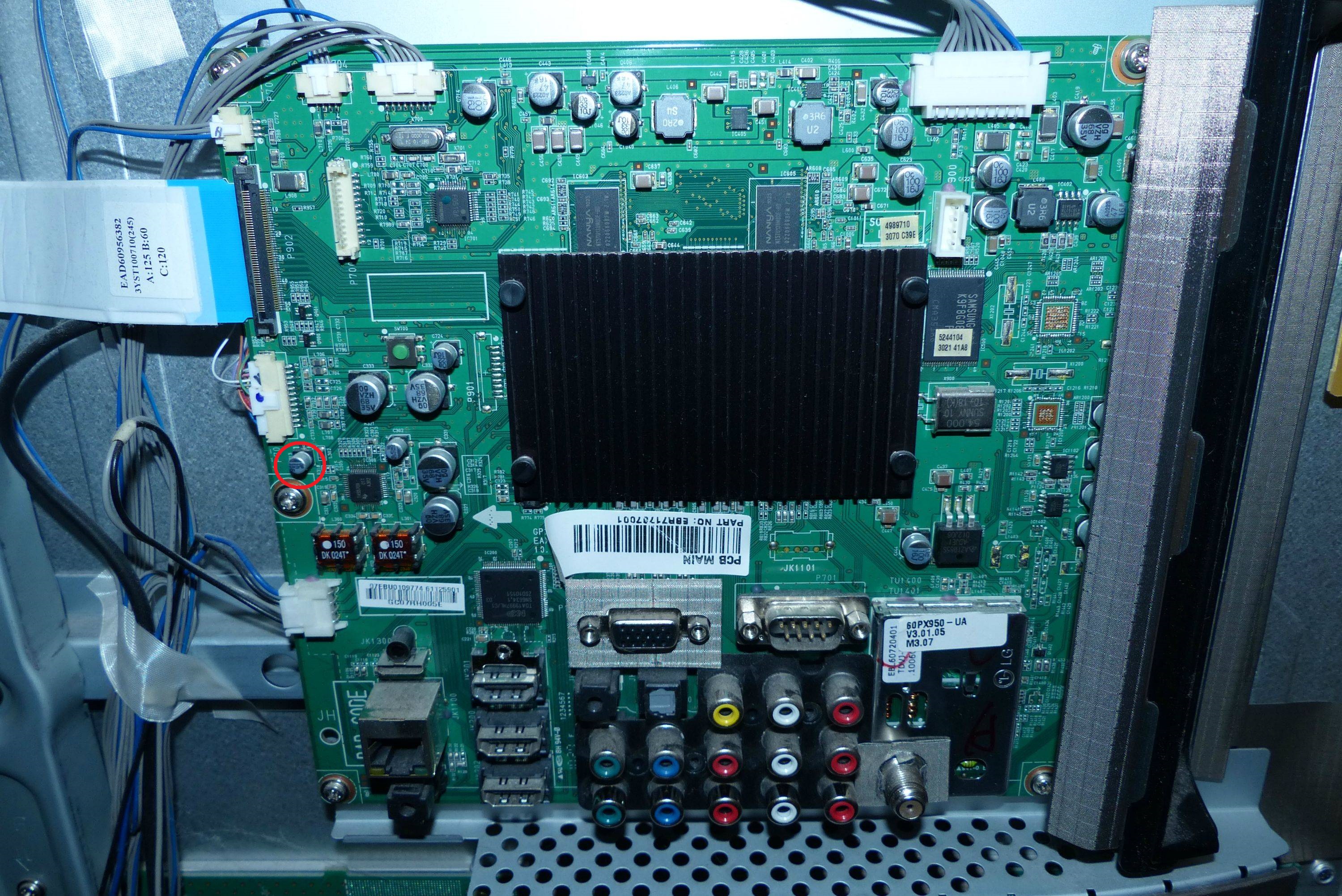

              Re: LG 60PX950 No video...
              Main Board (I think):
              http://imgur.com/fvfWVo8.jpg
              Right side:
              http://imgur.com/tQg0Hrc.jpg
              Left side:
              http://imgur.com/ZHTFkDk.jpg
              I don't see anything out of the ordinary other than cobwebs... (wtf). No burnt marks are anything else. Let me know if you need closer pictures of any other pieces. The green light that flashes comes from the little green light board on the left (labelled CTRL) underneath the power supply (yellow board)... The YSUS is the left big board, ZSUS is the big one on the right.

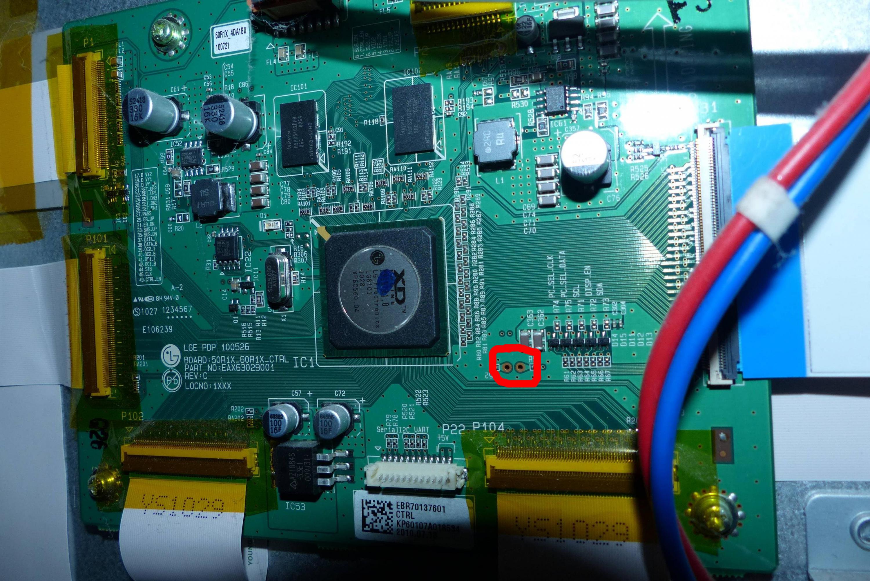

                Can you get a closer pic of the CTRL board?
                • bradf79
                  • May 2014
                  • 17
                  http://imgur.com/df0p5UN.jpg
                  http://imgur.com/2uXBytw.jpg
                      Turn TV off.
                      Place a wire jumper between the two holes; make sure they are connected.
                      Unplug the right hand wide ribbon cable.
                      Plug TV in and turn it on.
                      You should see a cycling of test patterns if the control board (CTRL board) is working OK. If so there are two possibilities, the 3D processing board being bad (in between the main board and the CTRL board) or the main board. The main board is a lot more likely but you may have to replace both boards.
                          Well, I shorted those pins and it went into test mode, red, blue, green, black, white, then some bars. Guess this means I need to find a main pcb or just replace the whole TV? Any chance it's possible to bypass the 3D board to keep from having to replace that?
                          I'm just not sure on spending $200+ on a 3.5 year old TV when I could replace it with something probably better for $1100 (Vizio M Series 60")....

                                        I got the board in today, I hooked it up and it's working but there was a loose piece in it and looking at my old board it's the piece circled...
                                        A) What is it?
                                        B) Can I fix it?
                                        C) How is it working without it?
