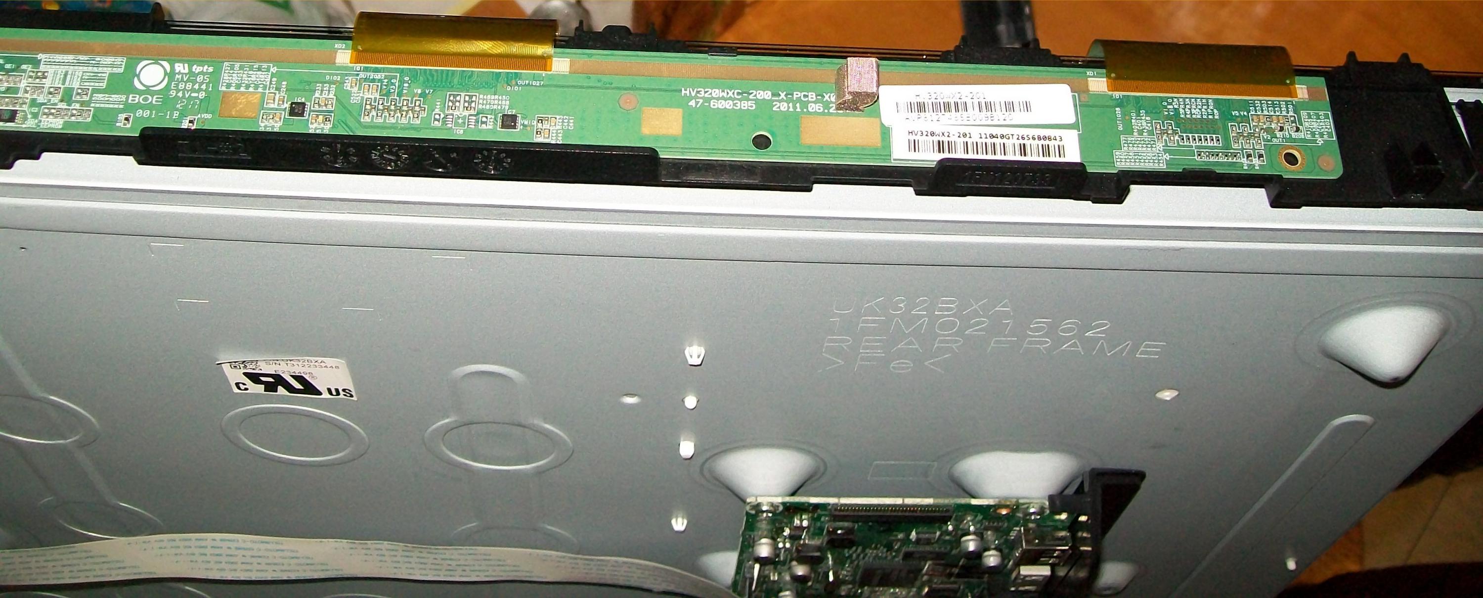

                                    any numbers on the board at the top of the lcd panel
                                      #58
                                      Re: Emerson LC320EM2 back lights on but no picture
                                      kinda hard to make out but here's a pic of the numbers on the top board.
                                        that helped, took me to the glass face instead of a complete panel
                                        looks like 12v
                                        Panel Brand : BOE
                                        Panel Model : HV320WX2-201
                                        Panel Type : a-Si TFT-LCD , CELL
