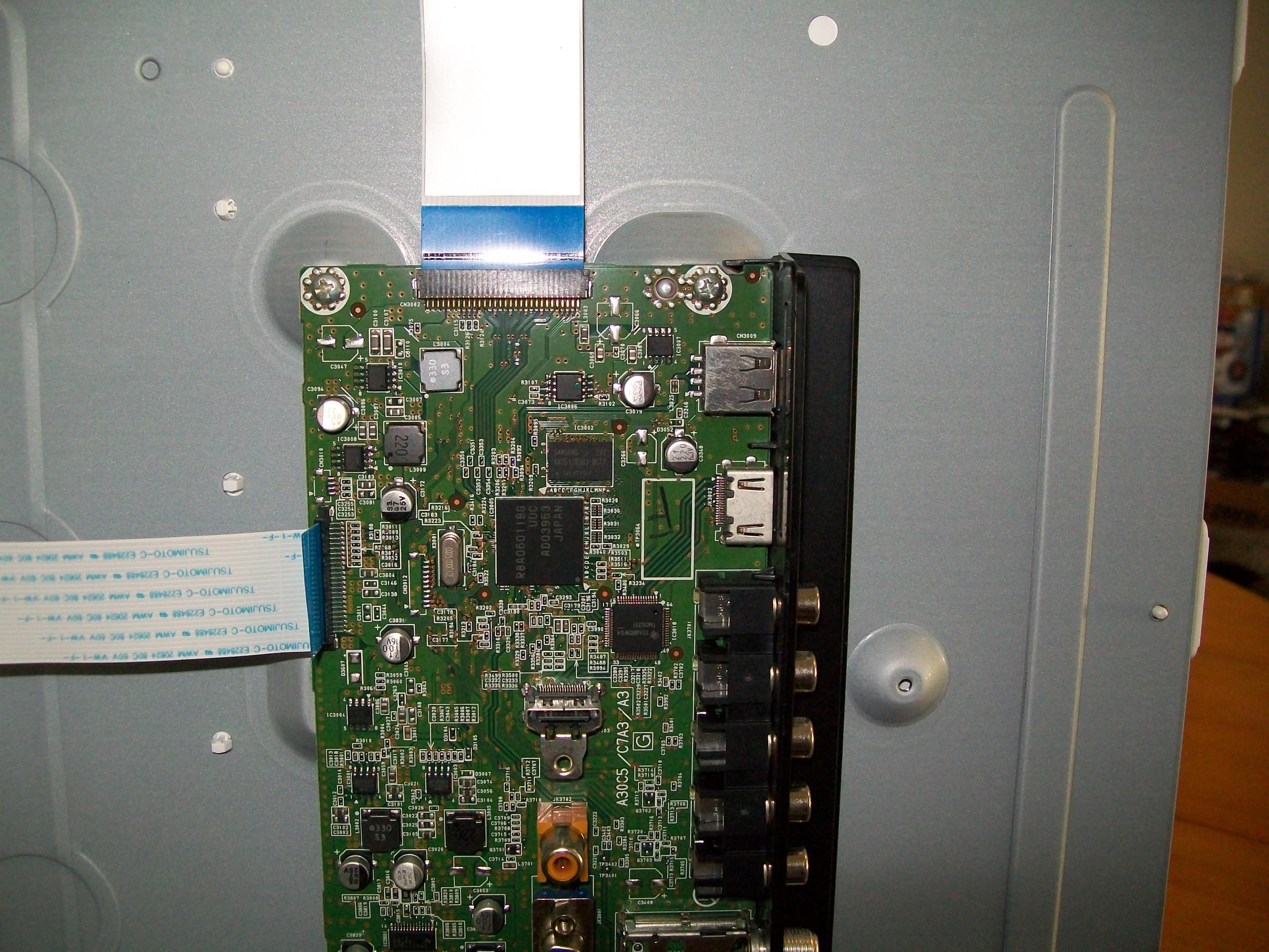

    Can we get better focused pictures of the main board, especially around the LVDS connector? There must be switch MOSFET that supplies the voltage to the T-CON when the processor send the signal to turn on that MOSFET.

      My old shaky hands aren't the best at taking pictures, but hopefully this one is fairly clear.

              Re: Emerson LC320EM2 back lights on but no picture
              I cant hardly see the numbers but the best I can tell it says
              M2305SDS
              C2456328
              MPSC17

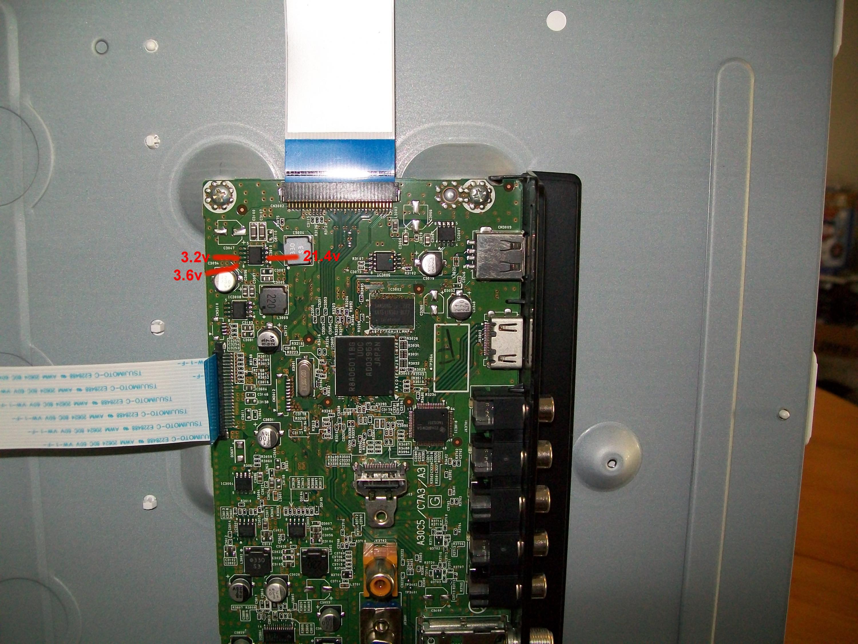

                I suspect it's an MP2305 device which is broadly similar to the MP2307. Datasheet here: http://www.ic37.com/MPS/MP2307_datasheet_5331544/
                Check pin 2 (supply voltage), pin 7 (enable voltage) and pin 8 (softstart voltage)
                Expect for working CPU but bad converter IC:
                Supply >4.7V
                Enable >2V
                Softstart > 0.925V
                Expected for bad CPU/firmware issue/other fault:
                Supply >4.7V
                Enable <1V
                Expected for PSU problem/fuse/etc:

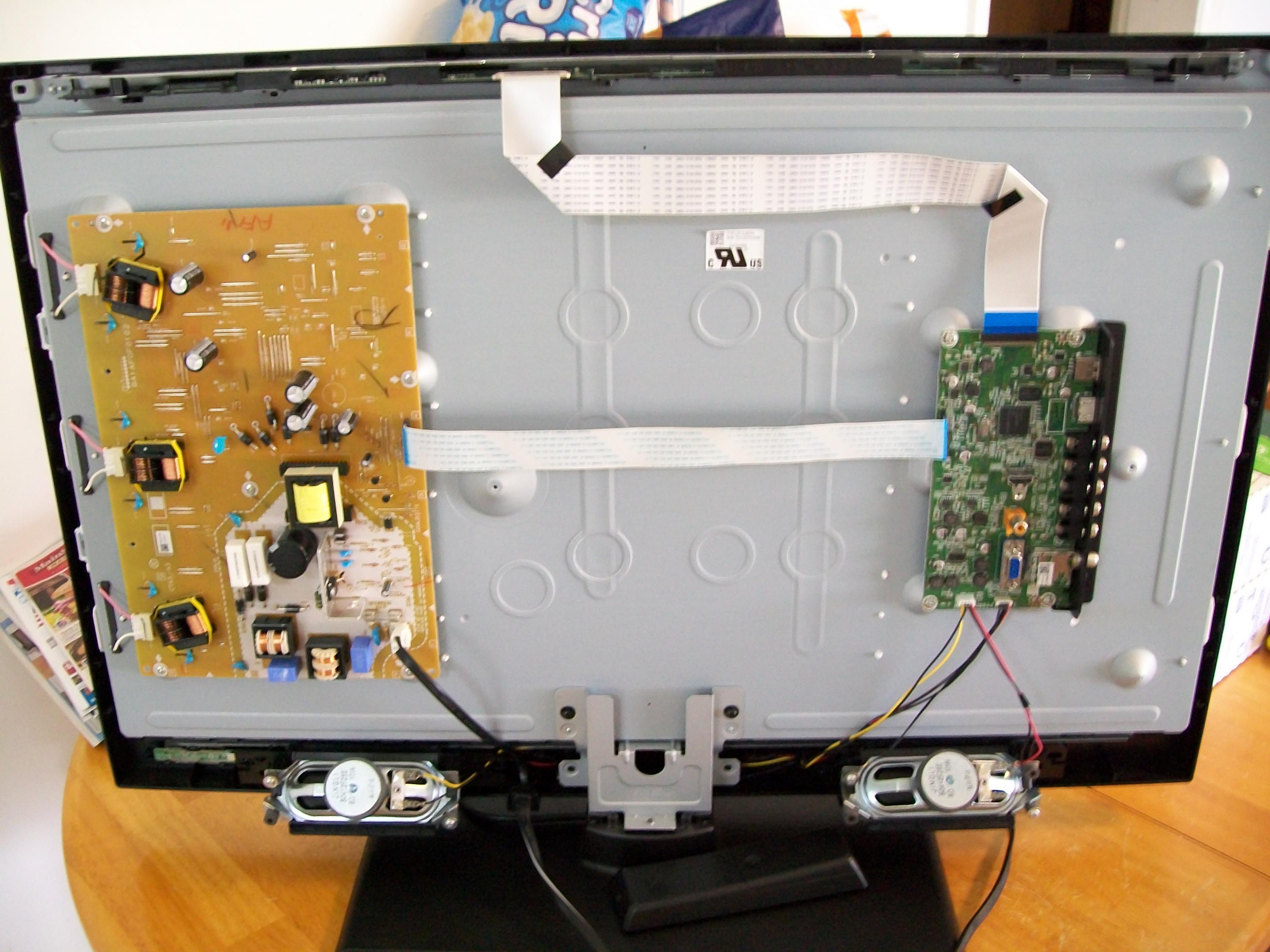

                  I am embarrassed to admit it, but I made a rookie mistake. My test lead slipped and I accidentally touched an adjoining pin and shorted the TV.
                  It didn't blow the PSU fuse but there was a squealing noise coming from the PSU. I immediately unplugged the set.
                  I unplugged the power cable going to the main board and plugged the TV back in and there was no squealing so I'm thinking the damage was done to the main board only.

                            I received my replacement main board today and unfortunately it didn't fix the TV.
                            It's back to the original problem. The TV turns on and the back lights light up, but no picture.
                            After pressing the power button the red power light blinks 19 times before the back lights turn on. Not sure if that means anything or not. I googled it and didn't find any info.
                            So I'm guessing the problem is likely the T-Con? and the TV is not repairable?
                            Any other things I could try or is my best bet just to part it out?

                                    I forgot to post the measurements of IC3010.
                                    tom66
                                    IC3010
                                    Pin 2. 21.4v
                                    Pin 7. 3.2v
                                    Pin 8. 3.6v
                                    if i measured the right pins (see pic)
