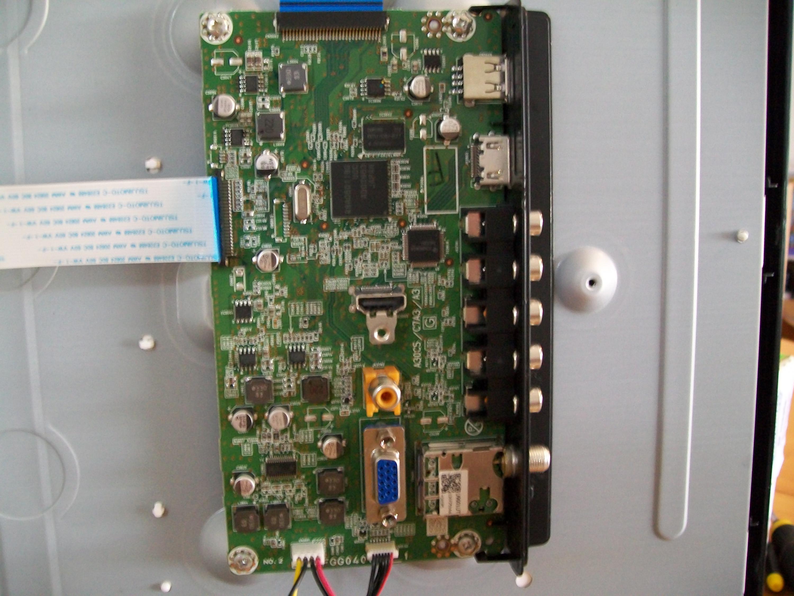

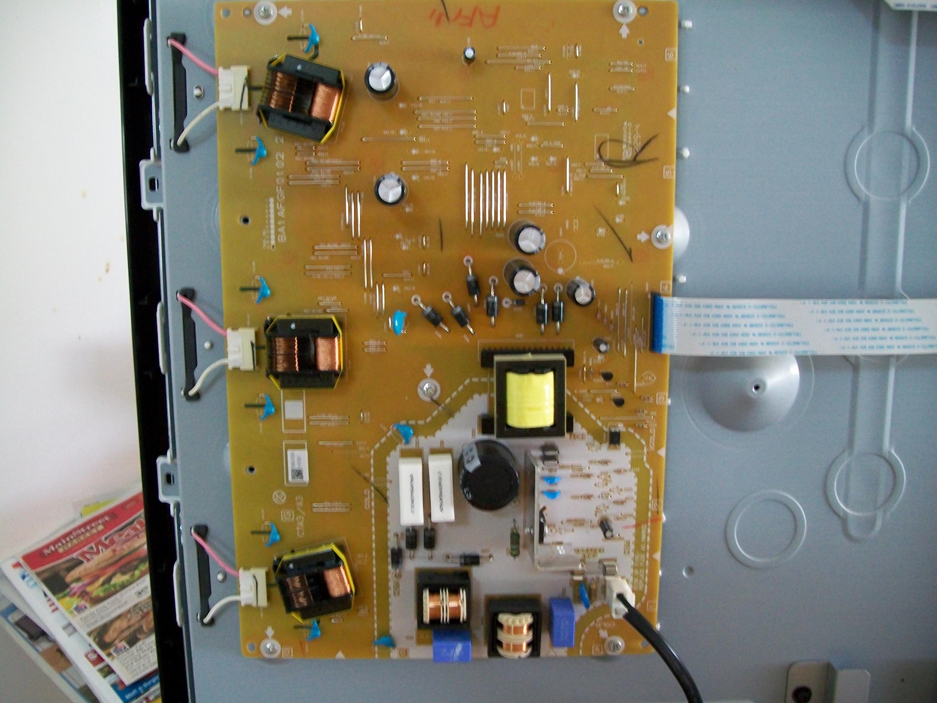

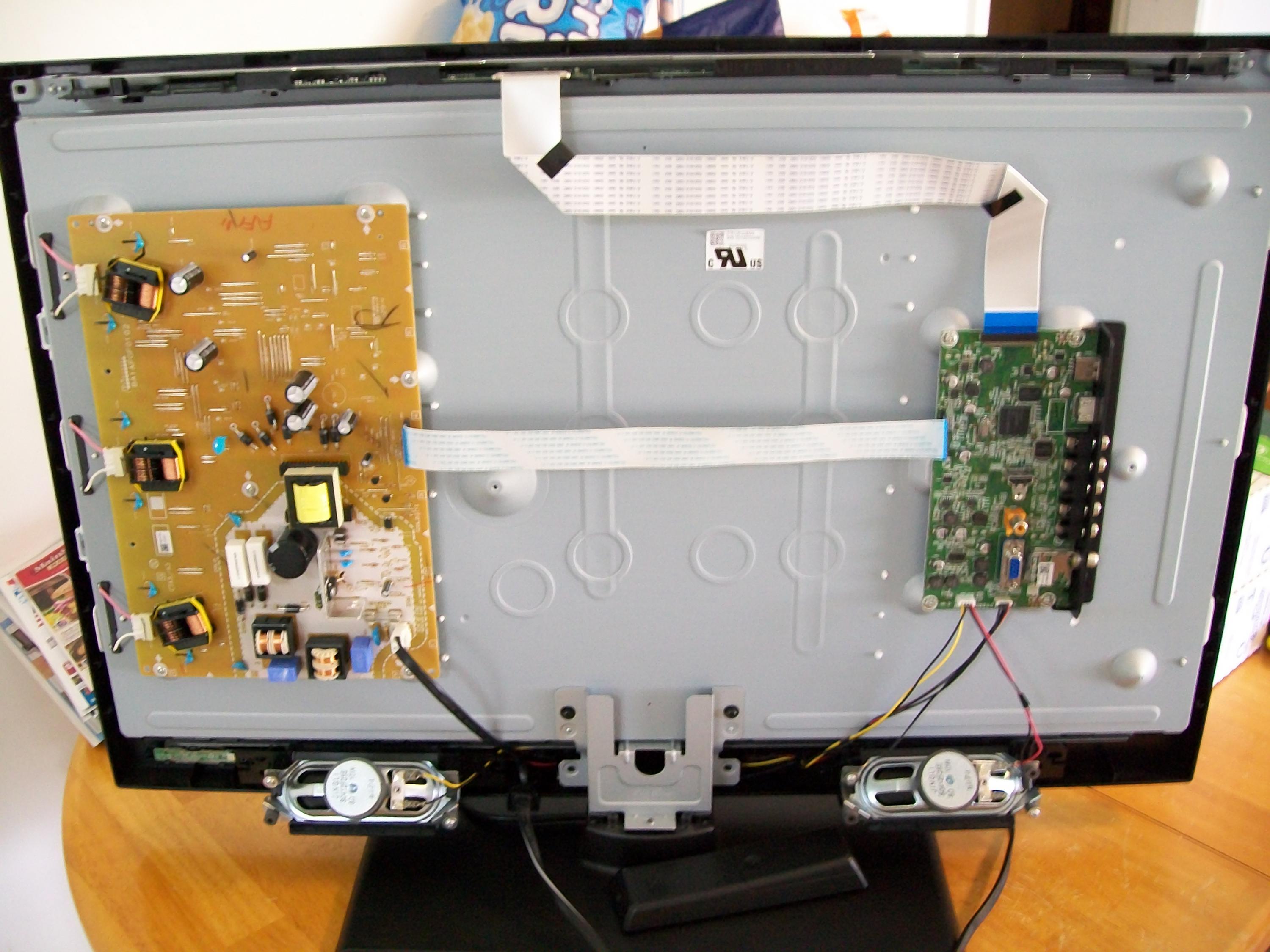

        Re: Emerson LC320EM2 back lights on but no picture
        I opened it up.
        looks like the power and inverter are on the same board and the main and t-con on the other board.
        No signs of obvious bad caps or burnt components.
        not sure what to do next.
          that's a clean layout.
          it could have done with a heatsink on the main chip though.
          did you check the connectors are in o.k. ?
            I checked the cables and made sure all were firmly seated.
            Also on the PSU I checked all the jumpers with a voltage labeled next to them. There were 3 or 4 21v jumpers and they measured right on. and I found one 3.3v that was also right on.
              • 31188
              you see that board at the top-center,
              i suspect that has a second connector on it you cant see.
              the panel connectors are not on the edge - they are on the back.
              that board probably acts as an extension cable.

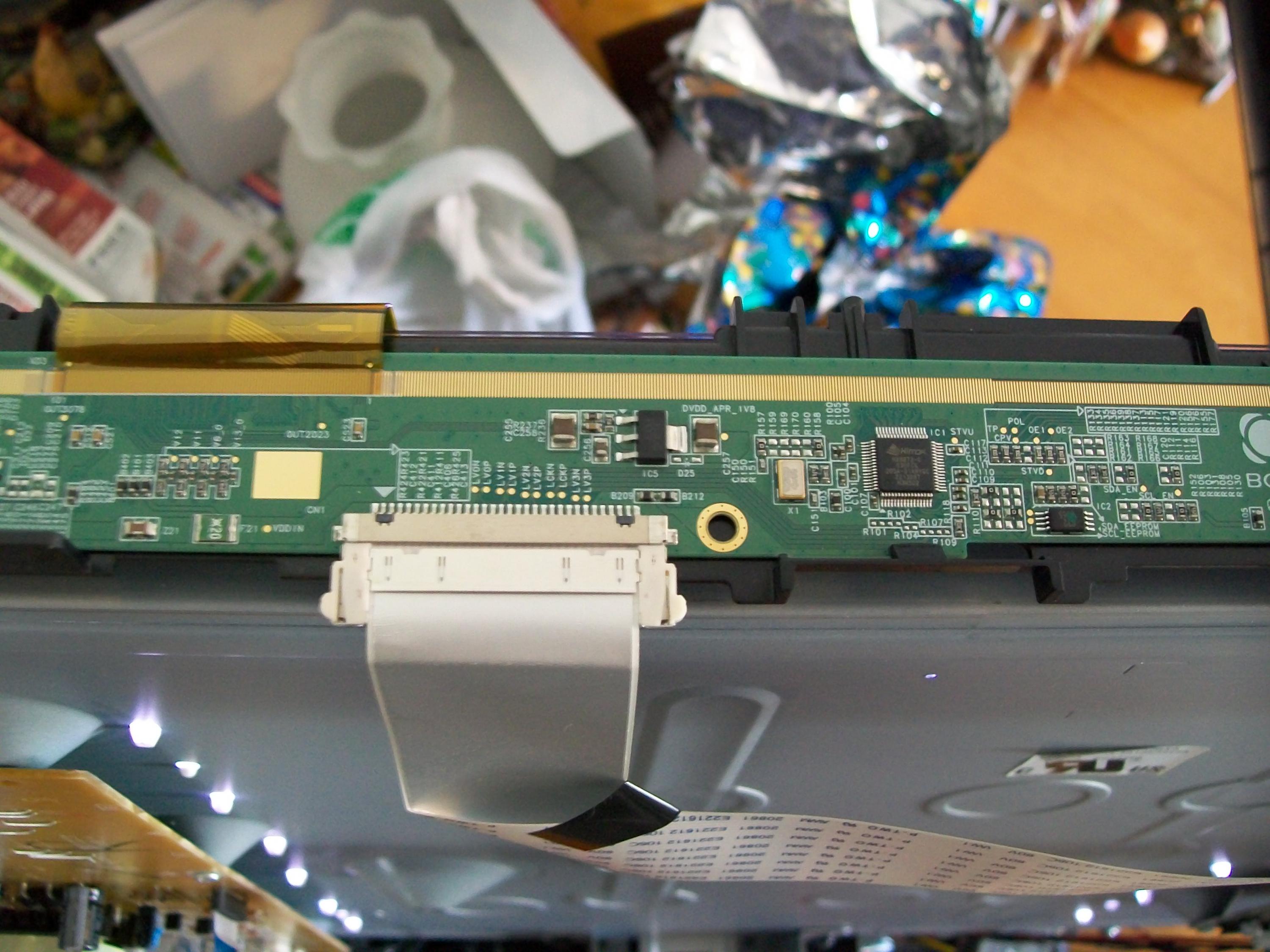

                i don't see any other connectors just by looking but i also haven't disassembled the metal frame yet either.
                Do u think the issue is with the main/t-con combo board?
                thanks

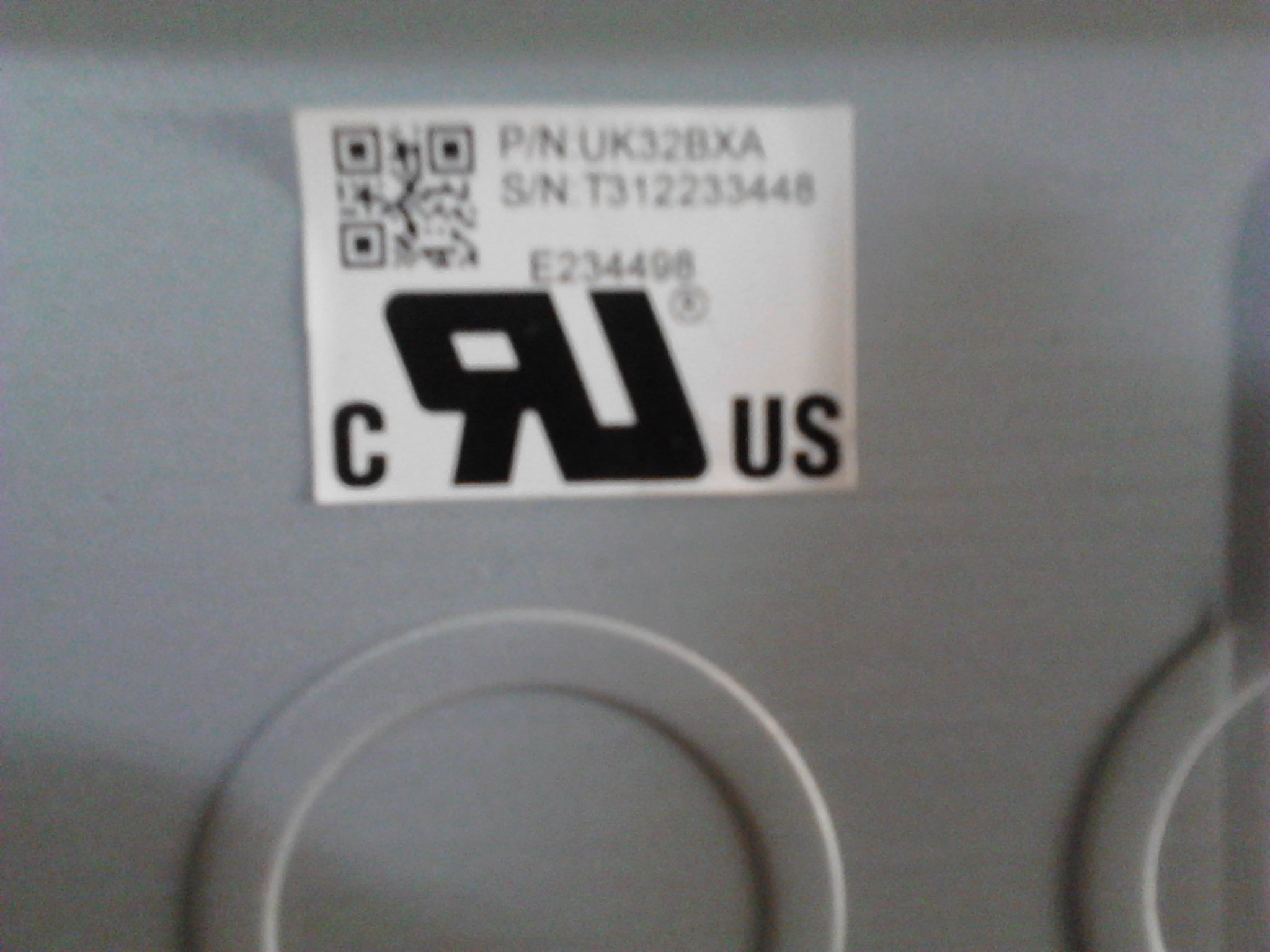

                  OK, this LCD panel may have integrated T-CON or T-CON is integrated into the main board.
                  Can you see the LCD panel number sticker? I need it so I look up the spec sheet of this panel.
                  I can seven LVDS pairs on the main board.
                    I can only find one sticker on the back of the panel and if I'm reading it right I think it is P/N UK32BXA
                      If the t-con is integrated into that top board does that means the TV is likely not fixable?
                        That is correct. So far no info about this LCD panel UK32BXA.
                            That power board is worth at least 40$ on ebay. Its a bit of a hassle but it would get your money back

                                I was tinkering some more with this TV and decided to take the metal frame off and get a look at the board that the LVDS cable attaches to.
                                There is what appears to be a voltage regulator at location IC5 in the pic.
                                It has 1117 written on it.
                                I tested it with the TV powered on and got the following readings 0.01, 0.04, and 0.72.
                                Does that sound like its ok?
                                Are there any fuses or other things I could check on this board?
                                thanks
                                  So it does have T-CON on the panel, the fuse is the SMD green fuse on the left of the connector (CN1) with 20 printed on top (F21? marking on the board). There is also small copper pad with 'VDD IN' for incoming voltage test point.
