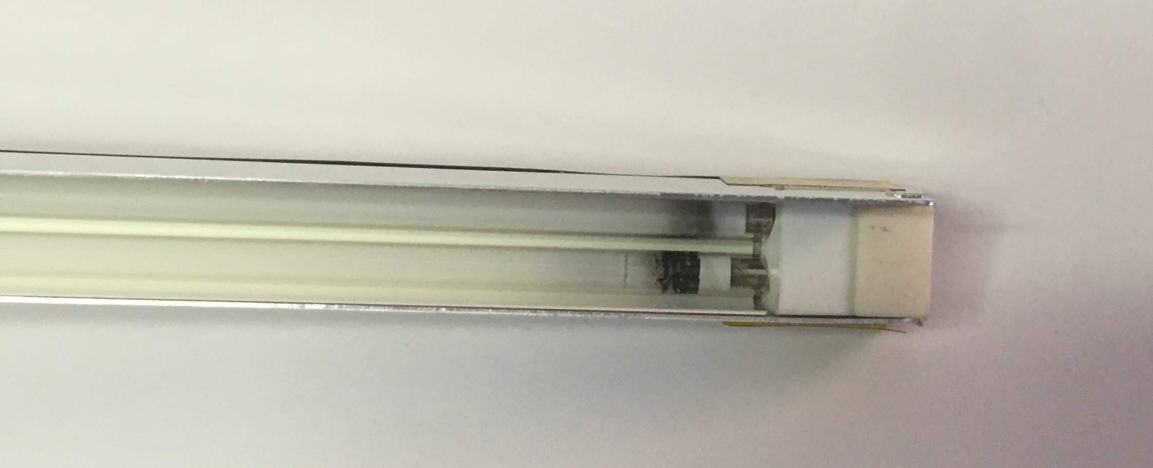

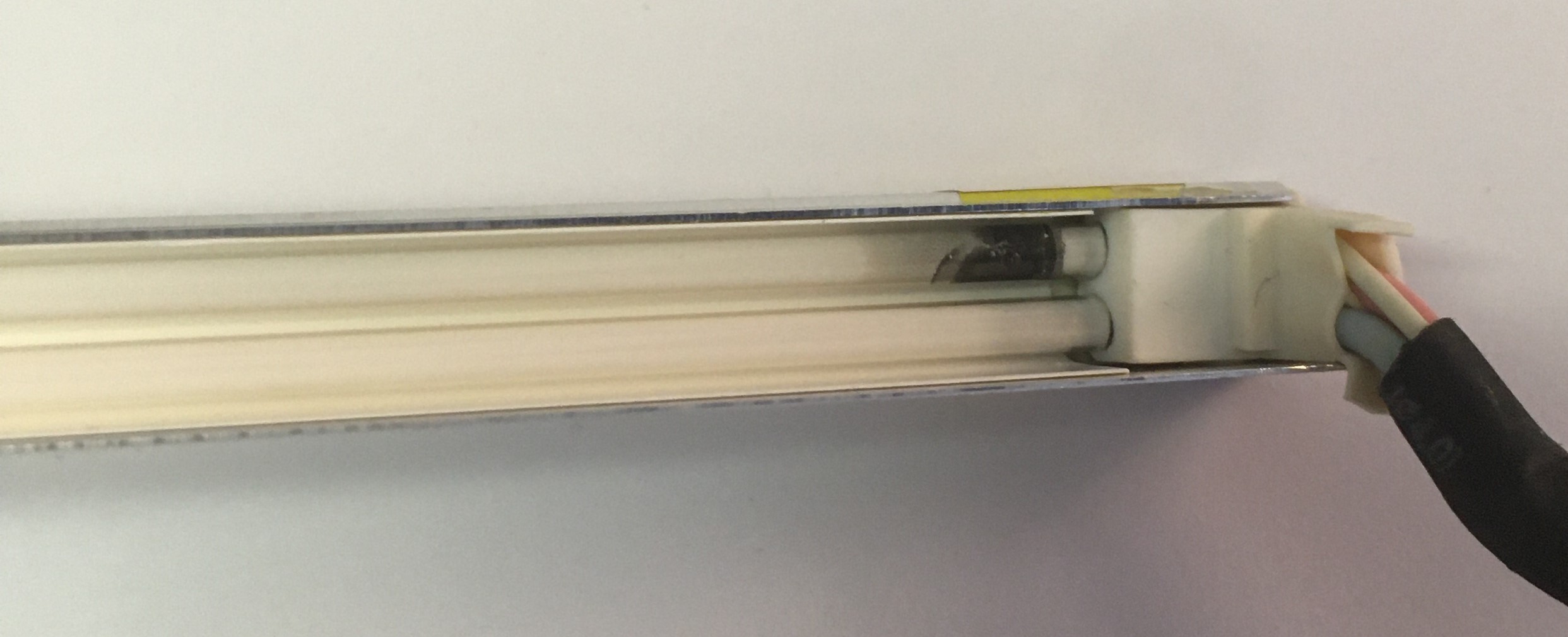

          • valvashon
            • Oct 2020
            • 90
ID:	3545048 Click image for larger version
ID:	3545049 Here's a sample of what I found on the CCFL's. This is the top assembly, I've already taken the bottom assembly apart to measure them and they looked about the same. The size I need is on sale for $5 each at CCFL warehouse so this is affordable even though I won't see a return on investment. I've got about $30 into it and will be lucky to sell it for $10 if I don't have to give it away. With new caps and new CCFL's it will probably last forever.

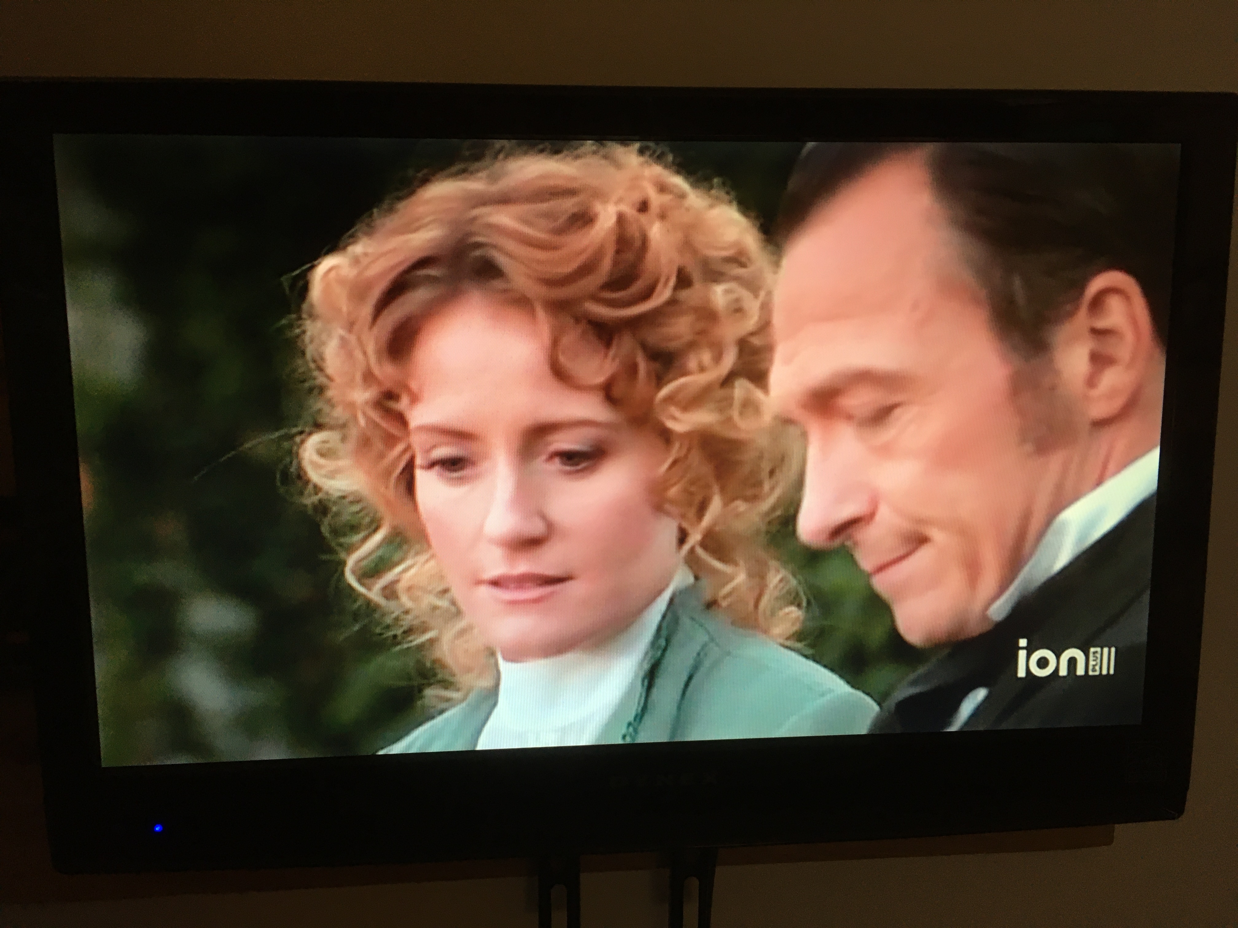

              Finally put this TV back together- they don't make it easy to change out CCFL's do they? This set was significantly more difficult than the Vizio I did a few years ago. Here's what it looks like at startup, you can see some of what I believe is called the halo effect at the top and bottom of the screen (it's currently subbing in for my 50" Samsung which explains the overly large mount):
              Click image for larger version  Name:	IMG_6232.jpg Views:	0 Size:	1.39 MB ID:	3561239
              When there's a picture on the screen it's really not too objectionable. Not sure if this set had this problem originally as it never actually turned on during my time of ownership. This is from the show "Murdoch Mysteries". You can barely see the halo:
              Click image for larger version  Name:	IMG_6231.jpg Views:	0 Size:	2.34 MB ID:	3561240
              Will see if the original owner wants it back, otherwise away it goes!
