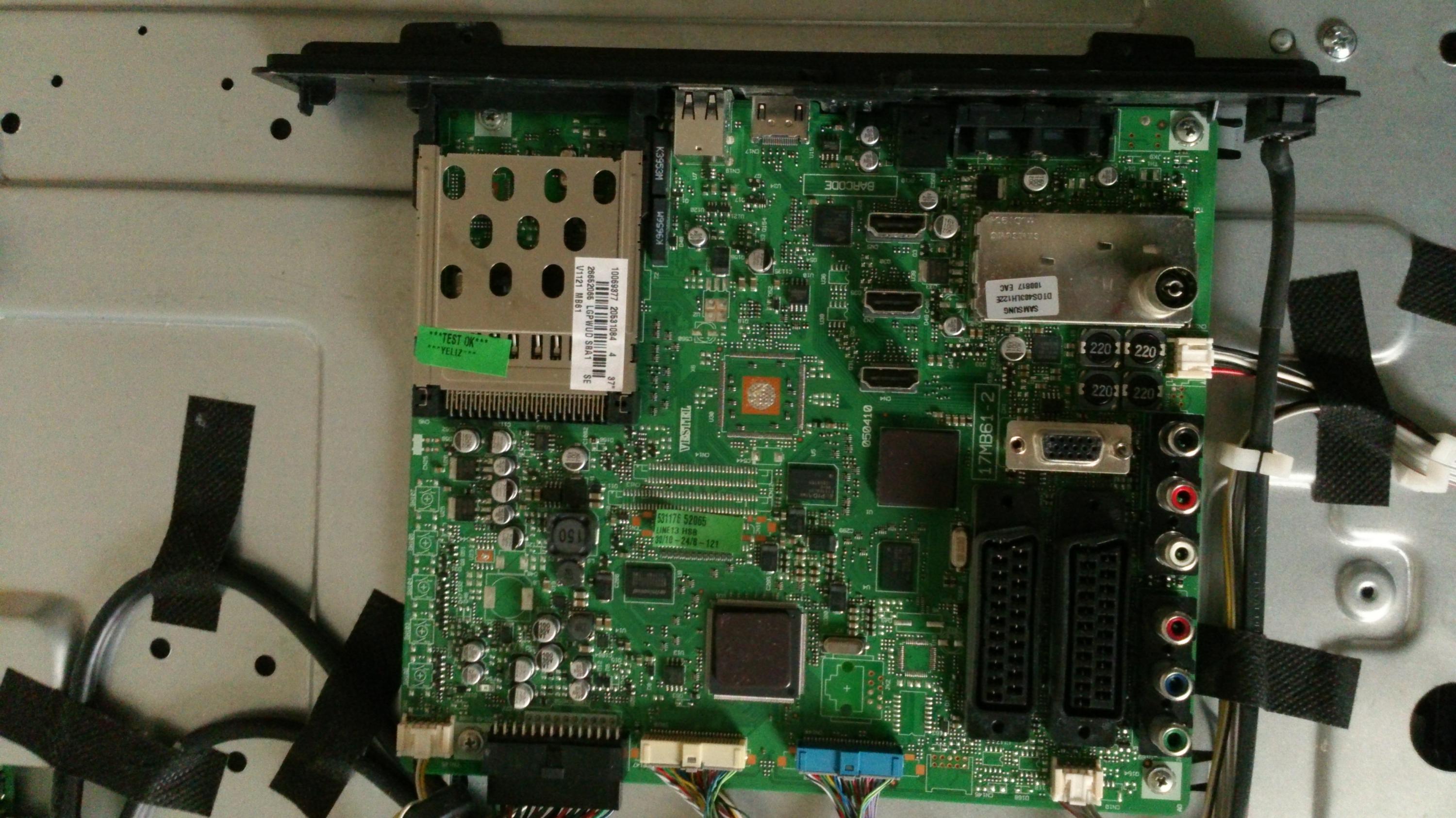

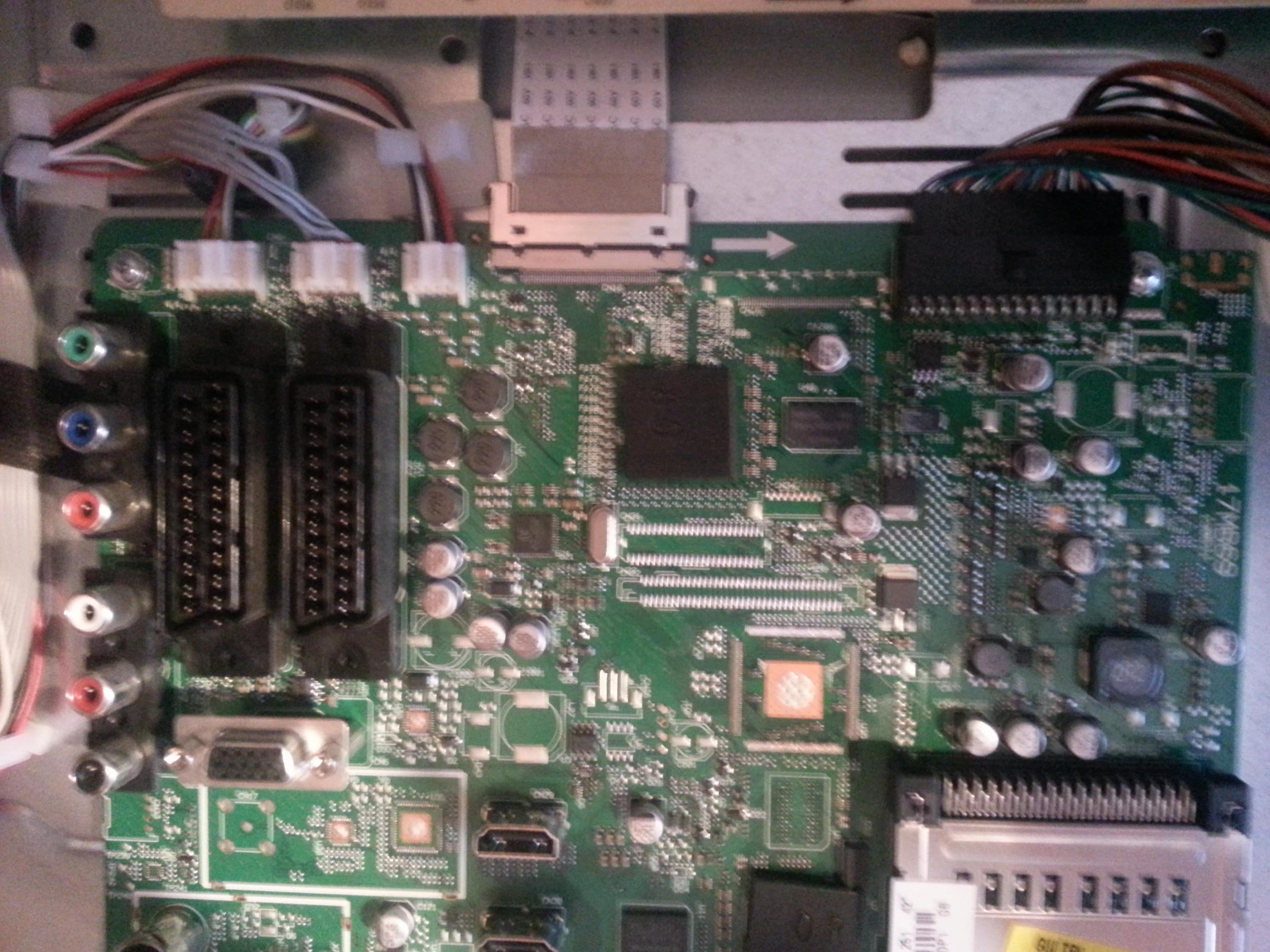

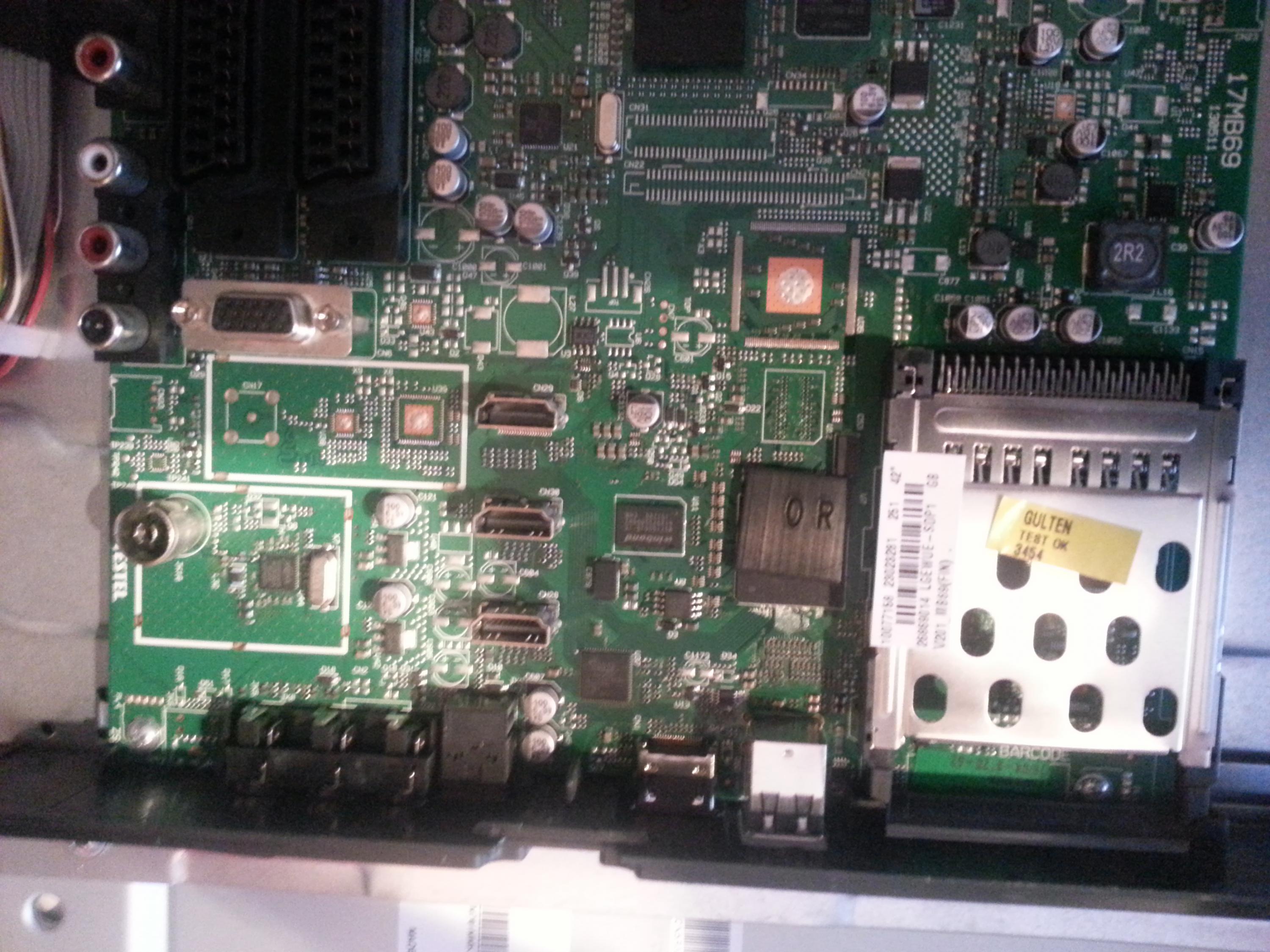

              so maybe posting some clear pictures of the boards with the back off the tv may help you more with fixing your problem
                Re: finlux (vestel) 42f701 3d lcd backlight but no picture
                These are all I have for now, I can take more when I get home.

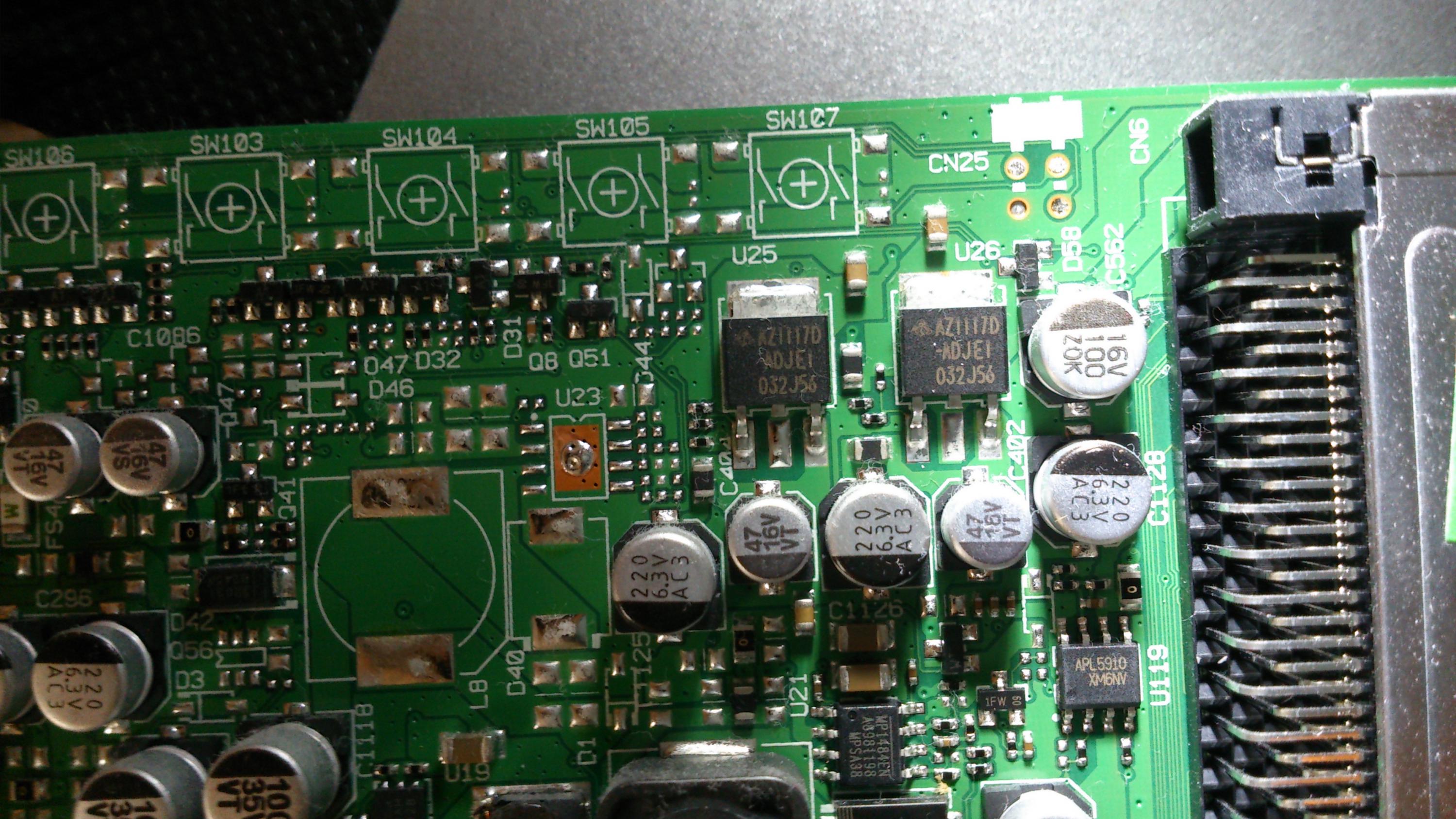

                  So, I measured 4 large voltage regulators on the mainboard, and they all raised the input voltage by 1.25v as expected. This tells me two things: they are not faulty, and the MB is at least supplied some voltage.
                  I would love some feedback on how to measure the psu voltages while the system is on, and on what voltages to expect!

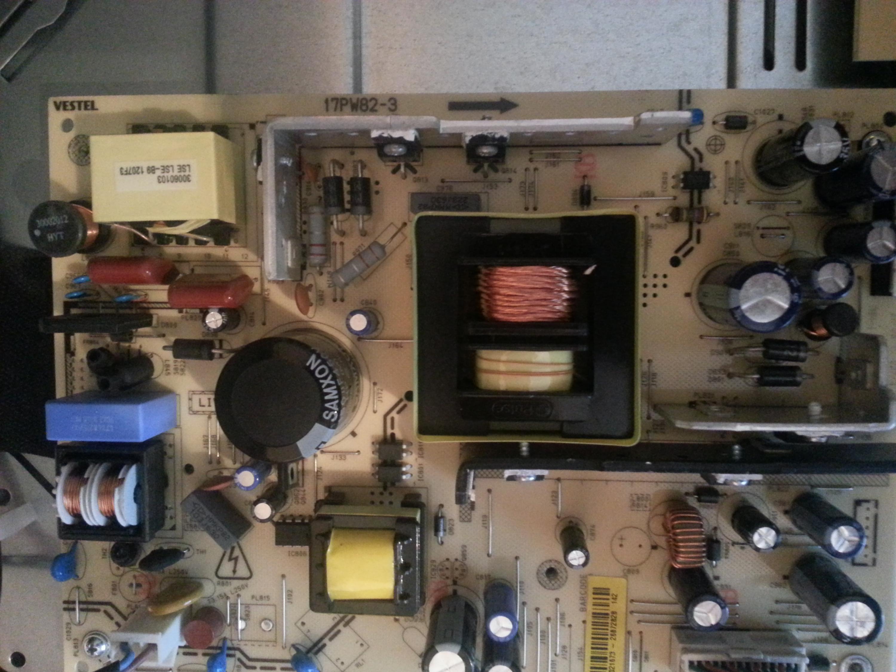

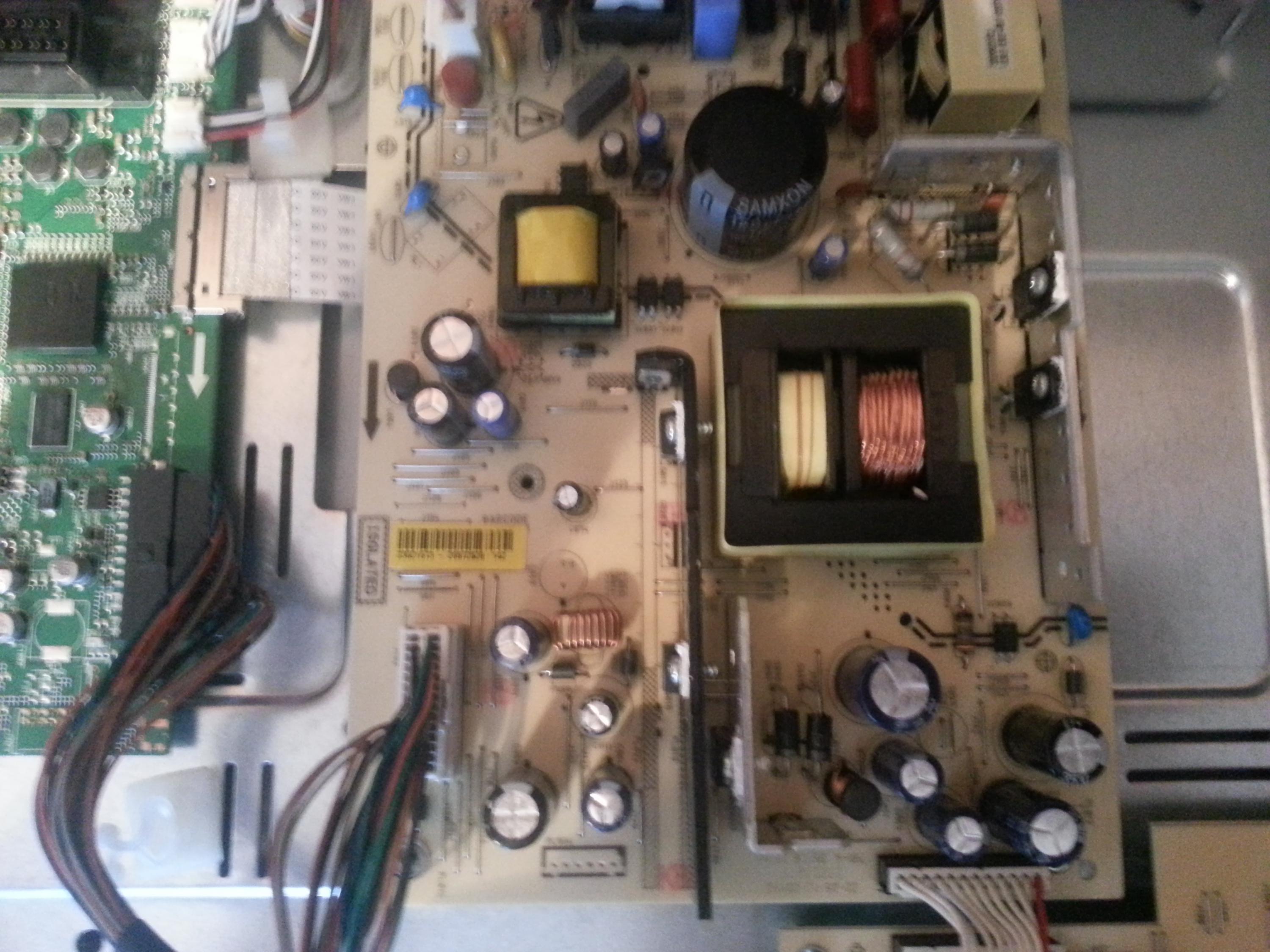

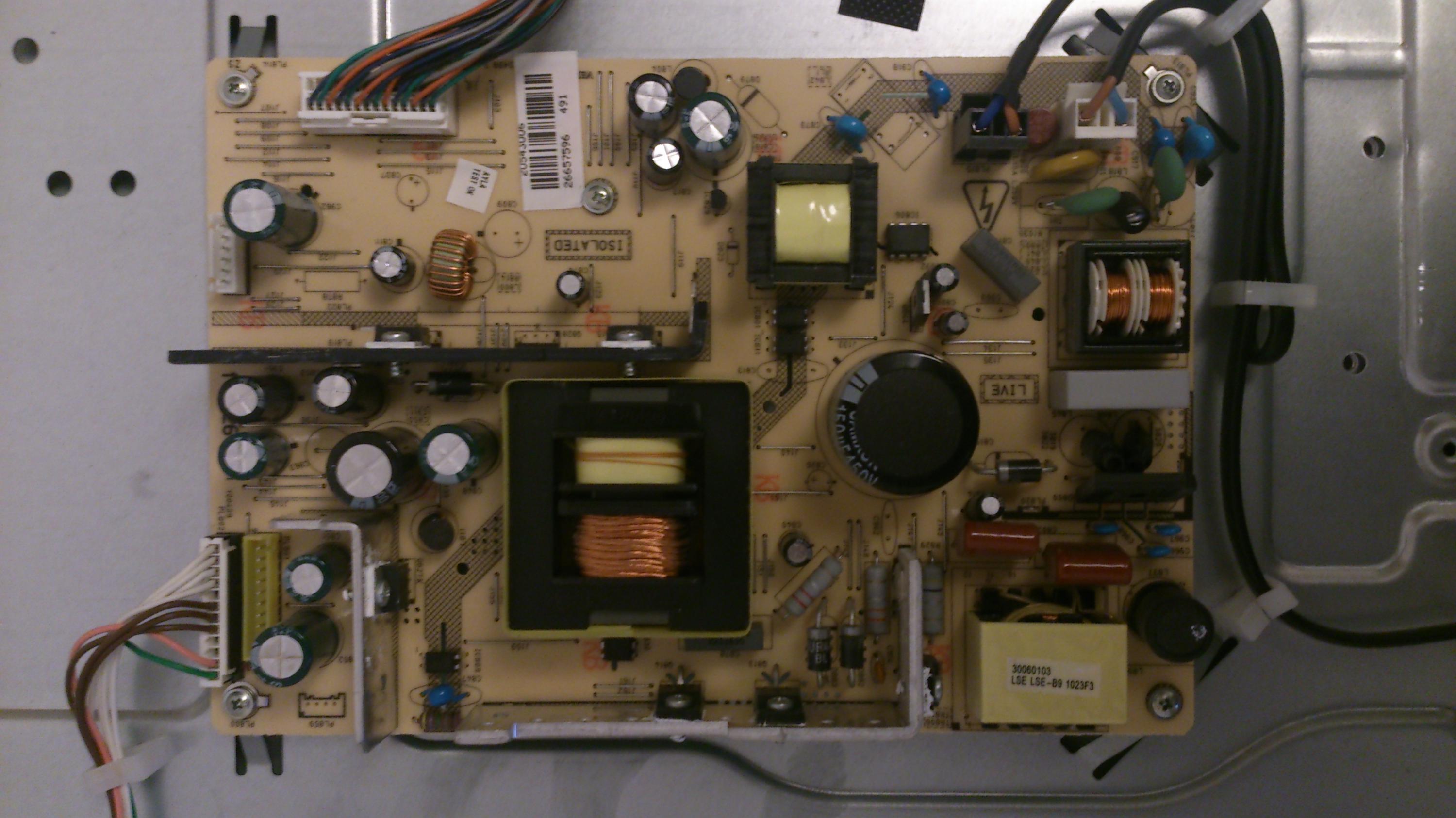

                  Picture of PSU attatched.
                    Is it a 17PW26 PSU?
                    http://www.toms-service-manuals.com/...h=Submit+Query
                      Yes it is, thanks for the link! Will do measurements tomorrow. Is the metal case under the board a suitable ground?
                        yes black probe to chassis red probe to measure

                              Ok, on to voltages:
                              3.3v and 5v standby are fine.
                              24v and 5v also.
                              3.3 on measures as 3.2 and 12 v on measures as 11.9. Could there be something wrong with the inverter board? I suppose that it is this thing at the top of the tv (attatched). What should i look for?
                              But I am not sure how this would explain that the tv in unresponsive to the remote and the buttons once it is powerd on...

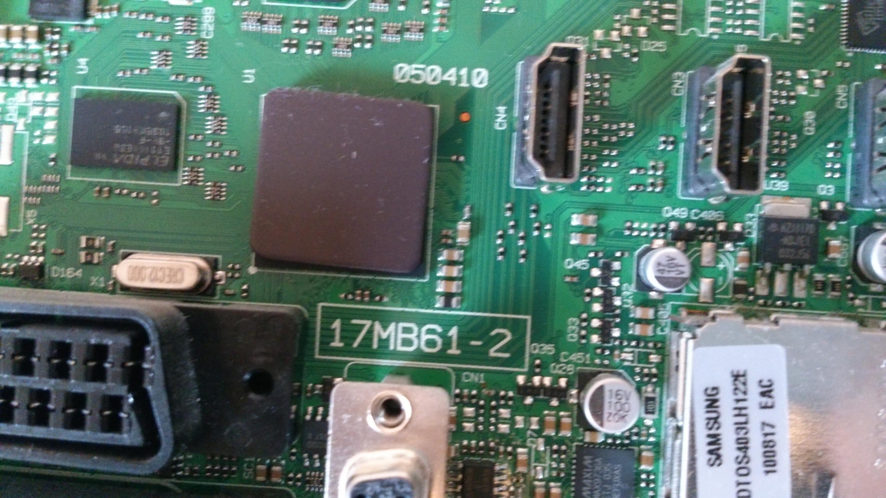

                                could also be a main board issue too i guess whats the part number/sticker number on the main board?
                                  The model is 17MB61-2, do you need more than that? There are some other stickers with numbers, there is a picture higher up in this thread, and two posts up from that is a full problem description. The main board is alive enougth to create files and folders on a usb drive though.

                                      I have measured all the incoming voltages from the psu, and they seem right. The tv makes a "BEEP" when you press one of the buttons on the side, but it is otherwise unresponsive to them.

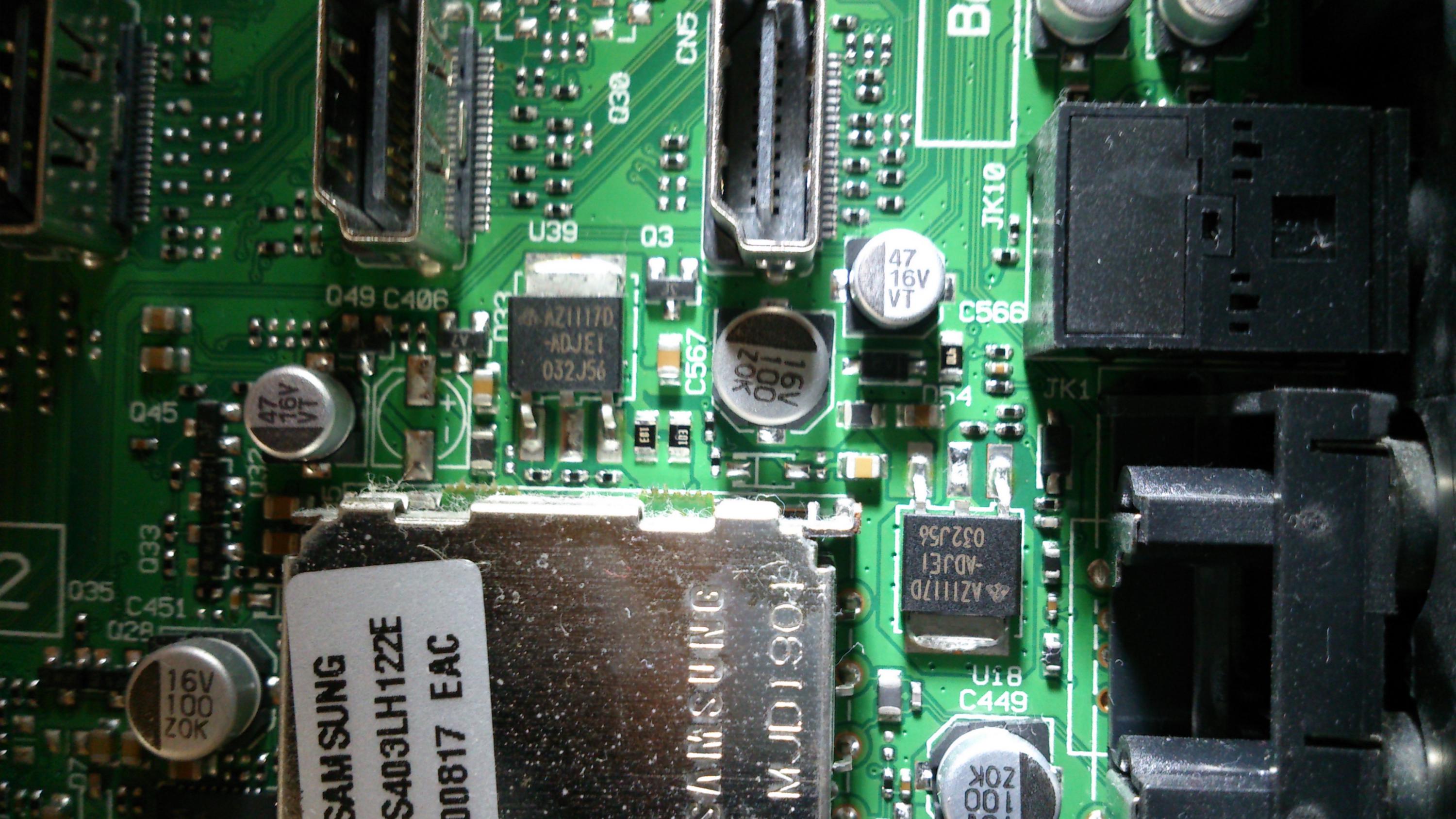

                                      I have also measured the 4 large voltage regulators on the MB and they all raise the input voltage by 1.25v as expected. I am not sure how to know if these input voltages are ok, though.
                                      EDIT: found them in the diagram, will measure again soon.

                                        U39, U18, U25 and U26 all output the correct voltages. I seem unable to find anything wrong with this tv. Could it be software-related?
