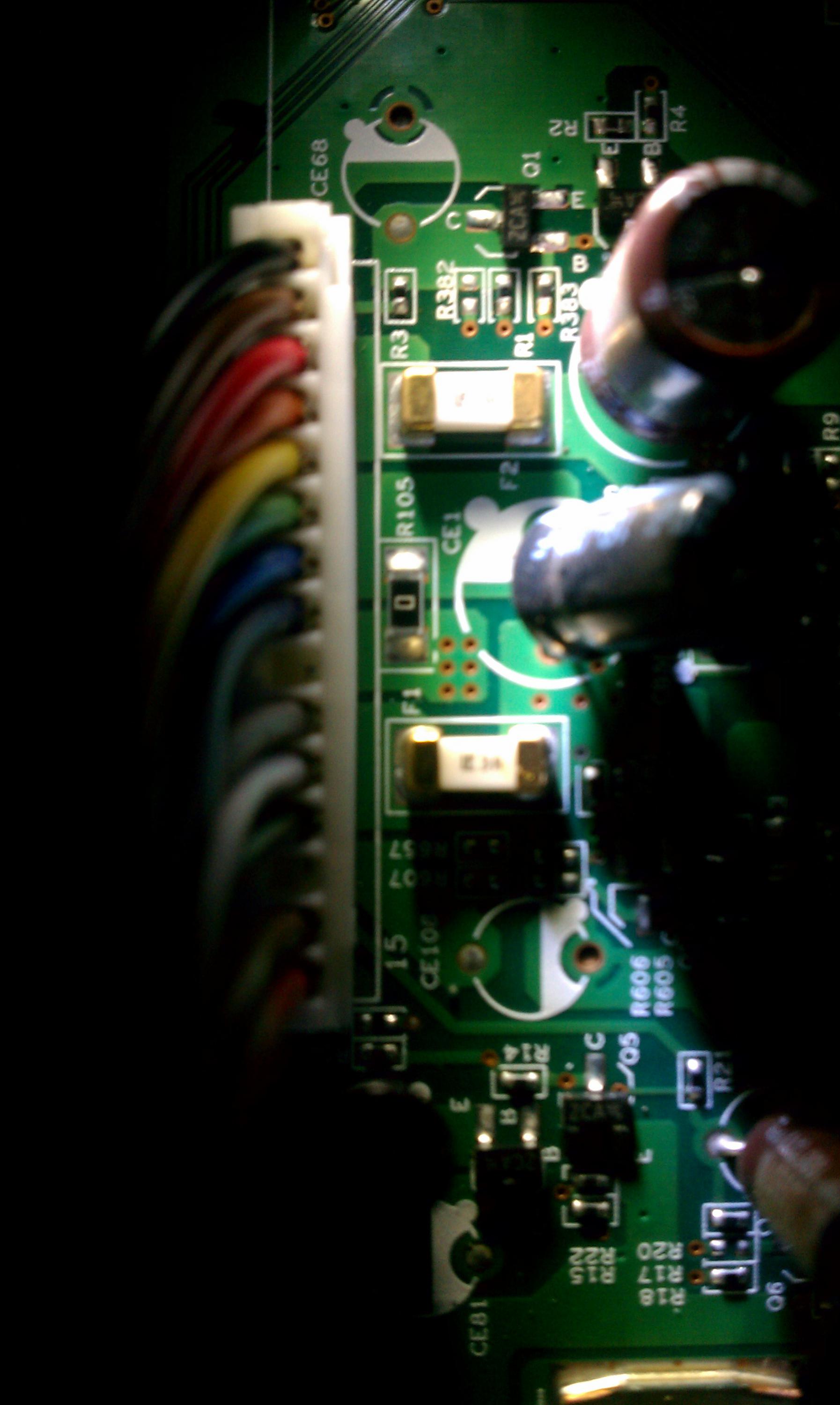

ugh i totally messed up while i was testing the last regulator... my probe slipped and i think i touched pin1 to pin2 i had measured pin1 at 12v
and then i was going to measure pin2 and the probe slipped... i had the n64 still hooked up so i could hear the sound of mario kart. as soon as i made this mistake, the sound disapeared. i flipped up the tv and noticed the backlight was off. oh no i fried it! so i turned it off and back on again and the backlight came back on but the sound did not.
checking the regulators again i noticed that now i was getting all zeros on the one that was previously 12v... and of the other regulators i tested one of them was also 12v. all the rest are only 5v input. both of the regulators handling the 12v input are now reading 0 from all pins. all the other regulators still have the same readings. so basically i just lost 12v power to the motherboard. i checked the fuse by the power cable to the motherboard (or from it?) and it had no voltage. i unplugged everything and tested continuity, and yep the fuse is blown. the other fuze for the 5v is still fine.
please tell me all i did was blow a fuse, and that its easy to change?? ill upload a picture of the fuse. it doesnt look easy to change
i guess i should list all the voltages i found before i messed up. according to the math they all checked out good. and on the last one i guess i was expecting to read a 13.25 volt output but whoops!

There are small white fuses on the main board. I circled them in red on the attached pic. Check them for continuity.Attached Filesif you find these attachements useful please consider making a small donation to the site
Re: VIZIO V037L FHDTV20A powers up, backlight on, sound works, buttons work, no pict
heres the fuses. the top one says Lf 5A and the bottom one says Lf 3A
the top one (5 amp) is blown and has no continuity.
please help!

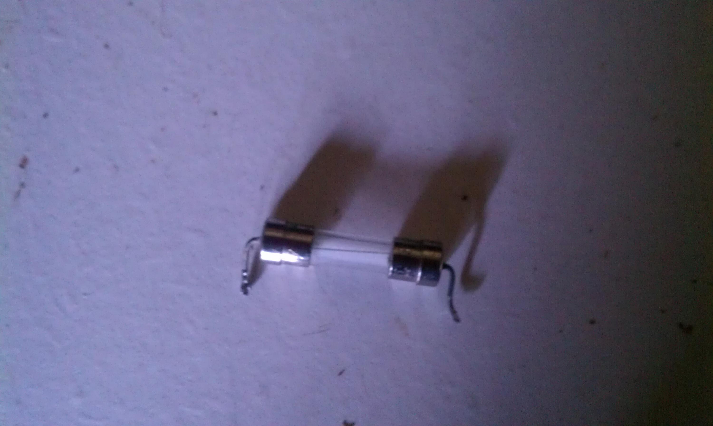

ive got one here that says F5AL250V
i pulled it out of a dead PC power supply a few days ago.
does the 5A in there mean 5 amps?Attached Filesif you find these attachements useful please consider making a small donation to the site

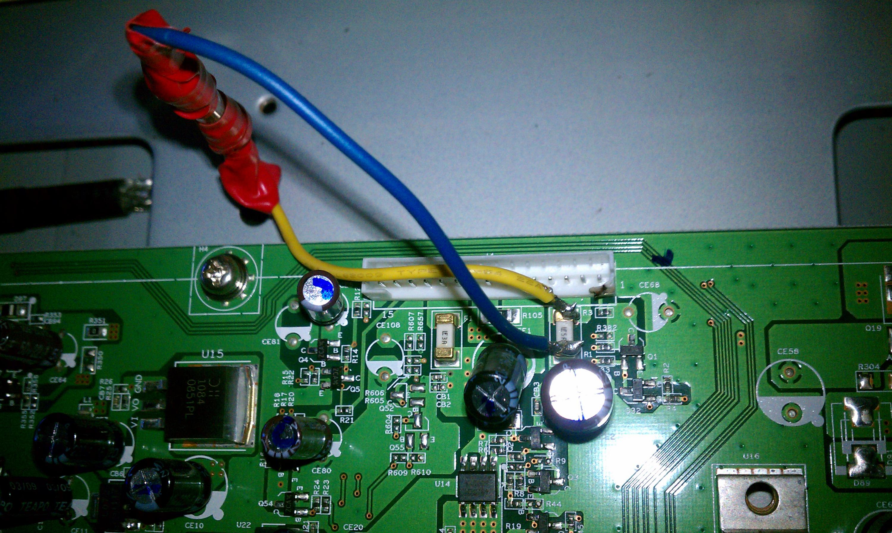

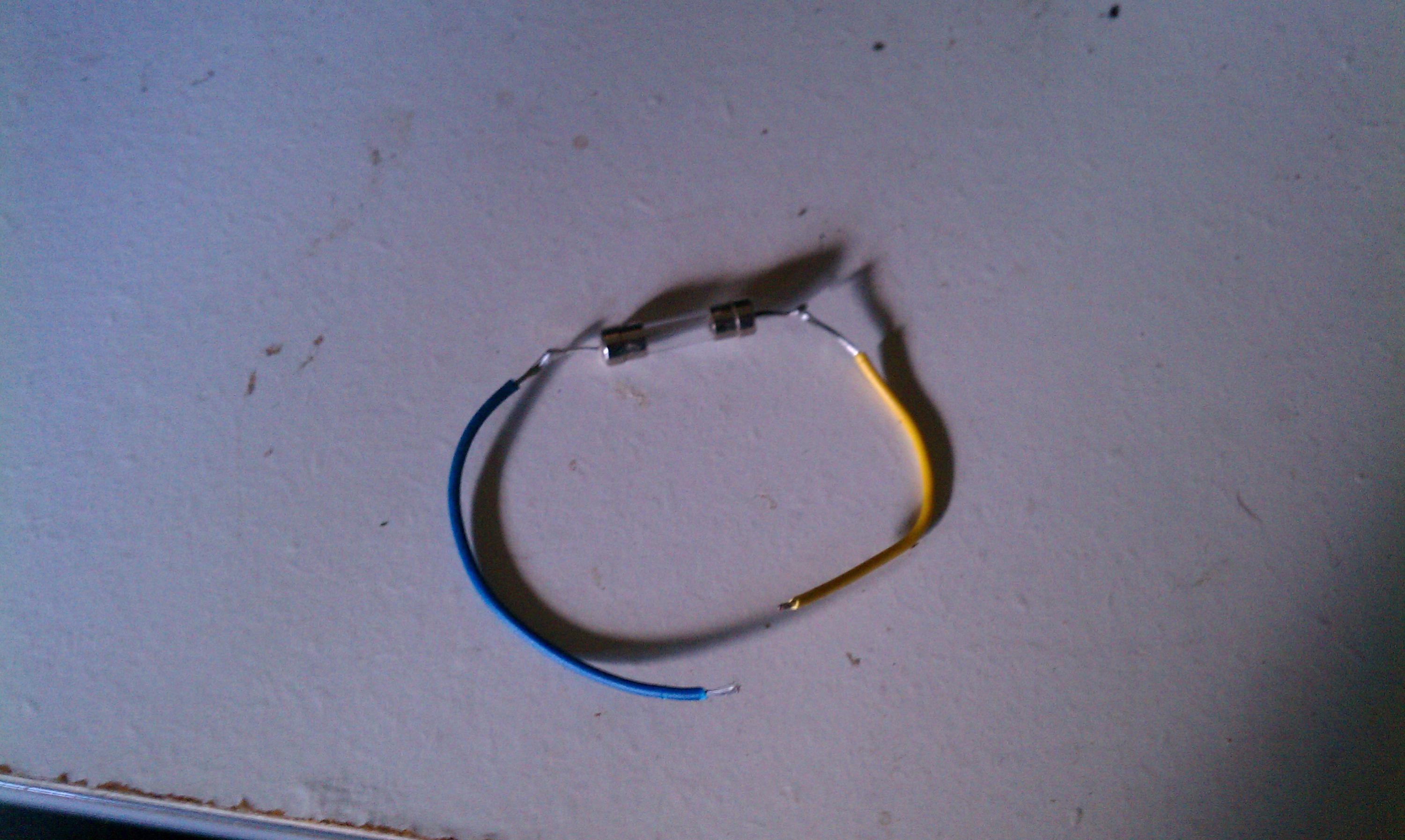

its actually not a ceramic one but it was not an easily removable one... so do i just solder wires to both ends and solder them to both ends of the blown fuse and call it good pretend it is?Don't fear the repair...Comment
Yes, you can use it. Just solder small wires long enough to its end to allow you to solder the wires to the ends of the blown fuse, no need to remove the blown fuse, just tape up the fuse so you will not have another accident.Never stop learning
ok just want to make sure this is what you meant before i go ahead and turn it on again...Attached Filesif you find these attachements useful please consider making a small donation to the site
i burned some of the plastic on the clip for the power supply...but i think it will be ok... and im pretty sure im not touching anything else with the solder...Don't fear the repair...Comment
That will do for now.Never stop learning

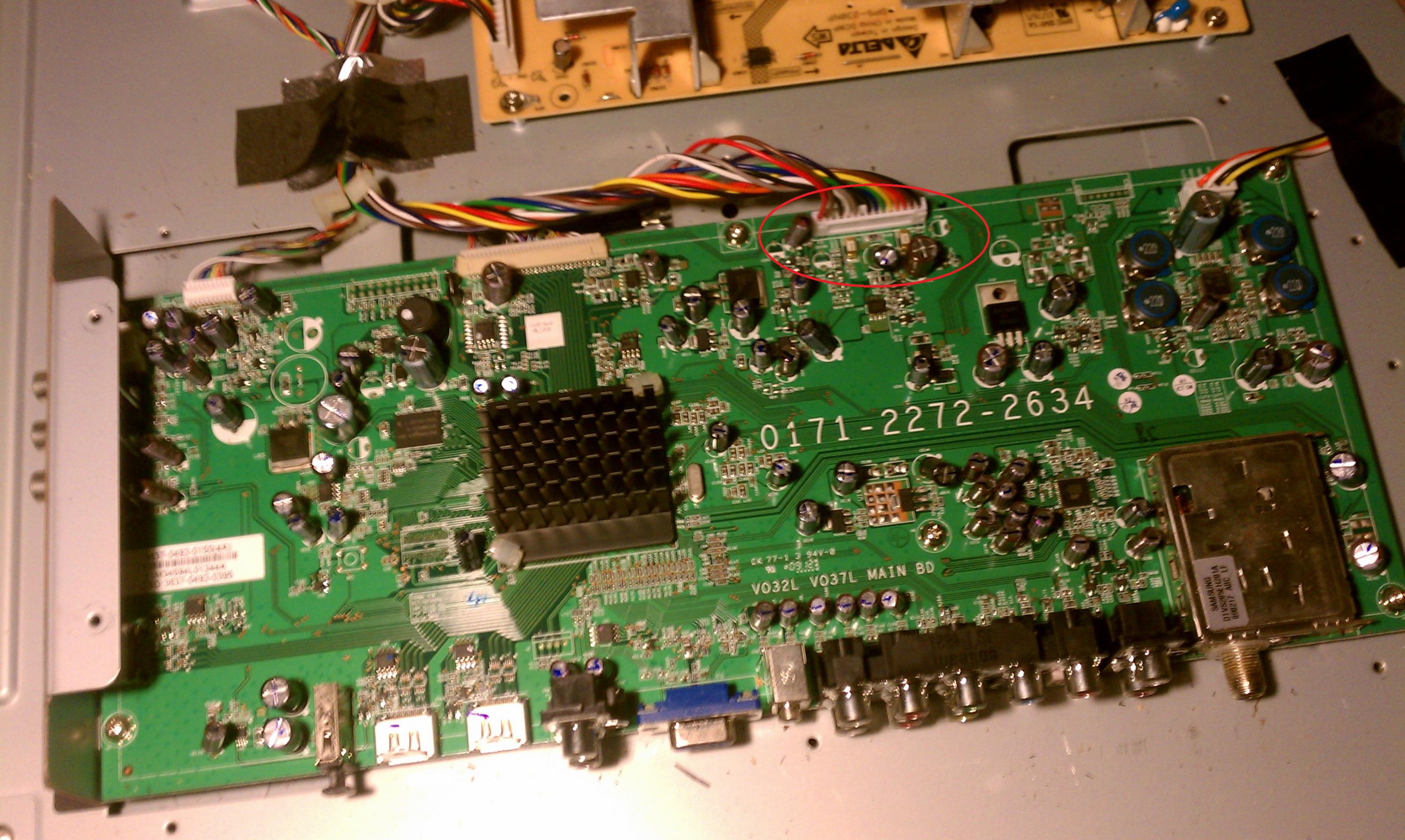

ok the fuse worked. both 12v regulators are back online. the one i didnt get to test earlier reads 12 on pin 1 , 0 on pin 2, and 5 on pin 3... thats how it should be, right?
i didnt get sound back yet but its because my n64 is messing up now! i need a more reliable a/v source for this test...Don't fear the repair...Comment
ok awesome i got sound again still no picture tho... (but why would i? i havent fixed anything yet!)Don't fear the repair...Comment
