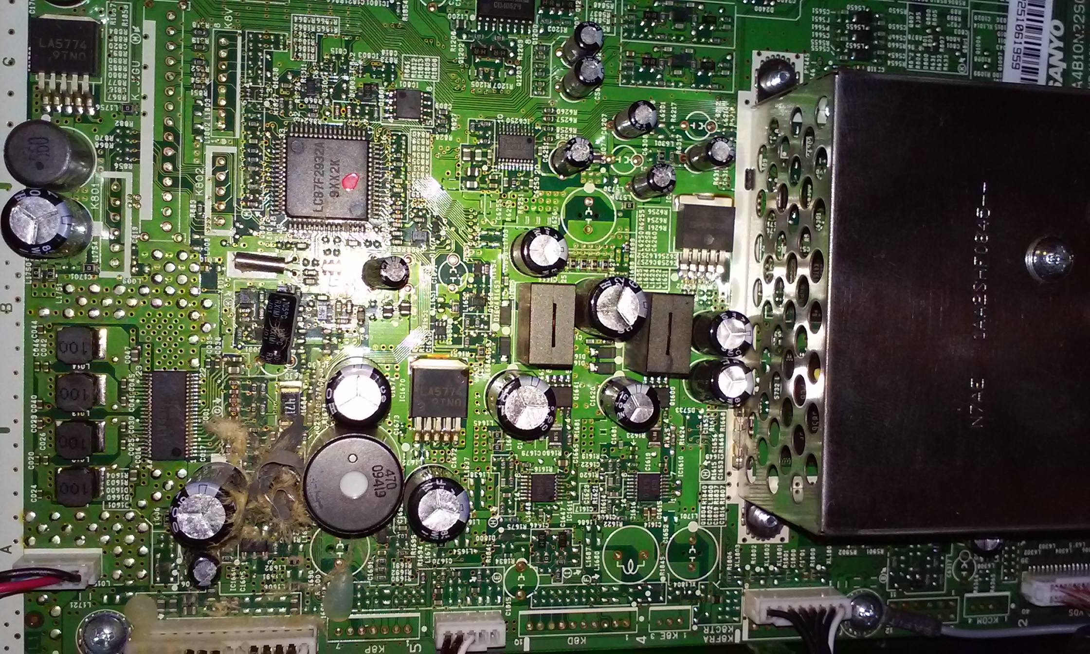

    Sanyo dp42840 cap exploded
    3rd tv from lot i plugged it in and a loud pop came from it then a smell i took off back cover and a cap top fell down i found the rest on the main board. what would make a cap explode like this on power up?
    • 31294
    Re: Sanyo dp42840 cap exploded
    shorted rectifier or diode is a good place to start looking.
    it can just happen - but it's very rare.
    nice foto - cap was so crap that it blew it's bung instead of the top vent!
    i'd check if it's in parallel with the one next to it.
    and if the sleeve is intact - read the voltage & compare it to what's coming out of the board.

          well the issue is 1 cap is completely gone exploded that's all the paper stuff u see so i cannot identify it but the 1 that blew was smal. there are a bunch of other small ones on the board but different uf's and voltages so im in the dark here without a diagram

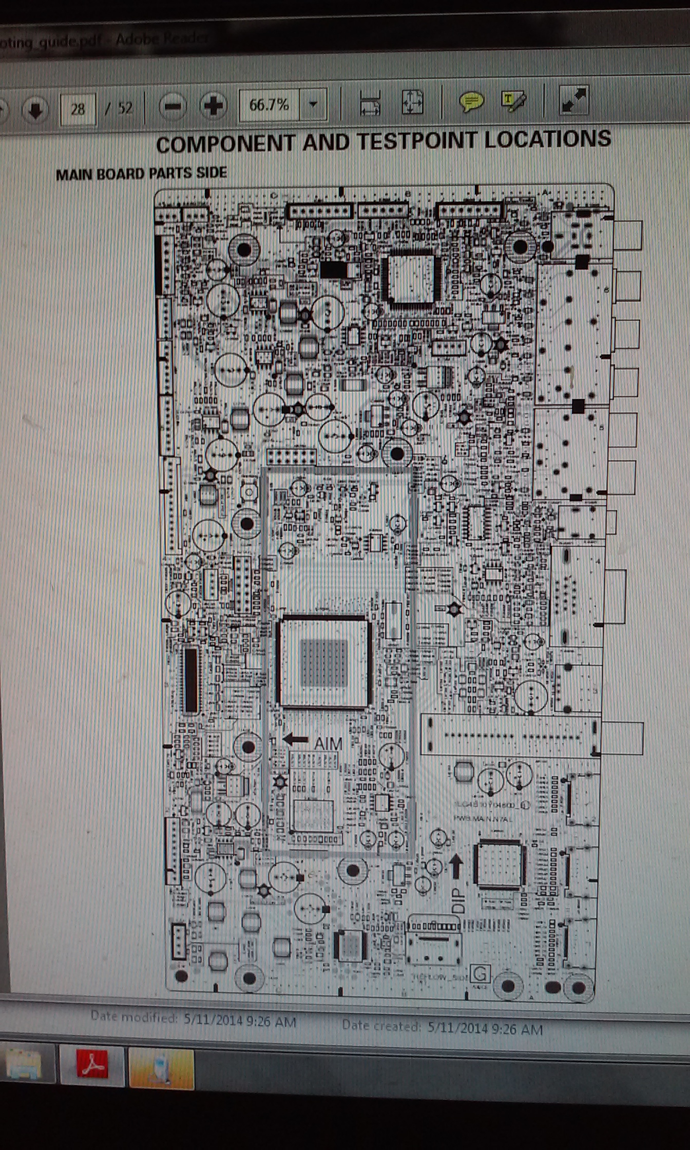

                        yea i have seen that one and have looked at it for hours but cannot find the cap because the board in the schamatic does not resemble the actual board

                            It's a N7AE board so this manual should be correct. You know it's an electrolytic not a ceramic so one of these is most likely.
                            C1660 CEXLB1C101VDN ELECT 100U M 16V
                            C1662 CEXLB1C102VDN ELECT 1000U M 16V
                            C1664 CEXLB1C101VDN ELECT 100U M 16V
                            C1666 CEXLB0J102VDN ELECT 1000U M 6.3V
                            C1672 CEXLB1V471VDN ELECT 470U M 35V

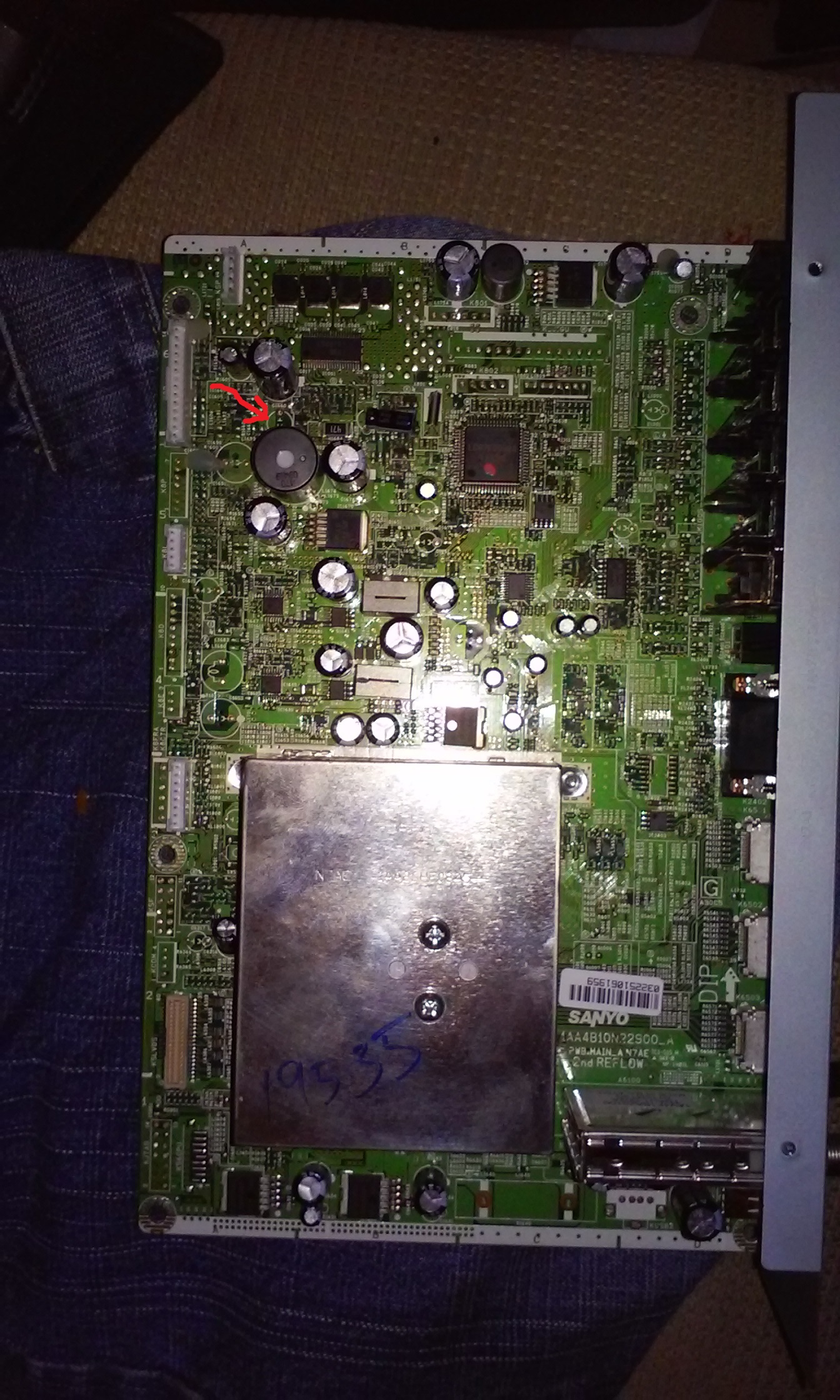

                              I think it's
                              • whatusername
                                • Dec 2013
                                • 456
                                Now thats what im talking about :-) that board looks just like it and as i thought its c 1660 but the other schematic was showing ceramic and i knew it wasnt.. this one shows Electrolytic and its a 100uf 16v thank you so much TW

                                    now if im not mistaken the white dot signifies the neg pole of the cap and upon looking at c1664 apparantly the po soldered in that cap in reverse too which is probably why c1660 blew so if u guys agree even tho c1664 is not blown yet should i replace it or just reverse it?
                                    • tw2005
                                      • Oct 2011
                                      • 6458
                                      White marker lines up with white band which is Neg, other could be ok but if it looks like it's been removed and resoldered with the Pos at the marker I'd swap it around but would not hurt to replace it.
