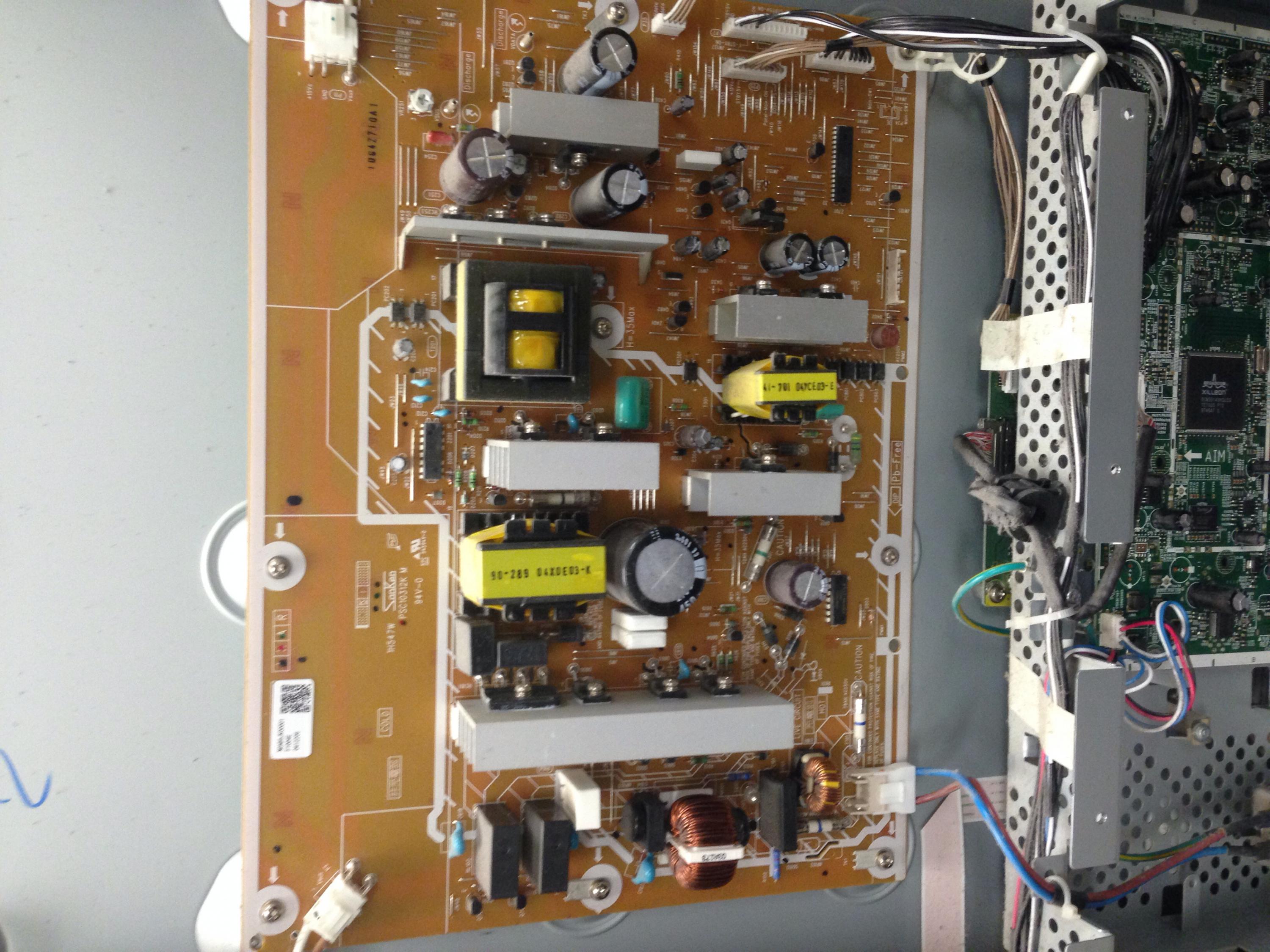

    Sanyo dp50740 will turn on and off but no picture
    The plasma tv when i plug it in and hit power button i see a quick flash of white light on screen like it is trying to turn on but it does not.I also checked the main board check points i got all of them except for the 13 v test point but i dont see a circuit that would provide for 13v unless i am wrong.also on pin 48 i get 4.7 v it is higher than 3.3v for power fail circuit.

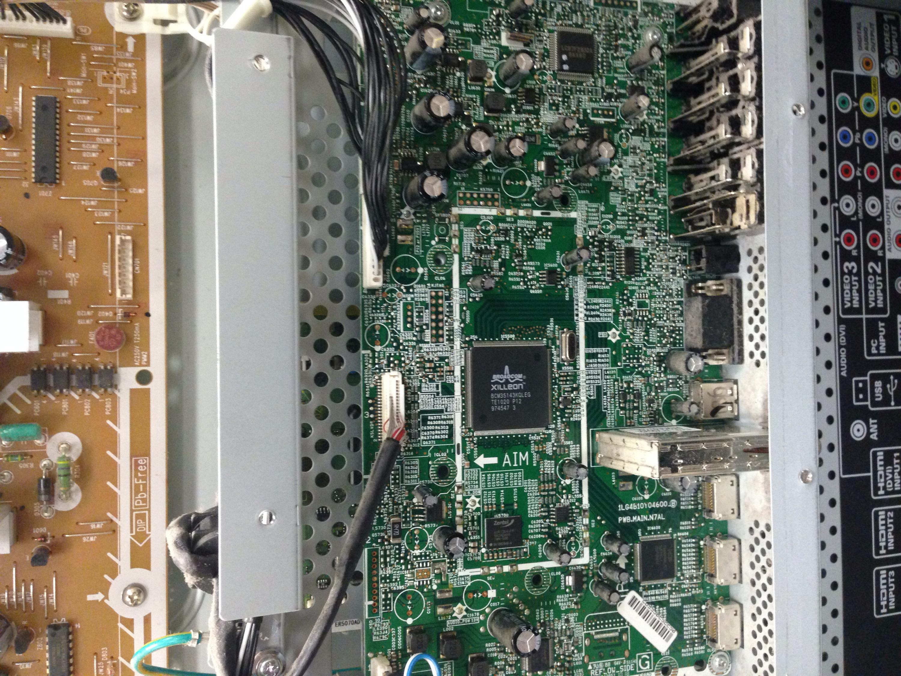

    Here are my regulator voltages
    Ic6630
    Pin1 .570
    Pin2. 1.821
    Pin2. 3.302
    Ic6650
    Pin1. 2.097
    Pin2. 3.349
    Pin3. 5.042
    Ic1660
    Pin1. 7.824
    Pin2. 9.072
    Pin3. 11.955
    All lm11175 adj voltage regulator
    Any help would be apprecaited

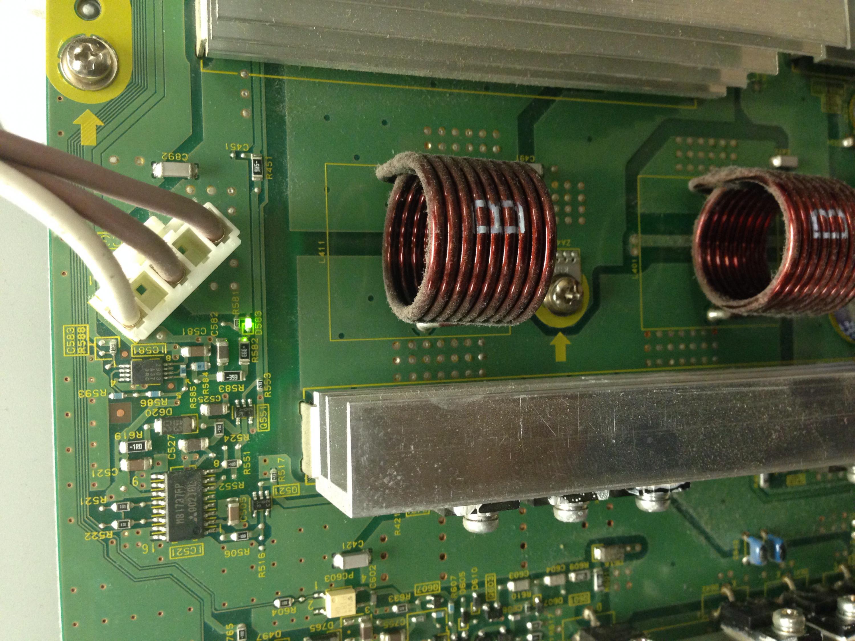

    I also noticed the sc green light is on it is bright green it only turns off. When set shuts off i assume if had short it would not light up.

      Here some pictures

        Pic

          Re: Sanyo dp50740 will turn on and off but no picture
          Sc board green light
            AMS1117-ADJ will this regulator work for replacement for 1117s adj 009
              Replaced my regulators on main board still same problem any help what to check next
