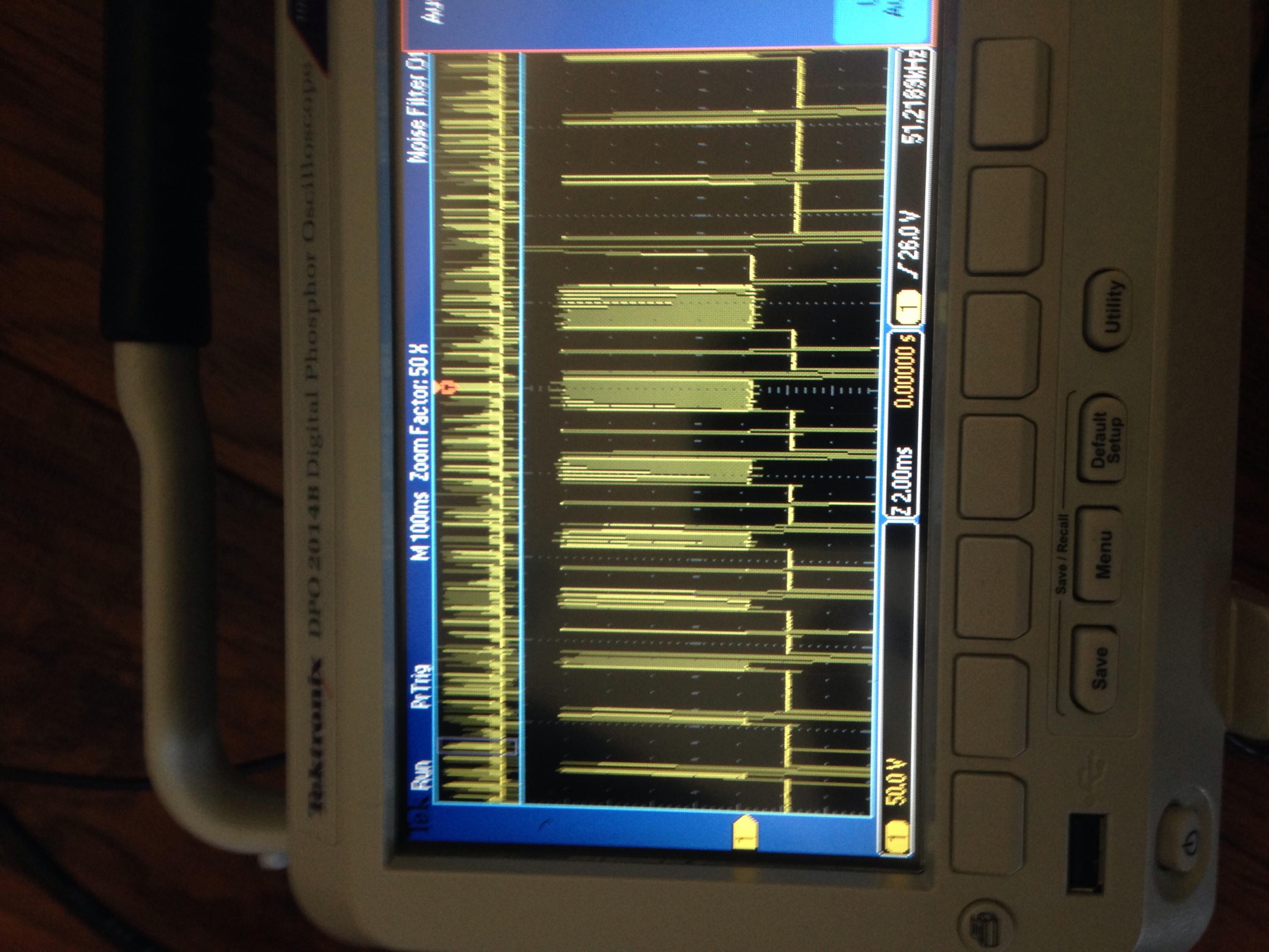

    Y-main scope reading

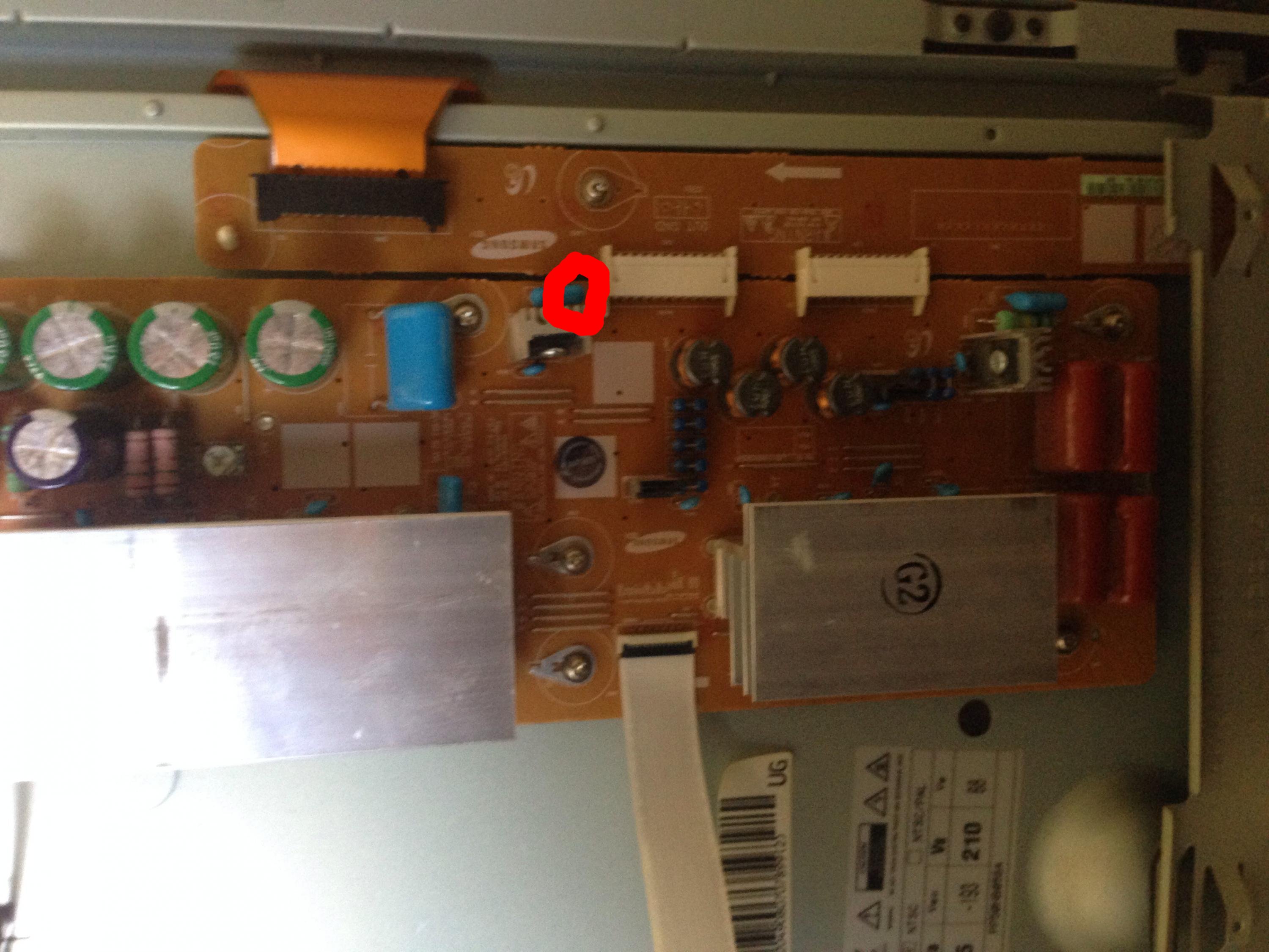

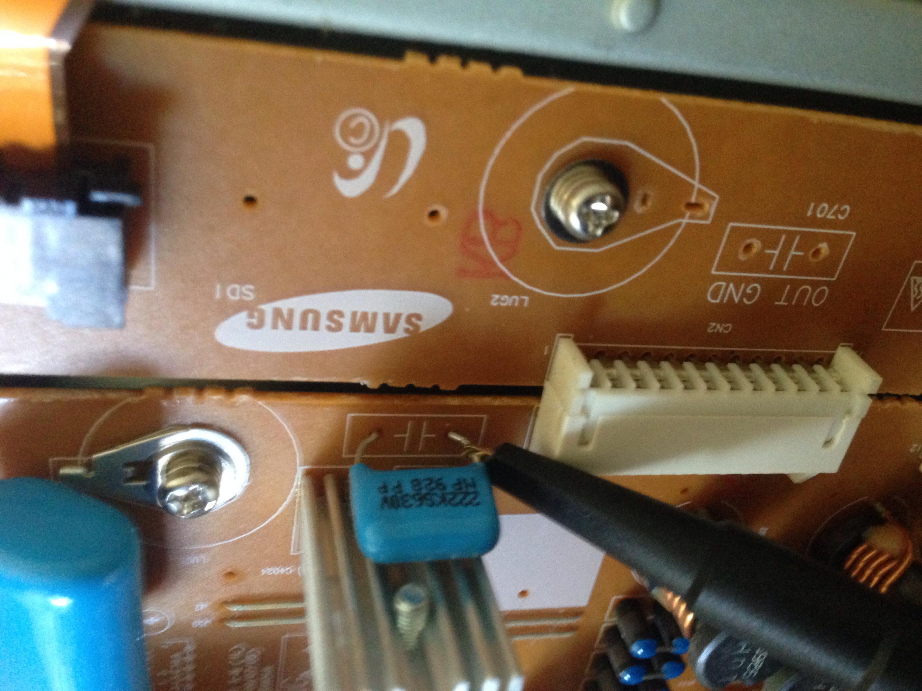

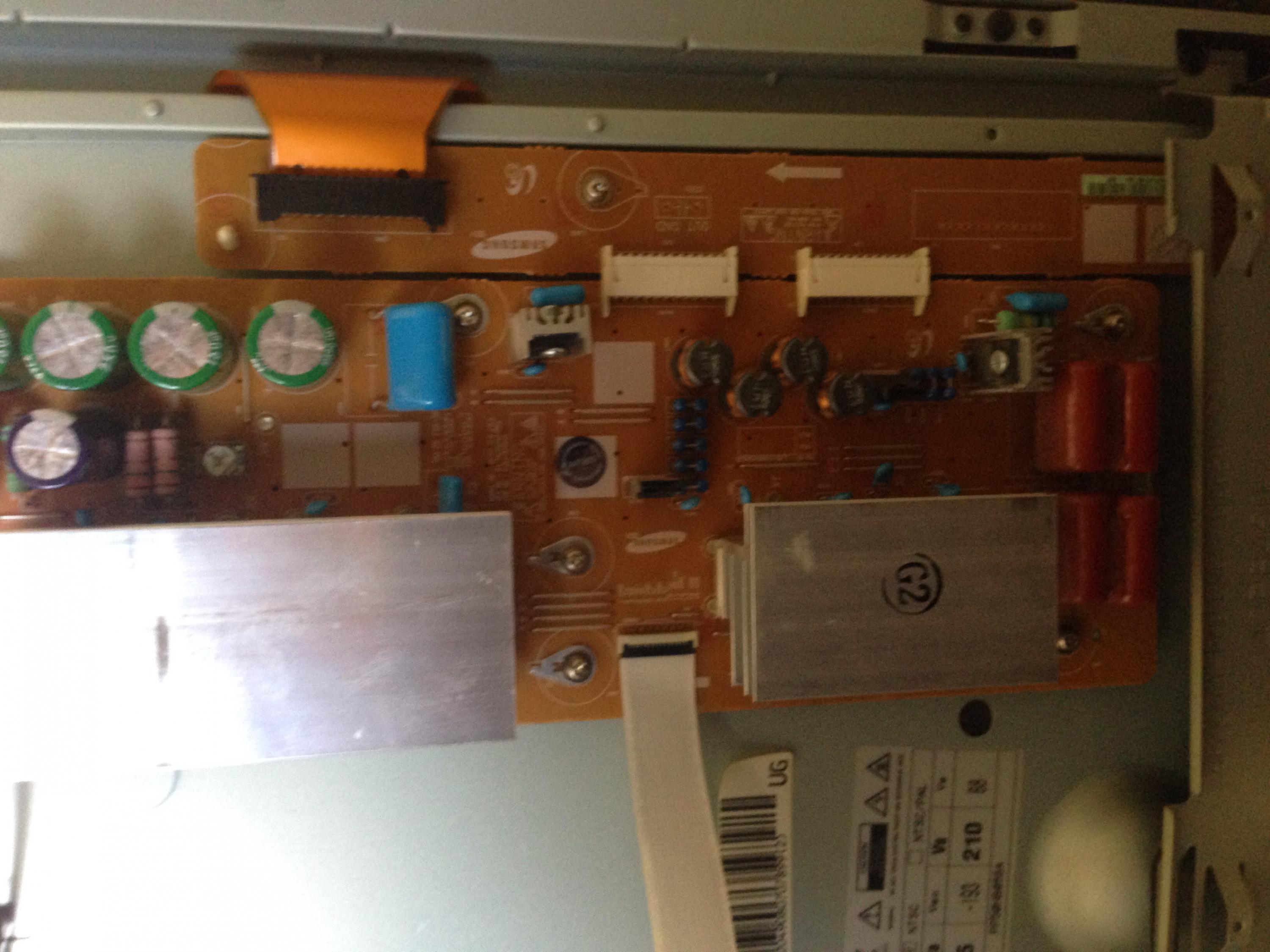

      Re: Samsung PN50B430P2DXZA
      Where do I connect scope probe on X-main
          Nice scope! Y'know, it has a USB port, for exporting an image, it's a lot easier.
          Y-main looks OK.
          X-main waveform, see picture.
          Yes, 5V standby should always be present.

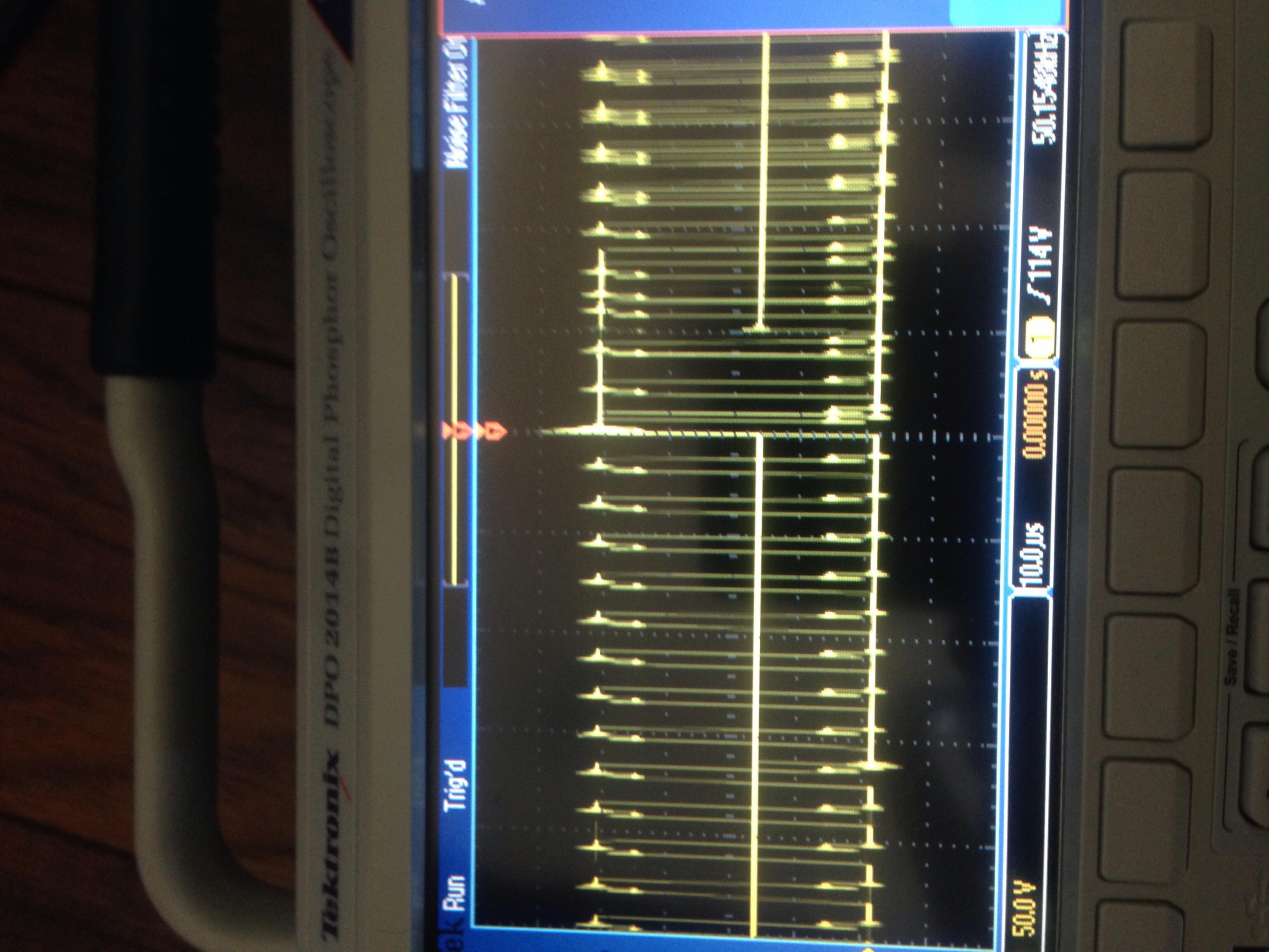

              Here is the one that matters fromX-main

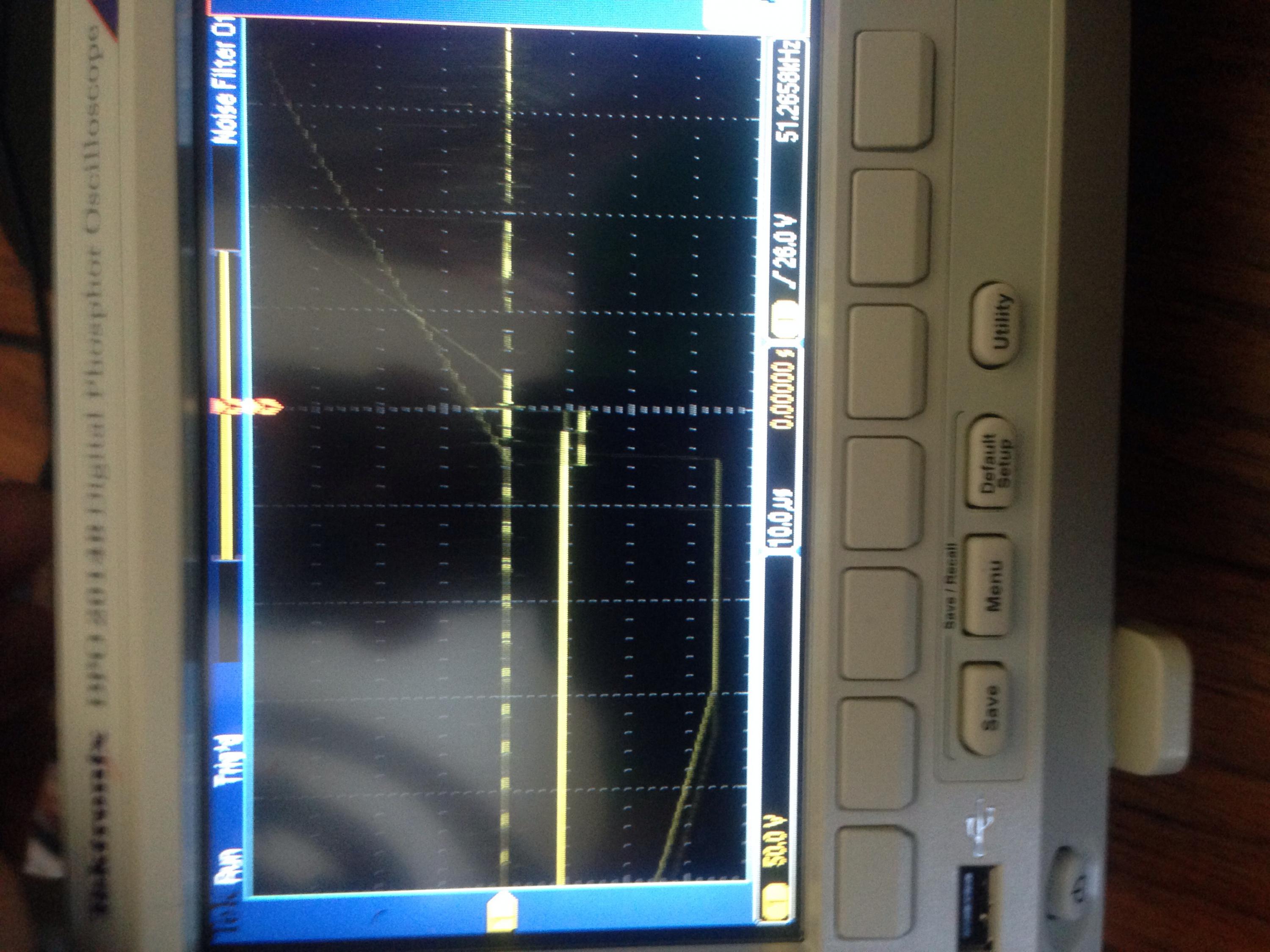

                That's more or less correct for X-main waveform. Can you try turning off the dual-timebase zoom (zoom factor should be off) and use a timebase of 10us/div?
                  Here you go X-main

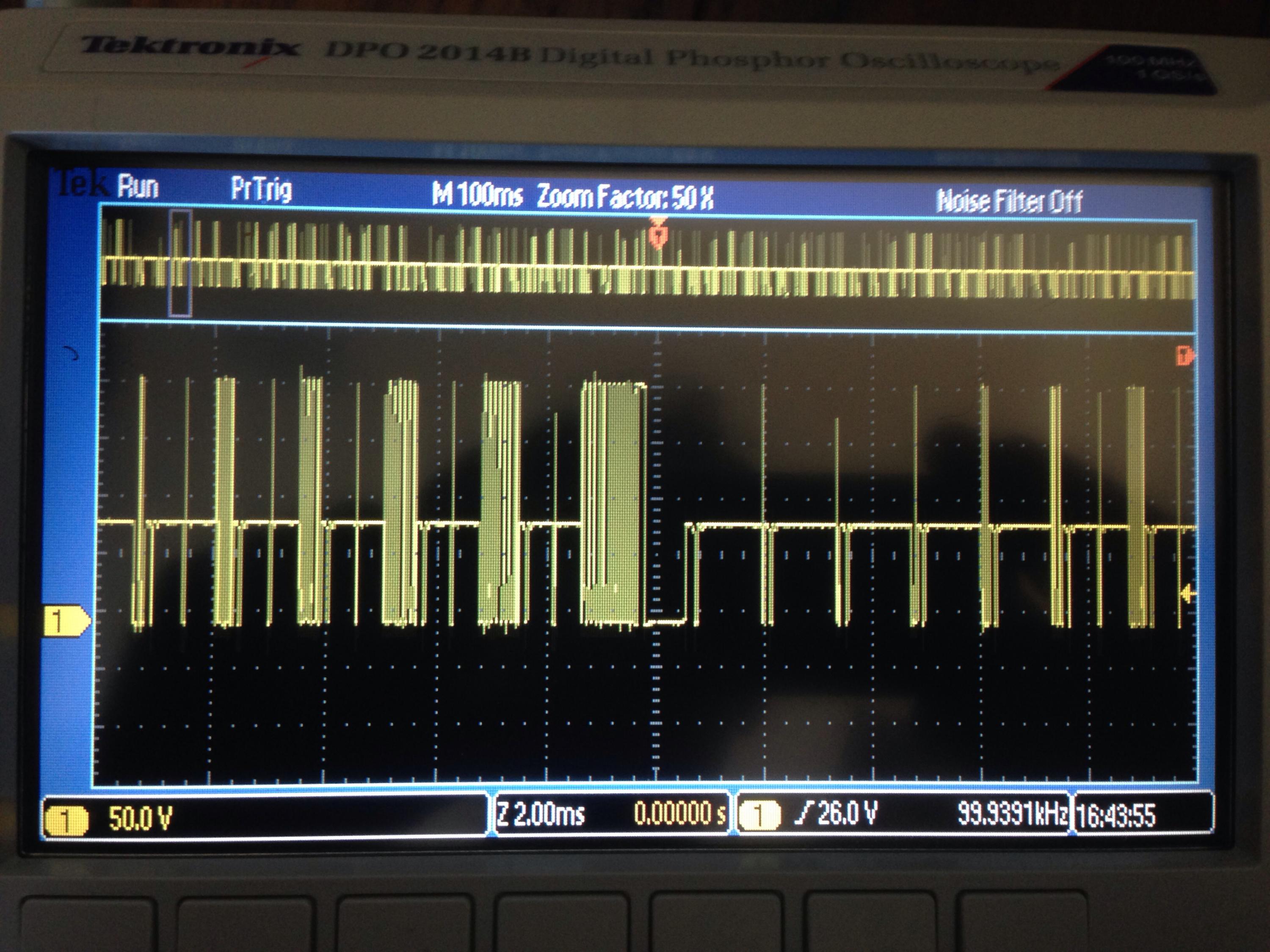

                    #29
                    Y-main with new settings looks suspicious
                      #30
                      I can't find fault with either of those waveforms.

                        #31
                        Did you see the picture of new Y-main waferorm I send. 88V matches panel sticker, maximum increase is close to 120V no difference in picture quality
                            The Y-main reading looks OK. I'm at a loss to explain the poor image - everything is working right. Any change in image noticed when you adjust the Yrr or Yfr on the Y-main? You should also see a change in the Y-main waveform.
                                    I never thought of it before, but how sure are you the X-main is connected properly to the panel? Are all ribbons installed? Is the connector well seated, no cracked solder joints etc,?

                                      #38
                                      I will compare x- main I ordered and the replacement. Maybe the one I repaired damaged control board I ordered as replacement. What bugs me is there are 4 RJH3044 gets and 2 Fairchild fets and Fairchild fets are supposed to be replacement for RJH3044. I installed Fairchild so ended up with 6 same Fairchild parts. If they are replacement why would every x and y main had both of them? I guess something is different.
                                        X main is connected properly. I removed few times and reconnected. I don't see nothing wrong with cable or connection. There is a way to check main and logic board pattern in service mode also. I just need to get remote for Samsung
