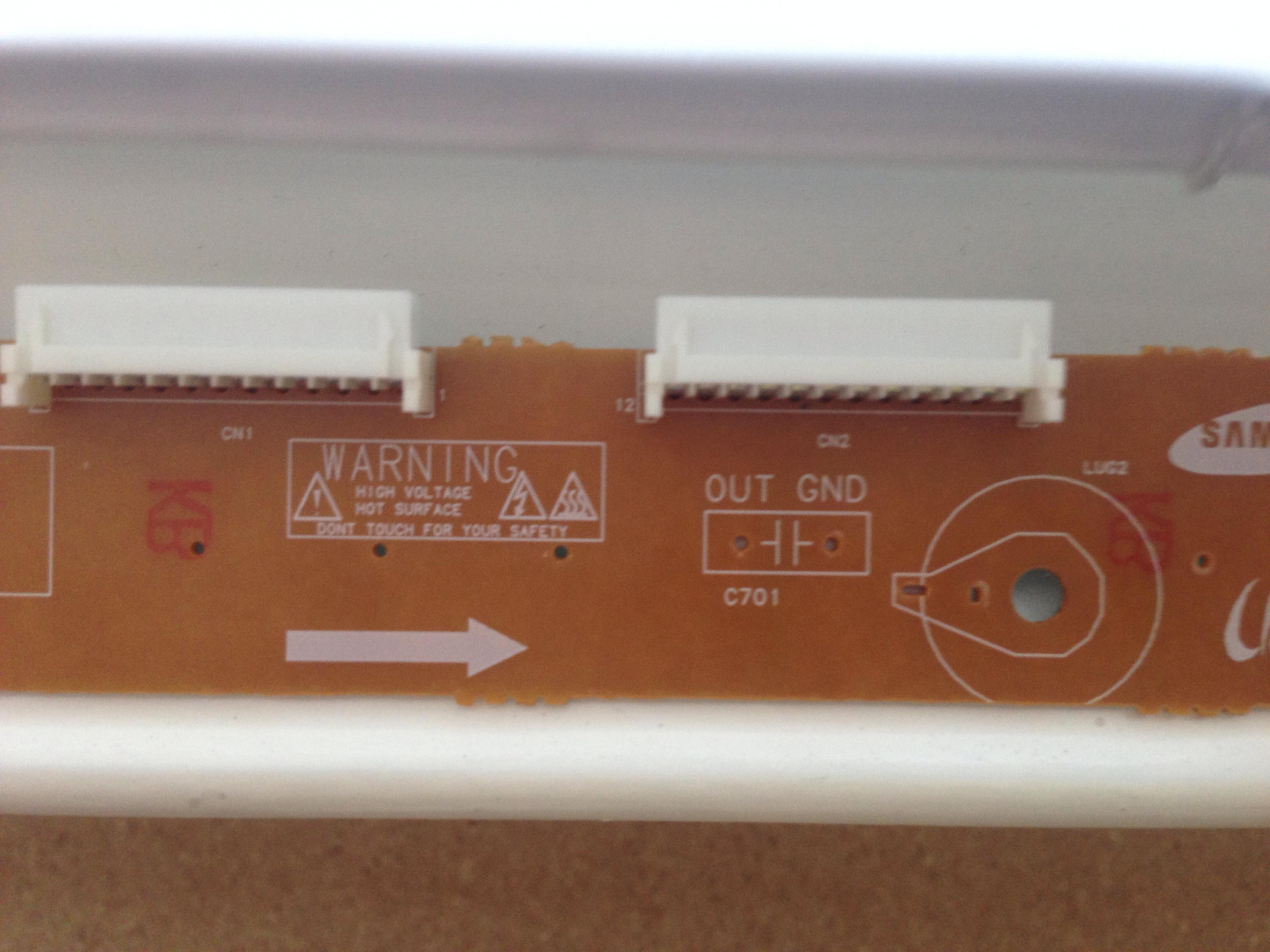

                            Do you still have the scope? Try probing the point on the X-buffer marked OUT. If it's notably different from the other waveform at that blue capacitor, I'd say something is disconnected/broken somewhere... that would be an interesting one.

                                Do I connect scope to any of these pins on white connector?
                                  #56
                                  Re: Samsung PN50B430P2DXZA

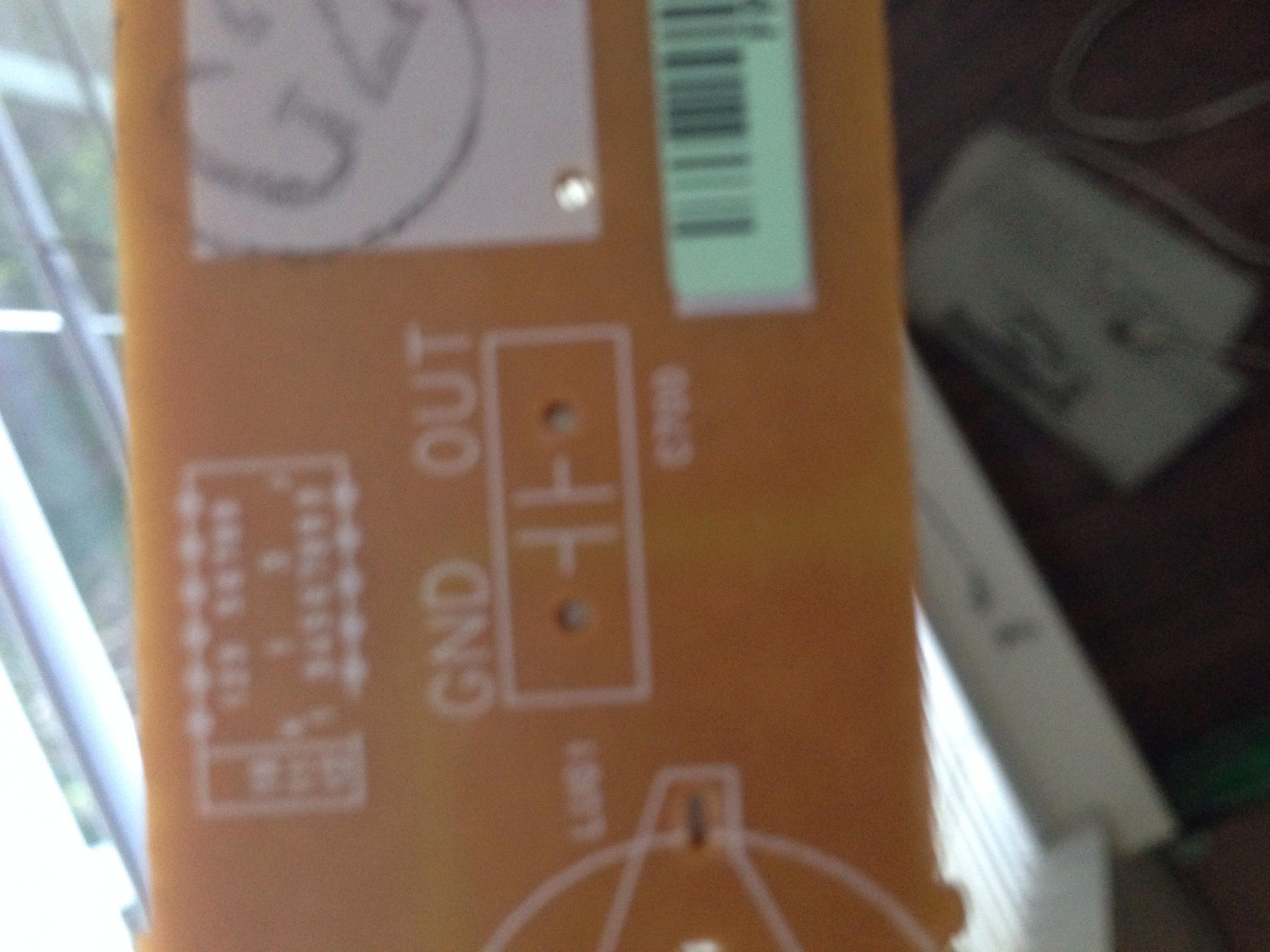

                                  Check the pad marked OUT, you can take the probe hook off the end of the probe and touch in on the OUT pad directly.

                                    The pad market out is empty hole with solder on the back of board. Should I run wire thru and solder on the back and connect scope hook there?

                                      Never mind I misunderstood your previous message.

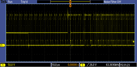

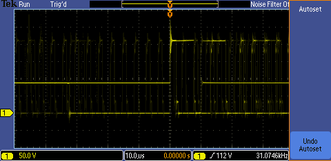

                                        Here is the picture of the waveform taken from x-buffer out.

                                          Both waveforms, from X-buffer and from X-main
