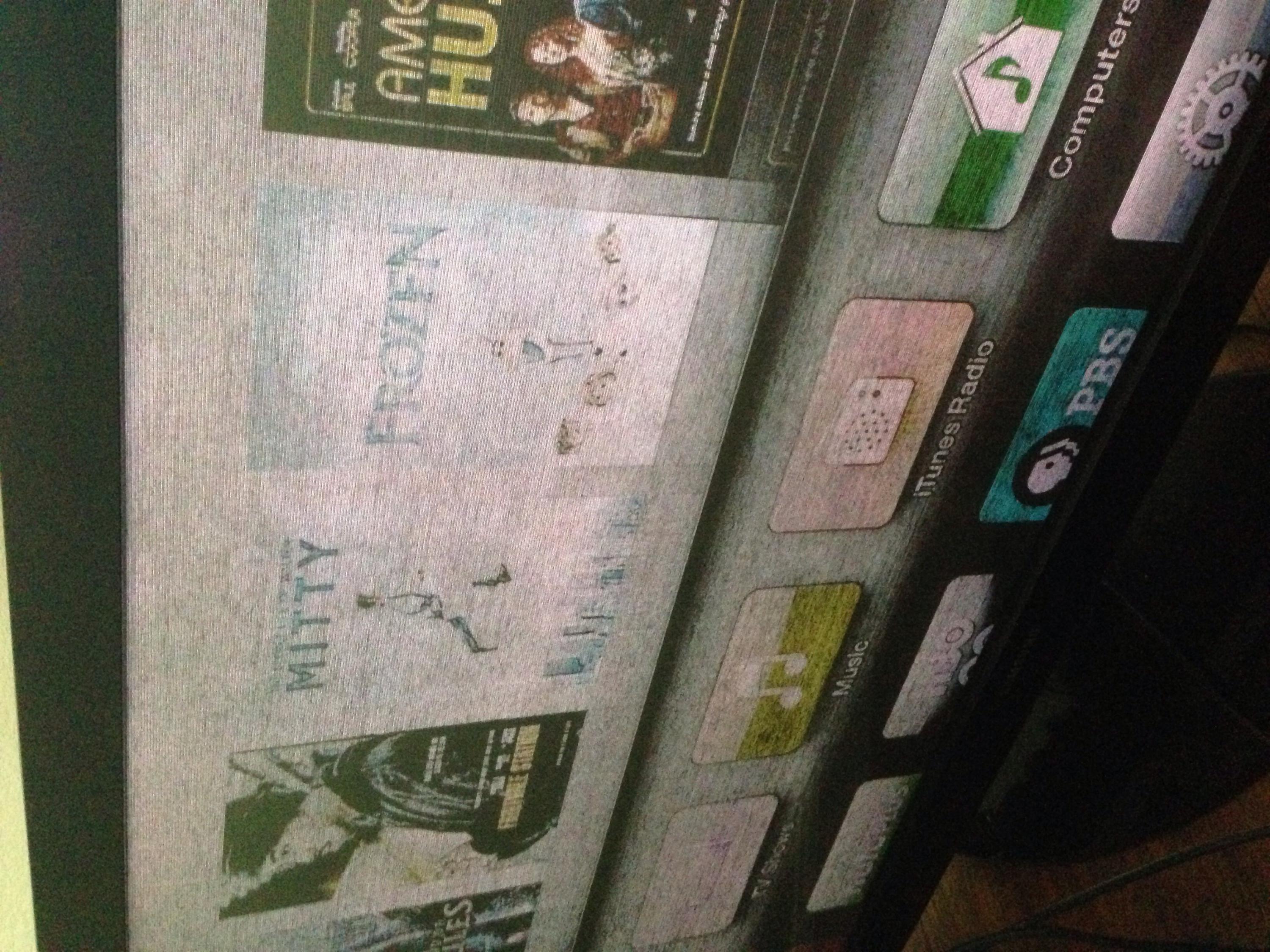

    Need help with 50" plasma. At beginning it will not pique up. Found shorted X-main board. Repaired board and it powers up ok. All voltages per panel sticker ok. But the picture looks fuzzy. Removed power cabke from power supply to main board, shorted ps-on to ground and put jumper on 3-4 on t-con. Test pattern came but fuzzy again. Ordered another t-con and X-main , still same problem. Please see attached picture.

    Can we see a picture of the fault?

      Re: Samsung PN50B430P2DXZA
      See picture
        That is an X-main fault if I ever saw one...
        Can you see if you can find the Ve voltage and try testing it?

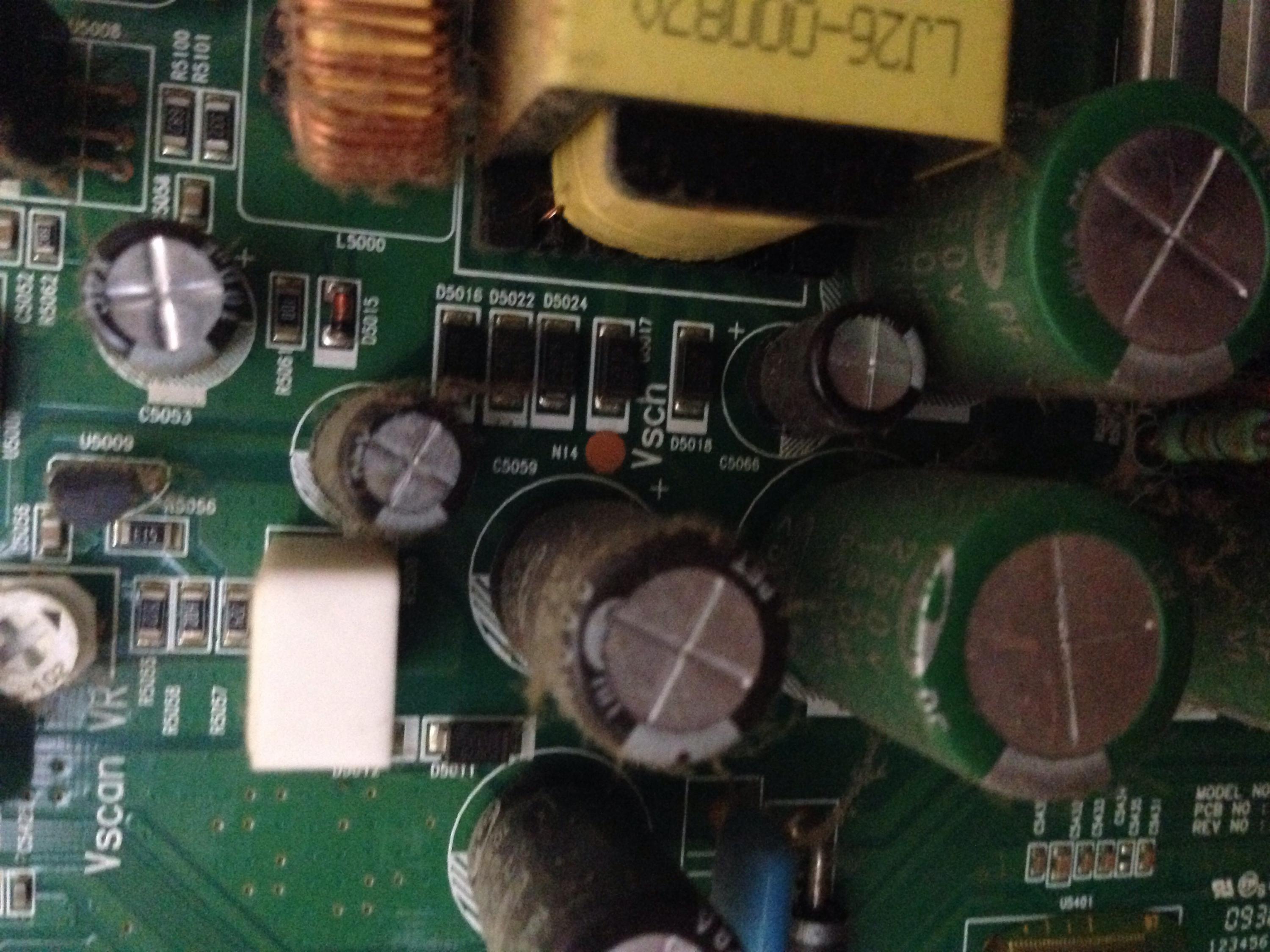

                    There is another voltage check that is on Y main board VSCH. It reads -44 Volts. The VSC reads -193 which is correct by panel label. What is VSCH supposed to read, it's not labeled on the panel sticker.
                    • ned1
                      • Feb 2014
                      • 139
                      • usa
                      Does anybody knows how to check voltages on VSCH. The VSCH to ground measure -44V steady. VSC scan is -193V steady. The reason I moved to y-main board is the sparks I can see sometimes on plasma screen.

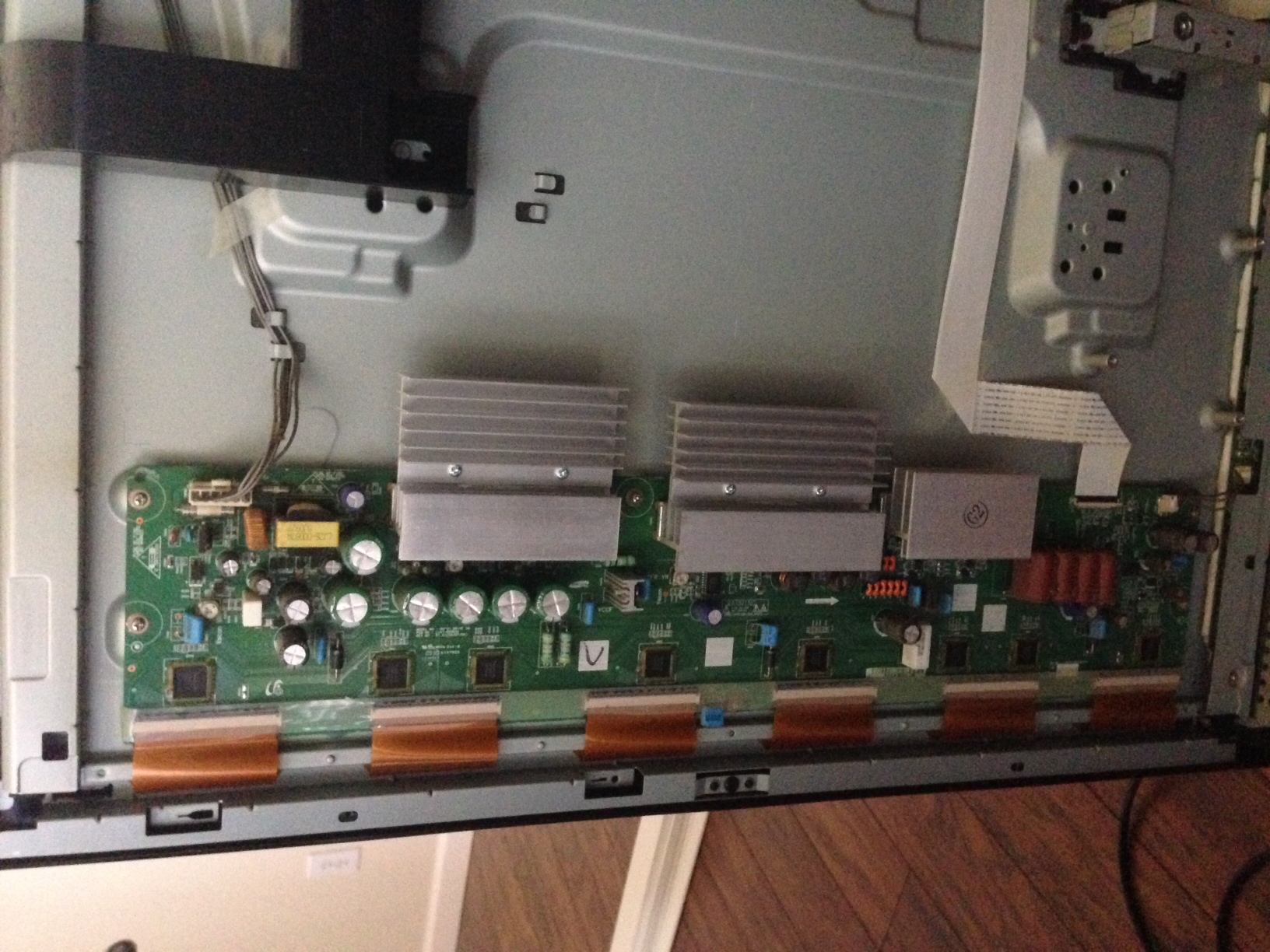

                          It could be the power supply, I had a similar model with a problem that kind of looks like that with similar parts. I swapped out 2 new x-mains and the problem was the same.
                          After swapping everything, it turned out to be the power supply. Wasn't sure for the reason why, but it worked.

                              Vsch is Vsc + about 130v to 160v in your case it's OK.

                                OK VCS scan to ground is -193 but VSCH to ground is -44. I just want to confirm with you again. I did not measure VSC scan to VSCH. Is that needed.
                                    You can see the difference is 150v it is fine. Your problem likely xmain or fault with control board

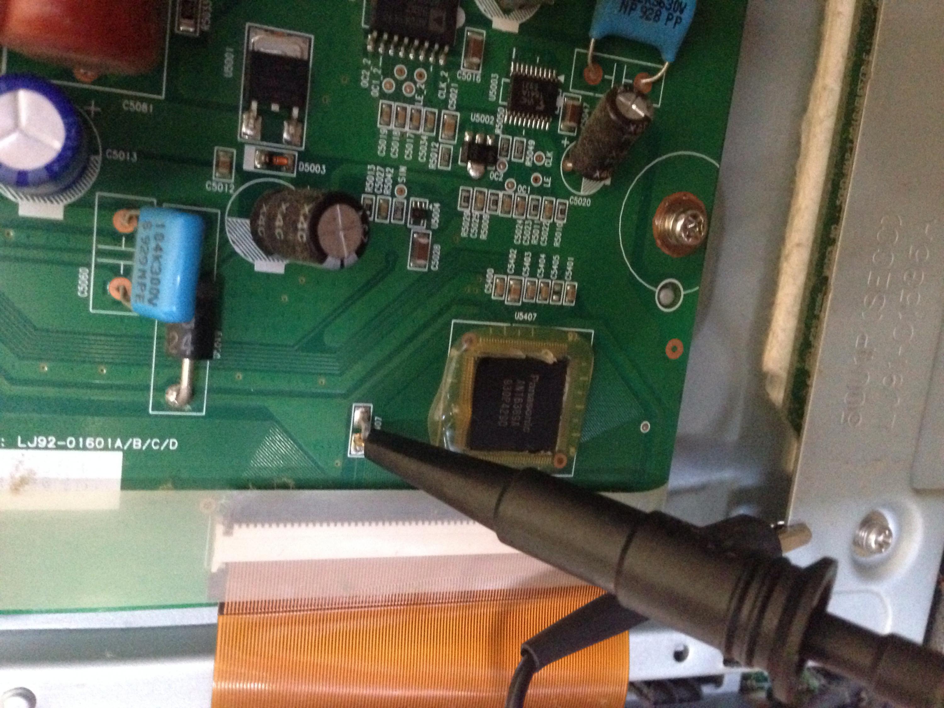

                                        Got the scope , hooked up to y-main board.
                                        Please see picture and tell me if I am doing it right?
