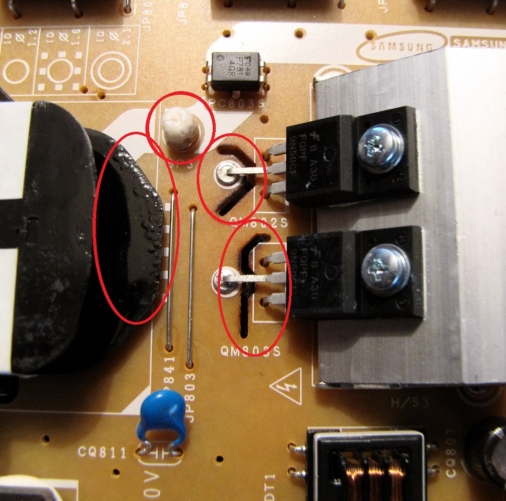

    The only thing that isn't normal is a slight discoloration (dark brown from overheating) around the openings in the red circle.
    On the plastic behind the screen panel, the part that comes in contact with the back of the P/S board it a little melted. Is it
    normal for this to get that hot?

    I took off the P/S board and inspected the back, but nothing look out of place. I inspected the M/B, but there really is
    nothing to look for on that board.

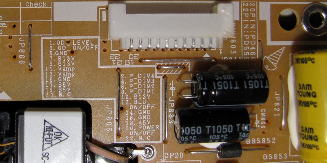

                      Thanks for the info tibimakai, unfortunately, my power board does not have these pin outs. This is how my board looks.
                      Like I said before, I am a noob when it comes to board level electronics, but I am a quick study and I follow directions very well.
                      Thanks,
                      Ian

                          That looks weird, I haven't seen these marking before.
                          The BLU ON/OFF it's most likely the turn on for the backlight, POWER_ON is the turn on(PS_ON), I'm a bit confused which one would be the standby, the A5V or the B5V?
                          You could test it while the TV is plugged in, but not turned on, see which one has the 5V.

                                    I connected the negative lead to the chassis and with the positive I checked each pin on the power connector going to the main board.
                                    These are the voltages I got, all seem good.
                                    1. OD_LEVEL - 5V
                                    3. OD_ON/OFF - 5V
                                    5. GND
                                    7. B13V - 14V
                                    9. B13V - 14V
                                    11. V amp - 14V
                                    13. V amp - 14V
                                    15. GND
                                    17. B5V - 5V
                                    19. B5V - 5V
                                    2. P-DIM4 -
                                    4. P-DIM3 -
                                    6. P-DIM2 -
                                    8. P-DIM1 -
                                    10. B13V - 14V
                                    12. BLU ON/OFF - 5V
                                    14. GND
                                    16. GND
                                    18. A5V - 5V
                                    20. POWER ON/OFF - 3V
                                    Nothing happened when I jumped the pins to get the backlight to light.
                                    Ian
