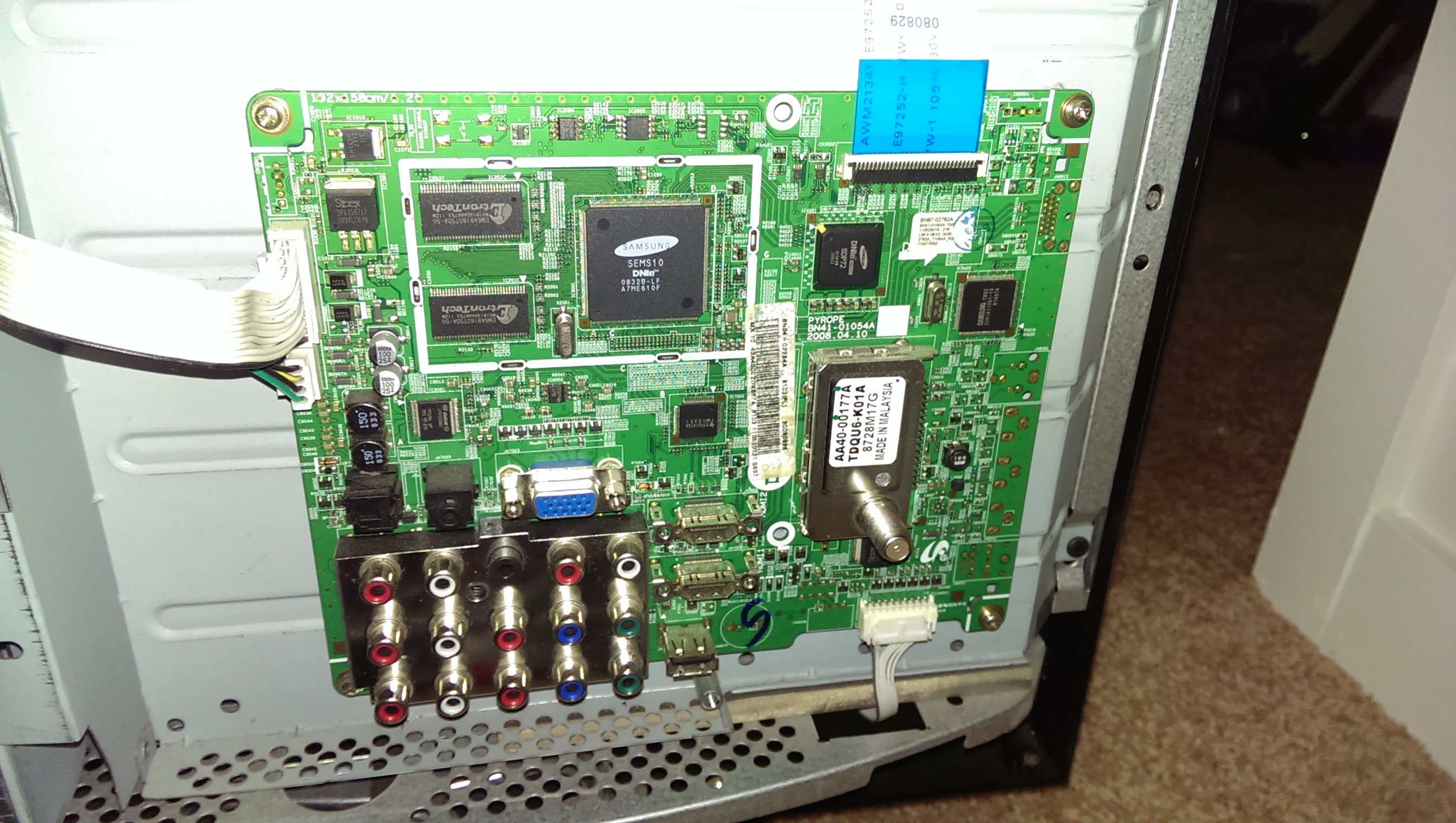

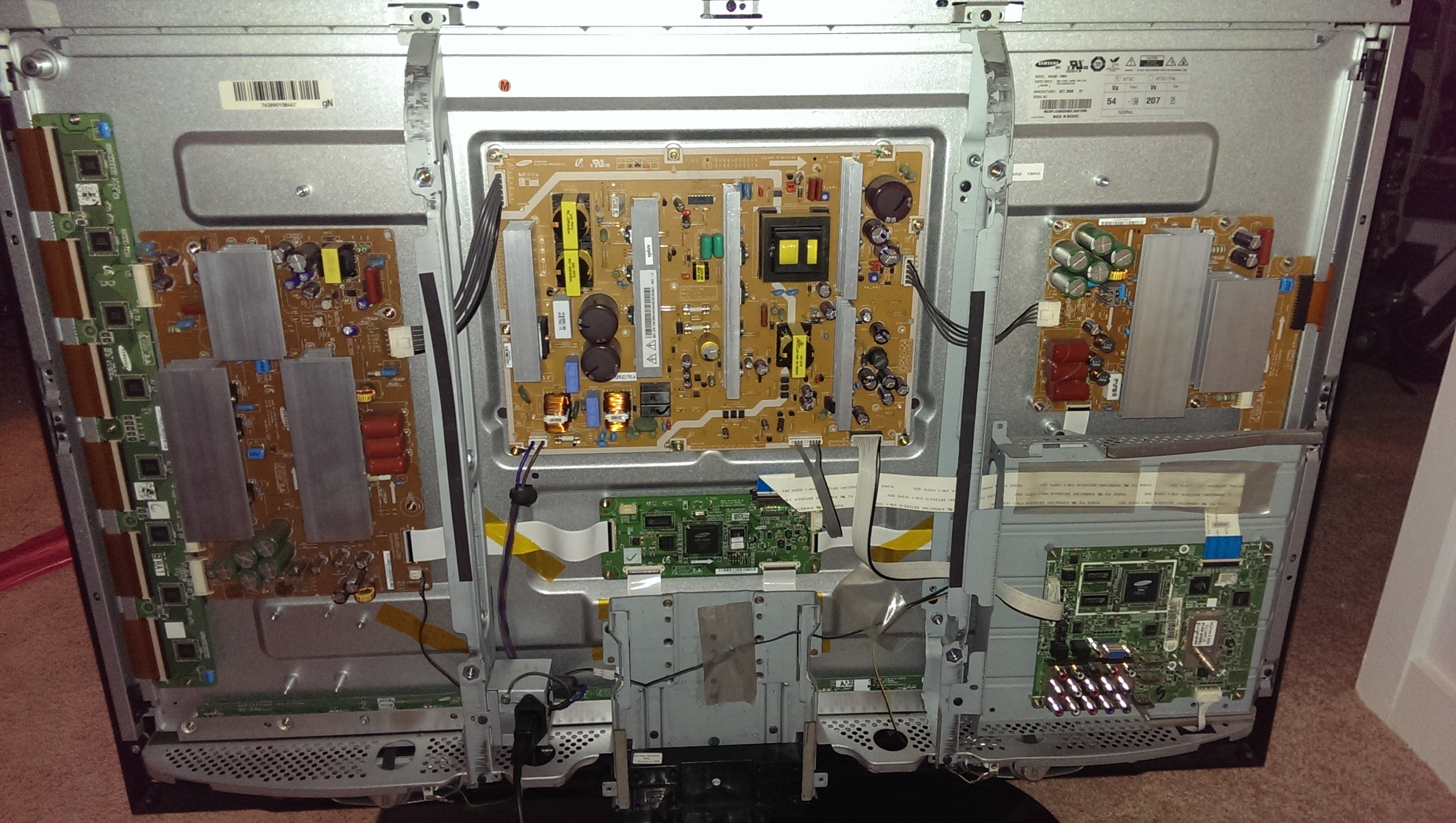

    My Samsung PN42A400c2d does not display an image. When the power button is pressed, I here a relay click once and then power light begins to blink for a few seconds before becoming solid. During this time, the start up noise is heard but no image appears on the screen nor does the backlight power on.

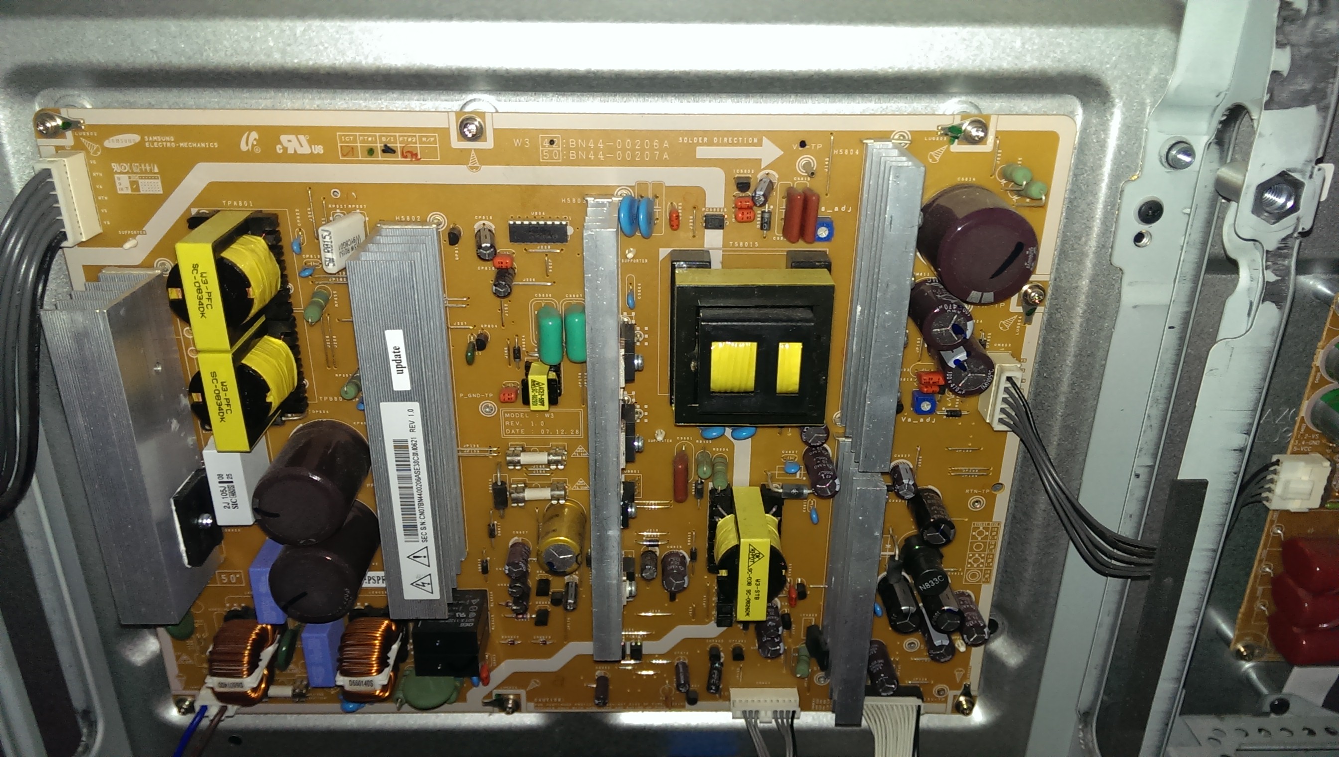

    On the inside, LED 1 briefly turns on before going out while LED 2 blinks until the the unit is powered off. Following other threads, I have checked the VS and VA voltages and found them to be right in the range of 207 and 54 plus/minus 2V, respectively, using a multimeter. Additionally, all of the fuses seem to be in working order. I have also confirmed that I can heard sound from inputs, specifically HDMI.

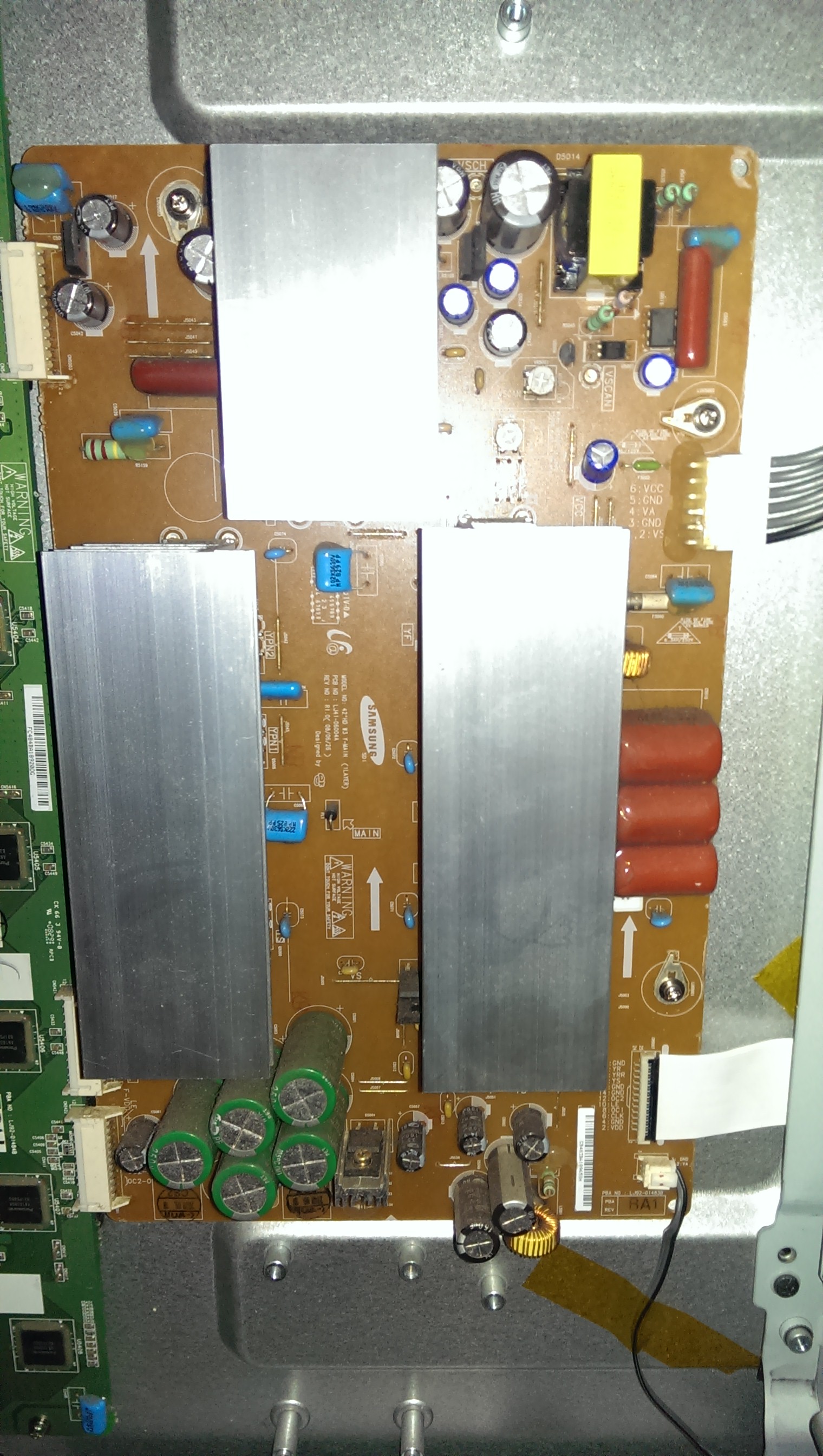

    Originally, I thought my issue was a bad Y main and buffer so I replaced them both but have had no luck. The only weird thing that I have not been able to find anyone else having is there is a sound which I believe to be coming from the Y Main. It is a slight hum, very similar to the sound of fluorescent lights which occurs about ever 3/4 of a second and repeats the entire time while the unit is on. This sound is present when using both the old and replacement Y Main boards. I can get a video if it would be helpful to you.

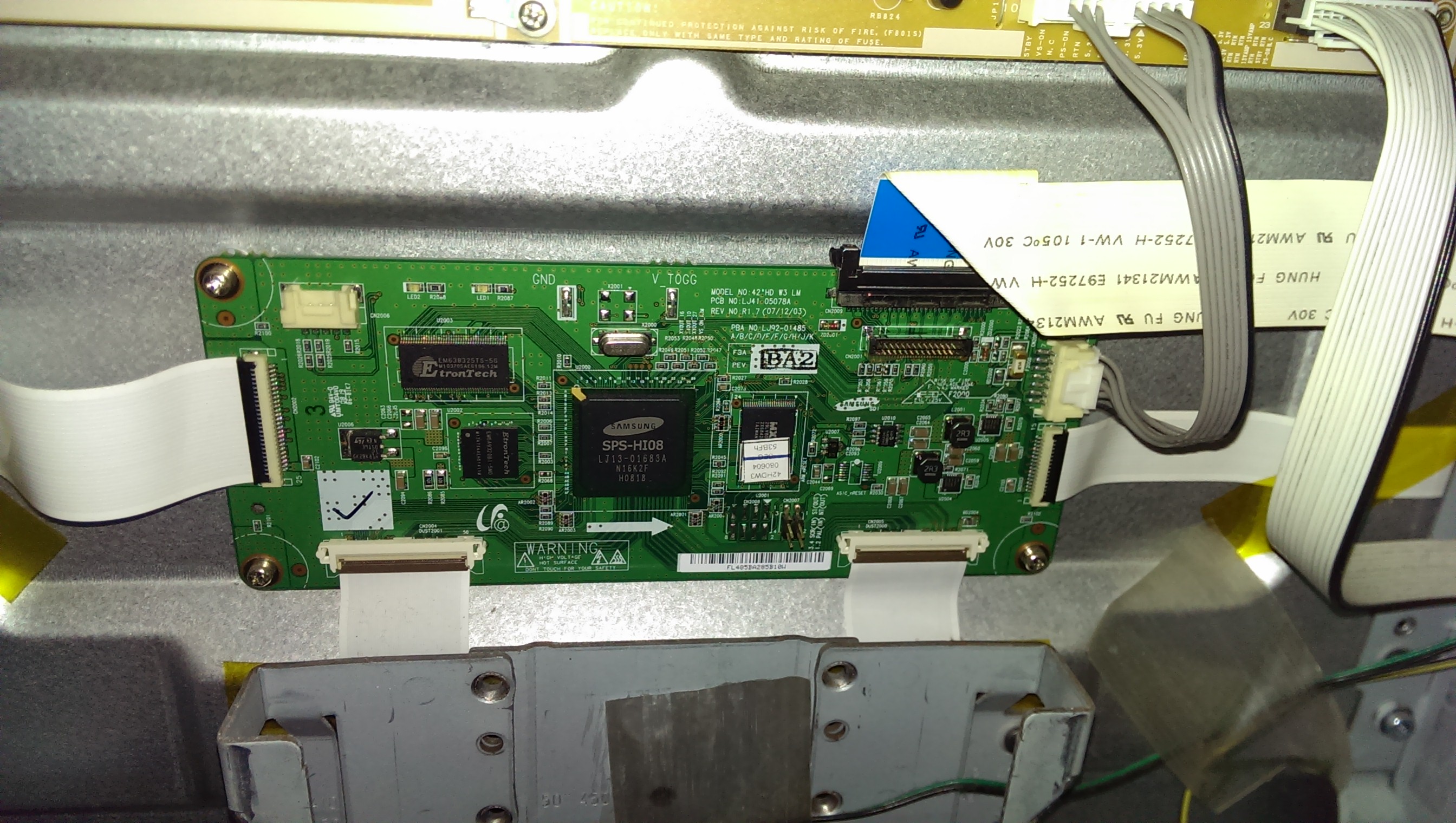

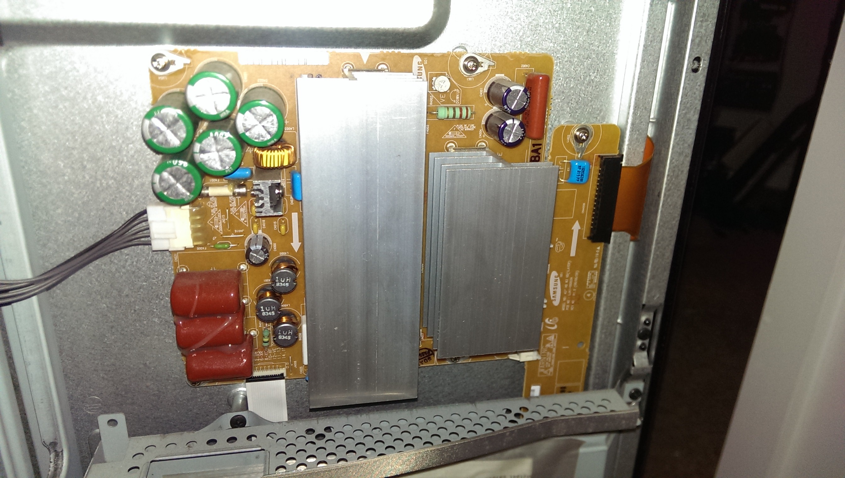

    At this point, I can't seem to find anyone else having these same issues so hopefully I can find help here as these forums and its users seem excellent in troubleshooting. I've attached images of all of the boards but do not see and bulging capacitors or any other visually identifiable images.
    Thanks in advance and I will try to be as timely as possible with my responses to your suggestions!

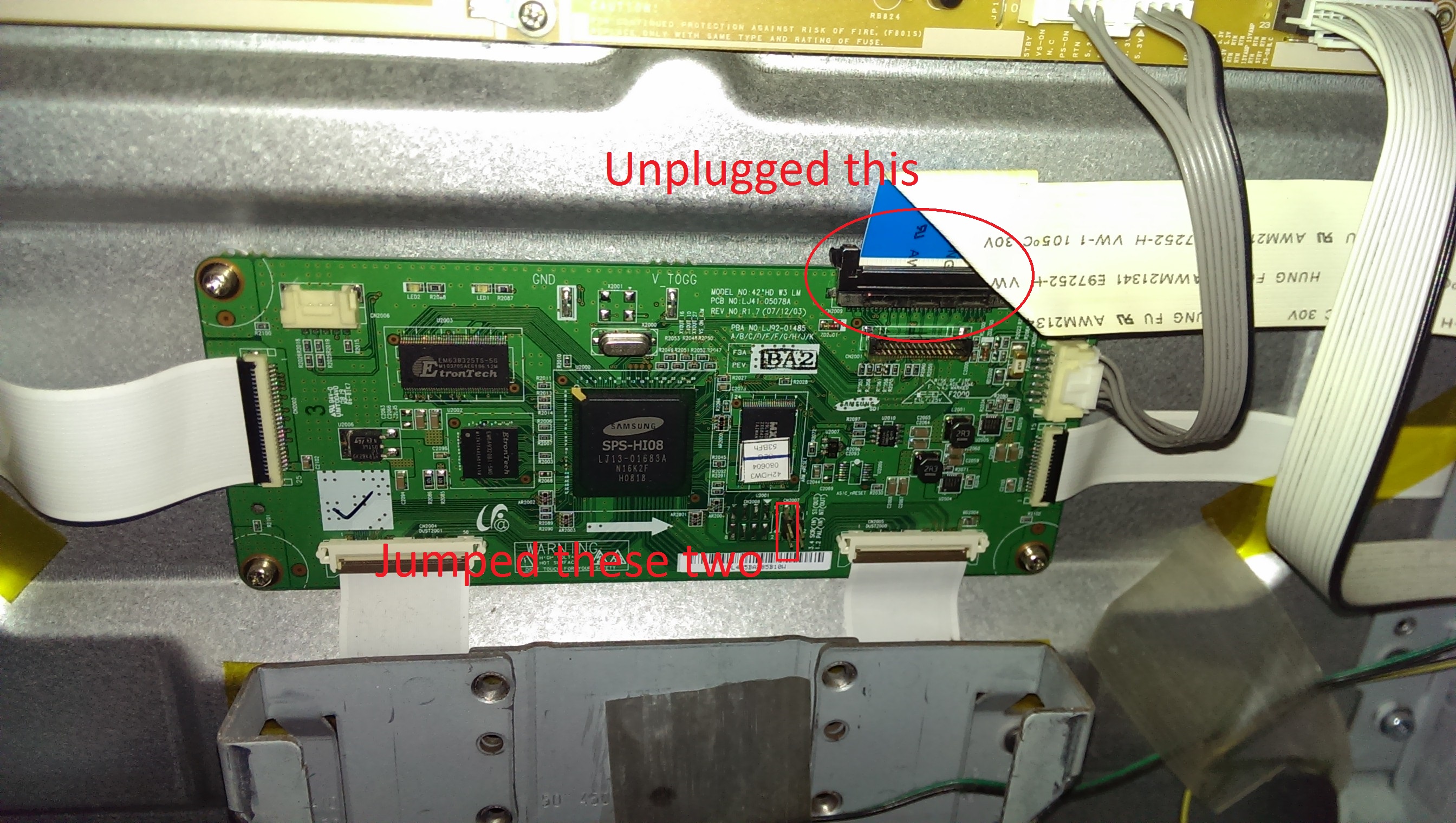

      Okay so I jumped pins 3 and 4 and unplugged the LVDS cable, all as shown in the attached diagram (just to make sure I did that right).
      There was no difference. No image appeared on the screen, I still got the boot up sound, and the Y Main board still made the same humming sound every 3/4 seconds.
        Re: PN42A400C2D: Turns on but no picture
        OK, that's correct. Leave it like that for now...

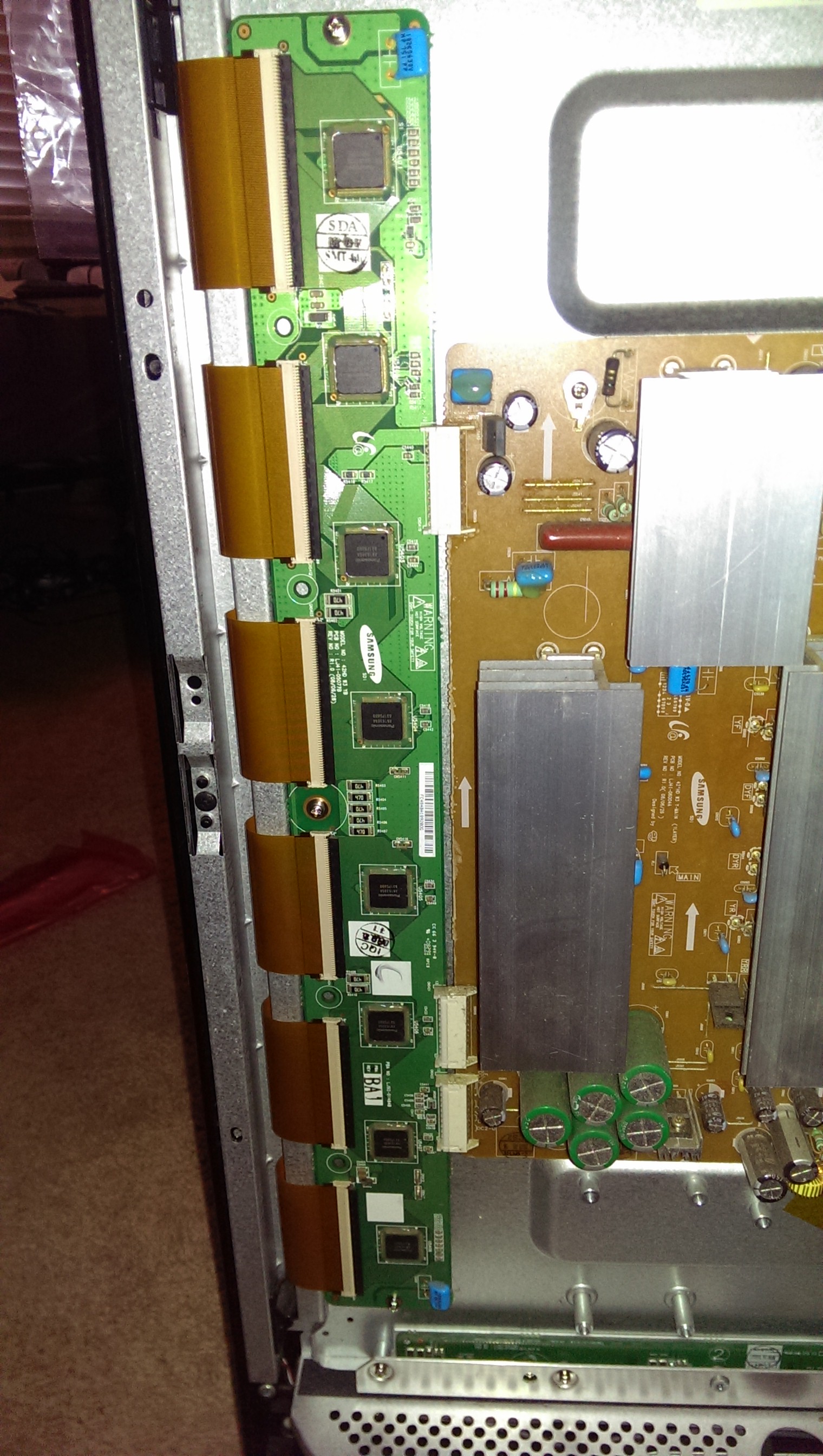

            OK, can you now disconnect the Y-buffer board connected to the Y-main and repeat the test?
              Repeating the test with the Y buffer removed, the VSCAN voltage now sits at a very steady -201V. Also, the humming sound coming from the Y Main is gone.
                OK, you have a bad Y-buffer it seems.

                  Okay so I did exactly what the video showed and it appears the Y Buffer is toast. I get continuity beeps in a few places on the connectors. I also tested the old Y Buffer and found the same thing though the shorts were located in different places.
                  From here, do you think I should replace just the Y Buffer or the Y Main as well? Is there a way to test the Y Main or do the tests done so far say anything about its condition? I originally purchased them as a combo from eBay but as the Y Buffer is defective, I will be contacting the seller.

                    Check the panel very carefully for cracks, especially around the chips that are failed (so for example the top chip drives the top 1/8th of the screen, if you find shorts there, check there.) If you find a crack the panel is toast.
                    Note that in that video, I pulled the board from a TV that worked, and naively assumed it would be OK initially, but then saw the hole in it. I've since noticed that on Samsung and Panasonic panels, the buffers are usually damaged when the panels get cracked, so a lot of used parts are no good. Shopjimmy does test their boards but we have seen bad parts from them in the past, too.
                    I think the only thorough way of fixing this is to replace the buffer ICs but it's a lot of work; so if you don't have that capability, you will have to just hope you don't get a bad board (perform this test before installing the new board.)
