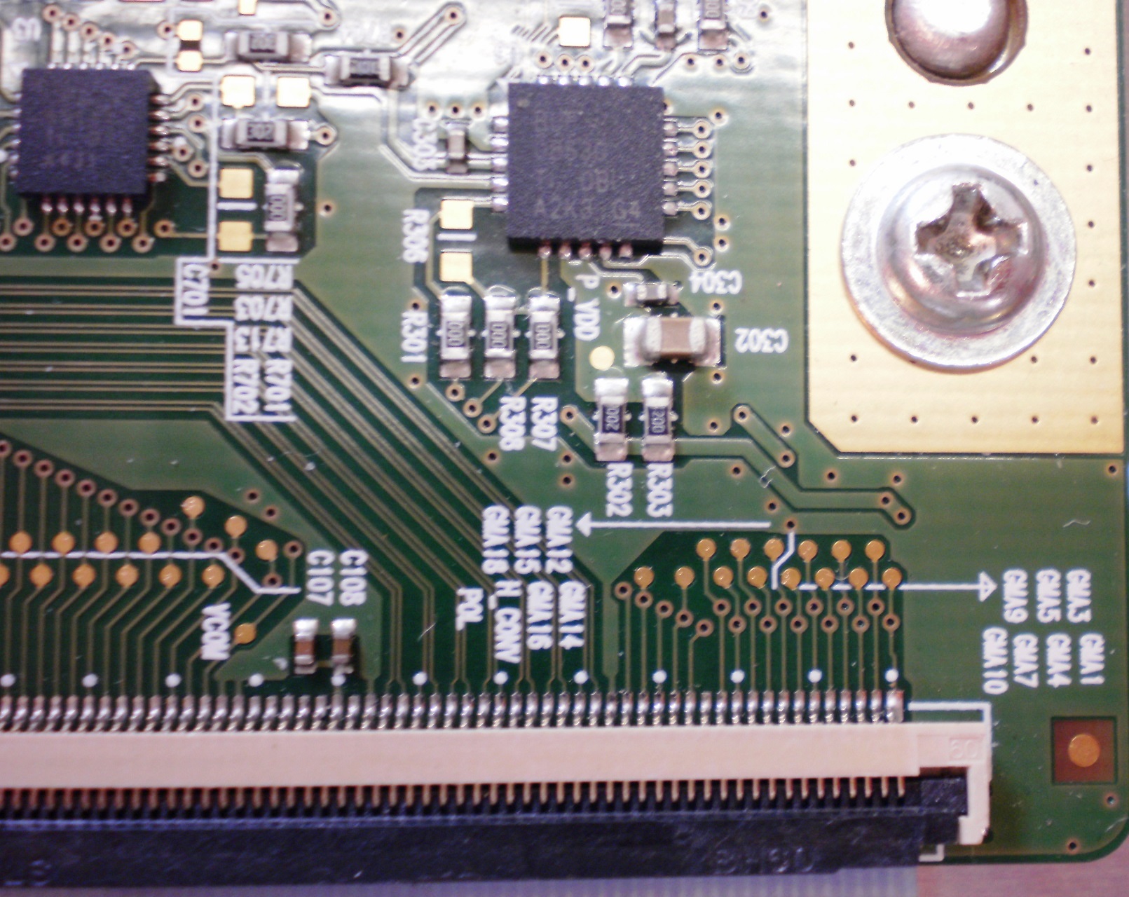

    LG 42LV5500 only backlight on
    I have done, which I should have not done, purchased it from somebody, who already tried to repair it before me.
    He replaced the PS and mainboard already. Only thing left, is the T-Con board, but he gave up. At least, that is what he said.
    Basically, the TV turns on with backlight, which turns on and them dims.
    I have checked the fuse at the T-Con and it's good.
    Do you think the I could check something on it, or could I have other issues at well, other then the T-on board?
    I have checked on shopjimmy, to be sure that is the right mainboad, and it is.
    This is my board(picture is from shopjimmy for reference):
    http://www.shopjimmy.com/lg-6871l-2554a-t-con-board.htm
    Any help would be appreciated.

      Re: LG 42LV5500 only backlight on
      12V both ends of T-con fuse?
        Yes, that was the first thing, that I have suspected and I was almost 100% sure that is the problem with this TV.
        He said, that they had a power surge, when the TV went out.
          So 12V is good?
          Next see if you can locate test points AVDD, VGH, VGL and gamma on T-con. Check these...
            There are multiple VGHs voltages, but I'm measuring 29.95V, -5.03V, -4.99V, 9.33V, 7.14V on those test points at CN4.
            The Gamma pin out it's weird too, I can't understand which way have to be measured.
            I can't find the AVDD test point and all other test points are weirdly placed, I'm not sure which one is which.

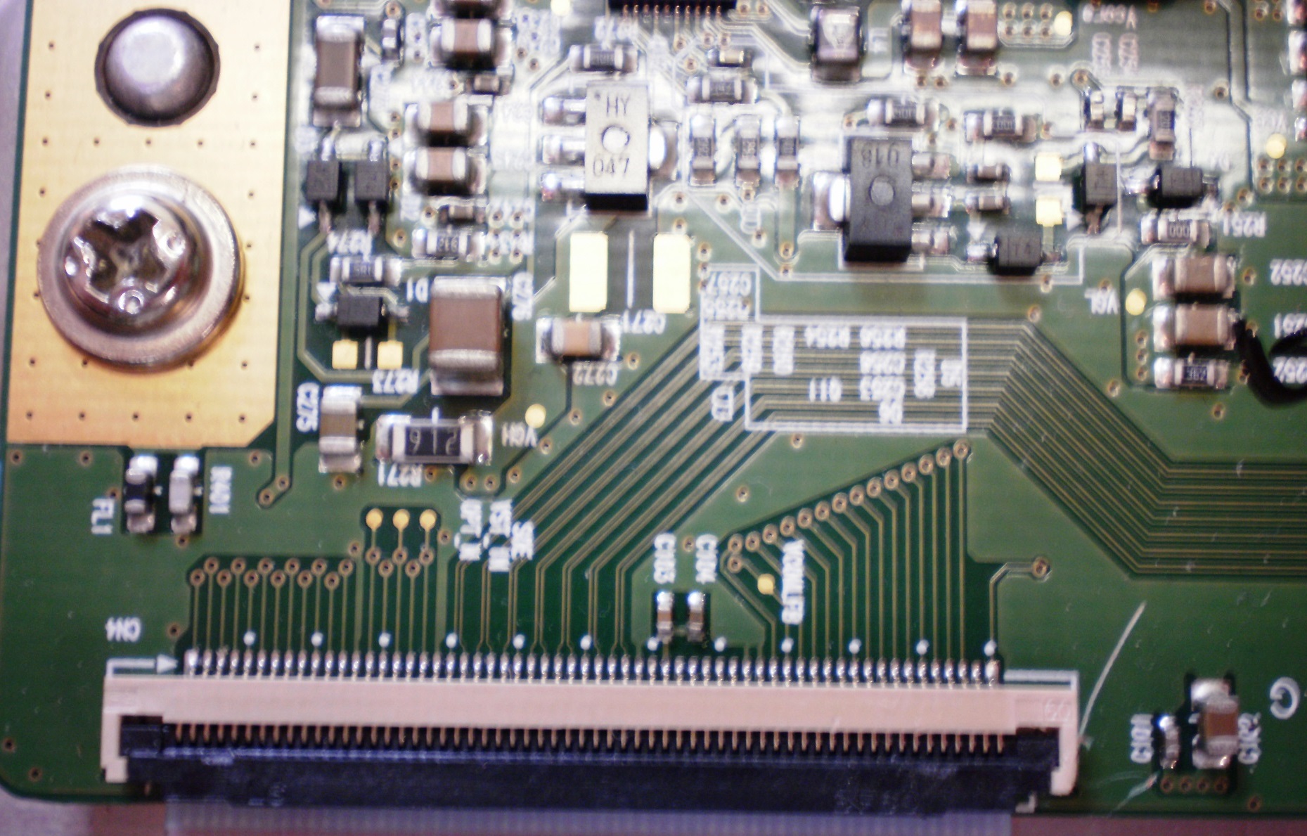

              I will take a picture, because the shopjimmy picture is bad.
              • tibimakai
                • Jan 2012
                • 3680
                OK, here are some pictures, though it's still hard to see the markings. Even when I look at at them up close, it's hard to see them.
                If needed, I will take some microscope pictures too, just let me know.
                Thank you for trying to help.
                  AVDD check voltage across C237 top right corner of this photo https://www.badcaps.net/forum/attach...8&d=1398637689
                  about 14~18V
                  VGH: R271 near bottom left
                  VGL: C252 middle left
                  gamma voltages GMA1 thru GMA18 far right
                  Vcore: C219 (probably 1.2V, 1.5V, 1.8V)
                  VCC: C212 (probably 3.3V)
                  do all with and without panel hooked up
                    AVDD= 16.71V
                    VGH= 29.83V
                    VGL= 5.029V
                    Gamma voltages:
                    I'm still not sure about there order, but I will start from lower right test point, the going up, then down and so on in zig zag pattern.
                    1= 0.001V
                    2= 14.37V
                    3= 13.62V
                    4= 12.55V
                    5= 10.58V
                    6= 0.001V(?!)
                    7= 0.001V(?!)
                    8= 6.226V
                    9= 4.226V
                    10= 3.176V
                    11= 2.454V
                    12= 0.001V
                    13= 0.001V
                    14= 1.656V
                    All the measurements, are the same with panel connected or disconnected.
                    Vcore= 1.006V
                    Vcc= 3.312V
                    12V at the fuse is 11.92V
                    Gamma voltages don't look good.
                    Gamma IC could cause this issue?
                    Which one it would be the gamma IC?
                    Thank you Tom for the great help.
                    I would also need help with a Sony KDL55EX720, it seems that I'm not getting much help with that TV. It's a 3D 55" and I would like to see it on. You know how it is.
                      Gamma IC is probably U3. to confirm try googling part #s. looks like it might be a Maxim chip and they make a lot of gamma references.
                      Gamma voltages might cause your issue, but it is strange, I would only expect a distorted picture.
                      I don't know if you can replace U3 easily - it's a QFN (leads are not exposed) - I struggle with those at the best of times...
