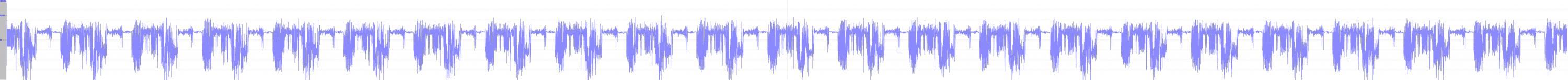

    You can see each of the differential pairs going into the T-con processor. They are the little traces that bunch together at the top of this board.
    https://www.badcaps.net/forum/attach...8&d=1398637689
    Pick a few, (doesn't matter which, try to get a random selection) and record what you get from them.
    Set your scope to 500mV/div, 1us/div, trigger level 0V, bandwidth limit OFF, AC coupled.
    Use the RUN/STOP button to pause the waveform, then take a photo or export it using the USB port.

                    Finally I had some time to work on this TV.
                    To me it seems like there is video LVDS signal before the T_con IC.
                    How would I show you the wave form?
                    I have also noticed, that the main board's main processor, gets to hot after a while and shuts down.

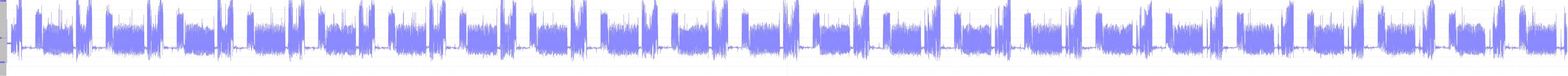

                      OK I have used WFMReader to save these files in jpeg format.
                      I have also noticed that at one of the pins(VGH_F) the voltage was once 29V then changed to -5V and then back to 29V and so one. I'm not sure what this means though.

                          Re: LG 42LV5500 only backlight on
                          These are, the right LVDS signals or not?
                            #33
                            I have never seen the readings presented like that. However it looks right. One test you can do is to press the menu key, for example. The LVDS signals should visibly change. Do they?
                              I will measure when I'm home. I didn't thought about doing that, good idea.
                              It's hard to get to the right input without an image on the screen.
                              When I did this measurement, I had sound for a second and then went away. I assumed that the video it was still running.
                              Last time, when I worked on this TV, the sound it was very loud and I could not adjust the volume.
                              I did as you said, to set the scope. Then, I used Save to external storage and I have used that software, to take a snapshot from the wfm file and saved it as jpeg.
                              I believe, that software is a Rigol scope software.
                                OK, there is definitely change on the scope as I stop the movie, or select menu.
                                The main CPU on the main board is getting really hot. I have measured 51C deg. and I didn't want to keep it on to don't damage anything.
                                Last time, I have left it on for a bit longer, it started rebooting.
                                With or without ribbons connected to the panel there is no difference at all.
                                There is only backlight on. No video signal at all.
                                I don't like those missing voltages at the gamma test pints.
                                I could have got a bad T-con board?
                                Initially, both the old and "new" boards were showing the same exact voltages and the missing voltages were missing on both boards in the same spots.
