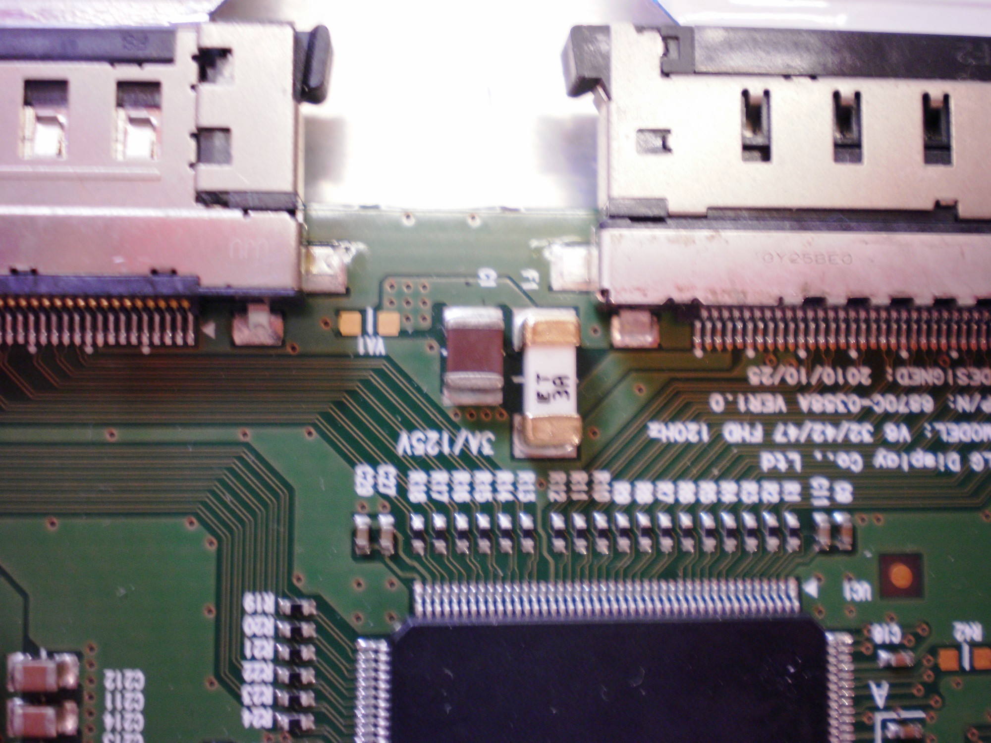

    I have checked the fuse at the T-Con and it's good.

      12V both ends of T-con fuse?
        Re: LG 42LV5500 only backlight on
        Yes, that was the first thing, that I have suspected and I was almost 100% sure that is the problem with this TV.

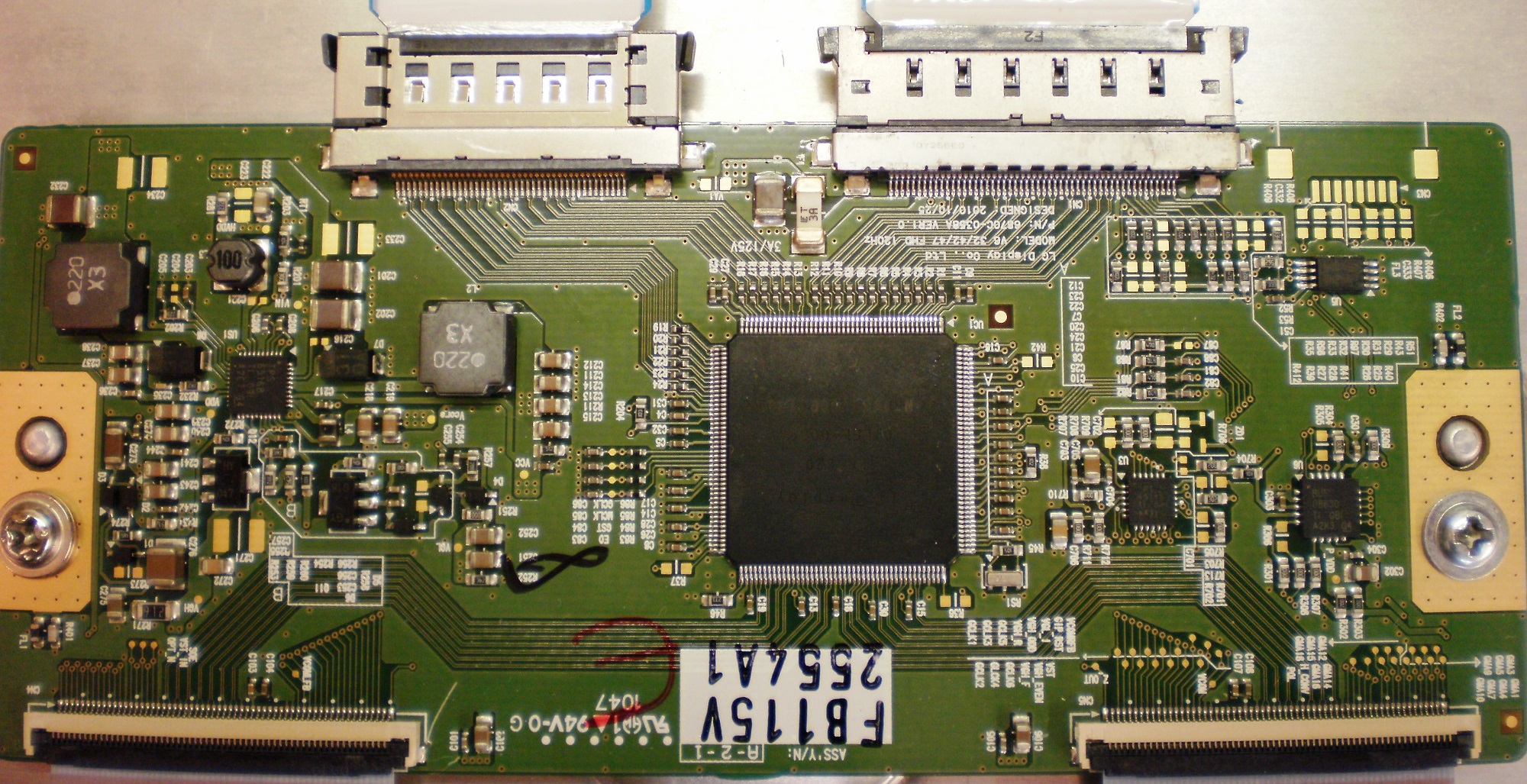

              I will take a picture, because the shopjimmy picture is bad.

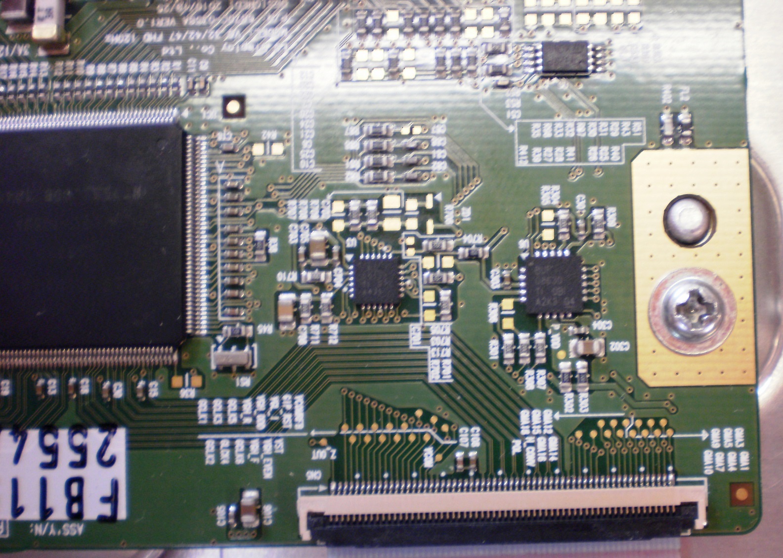

                OK, here are some pictures, though it's still hard to see the markings. Even when I look at at them up close, it's hard to see them.
                If needed, I will take some microscope pictures too, just let me know.
                Thank you for trying to help.
                  AVDD check voltage across C237 top right corner of this photo https://www.badcaps.net/forum/attach...8&d=1398637689
                  about 14~18V
                  VGH: R271 near bottom left
                  VGL: C252 middle left
                  gamma voltages GMA1 thru GMA18 far right
                  Vcore: C219 (probably 1.2V, 1.5V, 1.8V)
                  VCC: C212 (probably 3.3V)
                  do all with and without panel hooked up

                      Gamma IC is probably U3. to confirm try googling part #s. looks like it might be a Maxim chip and they make a lot of gamma references.
                      Gamma voltages might cause your issue, but it is strange, I would only expect a distorted picture.
                      I don't know if you can replace U3 easily - it's a QFN (leads are not exposed) - I struggle with those at the best of times...

                          This is U3:
                          http://www.ti.com/product/tps65194
                            I guess, this one is the gamma IC (U6 the one on the far right):
                            https://cdn.badcaps-static.com/pdfs/...746ad8e194.pdf
