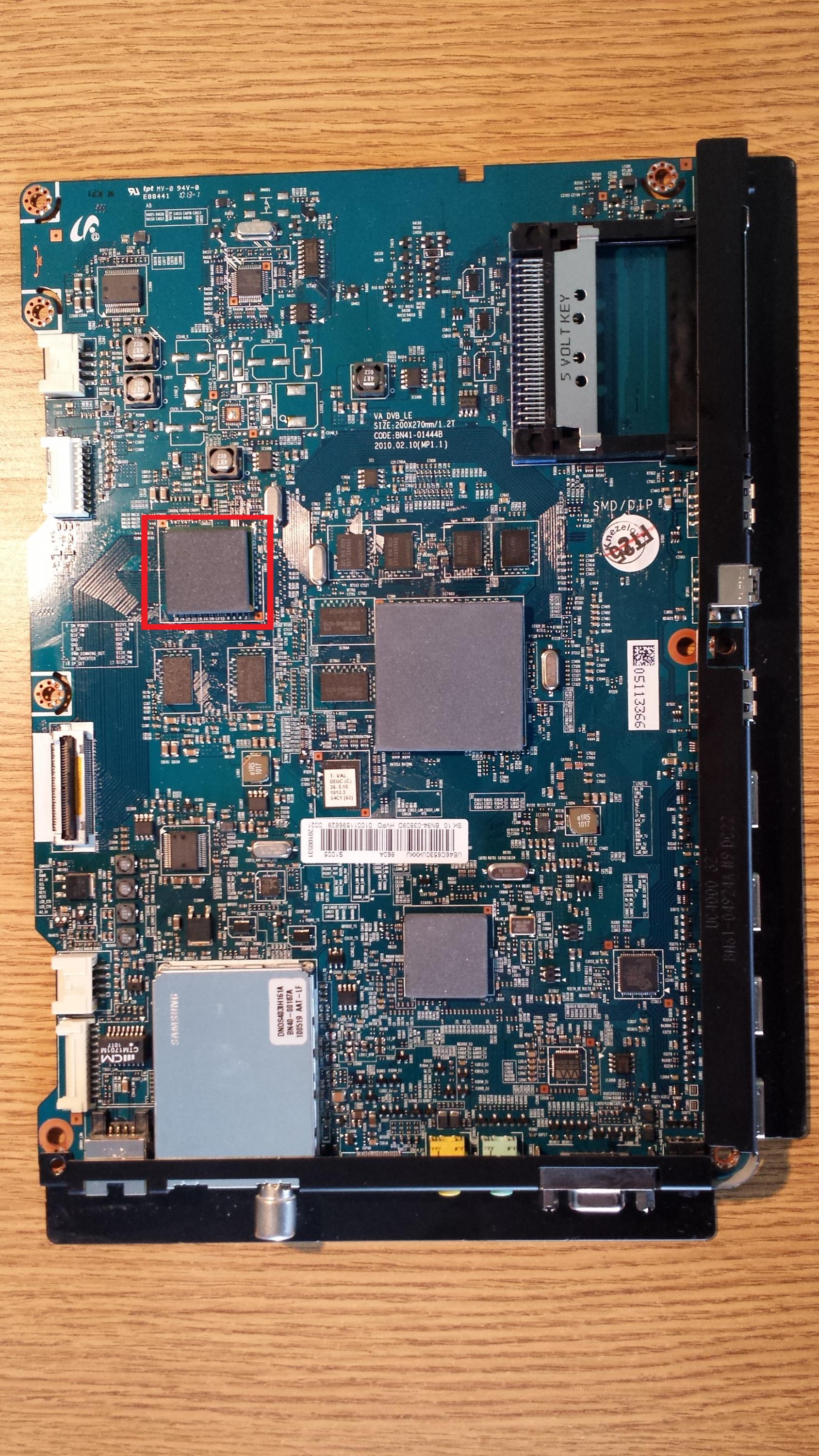

    So yesterday i picked up this UE46C6530 LED TV as i was after a C series main board (BN41-01444) for my other TV which was on the bench... (https://www.badcaps.net/forum/showth...t=35344&page=2)
    The seller described the fault as "Vertical colored lines" on all inputs and also in the image diagnostics so i assumed it was a panel / T-Con / AV fault (The dark smudge in the top left corner is the cling film the tv was wrapped in).
    I was hoping it was not a panel fault as the lines covered the full width of the screen; not just discrete portions and the line colors didn't change with the picture behind them - This made me think this MAY be a T-Con or AV issue?
    I remember seeing something similar on a laptop which needed a GPU reflowing (broken solder joints under the GPU chip) So i started pushing on each of the 3 heat-sinked SMC's on the AV board...lo and behold, as soon as i put some pressure on one of the chips (highlighted in red) the image cleared up... and went back to funny lines as soon as i stopped applying pressure.
    Has anyone had anything like this happen before? Any suggestions as to how i can fix it? Unfortunately the main boards are fairly rare/ Pricey!

    Re: Samsung UE46C6530 Vertical colored lines accross screen
    cold soldee joints under bga chips is very common. If anyone local to you has rework equipment they may reflow or reball it for you at not too much expense. You could heatgun it but theres always a risk you will kill the chip/board when heatgunning things. leadfree solder needs to be around 217c to be reflowed
      Hi wills,
      Thanks for the reply. Is that the BGA Chip then?
      I will look around and see what my options are... i have previously successfully reflowed some equipment in my microwave oven (set to the oven mode... Obviously) but dont want to subject everything to the heat...
        it looks like it has the solder balls underneath it from the photo to me, the fact you press on it an all works ok, points to cold solder joint under it Yeah ive heard of people ovening things but wouldnt reccomend it lol. i have ir rework machine though so have it easy lol
            Update
            Just a quick update - I did a heat-gun reflow (did lots of research and hopefully did a decent job of it using flux and a IR thermometer) and the vertical lines cleared up!
            Been using the same board in a different TV for about a week now and so far so good... I also added a few more thermal pads to maximize heat extraction out of the surrounding components and keep everything cooler....
            Thanks for the help all and hope this helps everyone.
