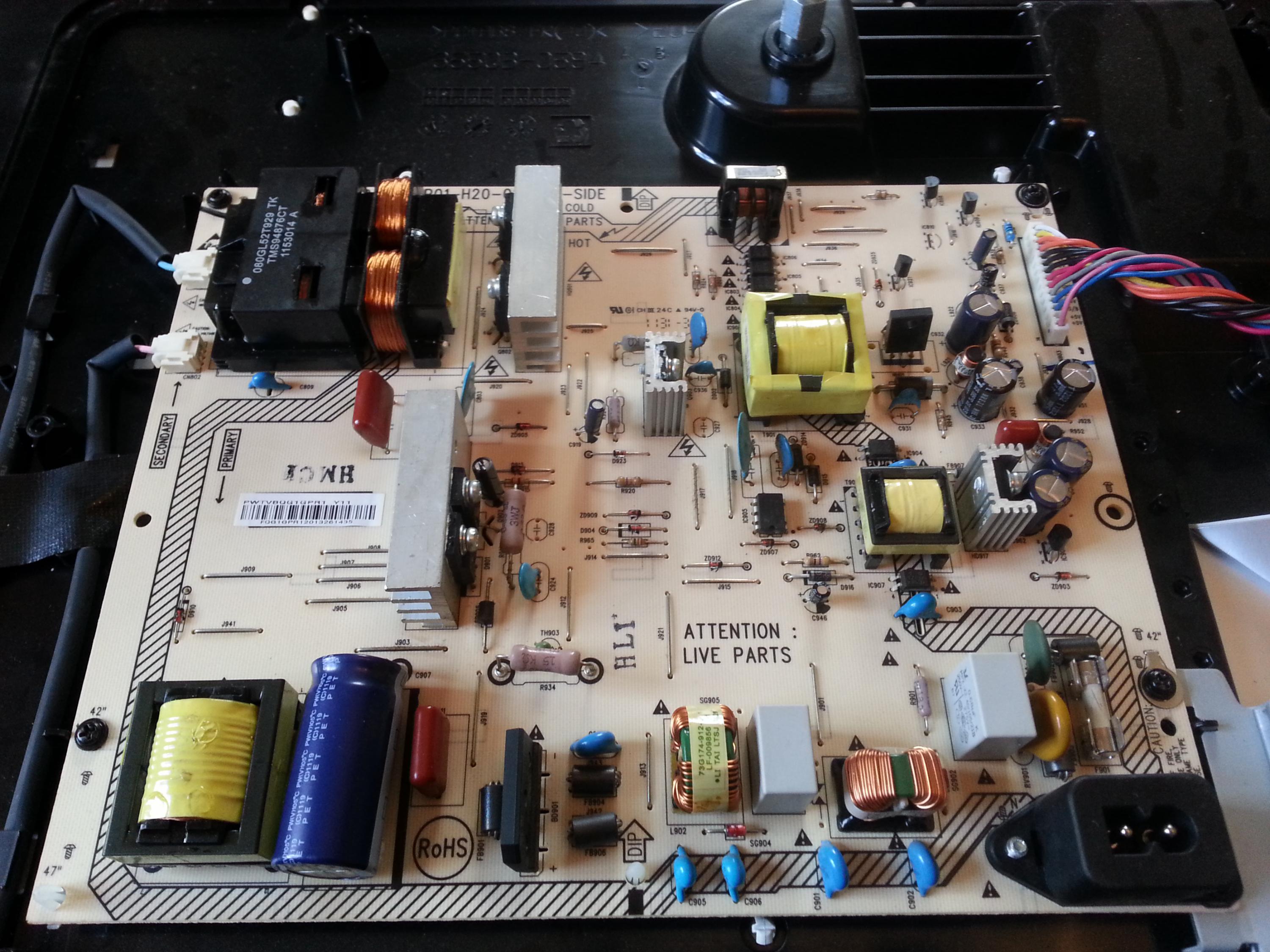

    Hi guys
    I'm looking for some help fixing a problem with my TV and and found myself on this great site. I've done a lot of reading on here and thought I had found the solution but haven't so I decided to join and post my own thread.
    The problem
    I was watching the TV one day and just heard a slight pop/hiss sound like the noise the TV used to make when I first turned it on and and after that the screen went black but the sound continued. When I turn it on now I don't hear the noise it used to make when turning on and there is no sign of life on screen. When I shine a light on it I can see the picture faintly so I know it's the backlight.
    What I've tried so far
    My friend also bought the same TV on the day I bought mine and I had him bring his Woking one over and we opened them both up. when I switched the main power board (the one the ac plug slots into) my TV worked perfectly(including the little little noise I used to hear when I turned it on first pre-problem) so I know the problem is with that board. Next, after reading some posts here about similar problems I checked all the caps on the board and although none looked to be bulging or damaged I decided to change them all jus to be safe and because it seemed like the easiest solution but after ordering the caps and changing them all today I still have the same problem.
    I'm wondering where I should go from here to fix this as this is a relatively new TV It had just gone out of warranty when the problem happened and I don't want to have to scrap it already and I've tried to find a replacement board for it on the net but it proving very difficult. Also probably worth saying I'm in Ireland where we run on 220v power.
    I appreciate any help you can give me and will keep this post up to date.
    Cheers lads,
    Dave

    To get the best help,I would post good and clear pictures off the boards.
    specially the main board in this case,try a few close ups from the front AND the back of the board,try and include a pic of the plug that runs from the powerboard to the mainboard as well,so the guru's here can see what voltage etc goes where...

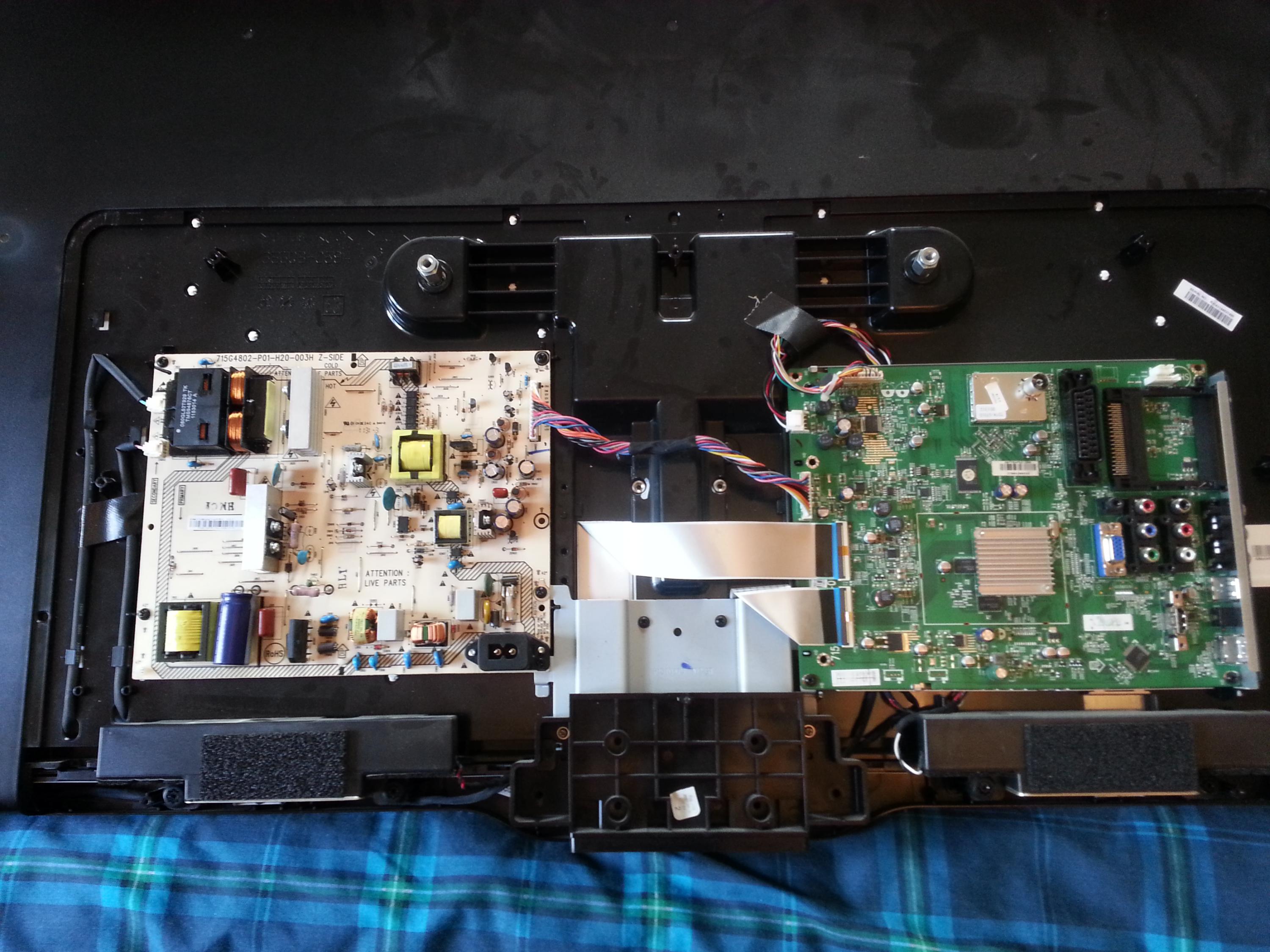

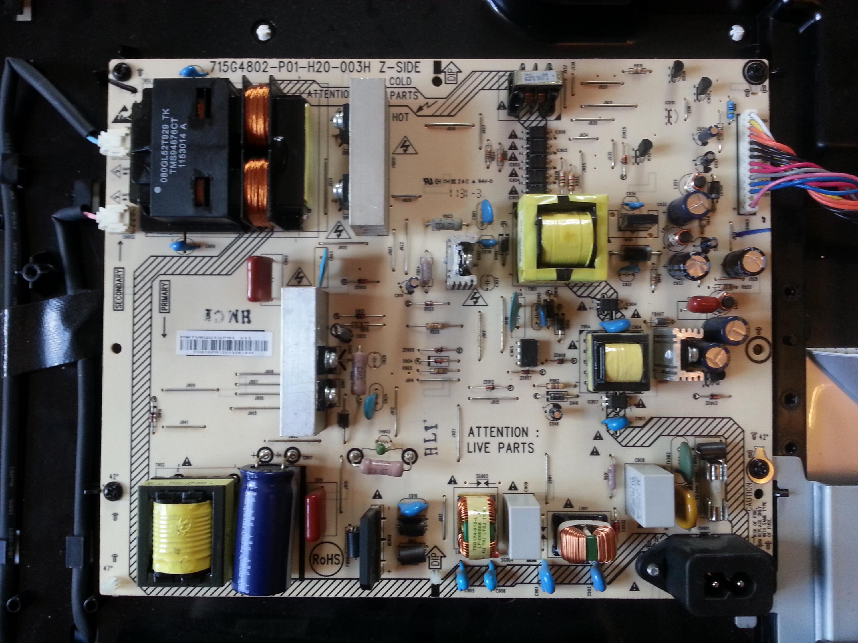

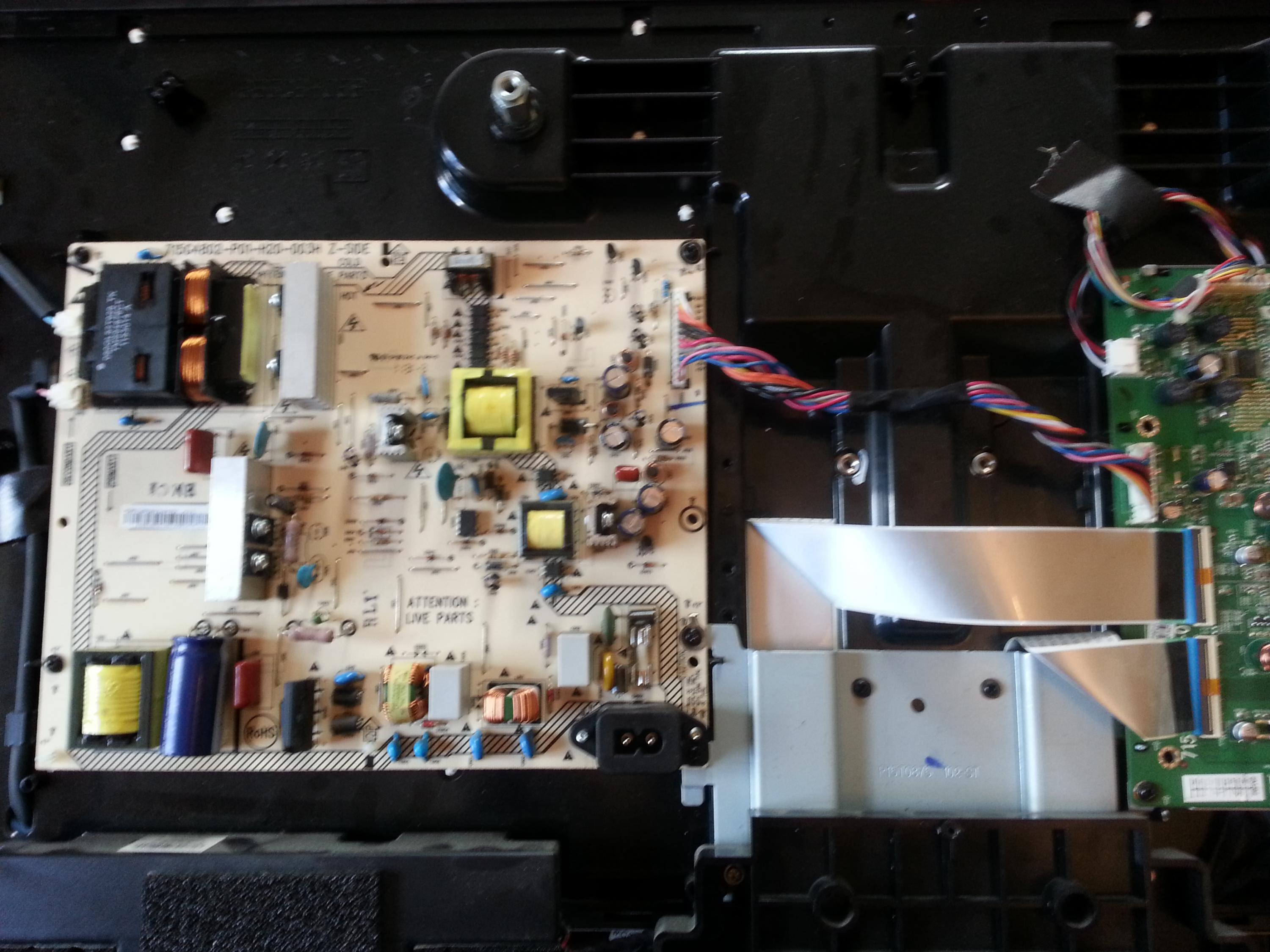

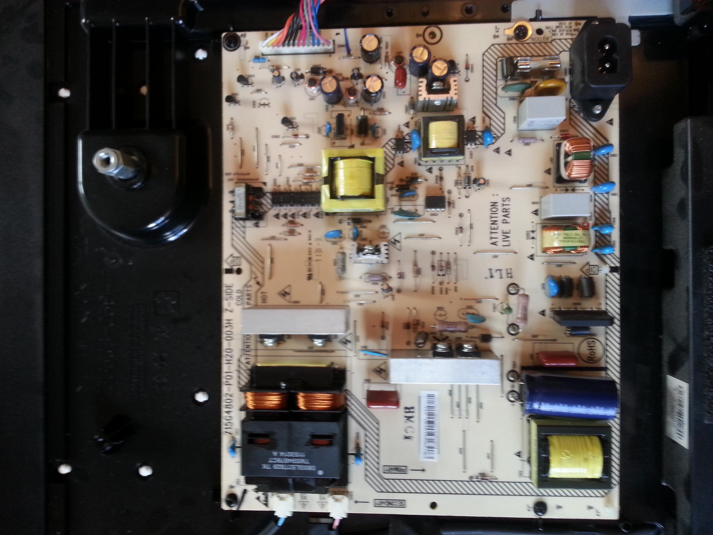

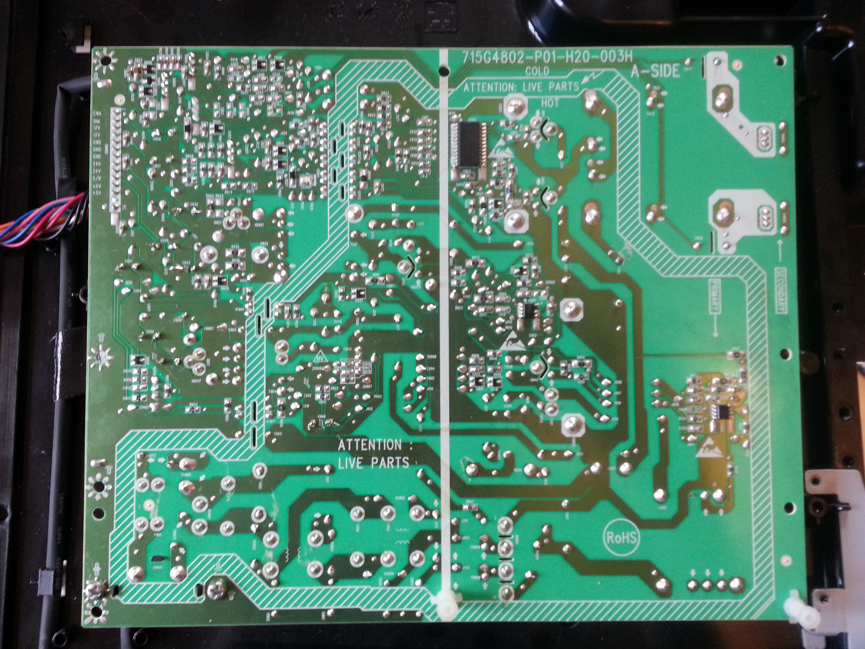

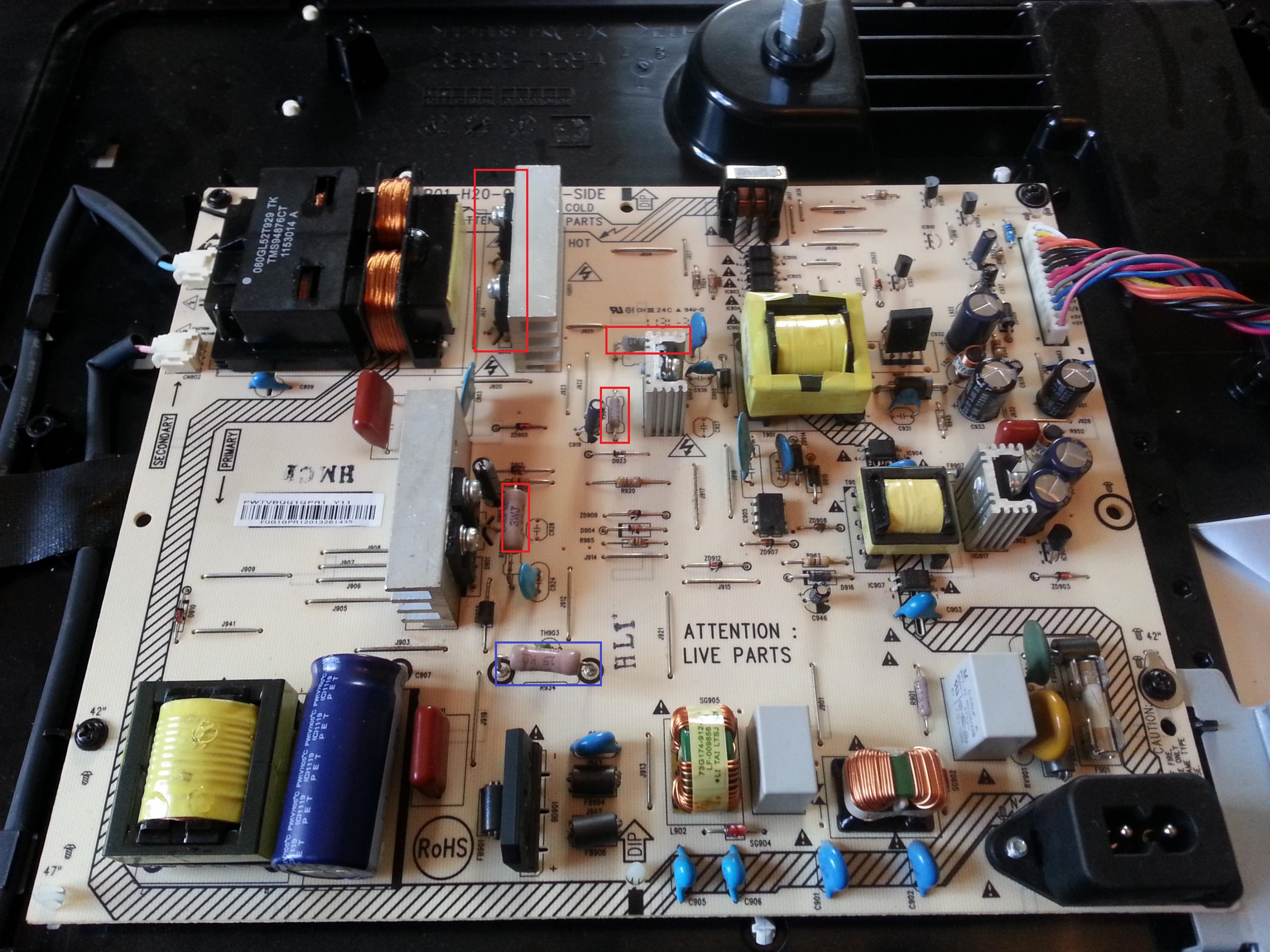

        Re: 42pfl3606h/12 Phillips tv powersupply/backlight problem
        These are the photos I have taken if there are any more needed please let me know
          since you have a combo board I would check to see if the mosfets feeding the inverter are shorted out, then look for an open resistor feeding them. I outlined some suspects for you to test.
            Thanks for the reply, I have a multi meter here but haven't done any testing on these kind of things before, what am I lookin for when I test it?
              The mosfets should read high ohms (several kohms and up) between the three legs of each mosfet, the resistors should match the value printed on them. you can use diode mode to check the mosfets as well if you get a continuous beep then you likely have shorted components.
                Tried to test today but I got a spark and crackle out of it and decided I might be in too deep:/ I've never done this before but the way I attempted it on the advice of a similarly clueless friend was set the dmm on ohms and touched the black lead on an earth and the red one on a leg of the mosfet and got a high reading for a second but when I tried to touch it again it sparked and some smoke came out of it so I haven't touched it again. Have I blown it beyond repair now?
                            Well if you let the magic smoke out of those mosfets they will need replaced for sure now. You should always have the set unplugged when testing for faults on the power board, also a good idea to discharge the main caps with a large resistor before working on it. once you have verified all the components are ok then you plug it in to do voltage checks. You likely shorted the lead with a stored charge to ground, Sometimes if you only get an arc it doesnt do any lasting damage, but if your mosfets were smoking they are done for.
