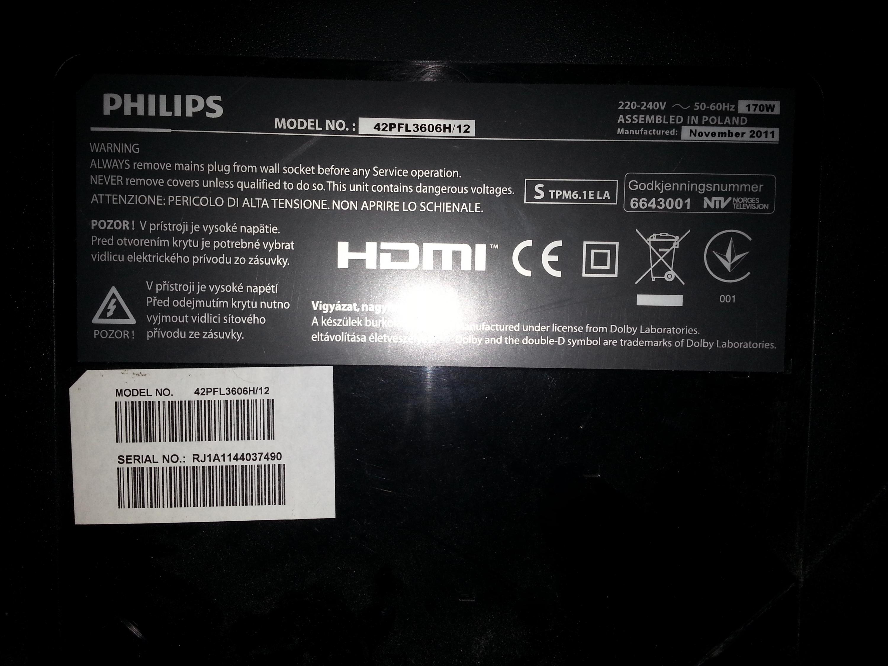

            I looked without success off your model number, can we get a picture of the sticker on the back to see what the chassis number is?

              Is this the sticker your looking for?
                Re: 42pfl3606h/12 Phillips tv powersupply/backlight problem
                Yes the chassis is TPM6.1E LA, with that info I did find a service manual. The power supply appears to be made by Bush, I found several that were very close, but none with the same number (715G4802-P01-H20-003H) Im wondering if there was a more popular version with the same pinouts made? Unfortunately all of our resources on this side of the pond do no good for a European version. I found an amazon listing but of course they are out of stock

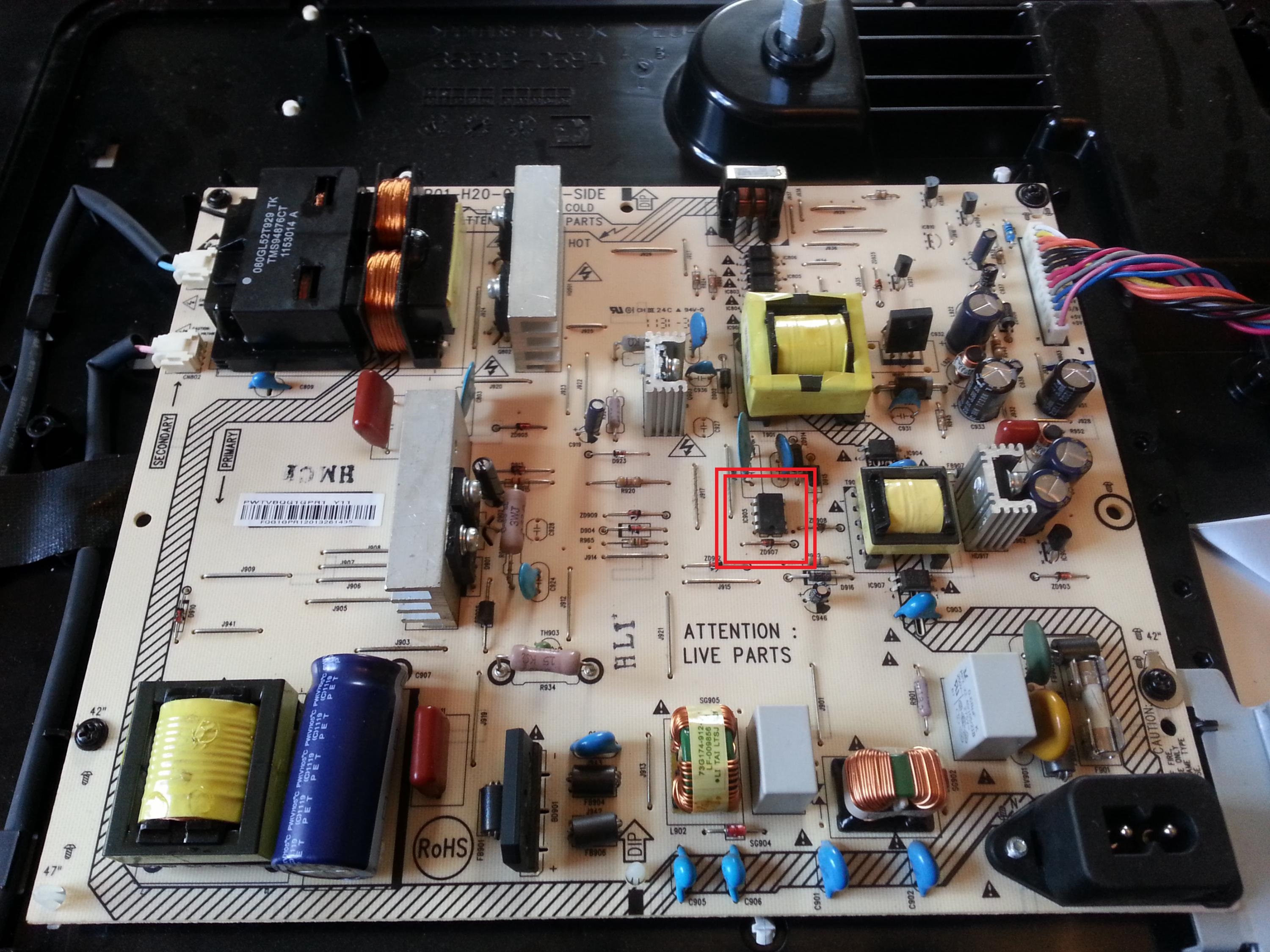

                  Did you have any look with your tv?i have the same tv as yours and one part on the board blow up the last day..IC905..just wondering if you got another board some where.
                  thank you

                    Since you now have no power at all have you checked the fuses? If any have popped you will need to check for a short beyond the fuse before trying a replacement. With the meter on an ohms setting and power applied you will be applying a low resistance across anything you apply the probes to, so the outcome is always likely to be a pop. Always test resistance with the power off.
