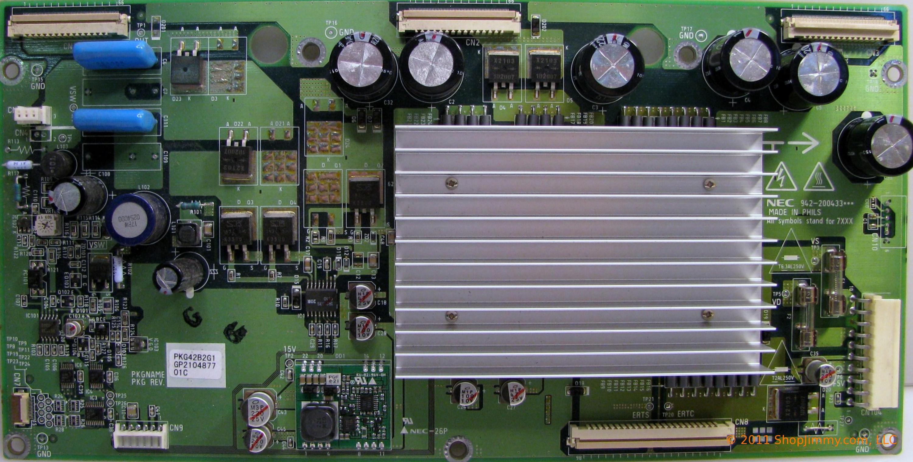

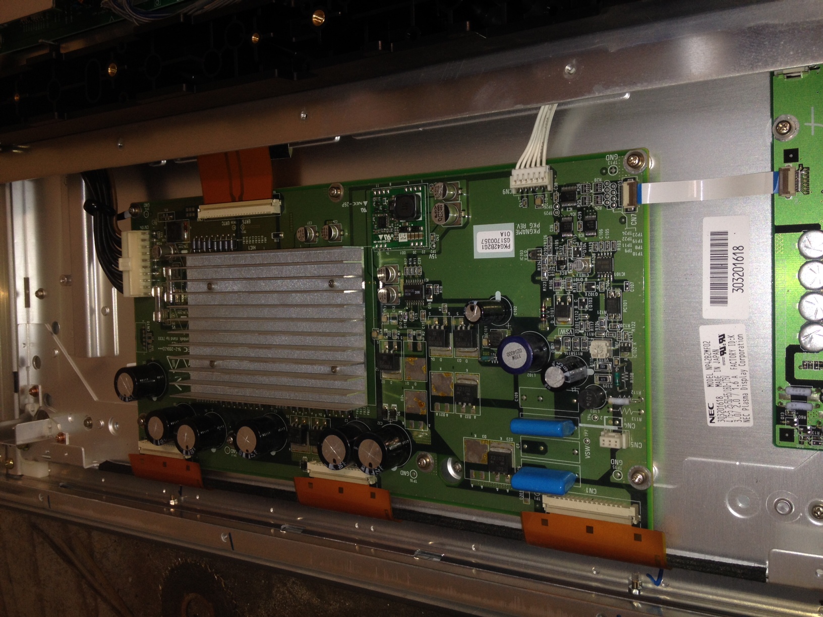

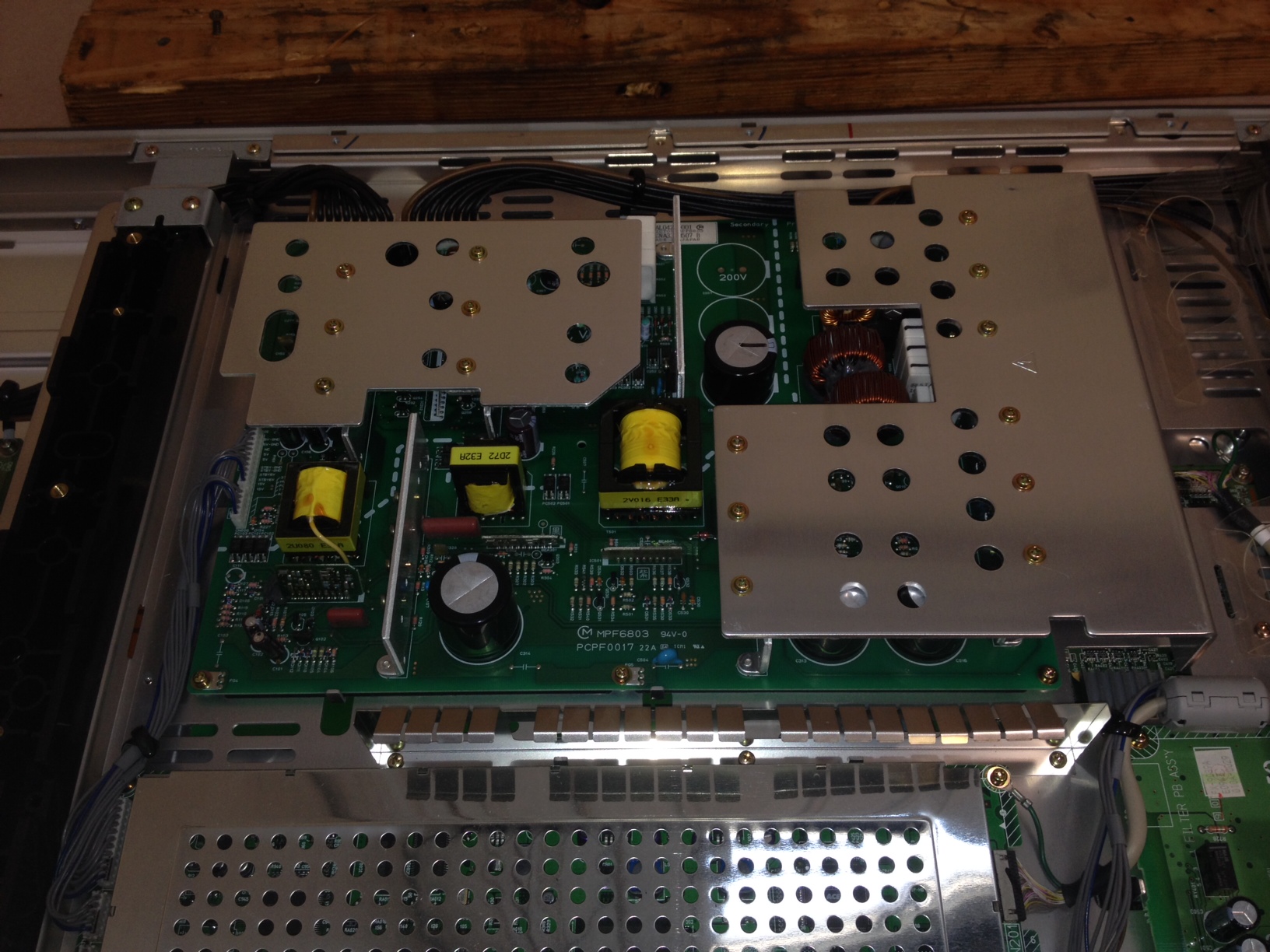

            Here's a picture of the PS and X Main boards.

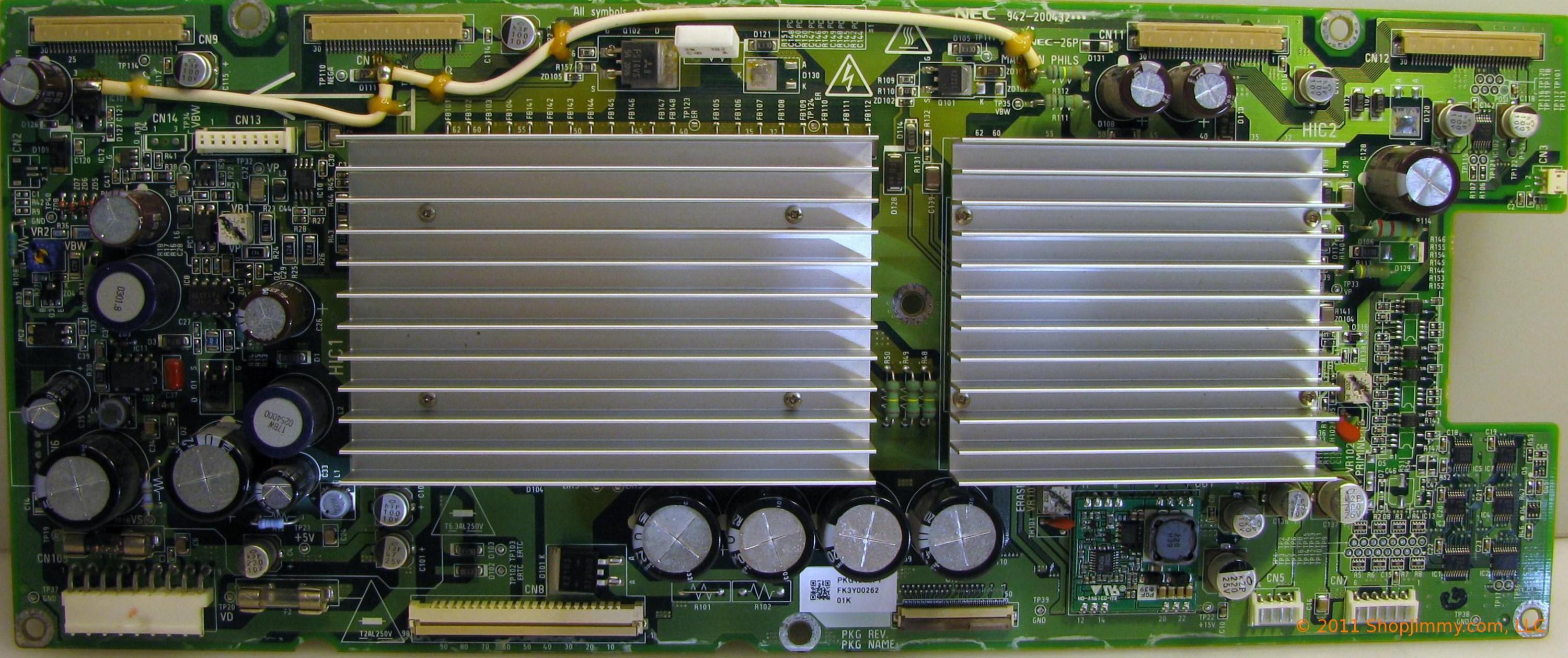

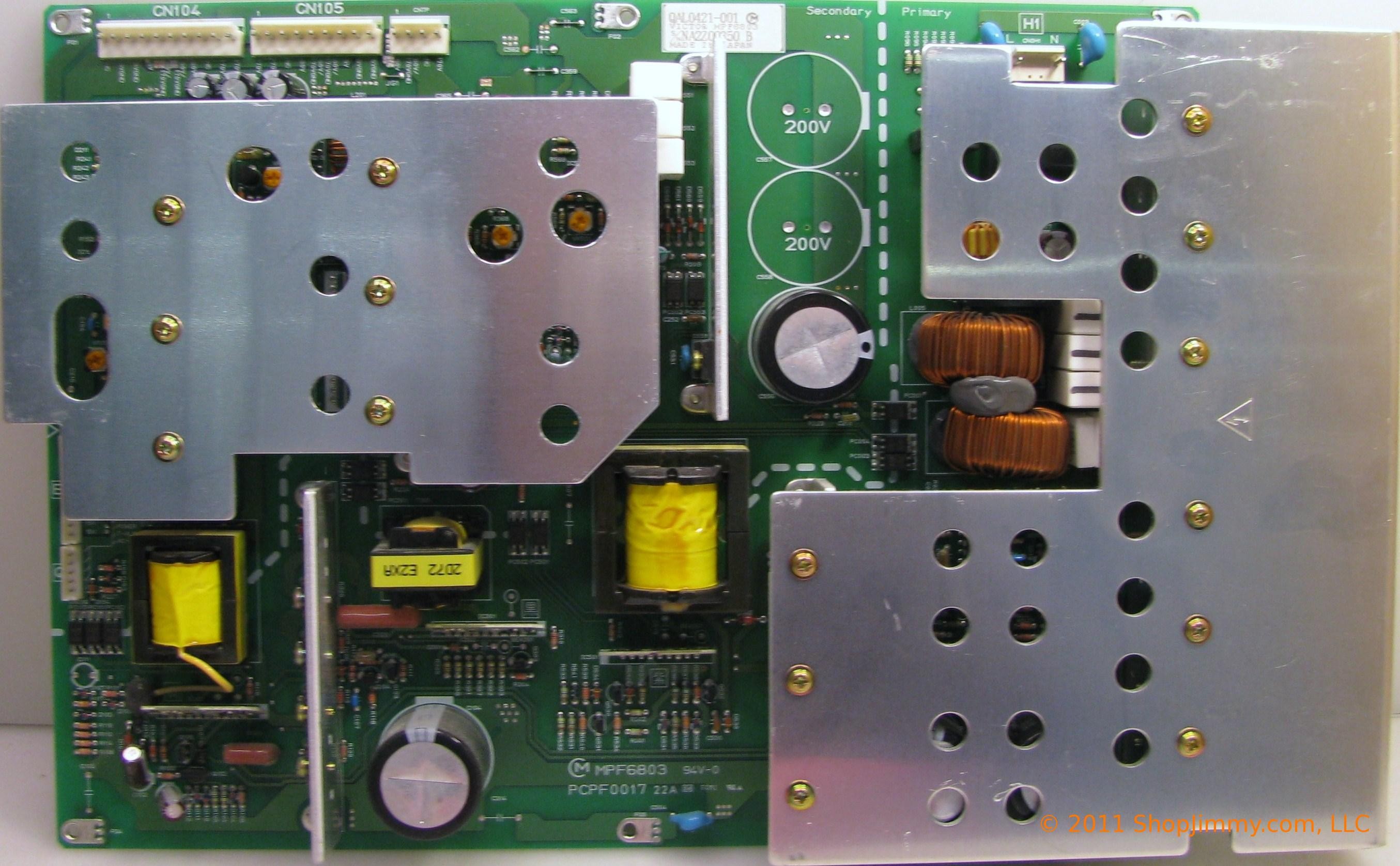

                          I found some better pictures of the boards....
