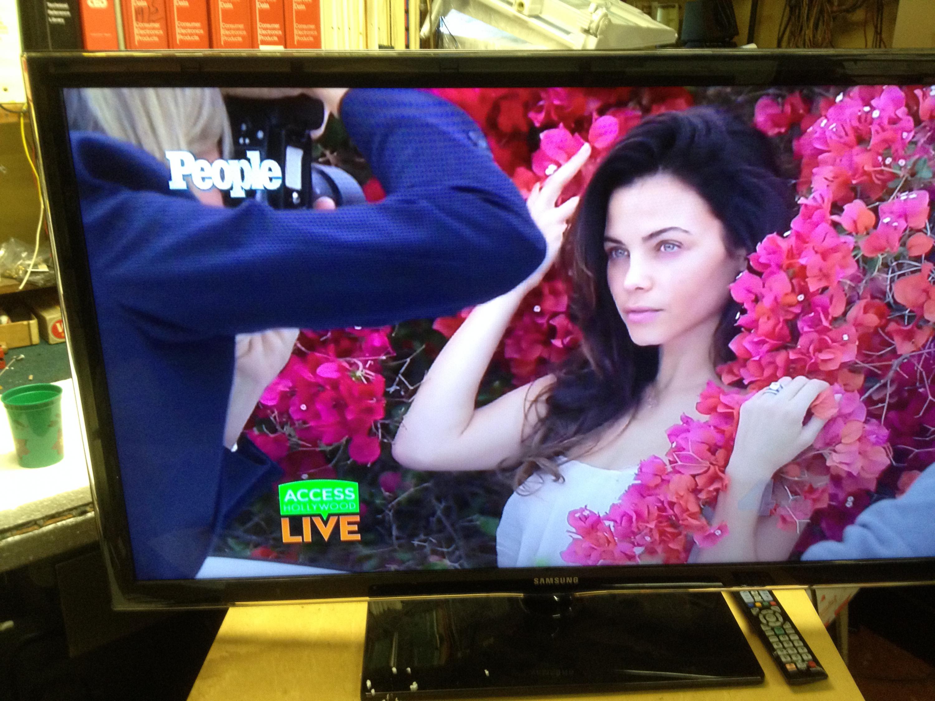

    I have a Samsung 46in LED TV M# UN46D6003SFXZA. The screen goes from bright to dark and back and forth. The backlights do not seem to be dimming at all when you stand behind the TV. The voltages from the power supply to the backlight do not change when it goes dark. The picture kind of looks like it is flooded with red.
    Has anyone had this happen? I went into the servicer menu and reset the factory settings and this did not help. I am leaning toward the main board being the problem.

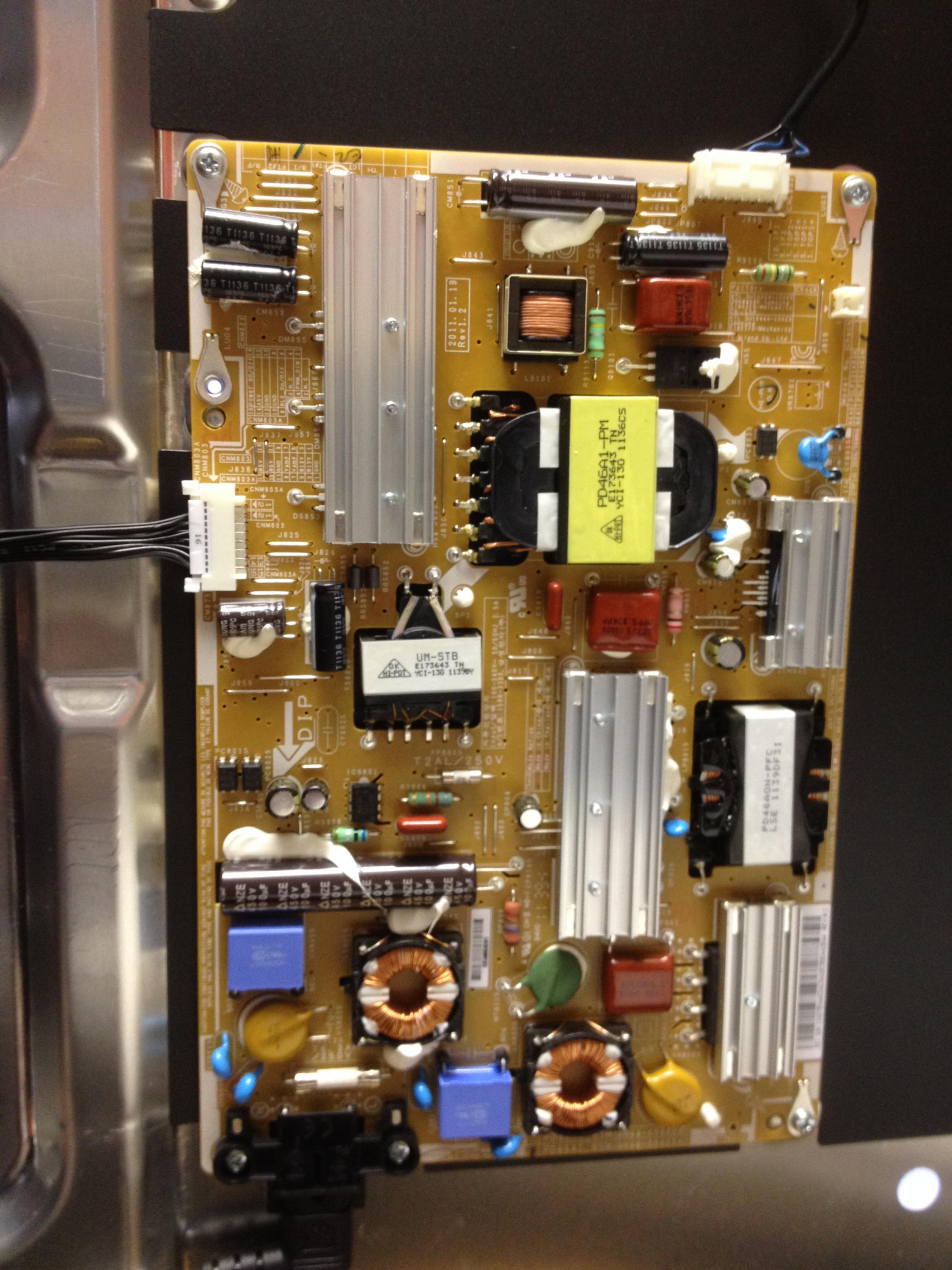

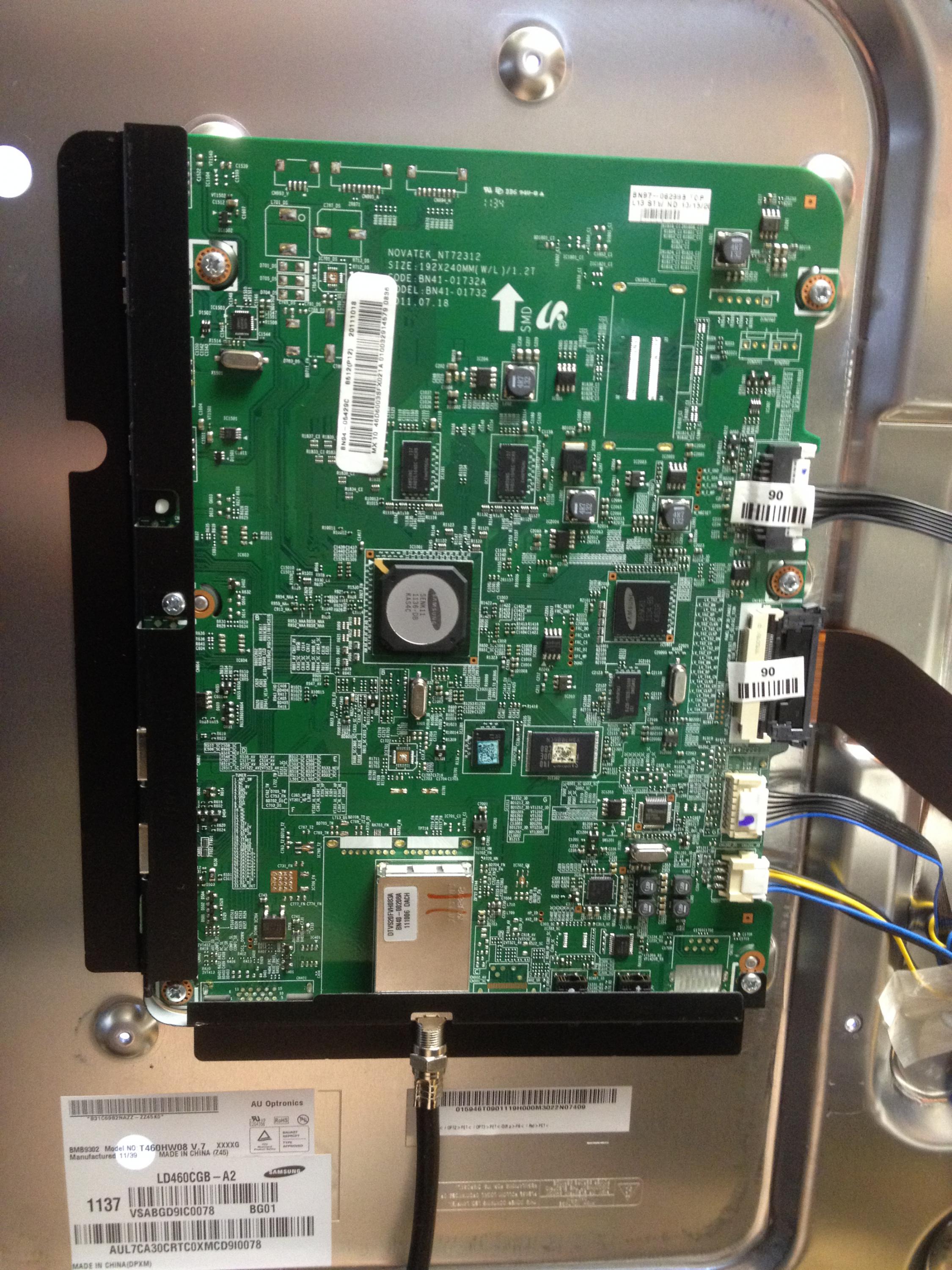

    I will post pics of the boards shortly.

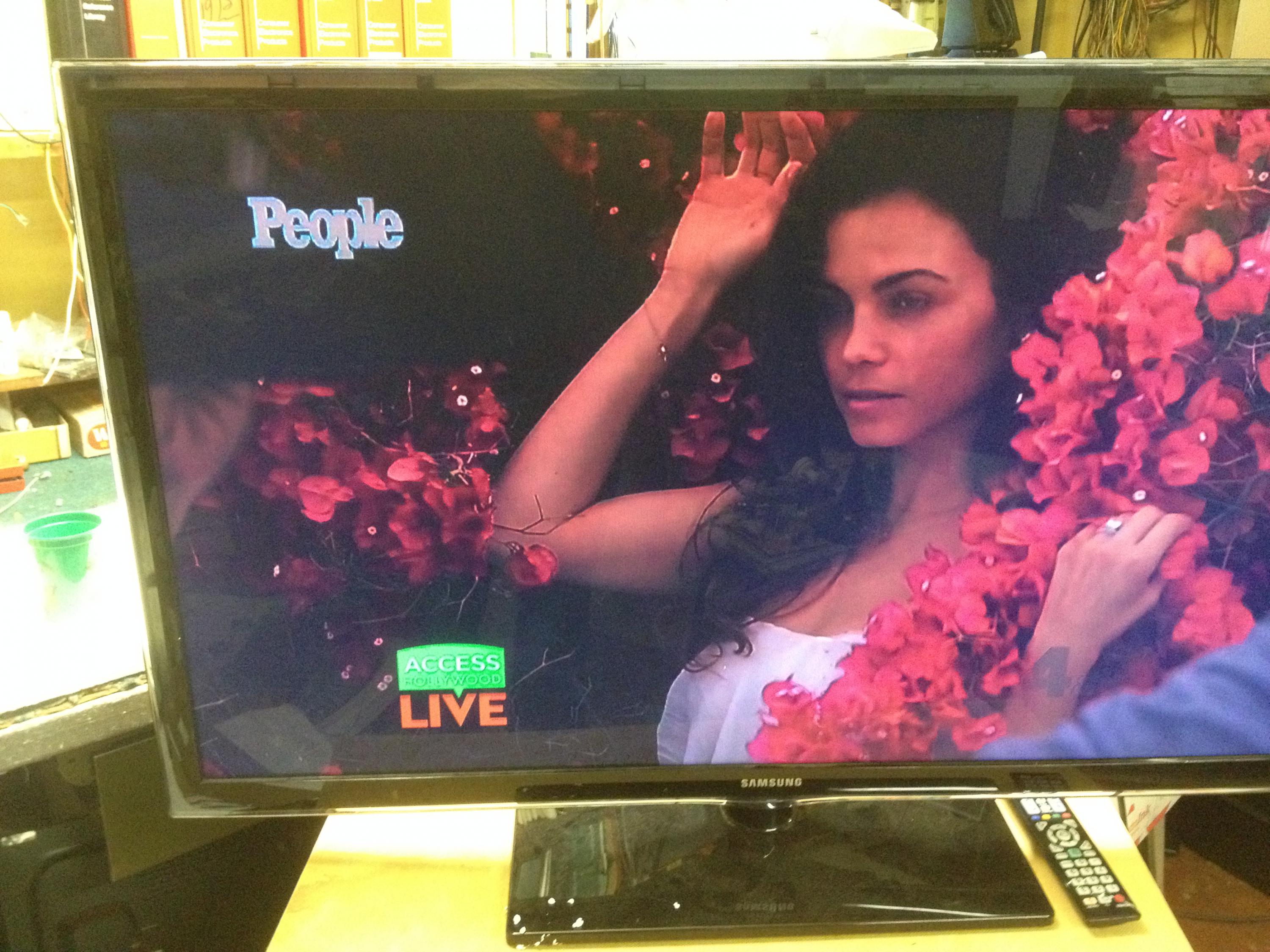

    Re: Samsung UN46D6003SFXZA screen dark then bright
    here are the pics of the boards and the difference between when the picture is bright and dark.
      Hard to tell - Can you see what a "black" image looks like on the panel to see if the backlights drop out.
        • 31196
        i think your losing some blue bits - maybe a bad buffer ram or bad soldering on the scaler chip.
            I am assuming that the buffer ram and scaler chip are on the main board?
              • 31196
              they are.
              scaler chips often get *very* hot and should have a heatsink stuck on them - but often they dont bother to save money!

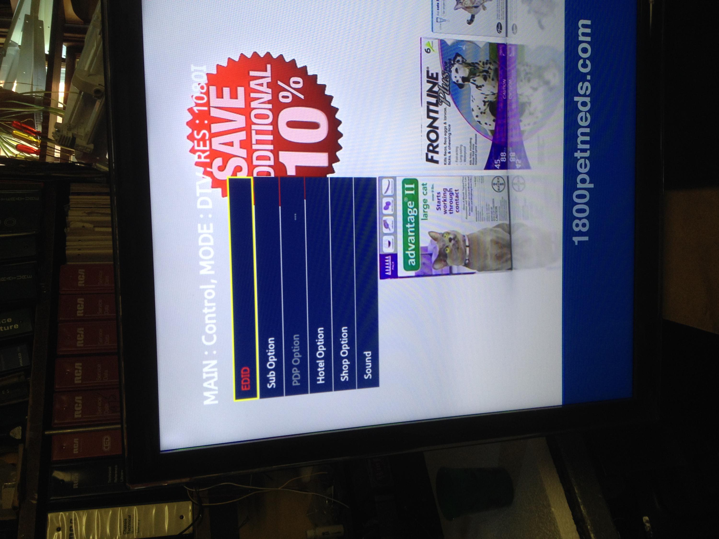

                First I think check the backlights, but if they don't dim you can check the scaler from the service menu.
                Just put TV into standby and press Mute, 1, 8, 2 then power it on.
                Then access Control > Test Pattern
                there should be about 3 generators there which lets you narrow it down to T-con/Panel or main board.

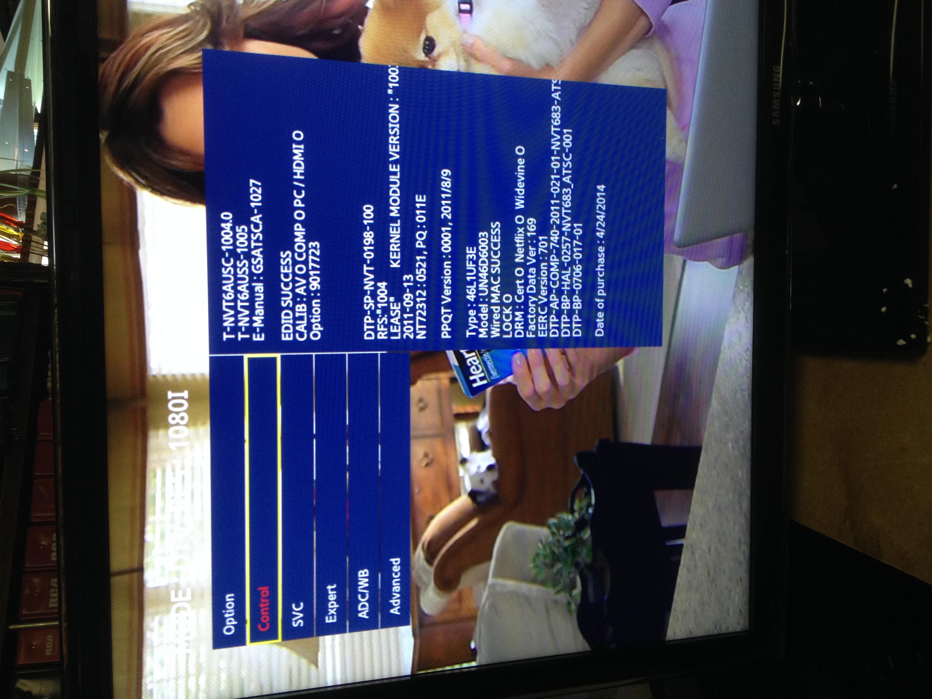

                  I can not find a test pattern under the control in the service menu.
                    Can you show a picture of what you've got instead? I'm using what I did on a B-series LED as reference.
                    edit: page 3 bottom right, try that
                    • aasnowskate
                      • Jan 2013
                      • 118
                      • usa
                      here is the pic of the menu and then the next menu when control is selected.
                        See my edit.
                          I went through all the test patterns and they looked fine, but the screen was still darkening and brightening the same while going through the tests.
                            So you will need to check the backlight for us. Any BLACK test pattern? Turn all lights out. If the black level (the slight blue or grey glow from the panel) varies, then the backlights are causing your problem...
                            If not... it is the panel or T-con.
