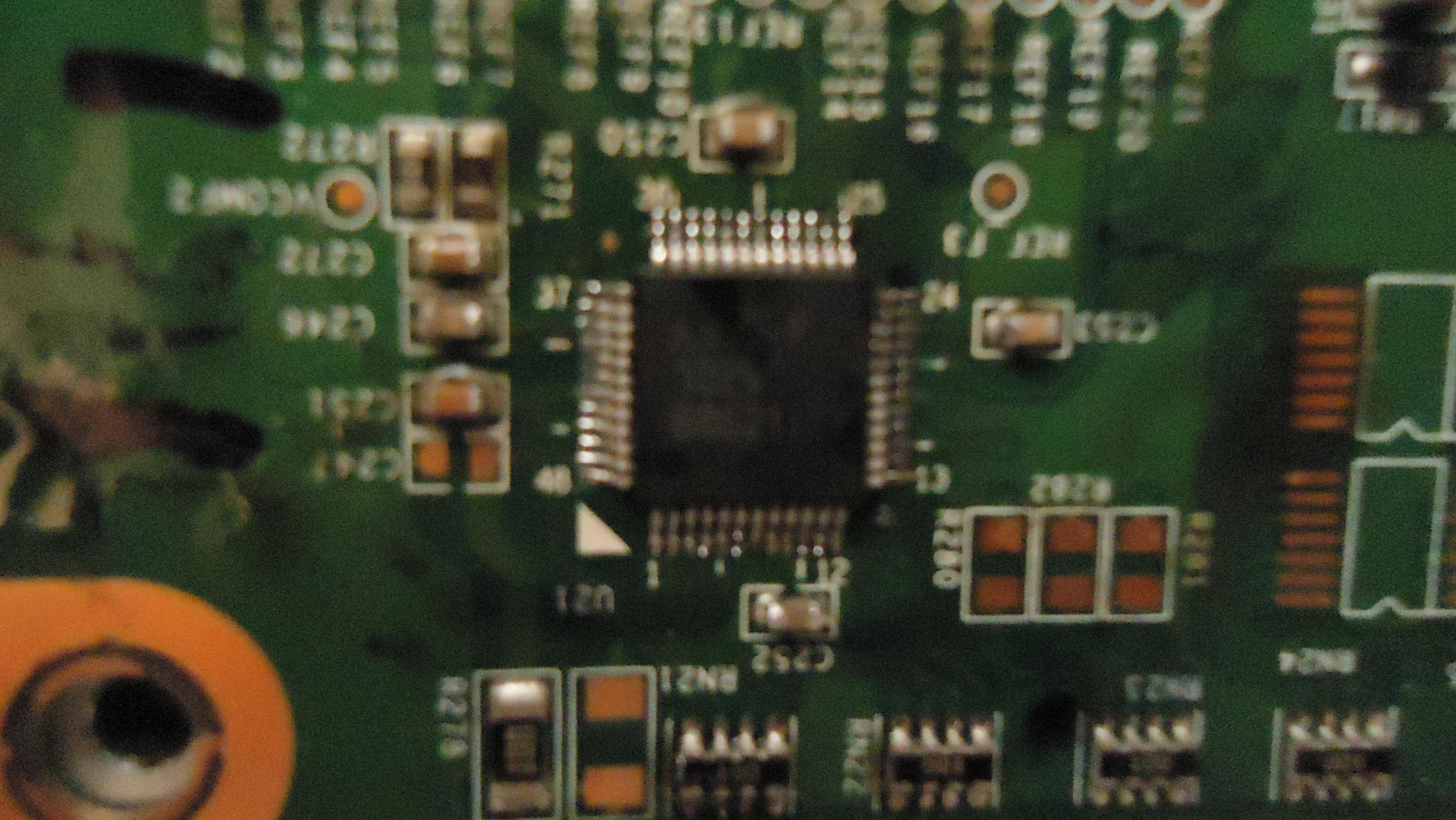

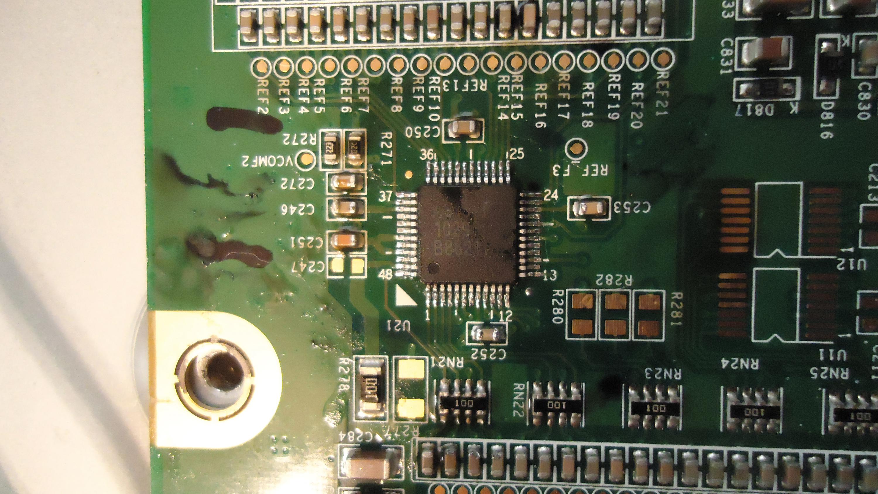

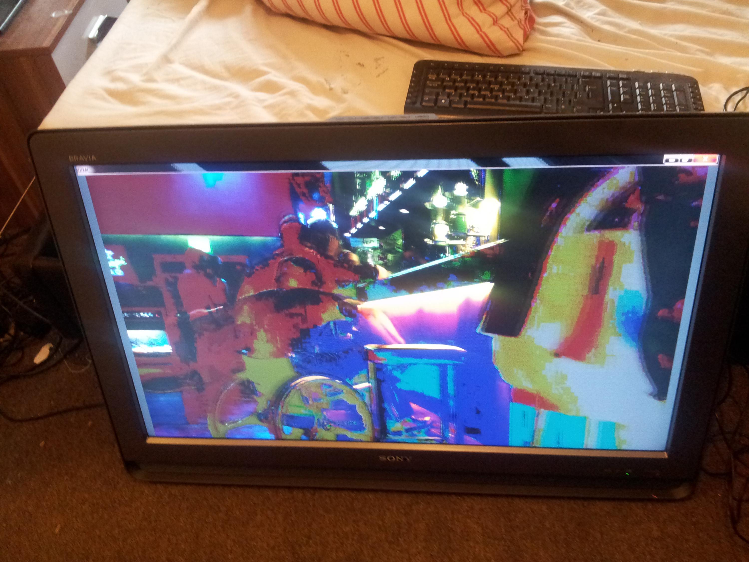

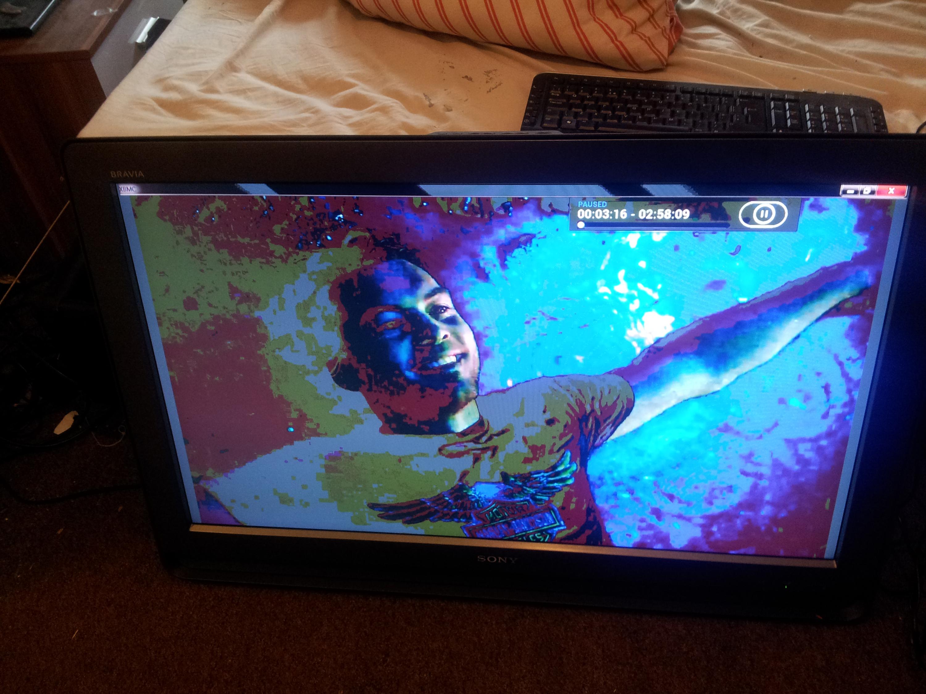

    I'd have immediately said that this was an LVDS cable or panel setting wrong, but here's a panel which is showing a solarised picture where the transitions aren't particularly smooth, and the gamma IC is the cause. So looks like I was wrong on that one... it is possible.
    Interestingly, a certain band of colours does appear OK - it's only the darkest or lightest which go all crazy. For example on Jake Sully's face, the mid-blue details are accurate; but the darker and lighter colours aren't.
    Has an AUO 37 inch 720p panel in it.
    VGAMA voltages, only some are available for test but we can still see it is bad:
    1. 14.91V (should be near AVDD)
    2. 14.55V
    6. 10.36V
    7. 9.56V
    8. 9.42V
    10. 7.63V
    11. 7.42V (midpoint - should be 1/2AVDD so this is OK)
    12. 10.77V (notably bad)
    13. 10.35V ^^
    15. 7.53V ^^
    16. 7.07V ^^
    17. 6.22V
    21. 6.02V ^^ (should be nearer to 0V by now)
    22. 0.37V (seems OK, should be about AVDD-VGAMA1)
    I compared REF voltages and they match, so it seems like that's not a reliable test: what appears to be happening is the input bias of the device is failing, and this is causing it to malfunction, but it sure is an odd failure. The references are derived with a long resistive divider, with 1% resistors.
    A quick check: device was running 55C which is hot, in a 21C room. Calculated rise of temperature at 67C/W T(j-a) as specified in datasheet puts it at 480mW... according to the datasheet the quiescent power should be 130mW so we can see that the IC is dissipating 3x more power than it should, probably due to an internal short.
    It's an AS15-U gamma IC, but this is identical to AS15-F, AS15-G, etc.

              Re: Sony KDL-37U4000 solarised picture due to Gamma IC AS15-U faulty
              Check the array of points marked "GAMMA" or test points marked GAMA#, VGAMA#, VGMA#, VGM#, VG#, GMA#, GM#, etc. There are usually from 12 to 22 points.
              A quick check which detects 99% of failures is that the curve goes in one direction only, for example 1V, 2V, 3V, 4V is OK, 4V, 3V, 2V, 1V is OK, and 1V, 3V, 2V, 4V is NOT OK.
              I also have an Excel/OO.org Calc spreadsheet available for general t-con tests including gamma tests.
              Fix is to replace AS15-U IC with a new IC, 44 pins TQFP SMD chip, takes a little practice but isn't too hard.
                  I have replaced 9 of AS15-F same chip as toms . If you never did a unsolder and solder On a IC practice on a junk board. The pads are very delicate, and will pull off if heat is to high. Will tear if wiped across the pads with an alcohol swab. It takes two hands to solder one on using 60/40 solder and lots of flux so have magnification you don't have to hold. Last thing have a steady hand ,and good luck.
                    better picture
