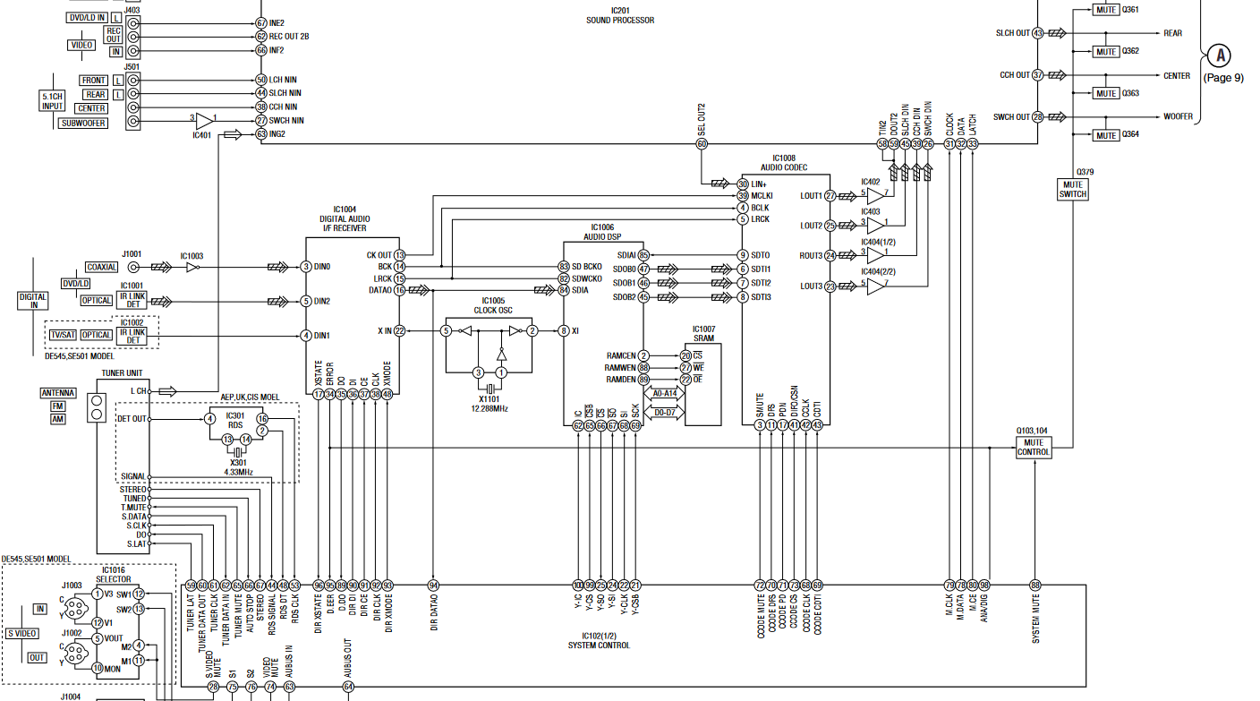

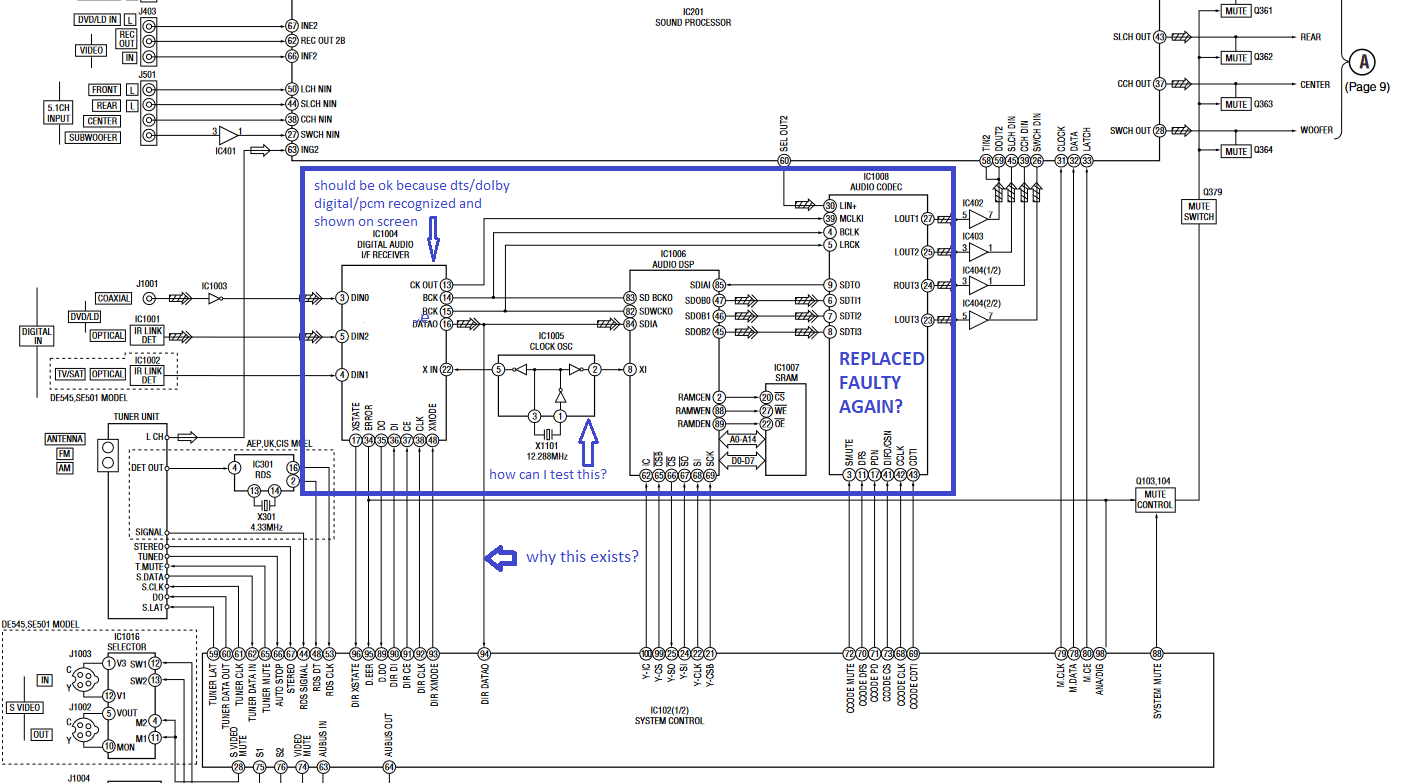

        Then I had to exclude things from being bad using what I got from the receiver:
        Since it is able to recognize when digital input is dts/dolby digital/pcm and it is able to show it on the screen, then IC1004 DIGITAL AUDIO I/F RECEIVER should be OK.
        So, the bad IC should be IC1006 AUDIO DSP or IC1008 AUDIO CODEC or might be also the DSP RAM IC1007. I ruled out IC1005 CLOCK OSC and X1101 12.288MHz because they send pulses to DIGITAL AUDIO I/F RECEIVER that received optical / spdif in and that one we just proved above that it is working OK. If I am missing anything right now please let me know.

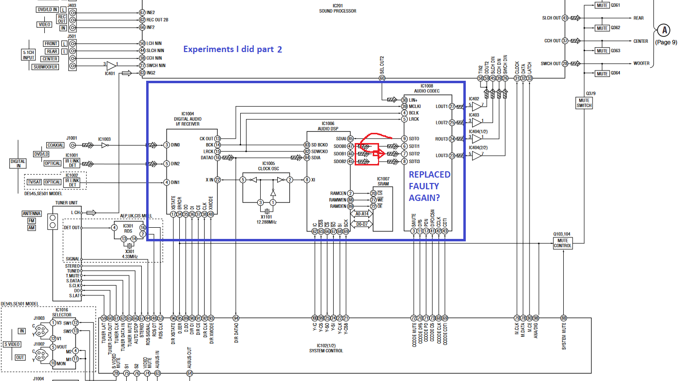

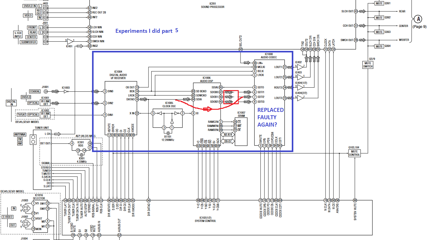

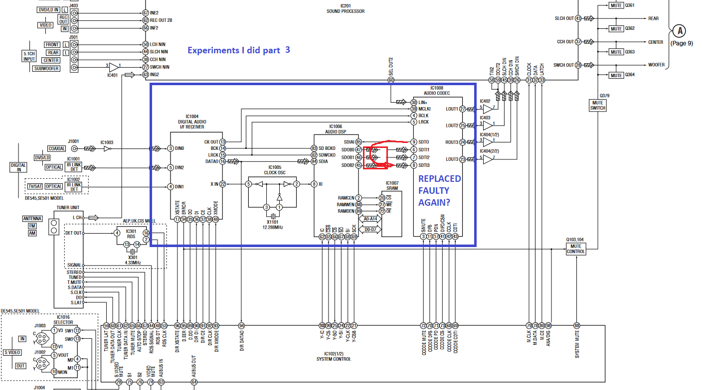

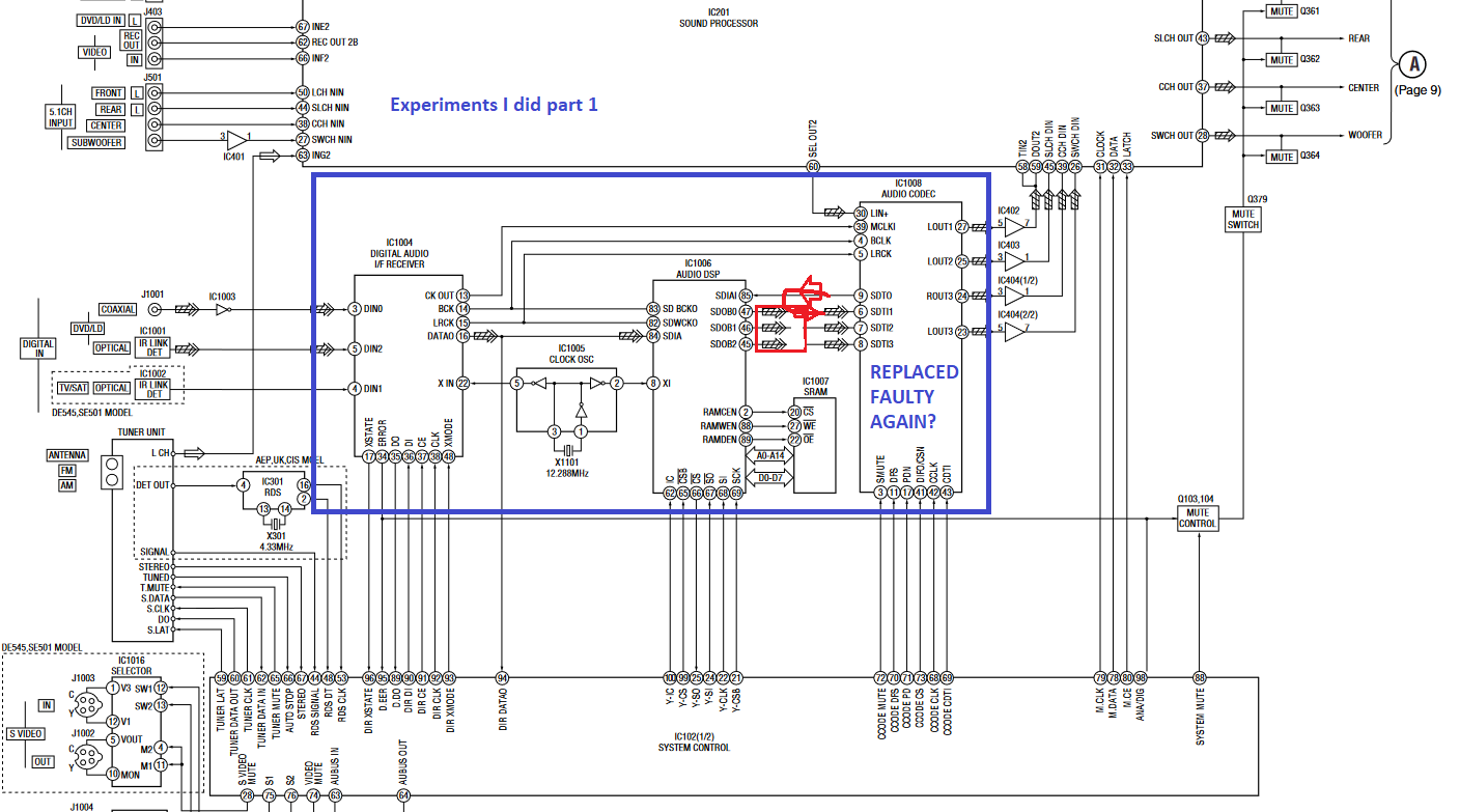

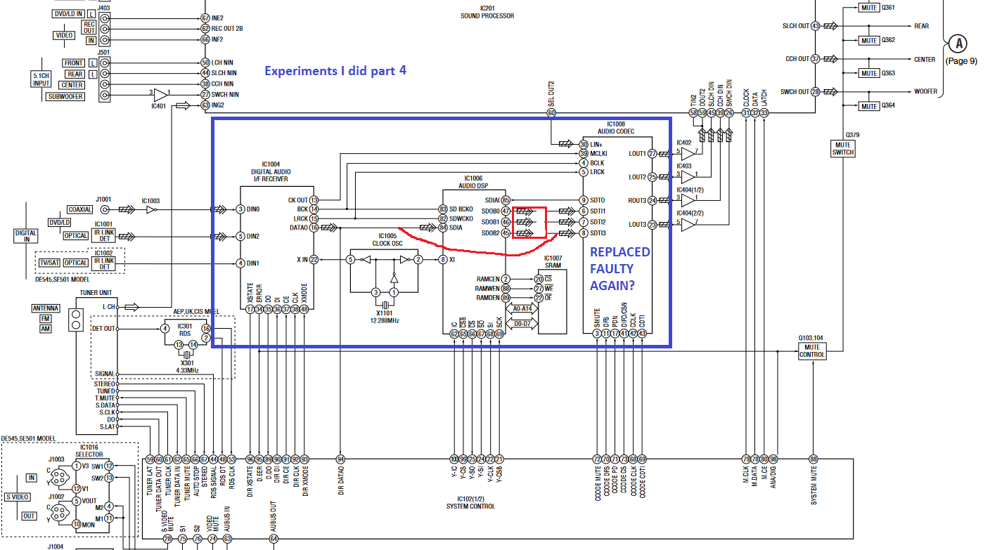

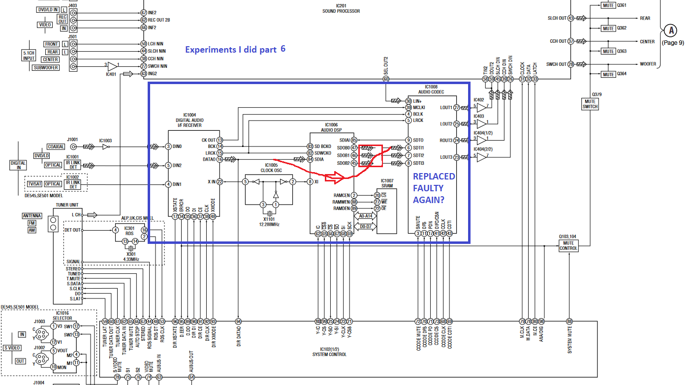

        Next I tried to do some crude experiments that are shown better on the pics attached. My goal was to rule out/ find out the ICs at fault.
        First I removed 3 100 ohm resistors, disconneting the 3 digital outputs of AUDIO DSP IC from the 3 digital inputs of CODEC IC digital to analog convertors (DAC).
        Then fed the output of CODEC IC analog to digital (ADC) to each one of 3 inputs of CODEC IC digital to analog convertors (DAC), totally bypassing AUDIO DSP IC to rule out that this is the faulty one. But I didn't get sound
        Also tried to connect the output of DIGITAL AUDIO I/F RECEIVER to each one of 3 inputs of CODEC IC digital to analog convertors (DAC), bypassing again AUDIO DSP IC with no sound.
        Note that during the last experiment I was feeding optical in with PCM uncompressed sound.

          You have to keep in mind that there is not only one clock per IC, there are a few. The main crystal clock you can see with the oscilloscope. You should be also seeing data flinging around between the IC’s and other clocks. If the clock is screwed up the dsp, it won’t produce sound either. Keep on poking around…
