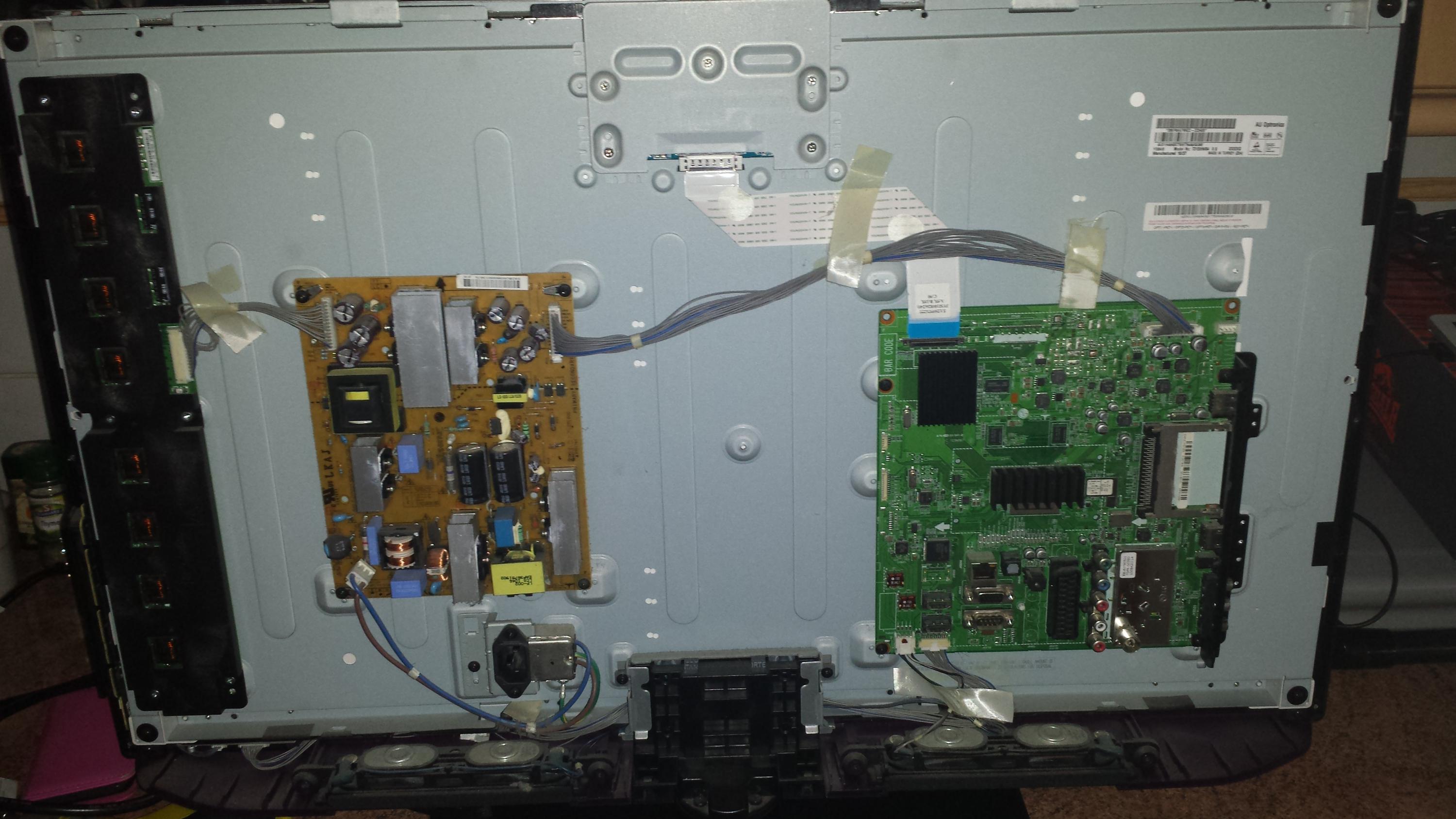

    Lg32ld490
    hello
    got this tv today i have sound but no picture but i still have the lg logo showing on the mainscreen
    any ideas ?
  • sordids999
    • May 2013
    • 2161
    • uk
    Re: Lg32ld490
    just tested voltages all seem fine
    • Alastair E
      Chief Womble
      • Mar 2013
      • 1963
      • U.K.
      Re: Lg32ld490
      Any menu functions onscreen?
      Tried any other input sources?
      Any sound?
      TELEFIX
      • sordids999
        • May 2013
        • 2161
        • uk
        Re: Lg32ld490
        The menu works when try via remote and the side buttons also tried the avi,scart but just sound with the LG cube showing on the screen
          Re: Lg32ld490
          LG No Signal cube? Are all inputs dead? What about Freeview/DTV?
          I have a friend with a smashed 32" like this, he might have a main board... I'll ask him if you're interested.
          • sordids999
            • May 2013
            • 2161
            • uk
            Re: Lg32ld490
            Yes tom tried all hdmi connections and avi have not got a aerial to test only virgin box available,I'll appreciate it if you could ask your friend plus yes to the lg signal cube logo
              Re: Lg32ld490
              OK, do you have anything with SCART on it? Tried that?
              • sordids999
                • May 2013
                • 2161
                • uk
                Re: Lg32ld490
                Scart also does not work tom
                  Re: Lg32ld490
                  OK, hold MENU on TV and MENU on remote. 10 seconds. Does service menu appear? Note: if code prompted try 0000, 3142 or 1234.
                  • sordids999
                    • May 2013
                    • 2161
                    • uk
                    Re: Lg32ld490
                    Is there a special way of doing this tried on the last lg I fixed can never even get into the part where u enter a code
                      Re: Lg32ld490
                      It sometimes requires a factory remote, depending on the model; someone on a forum said you can use a universal remote but didn't include any code.
                      • sordids999
                        • May 2013
                        • 2161
                        • uk
                        Re: Lg32ld490
                        I can use a USB connected to main board to play a movie on there and it's playing fine so this is strange
                          Re: Lg32ld490
                          I assume you've tried user menu reset...
                          • sordids999
                            • May 2013
                            • 2161
                            • uk
                            Re: Lg32ld490
                            Yeah done a reset in the menu u connect hdmi lead it says connecting then no signal it has built in games that work as well in the menu
                              Re: Lg32ld490
                              Really need to get into that menu but can't find anything on it - maybe try googling it a bit more as I only had a brief look, someone mentioned a One 4 All remote working.
                              • vinceroger69
                                • Mar 2012
                                • 6714
                                • uk
                                Re: Lg32ld490
                                http://openlgtv.org.ru/wiki/index.ph...es#Procedure_3
                                • sordids999
                                  • May 2013
                                  • 2161
                                  • uk
                                  Re: Lg32ld490
                                  so does that mean i need a Logitech Harmony Remote to access the service menu ?
                                    Re: Lg32ld490
                                    If you look on that list, there's many options. One of them involves using an audio output (e.g. laptop, iPod, phone) and an IR LED - if you can get the bits from CPC it could work.
                                    • sordids999
                                      • May 2013
                                      • 2161
                                      • uk
                                      Re: Lg32ld490
                                      can you still ask your friend if he wants to sell his main board as well tom pls
                                        Re: Lg32ld490
                                        I will give him a call tomorrow and check, he runs a TV/laptop repair shop. He'd probably sell the whole set of boards for cheap, will check with him.
