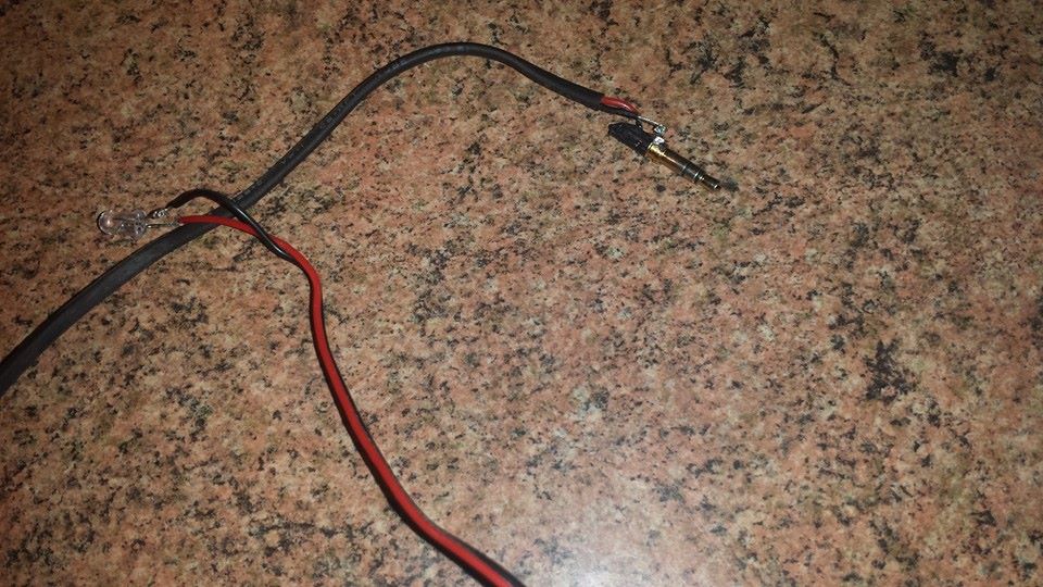

          i tried the video on youtube where you connect the headphone wires to a IR from a remote then used the required wav files close up the the tv sensor which should in theory load up the 4 digit pin but nothing happened
            Re: Lg32ld490
            Try reversing the IR. Also, make sure to turn up PC/phone/ipod volume to maximum.

                    ok tried again tonight via a smartphone using the IR sensor trick still nothing but watching the videos i think i need a picture but not sure about that,so is there anyway i could reset the EEPROM ive tried to downgrade to 3.15 which apparently you can then access the service menu but no files around
                      #30
                      Re: Lg32ld490
                      You shouldn't need a picture. What code are you trying? Tried using IN-START from standby mode? Also, show us your set up - are you definitely using an IR LED... to confirm if the LED is working, point a digital camera at it, or look at it with your phone in the mirror, you should see a bright purple or white flash from it on a camera (invisible to the human eye.)

                          im not sure if you can see but i copied a website to make this and im using the
                          serv-ok-ok.mp3 which i got from the lg site
                            #33
                            Re: Lg32ld490
                            Try the camera trick to make sure the LED is producing a signal.

                              not its not tom i tried the remote before i took it apart so i know the LED is working
                                #35
                                Re: Lg32ld490
                                If the output of the phone is too low, the LED will not light. Or a wire could be broken in the cable.
                                Try using a laptop/desktop, output may be higher.

                                  Well thats 3 LED ive used three sets of wires pc,phone,laptop still cant get the led to light up
                                    #37
                                    Re: Lg32ld490
                                    Cable is OK?
                                    Check camera against known working remote.

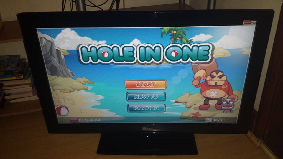

                                      Just typical games work on screen in menu and a movie loads up fine via usb but no scart,hdmi anything lol well no mainboards around so i guess its a dvd player for now
