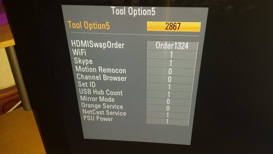

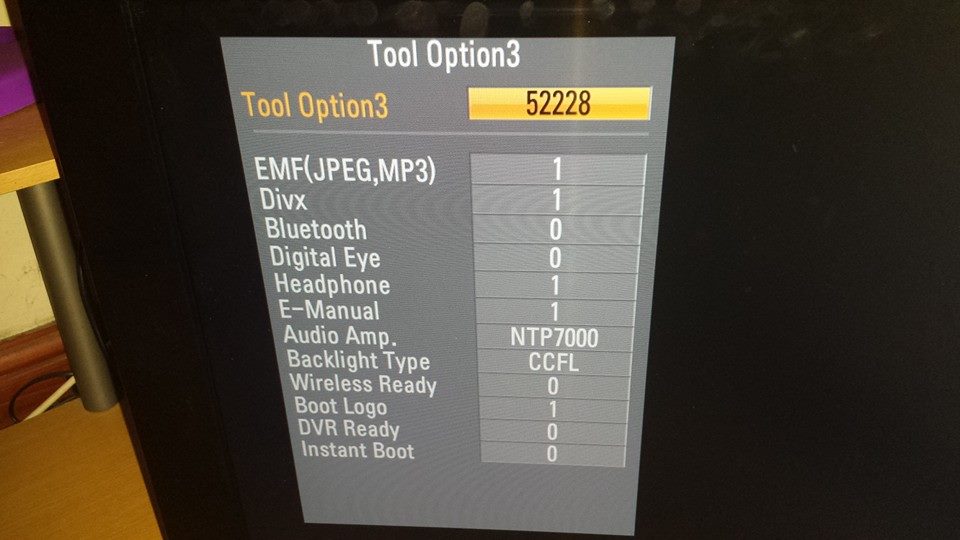

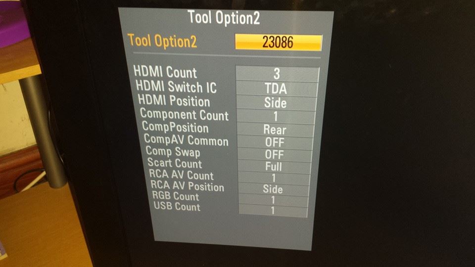

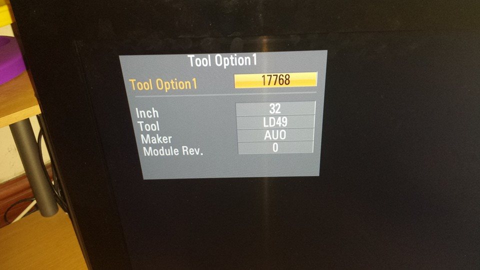

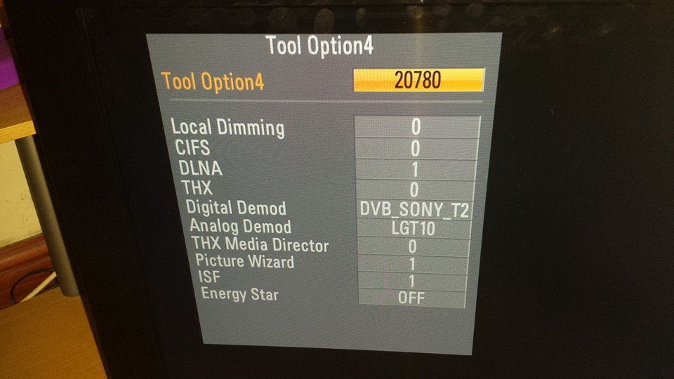

      Re: Lg32ld490
      Ok tom controller arrive I got into service menu what's next
        #43
        Re: Lg32ld490
        What options do you have?

          Re: Lg32ld490
          0.tool option 1
          1.tool option 2
          2 tool option 3
          3 tool option 4
          4 tool option 5

            #45
            Re: Lg32ld490
            Can you get a picture of what is under tool option 1-5 and check that your country group is set right.

              #46
              Re: Lg32ld490
              country group code 04
              country group EU
              pictures coming

                #47
                Re: Lg32ld490
                as requested
                  #48
                  Re: Lg32ld490
                  I was hoping for a reset option but there is not one there.
                  Since all inputs are dead it cannot be a single option in that list IMO, so not sure what to suggest, other than a new main board.

                      #50
                      Re: Lg32ld490
                      Just to check so each of those match for example you have 3 HDMI, a component input on the rear, 1 USB, side RCA port, etc.?

                        #51
                        Re: Lg32ld490
                        on the back
                        2x hdmi
                        1x av rgb scart
                        x1 rgb in (pc)
                        x1 rs-232 in
                        x1 lan
                        x1 audio in
                        x1 component in (video audio)
                        x1 antenna in
                        rear x1 hdmi
                        x1 usb in
                        x1 av in mono audio jacks
                          #52
                          Re: Lg32ld490
                          So it seems to match, it is probably a hardware fault then. Unfortunately it will all be integrated into one main processor so you have little choice when it comes to repair.

                            #53
                            Re: Lg32ld490
                            UPDATE: new board arrived seems to be working now so time to test........
