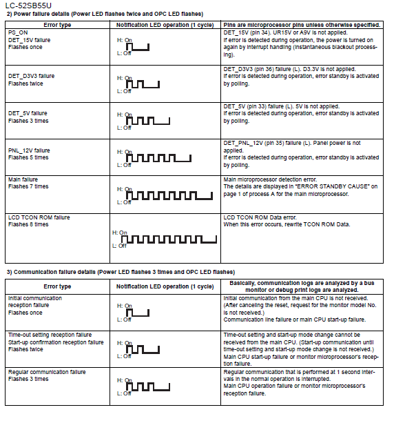

    SHARP LC-52SB55U Flashing power/OPC lights
    Power and OPC light flashes twice together and then OPC light flashes three more times. Then it repeats. I get no picture or sound. It was working just fine 2hrs ago. Wife turned it off the vacuum. When she tried turning it back on nothing happened.

    Re: SHARP LC-52SB55U Flashing power/OPC lights
    Try unpluging the tv and wait a few minutes then plug it back in,
    Power led flashing 2 times, opc flashing 3 times = DET_5V failure
    From manual...
    DET_5V (microprocessor pin 33) failure (L). 5V is not applied.
    If error is detected during operation, error standby is activated
    by polling
      I see and read your comment. Thank you. But I don't understand how to fix it. Is it repairable?
        Yes,repairable.Usually, IC 1604 and IC 1804 (hdmi) has a short.Check for short.
