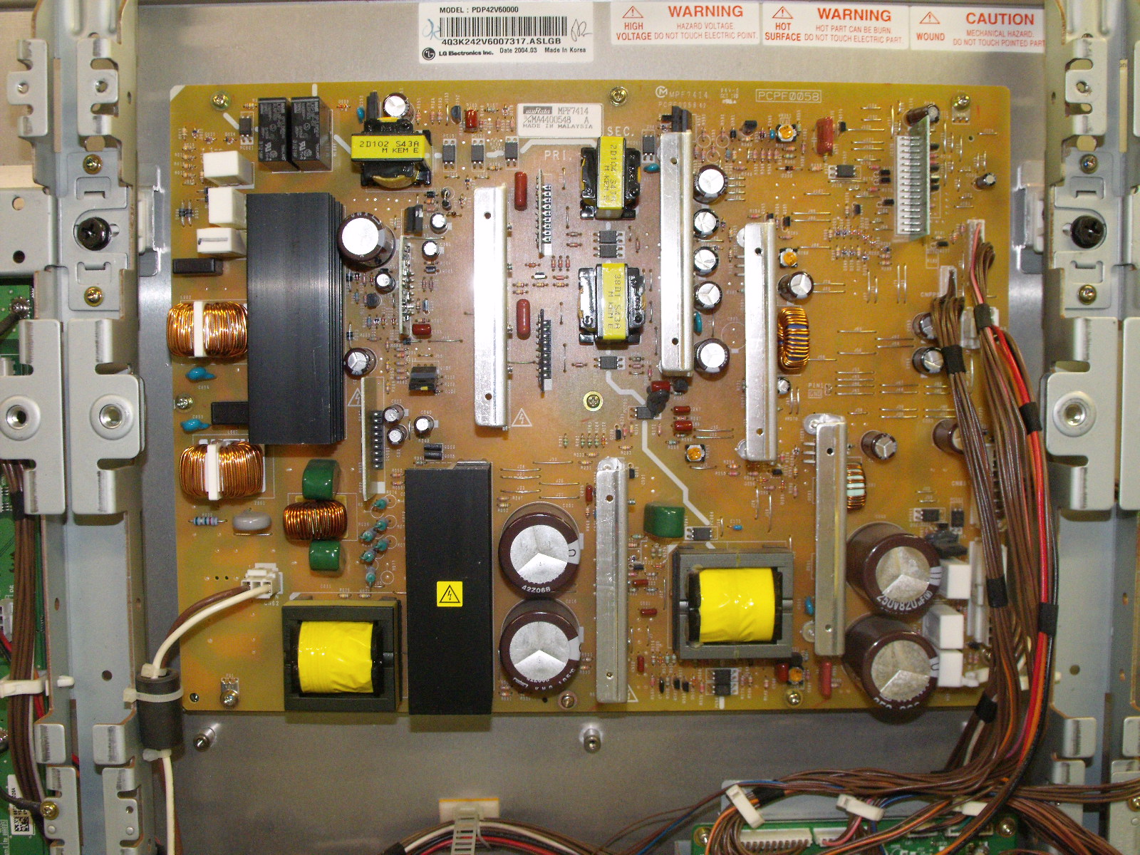

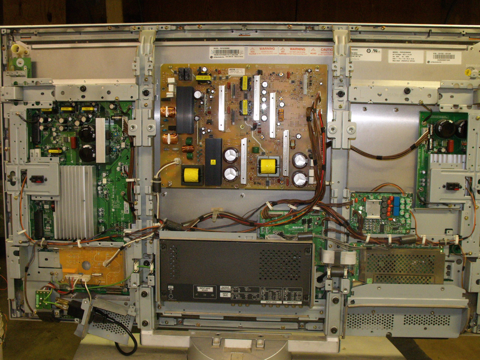

    Hitachi 42EDT41 Plasma Has amber standby light push power button and it turns green and I can hear solenoid click in back but nothing on screen. I checked VS and VA voltage and VS is 3.8V and VA is nothing. I was told the power supply board is new.
    Re: Hitachi 42EDT41 No Picture
    Check VSAGO, VCEGO signals on connector going to power board (should be labelled.) They must be high (>3V) for it to work.
      What stinks is that on the power supply there are no markings next to the connector just what connector number is.

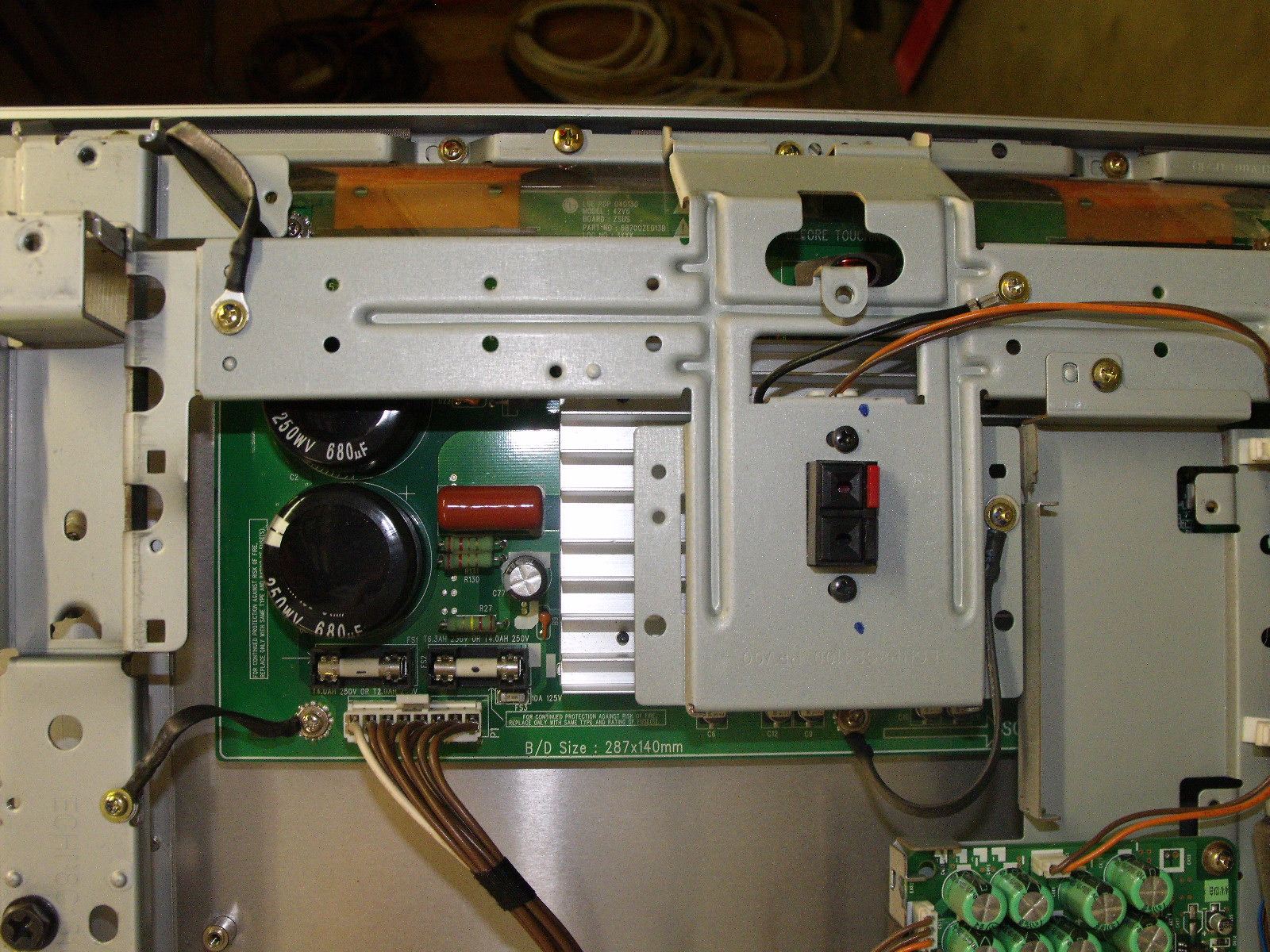

        Oh, I didn't notice this was an LG panel. 42V6, 2004 panel, 480p... is it really worth fixing? Anyway, try isolating the Y- and Z-sustain boards. See what happens, Vs rises or not?
        I have vague recollection of fixing one of these. Top left corner one of the ceramic resistors was open circuit.
          Only going to fix if it's cheap. Anyway I did get normal voltage with the Z-SUS disconnected.
            OK you probably have a shorted Z-sus IPM, I would look for a replacement Z-sus.

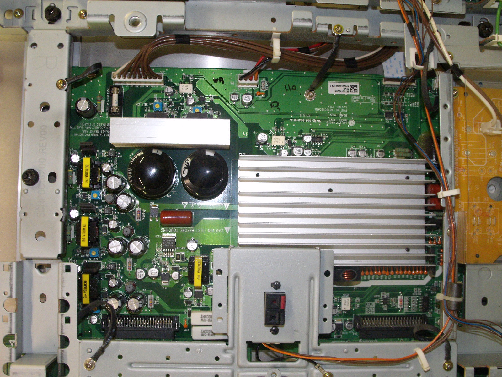

              Well got the Z-sus and same exact thing $45 wasted any other thoughts?
                Well, are you sure your replacement Z-sus is OK? Is it shorted? $45 on this TV? I get given these for free in working condition.
                  I was told it was tested and in working condition. I checked VS and VA to ground and it does not seem to be shorted. Unless you can tell me another way to check.
                    VS/VA bad with Z-sus connected means the Z-sus is short; sometimes the short can be hiding behind a component like a diode and so is not easily visible.
                                  Ended up junking it out after another Z did not fix it.
