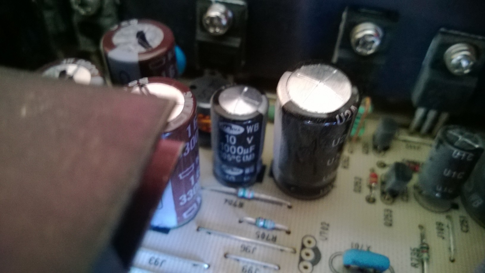

                    Re: LG 50pcdr1 is broke
                    This is a picture of the old Ps board that had the bad caps I replaced them and this did not work, then I ordered a board from eBay and I still have the same click of death.
                          What I am trying to find out is located in the picture I posted above, if only two of the caps were bad what else could been blown.
                            There are any number of things. The MOSFETS that do the inverter switching can fail. Diodes can fail. Use the diode function on your multimeter and look for junction readings that just don't seem right. Because you have many of the same components you can compare. For example, if two leads on a MOSFET read short but the same component elsewhere shows something like a 0.6volt drop then you can probably assume a failed MOSFET. Sometimes they go open circuit as well.
