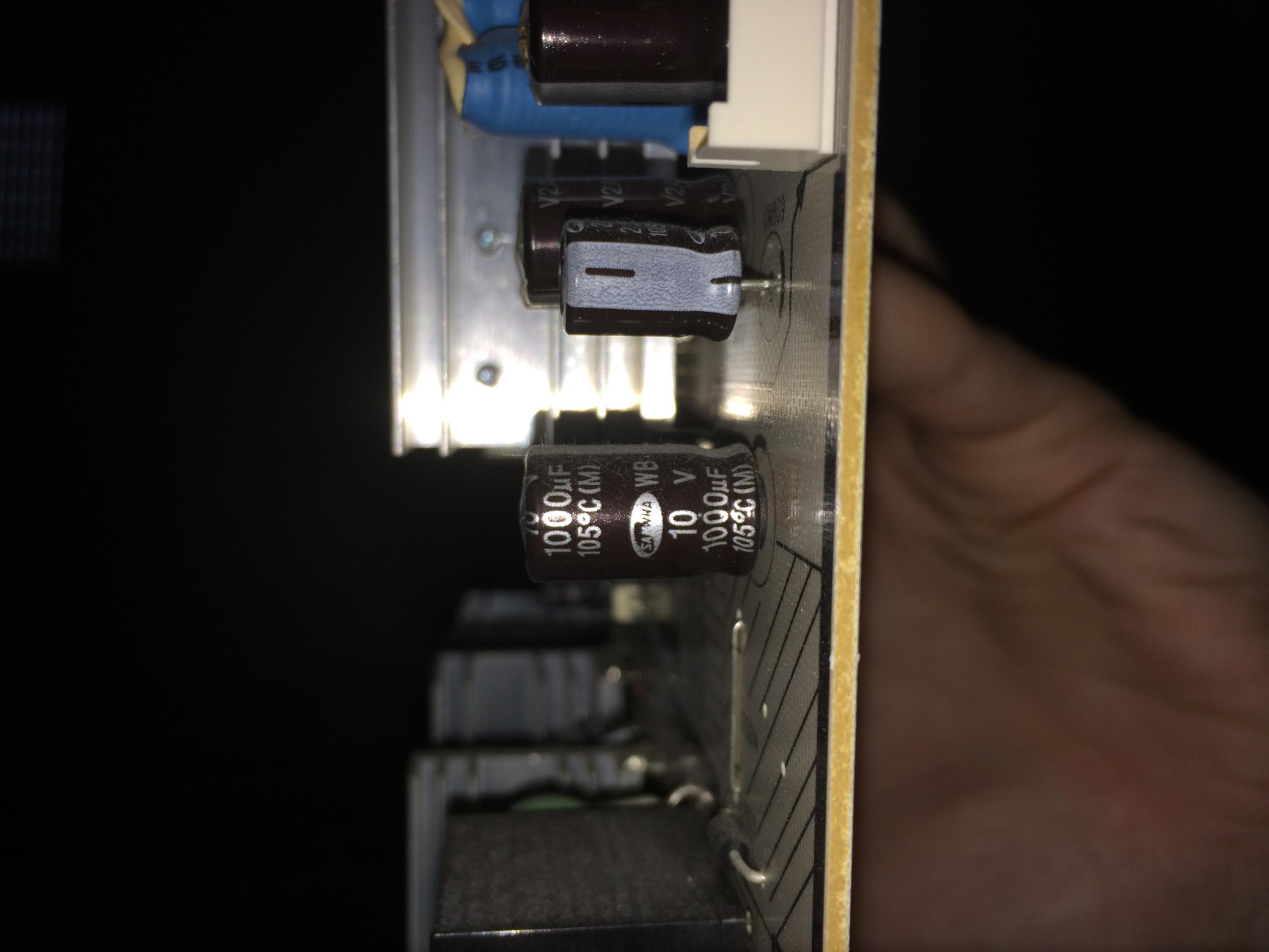

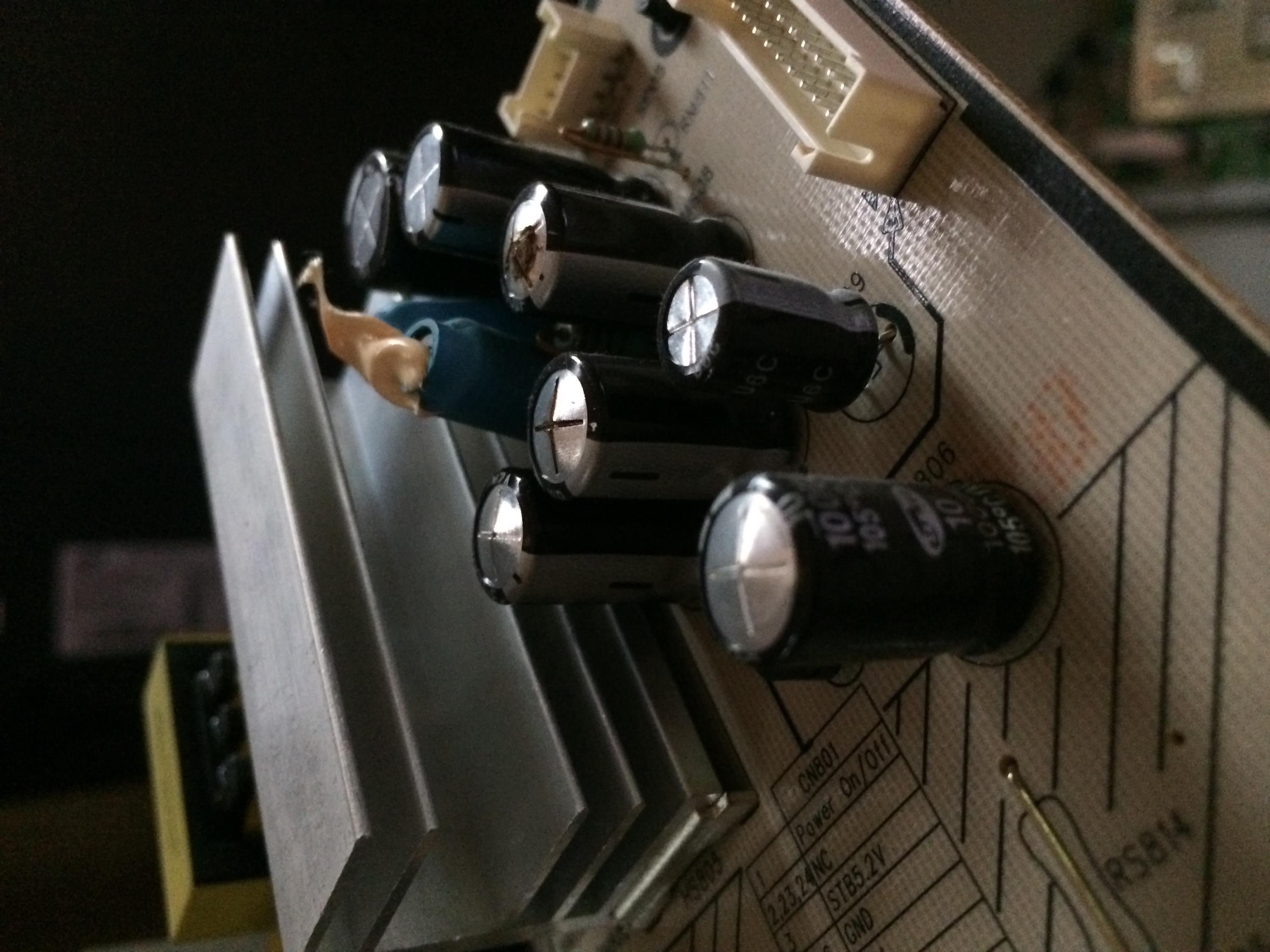

    I've already identified the busted capacitors but have no idea what to replace them with or where to purchase. I'm new to this level of electronic repair, any help is appreciated!
    I tried attaching a closeup of one of the caps, and a shot of the group of them.

    Do you mean broken off or bulging or leaking capacitor? The uf and voltage should be written on it somewhere. I see 1000 mico farad 10volt Caps at the forefront. Caps can be brought at Mouser or Digikey or ebay. Shipping will cost more than the cap. Be carefull not to damage the foil where the leads are soldered. Make sure the solder is molten when pulling the cap. U-Tube shoild have videos on how to unsolder and solder caps.

      Buy them from Digikey.
      Just type "1000uF 16V fc" for example in to find Panasonic FC-series 1000uF 16V capacitors.

        Go online to mouser.com. Type in capacitor. From dropdown choose Al electrolytic. From there enter what you know. You want 105 degree C and the capacitance and voltage are on the cap. Other choices are cap diameter, length and lead spacing. I like Panasonic. You want low esr. Have fun. Same thing with Digikey.

          Spec sheets, find the value and the size that will fit your board then type in the PANASONIC P/N in DIGI-KEY search box.
          I.E. FM series 1000uF 16V P/N is EEUFM1C102 search box
