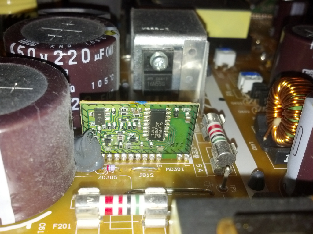

    I picked this set up yesterday, initially presented as no power no blinks. After getting it home and opening it up I found a loose harness between main and control board. A slight push and it came back to life.
    I brought it into the house and hooked it up for the kids to play games on, after about two hours it shut off and gave 10 blinks. Tonight I opened it up again and replaced the ceramic caps on mc201 and mc301. Had the kids play games again and it worked for about two hours before shutting down and giving 10 blinks again. Probably going to switch out the chips on the mc boards next.

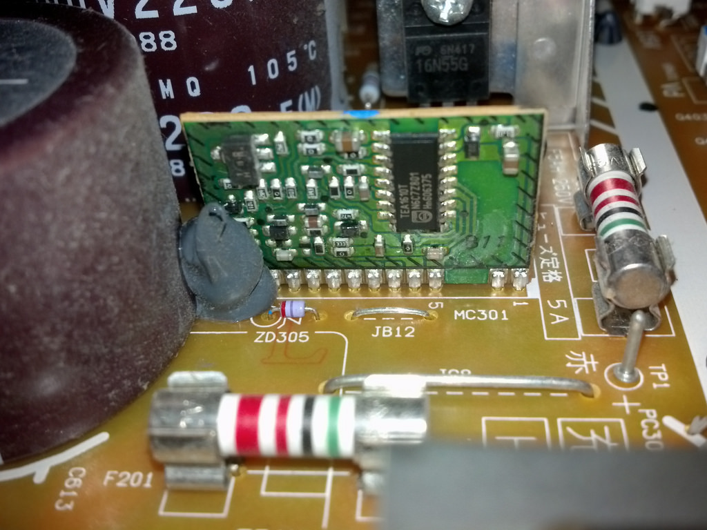

    Attached is before and after of the mc board, those little caps are a pain to solder. This one seems to be using a smaller caps when I meter them they are .224 uf, I used the 1uf 35v mlcc caps I used on the newer panasonics.

    10 blinks on this model is usually an internal thermal fuse on smps. Hadn't heard of it being intermittent. Maybe it is thermally cycling. Win Tips says install a 7 amp micro-fuse between R251 and R252 on bottom of smps. Might want to try that.

      Thanks I will give that a try if it does it again. It hasn't done it again since I posted. I was beginning to think maybe the harness that was loose was moving as it warmed up and causing the error. I'm going to hot glue it in for good measure as well

                  Well mine has started randomly shutting off with 10 blinks again, I pulled the power board and soldered in a fuse across r251-r252 put back in tv and it ran happily for an hour before shutting off yet again. I started poking around in the area around where I put the fuse and those resistors were reading about 140k then I tested them again after I pulled the power supply yet again and I was getting 2 megohm so I think it may be a cracked trace near those resistors. Didnt have any more time to mess with it yesterday but I think I will put a standard resistor across from the feedback pin to the transformer pin and see if that clears it up. Mine seems to be rather strange in that if I unplug it and replug it it will come right on and play for an hour or so before the fault comes back, makes it frustrating to try and find whats causing it.
