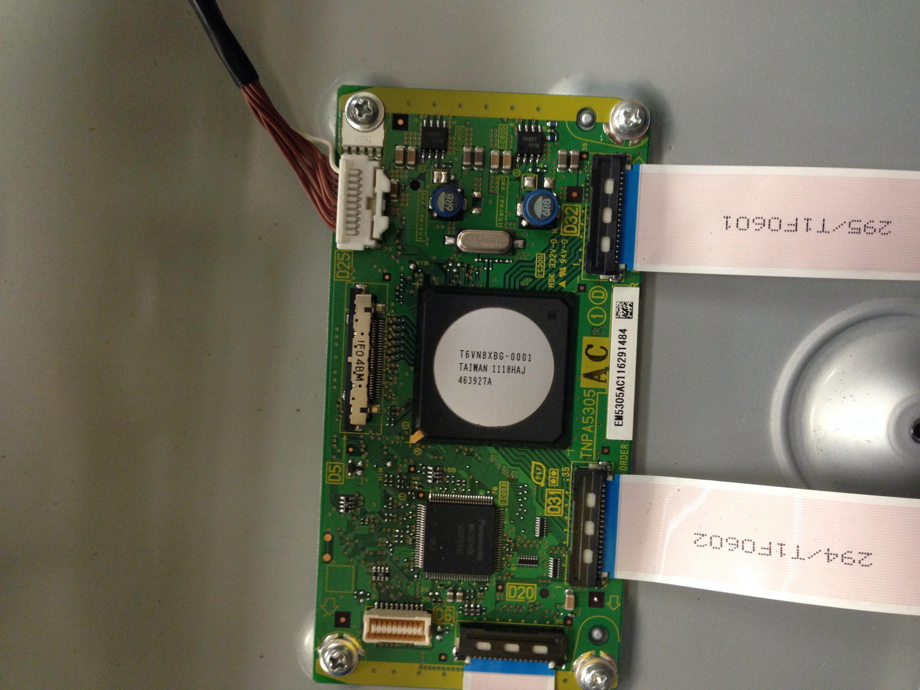

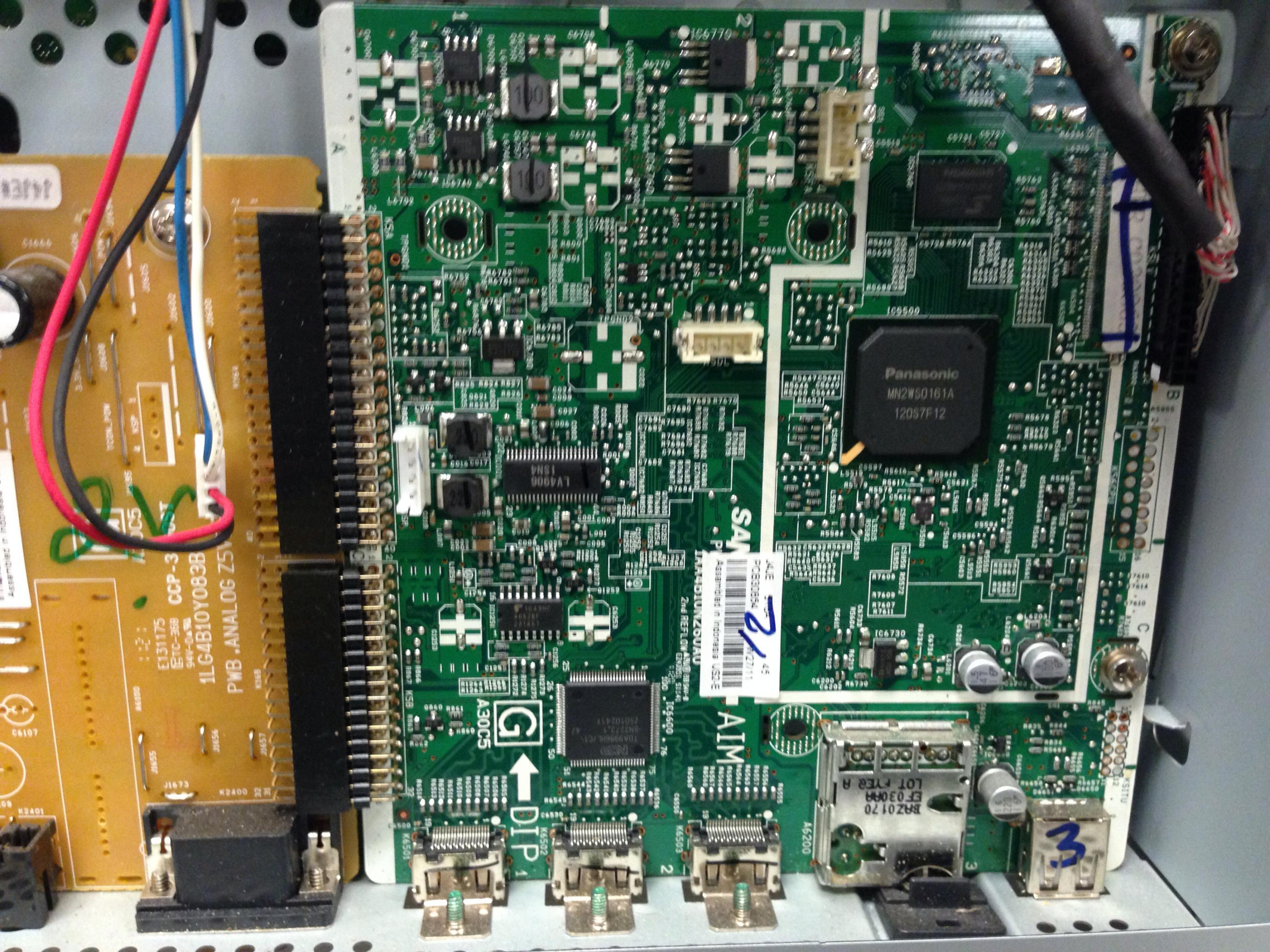

    I have a 50" sanyo plasma tv it will not power on.i have 5 volts standby also when i plug the tv on i can hear relay click and i see my power on voltage go hi to try turn tv on but it does not power on shuts off. I never see led power on i know they sell a kit for main board to repair power on issue.does any one know what this kit contains.any help is appreciated.

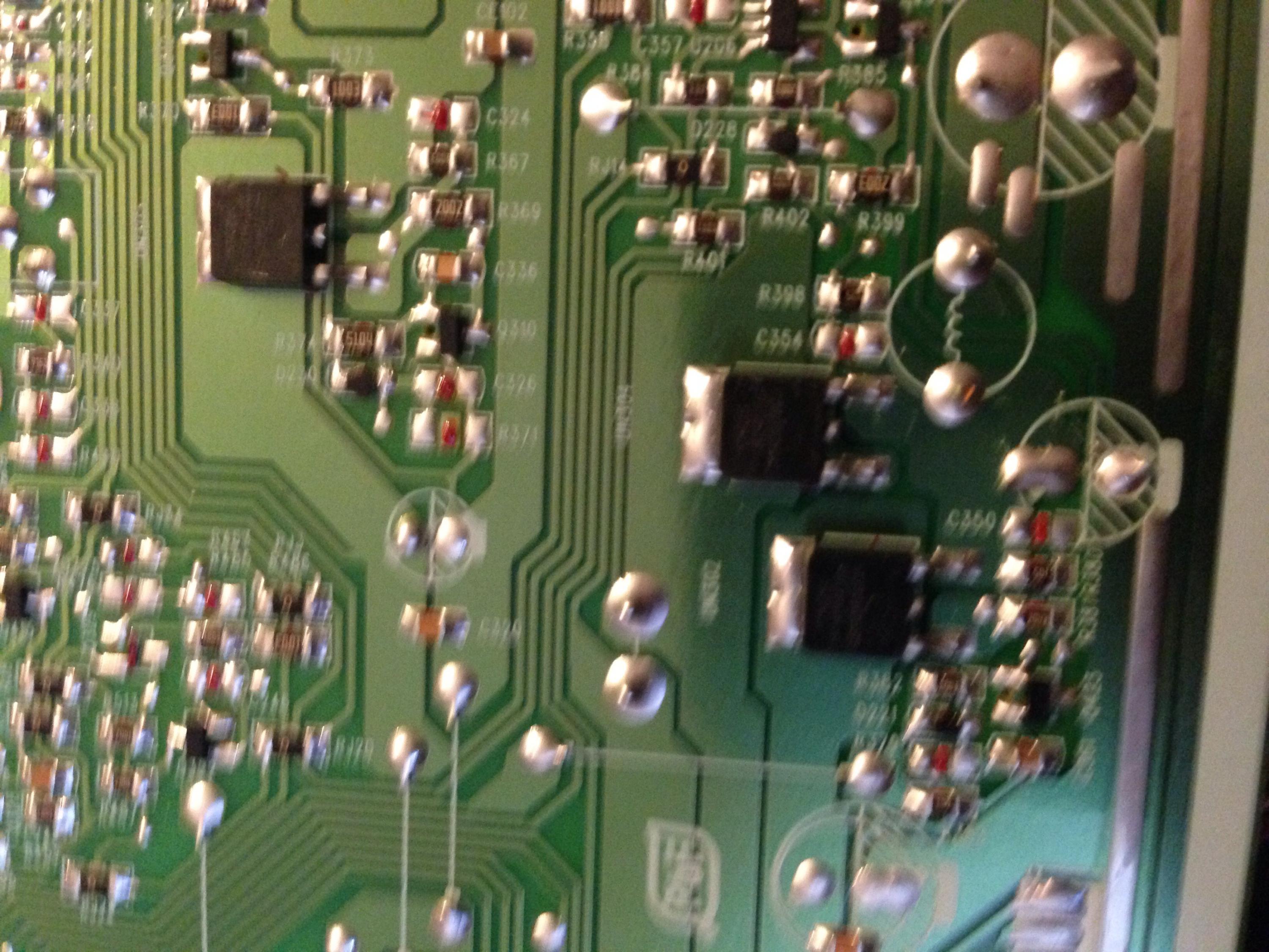

    The power led will not come on not even for a second.i disconnected this part in picture below.and now the green led will come on and then it turns off.i can push the power button and it will try to turn on then it turns off again. Before no response and no led light up.does this mean this part is bad.

                Protection circuit is shutting it down. There are voltage test points on the main board with white stars to make finding them easier. Place ohm meter black lead to chasis ground then use red lead to test each voltage test point for the short. I fixed one last week. The 3.3 vdc was shorted to gnd. It was the HDMI chip. Hard to find because it is obsolete but available. I took one from a bad board with other problems, I included a different service manual that includes your set with info other info that will help. See page 4 to test SMPS.

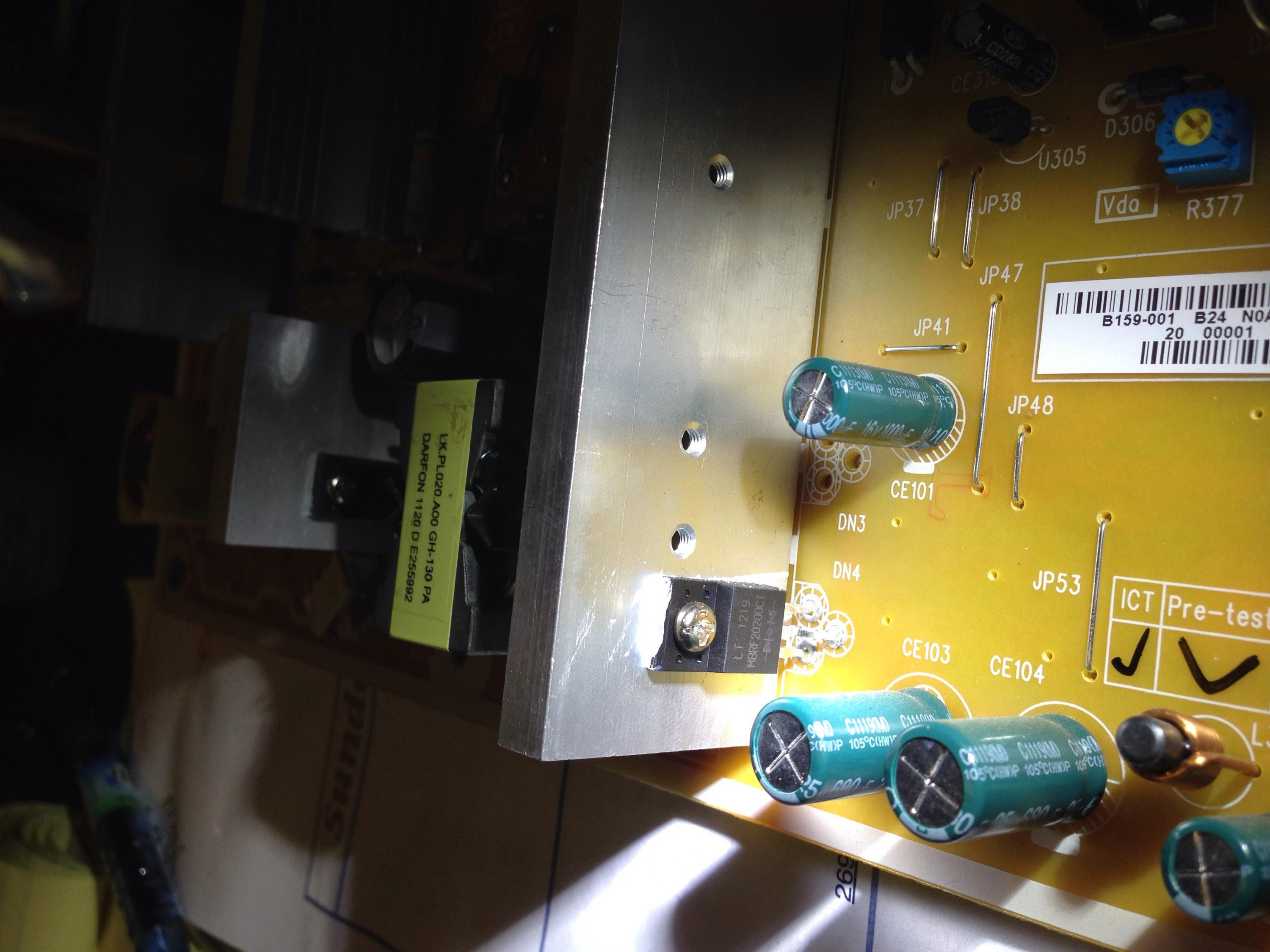

                    This diode when i touch either side to its heat sink it gives me a reading of .4 ohm is it shorted or is this heat sink live.here is a pic of it

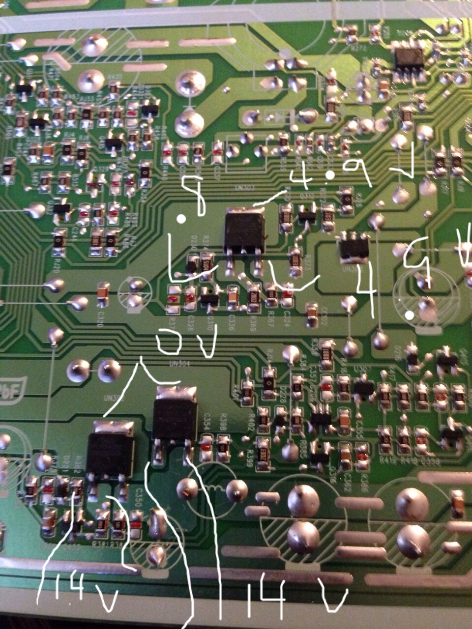

                      Does anyone know how to test p1540edg i have two that have 14v on both left and right legs and the middle has nothing.there is also one that has .8 on one leg and 4.9 other and 4.9 on middle leg.see pics

                          Well i recieved a power supply will try it tomorrow.i did do a quick test on bench and had all my voltages present the regulator i took a pic of earlier had 14 v on both legs left and right and nothing in middle leg.now on new board left and right legs had different reading one was 2.5 v and 14v and the center one had 14v so there is something wrong with the old one for sure.
                            Re: Sanyo dp50741 main board j4je
                            There is a possability that the audio amp is shorted loading the voltage regulator. Remove the voltage regulator and check for shortsto gnd

                                    Also just had one with a shorted HDMI IC6600, causing 3.3V protection shut down. Check D6702 for 3.3V on plug in. At first I though it was the audio IC, I was looking for 12V at D1668 like it said in SM, but it looks like that should also be 3.3V.
                                    HDMI IC6600 = TDA9996HL/C1 and mainly from China on eBay.
