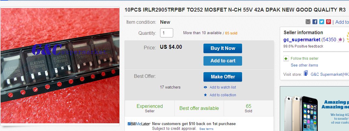

                              Can anybody help me find a suitable replacement for PHD38N02LT cross referencing wise? That is still available @ digikey? or ebay? Been hunting and not sure what would work. it goes to 7U28 on main board. I added the datasheet for specs to compare to original against a suitable replacement i hope. It's part of the 2.5 volt stabilizer for the dc-dc converter. It measures open on DMM no matter how you go about it but appears to be physically OK in appearance...
                              • RON_CET
                                • Jun 2012
                                • 217
                                #35
                                Re: PHILIPS 42PF7421D/37 Chassis EL1.1 U AA
                                the Philips part# 934057587118 which not many vendors have or this eBay replacement might work
                                Ron Driver,BSEE,CET,ISCET,NESDA
