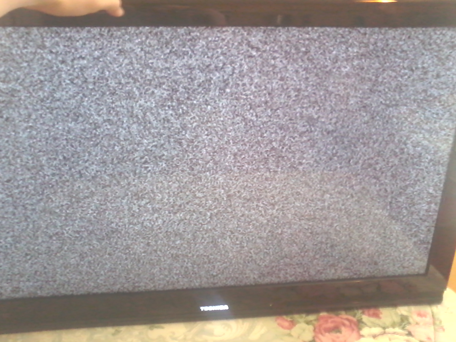

                            Well. as you can tell I'm still learning and make mistakes but....Thanks to Bud Martin, I have successfully got the tv to power back on!! Batteries were dead in the remote they gave me, turned it on and got signal from buttons on the side.
                            I assume, replace that TVS and all should be good to go!! Thanks again for not giving up on the thread, I know it was a headache with the mistakes I was making. Thank you very much sir!
