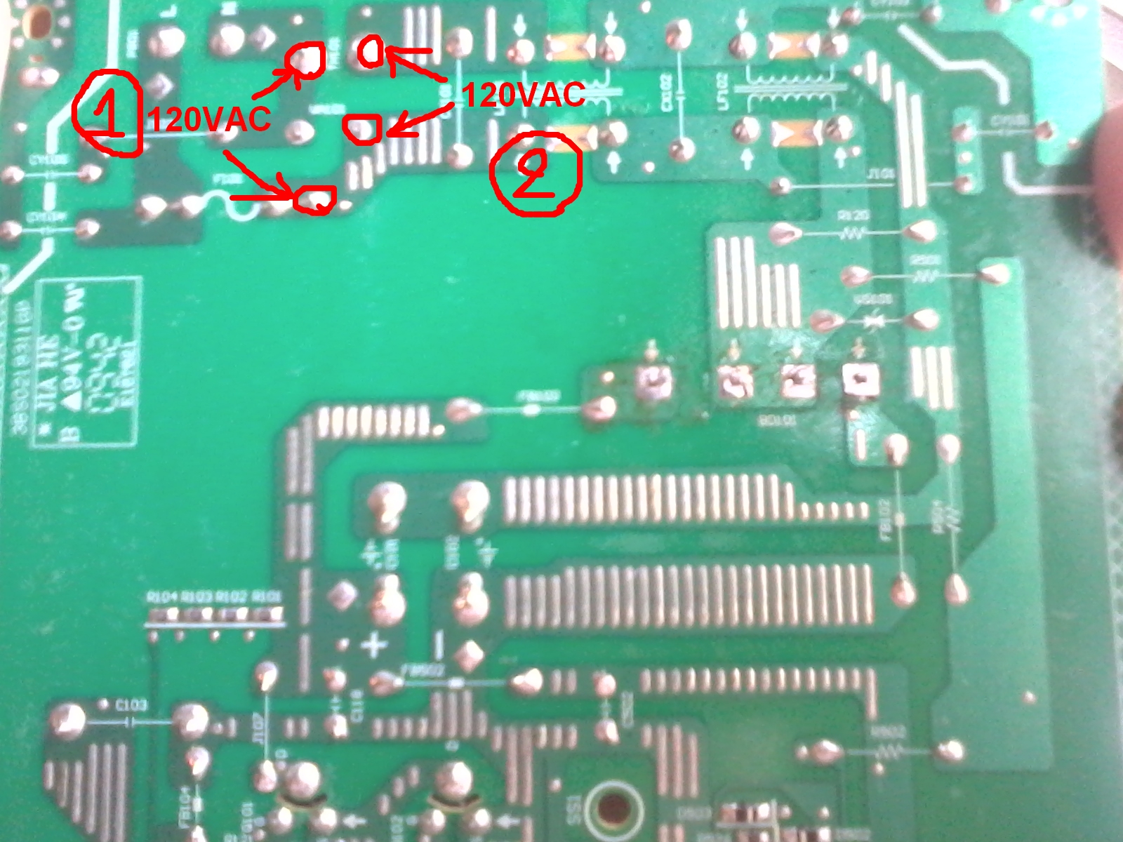

Put the bridge back in place. Another test, put meter in AC Volt and measure the AC voltage on the two pads where the TVS legs was solder to, it should show 120VAC.
I plugged it back in and got 16-17 v by probing the top side of the holes. I did put it back in circuit(bridge) as well. Edit: I flipped it over and probed the pads and got 005. v
That THxx is the inrush current limiter. I cannot see why you only getting 4~5V, that '1' reading is the voltage between N (Neutral) pin of the incoming AC and one end of the fuse (in this case the lamp).
There is no way you only getting 4~5VAC at those two points of '1' test points, you lamp is good? Something is not done right or measuring right.
What do you get at L and N where the AC connector is connected too?
Well that one was my fault for sure!! I still didn't get high readings on the points you pointed out but I put one probe on N and the other on one of the pads for the fuse holder and got 124vac and I put the other probe on the other AC line, L I think it was and probed the other fuse holder and got the same 124vac. I know it's not what you had outlined but I probed around after you said N and fuse and found 120vac that way.

TVS in, lamp lights up, TVS removed, lamp does not light: it means the TVS is shorted, so I do not know what you did wrong when we tested it before.
Leave TVS out and check the DC voltage on the B+ and primary ground again.
