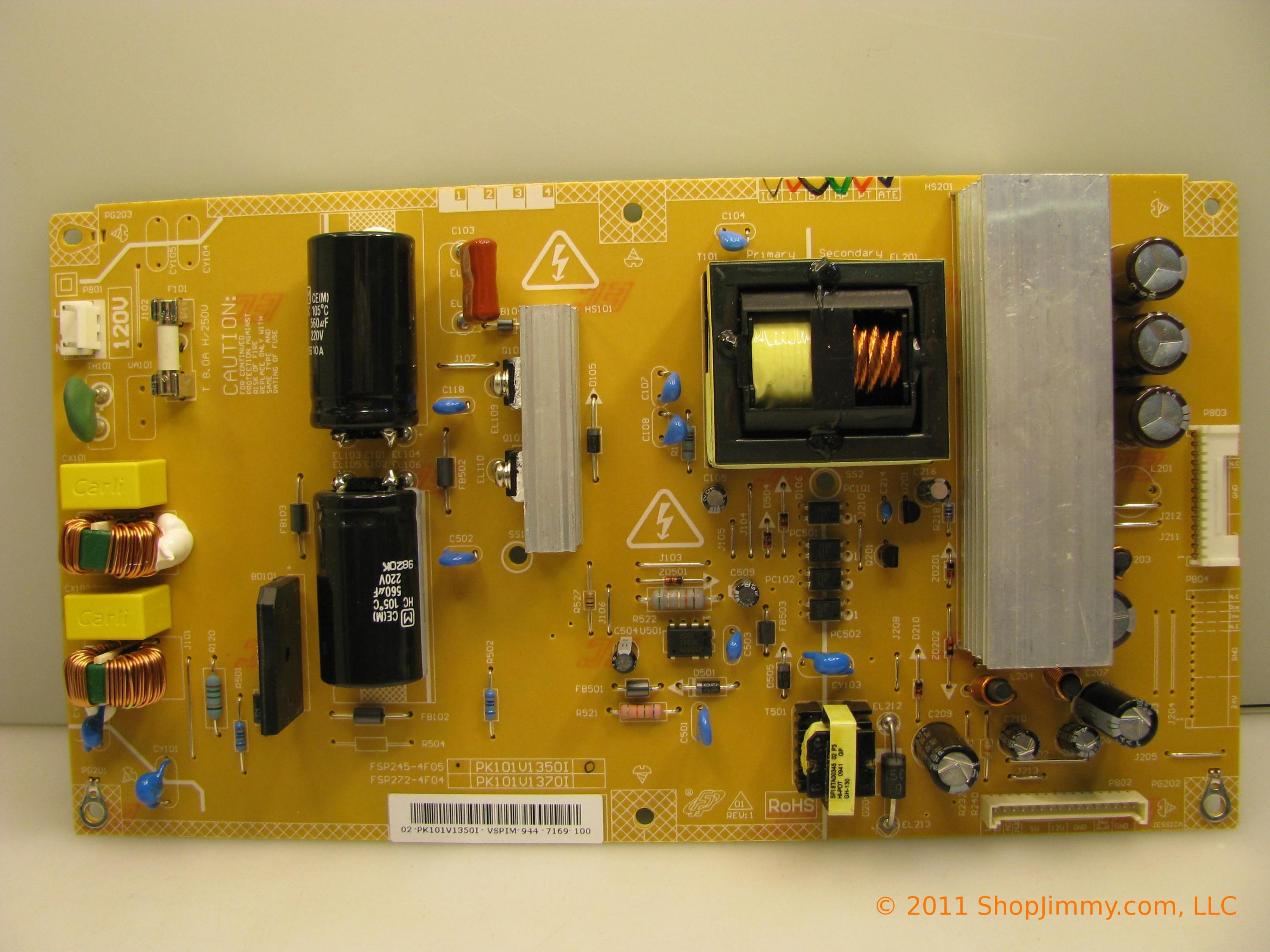

        I found a good pic of the board from shopjimmy.
        Can someone help point out the parts that would usually go out with a power strike? Also, next to the big caps, those solid black looking diodes, what are they called? How would one buy a replacement for one of these if there is no part #? I can't find a schematic for this board either.
        I figured there isn't too many parts on this board, shouldn't be too hard to find the cause, replace, repair.
          Re: Toshiba 40RV525RZ-No Power/Standby-Power Supply Help!
          'FBxxx" they are Ferrite Bead (small inductor), not diode.
          Good clear pictures of the bottom side of the boards? Instead of keep blowing the main fuse, you can use 75~100W lamp in place of the fuse, when the lamp stays bright without going dim, that will indicate the board still has shorted circuits.

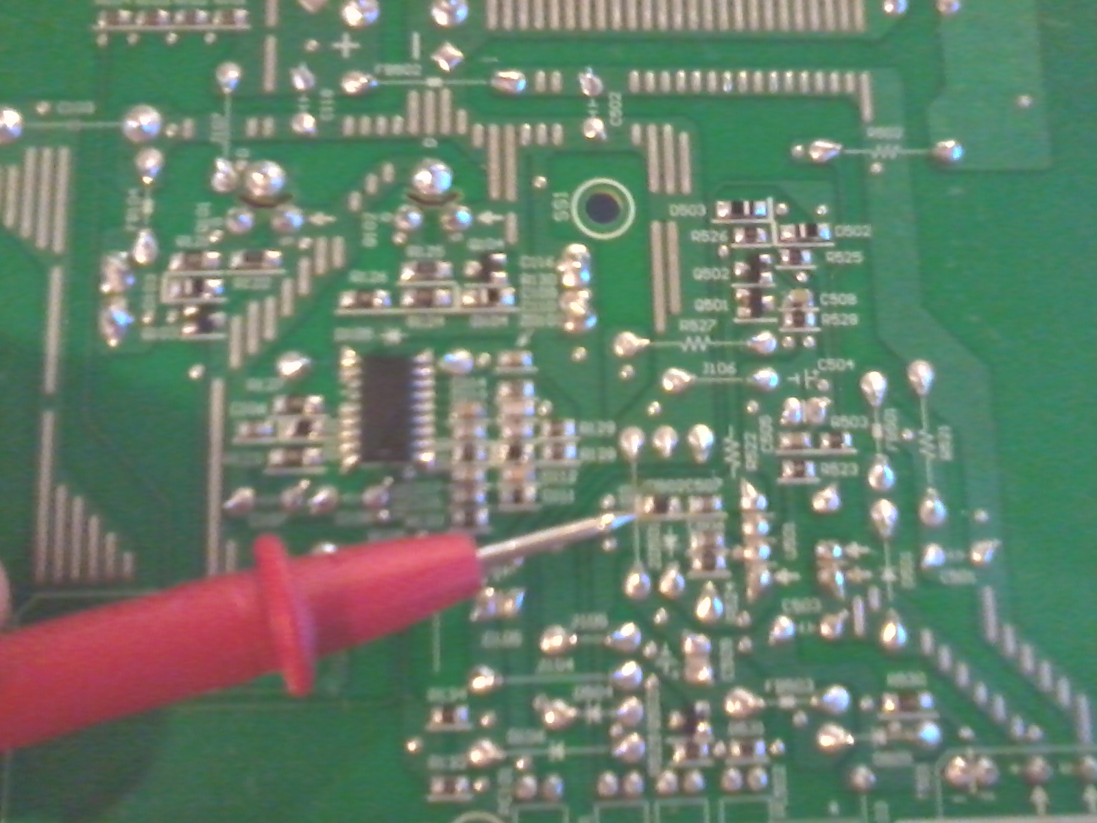

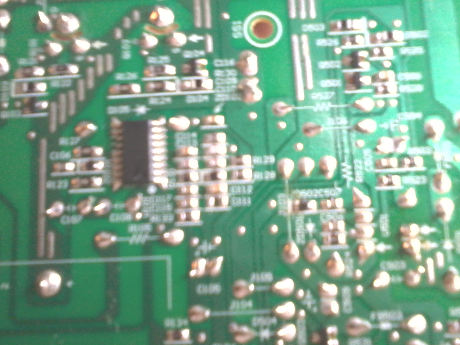

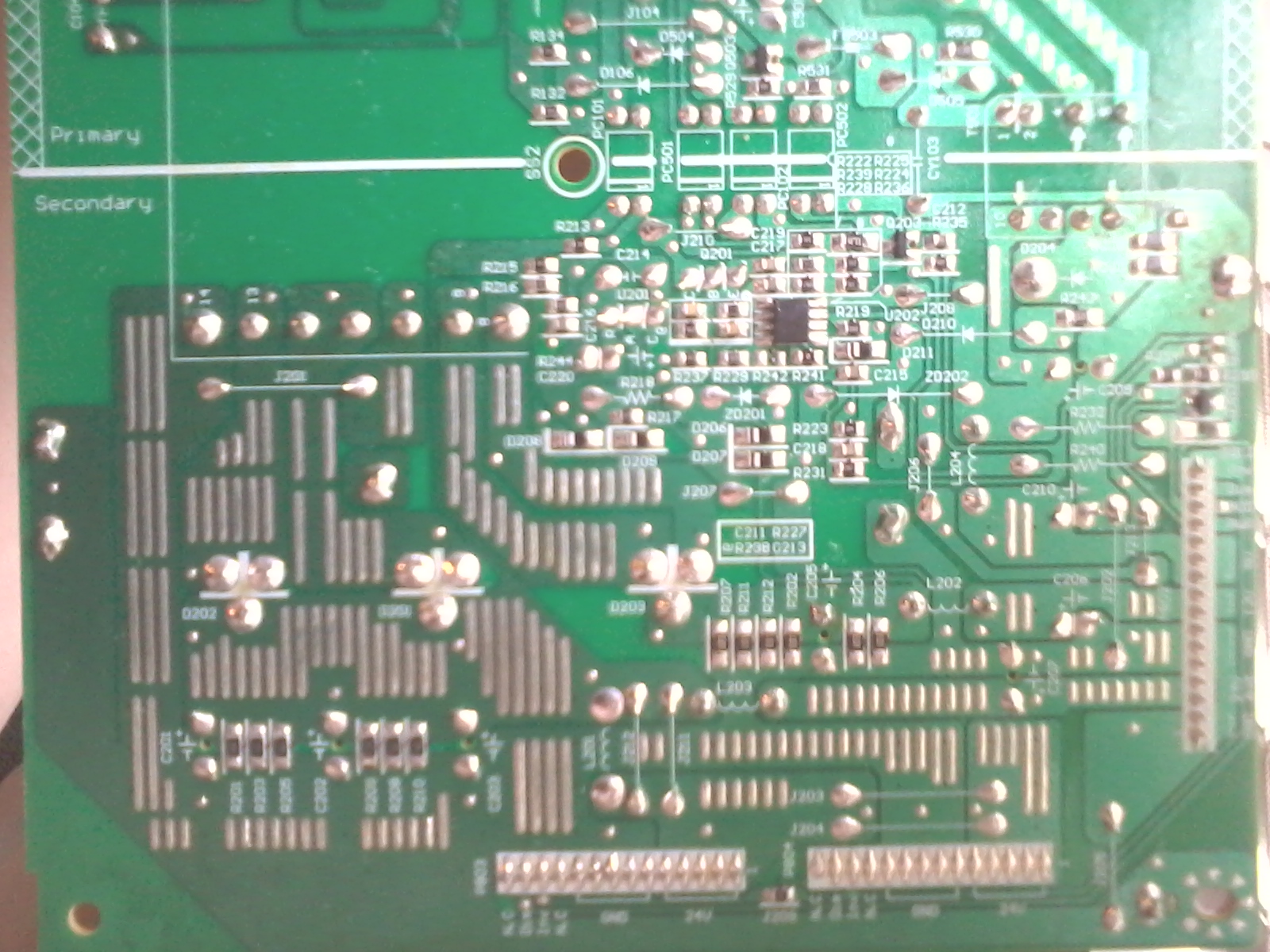

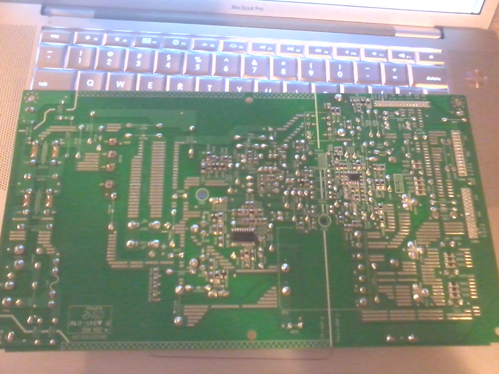

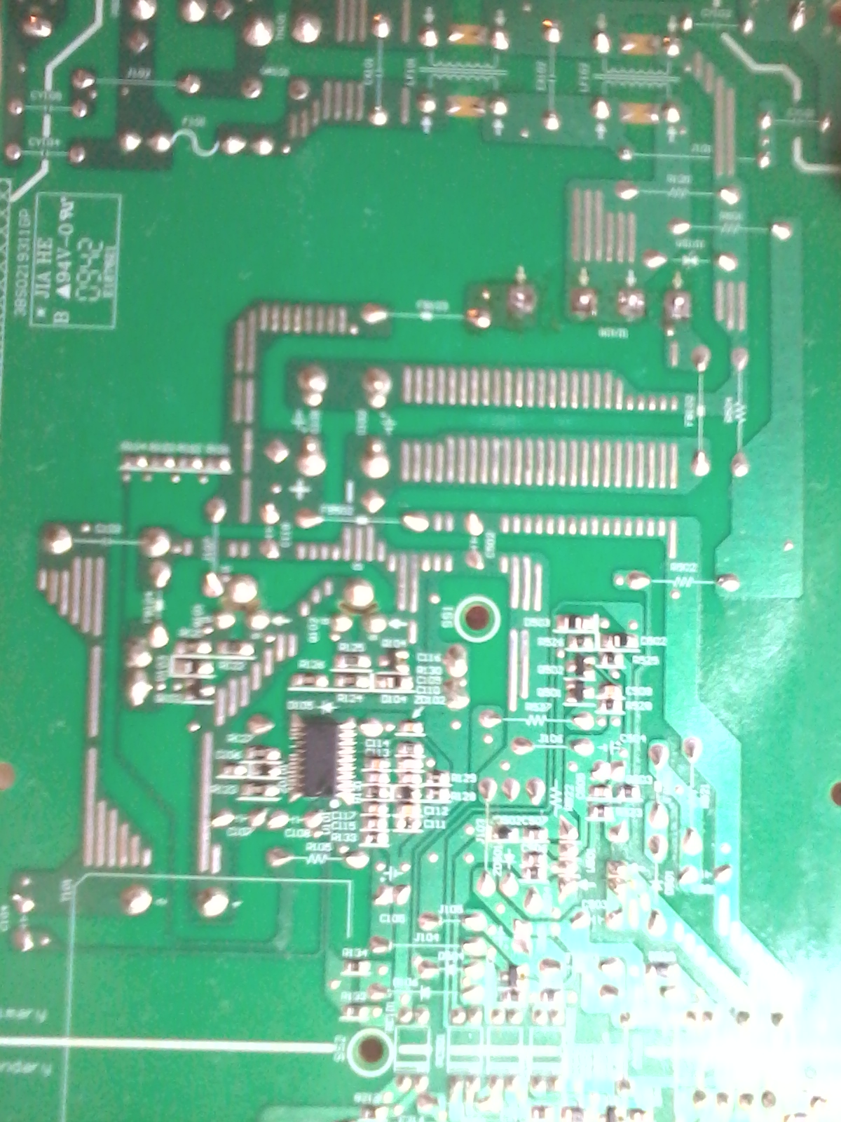

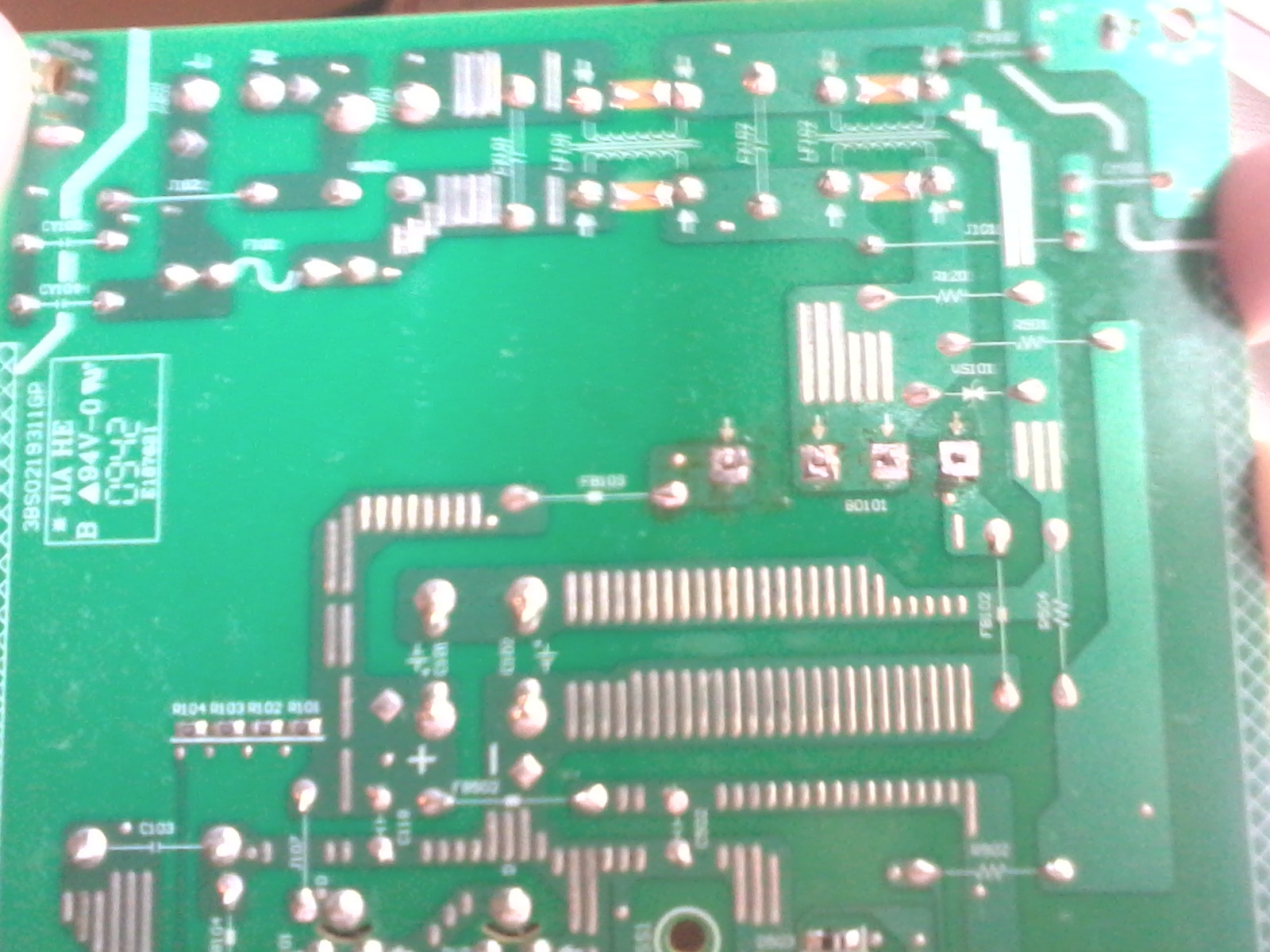

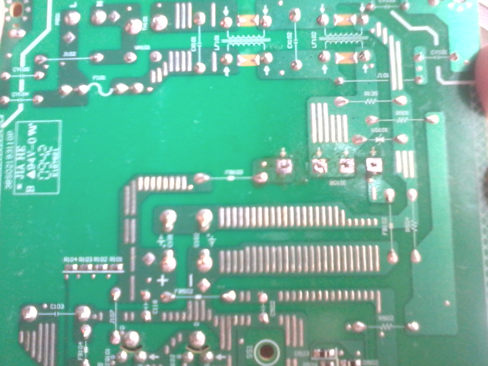

                  Not sure how well they will show up but took a few diff pics.
                    Pictures are out of focused for me to trace out those traces for me to draw up the diagram.

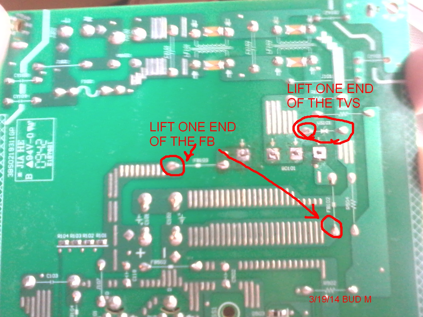

                      Damn. I don't have a digi camera Hmmm I'll figure something out. On that lamp test, just use a 100w reg light bulb and place it on the fuse holder?
                        'just use a 100w reg light bulb and place it on the fuse holder' Yes.

                          OK, list one end of the TVS first and see if the lamp will stay on full brightness, if it it does, the lift one end of those two FBxxx legs and see if the lamp will still stay on bright. you can run the board by itself, no need to connect it to other board.
