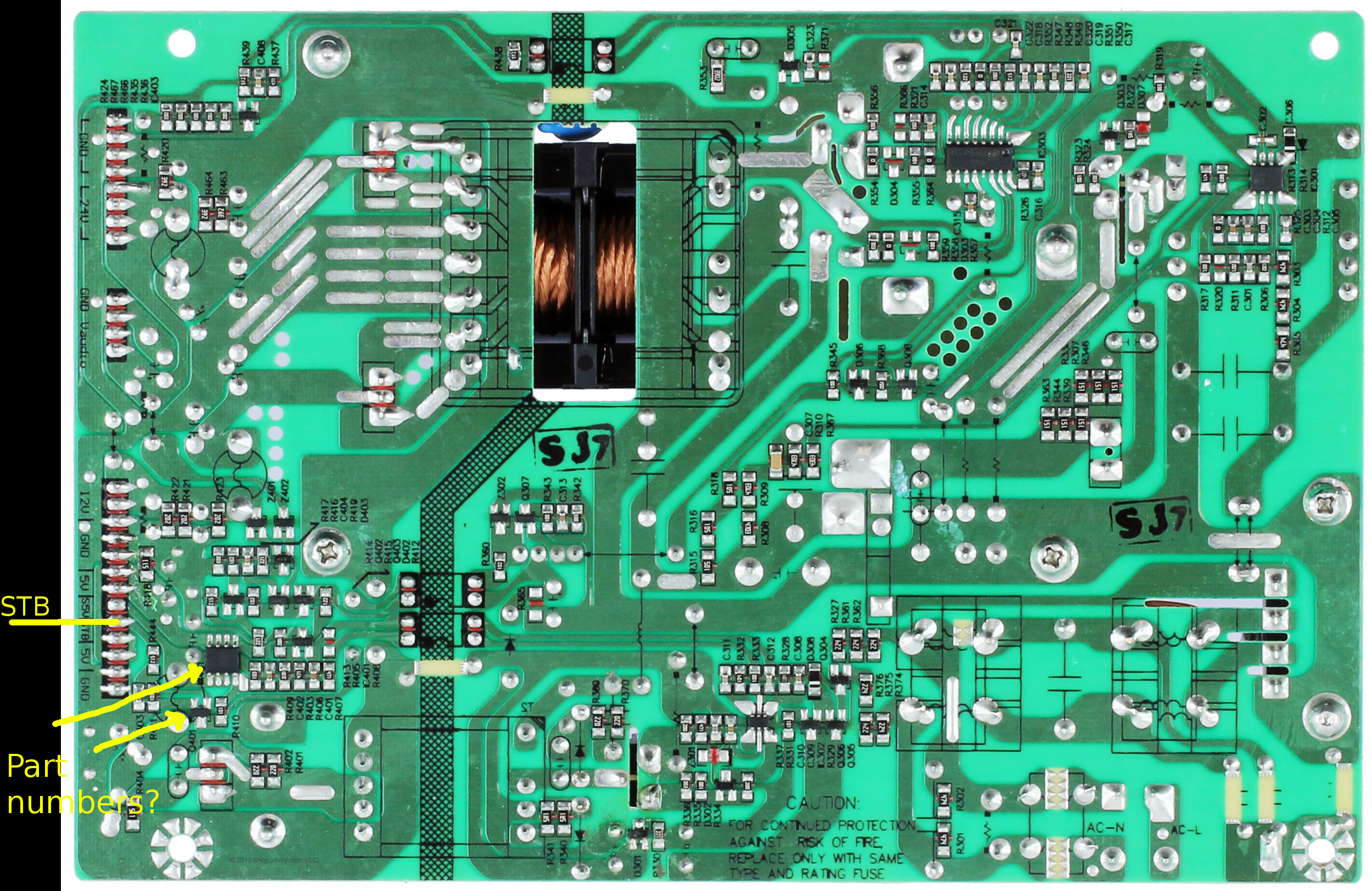

        #43
        Re: Westinghouse VR-4625 wont turn on
        The power board usually gets a signal from the main board to tell it to turn on (or rather, come out of standby)
        I'm guessing it would be pin 'STB' on the biggest white connector, and since it has 5v on it, it is probably supposed to be pulled low to turn the supply on since everything else looks like supply rails.
        To verify, can you post a better photo of the underside of the board around that connector?
        -David VanHorn
        • jesselyons2002
          • Jul 2013
          • 82
          • usa

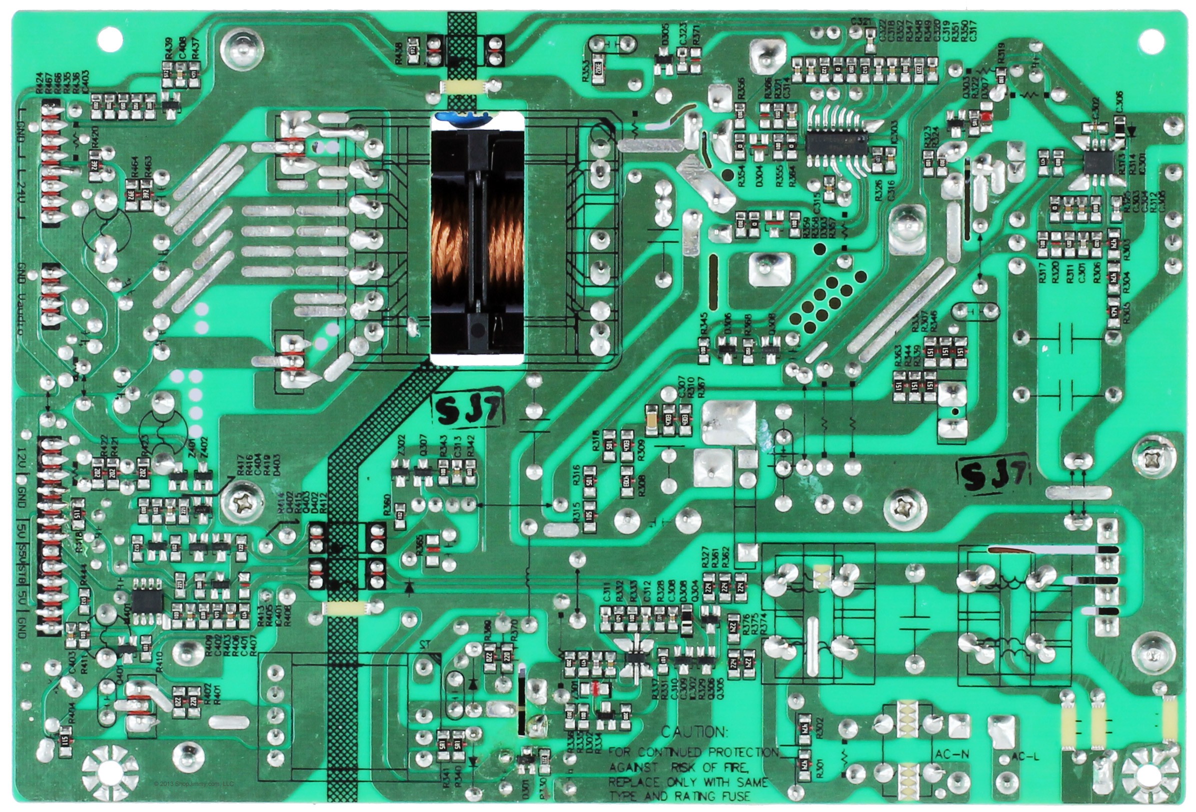

          #44
          Here a pic from shop jimmy
          • Agent24
            I see dead caps
            • Oct 2007
            • 5035
            • New Zealand
            #45
            I'll try to help how I can... See the attached picture for the STB pin that I'm talking about.
            Looks like you would probably ground STB which would draw current from Q401 (probably a PNP transistor) which looks like it controls the PC2 opto-isolator which sends a power-on signal through some other circuits to the main PWM controller.
            To confirm, try with the thing hooked up and see if that STB line goes LOW when you press power button. If not the logic board may be the problem.
            If you can give part numbers for the two components (Q401) and the IC next to it, that would be helpful in determining with more certainty how that pin works.
            Also the PWM controller IC303 part number might help with troubleshooting.
            -David VanHorn
