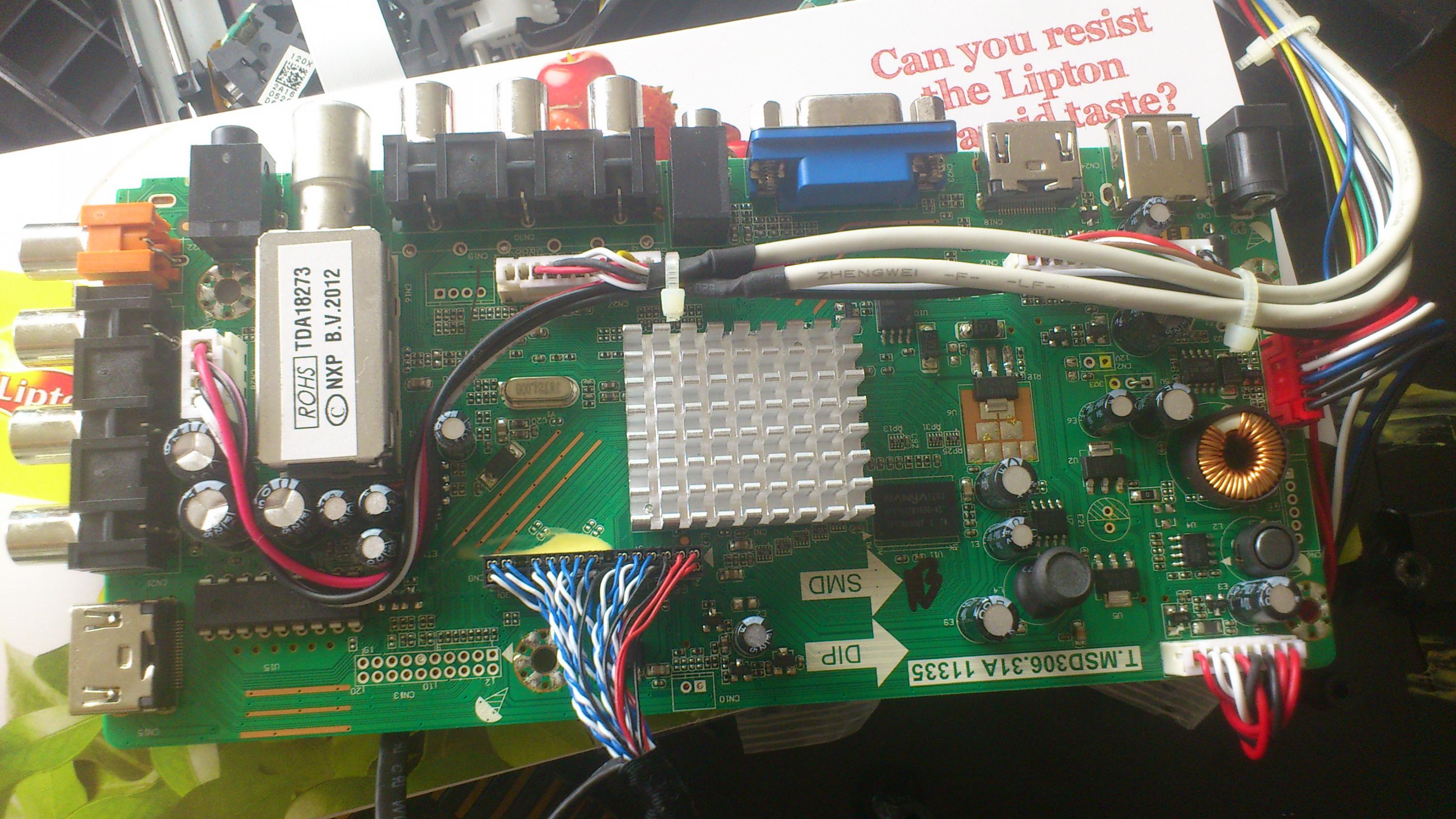

          Re: Hitachi LED TV le24ecd05au turns on sometimes
          Hi Tom66, Thanks for the reply. This is the mainboard I got http://1drv.ms/1hlZqDs
          Could you please point me out where are the voltage regulators and the dc dc converter?
          There is only one board on the TV.
          Thanks all for the support

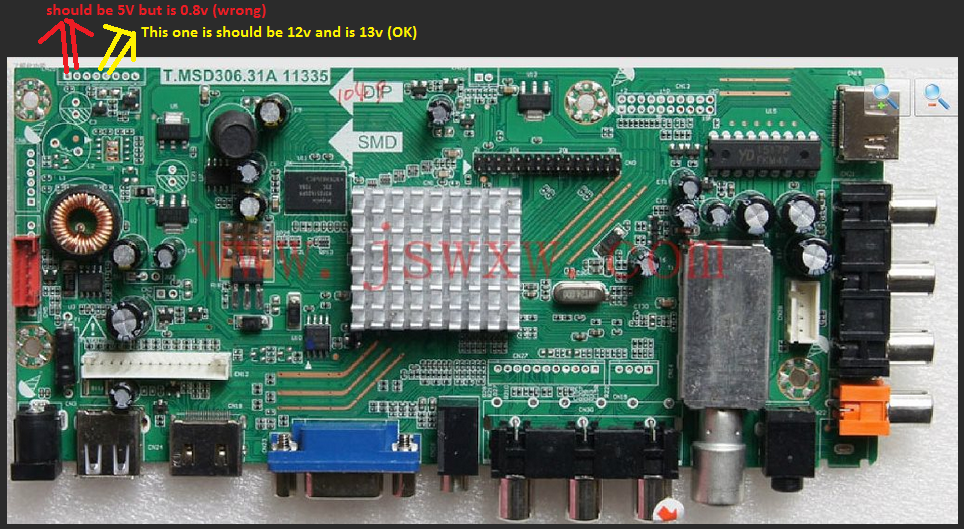

                      One thing I found is that when the does not turn on, the mainboard is sending 0.8 volts instead of 5v to the DVD board (this is a tv with integrated dvd combo).
                      but the 12v pint is OK, only the 5v pins are not getting the 5v.
                      Please see the attached image.
                      What could be the issue here to get less power? that is weird because sometimes it starts fine (very very few times). Also the power led is on and is a 5v led.
                      Thanks for the help !
                      Note: All the capacitors on the mainboard are EFC brand, they looks ok but I am not sure if that could be the reason.
                        Are you using a digital multimeter to check those regulators?
                          Hi Tom, Yes I am using a digital multimeter. There are 3 regulators 1117B 3,3 542B (I cannot find the datasheet) and one regulator (i think is variable) 1117B AD 931m.
                          I do not understand why I am getting 5v in some places (the power led for example) but in others just 0.8v.
                          It is weird because 0.8v is the same value as one of the pins of the variable regulator.
                          I have no idea what to do next, just trying different things and external power supplies
                          Thanks for your help!

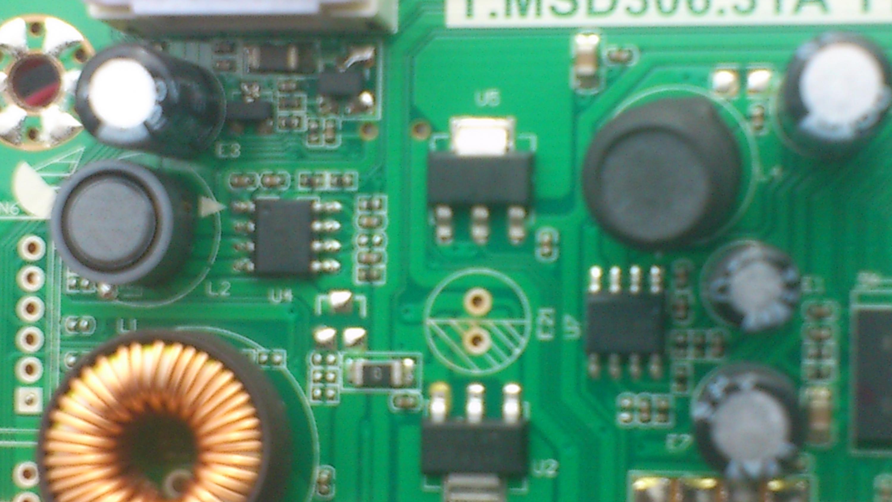

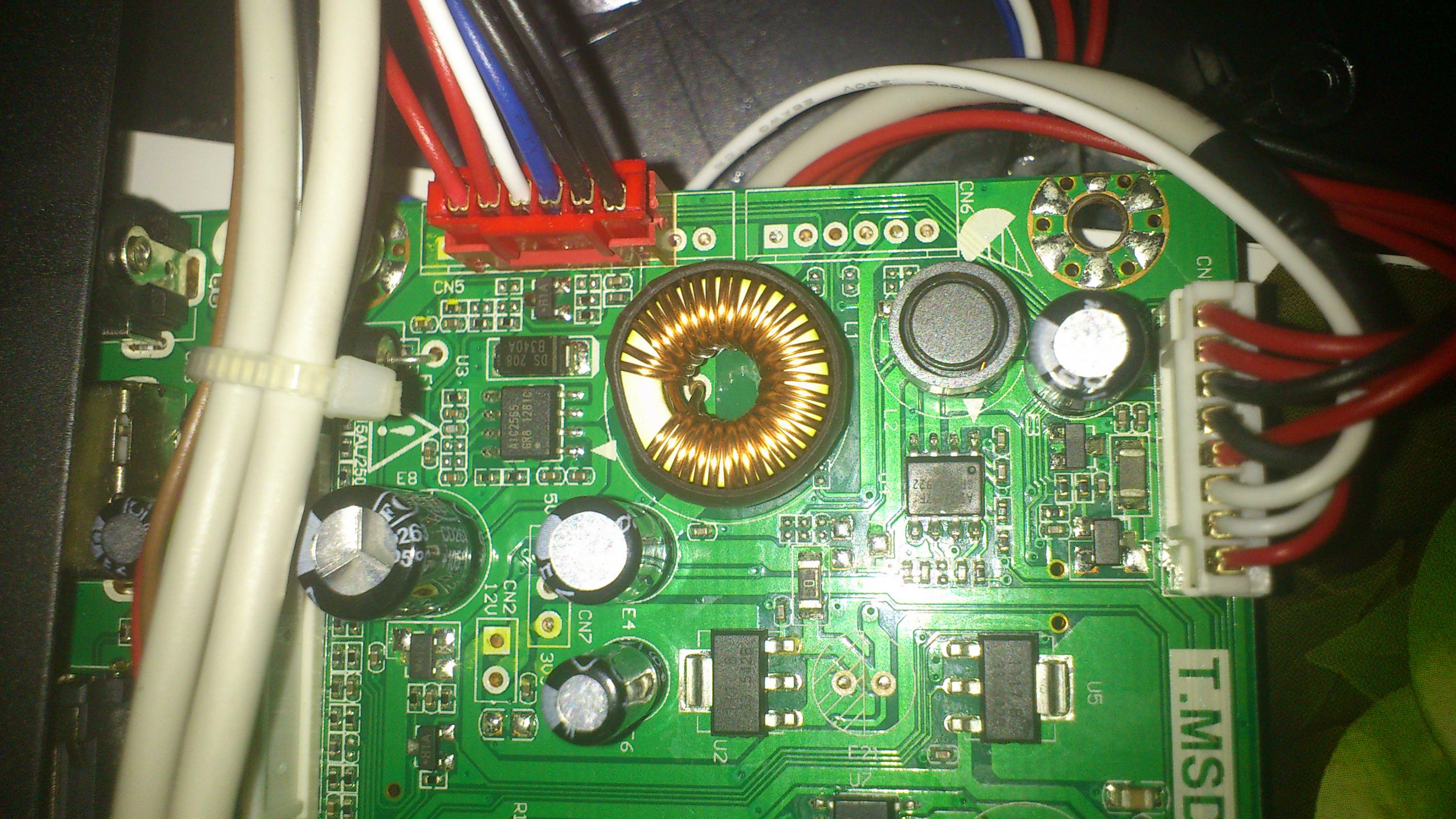

                                  Hi Tom, here are some pictures, let me know if you need more.
                                  Thanks !
                                    OK, chip AIC2565 (looks like U3)
                                    Check all pin voltages when unit is working, when it does not work and when in normal standby mode, need three sets of readings. All readings: red probe on pin, black probe on ground, DC 20V range.
                                    pin 1 - BOOST, expect about Vin (12V) plus around 5 to 10V so ~17V to ~22V when working (use DC200V for this if your meter goes out of range)
                                    pin 2 - VIN, expect about 12V (or adapter input voltage)
                                    pin 3 - SW, expect about 5V out when working
                                    pin 4 - GND, 0V
                                    pin 5 - FB, expect around 1.22V when working
                                    pin 6 - COMP, expect around 1.22V when working (though may be different - not certain)
                                    pin 7 - EN, need to see, may be active high or low (ENABLE: this controls the chip being on or off) - hopefully same between ON and FAULTY
                                    pin 8 - SS, the delay for controller start up, should be more than about 1V (SOFT START)
                                    The pin 7 and pin 8 are most important - if pin 7 is different then the CPU is not turning the supply on or off, so the repair might be quite complex, need to test other things. On the other hand pin 8 capacitor is a frequent failure point and explains the low output voltage (0.8V) I'd normally expect 0V if it were a problem with CPU and enable pin.

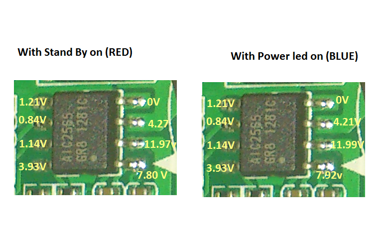

                                      Hi Tom, These are the measures I did on the chip on stand by and with the power led on. but I could not measure it with the TV working. I tried many times and it does not turn on, I will keep trying and will upload the values when the tv works.
                                      One more thing I noticed is when I measure the pint 7, it will restart the power led, if the power led is blue and I measure pin 7, the led will switch off and will turn to red (stand by).
                                      Thanks !
                                        Looks like we need to look elsewhere.
                                        My error on boost, it should be Vout+Vgs so 7.5V seems OK, guess it uses low Vgs FET or NPN.
                                        Do you see that jumper block with 5V/3.3V printed on it... what do you measure on the pins connected to 5V? Note:- be careful not to short it.
