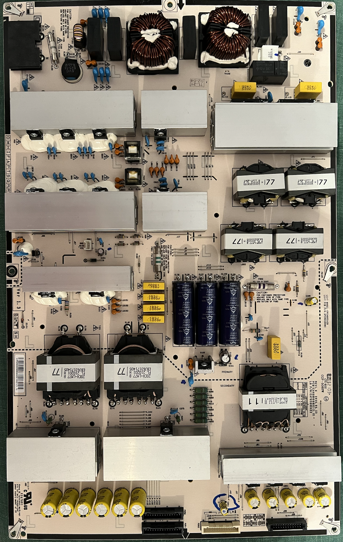

    Hi mates,
    I've an issue with the standby function of the LG OLED77C19LA from a colleague.
    Device
    Model: LG OLED77C19LA

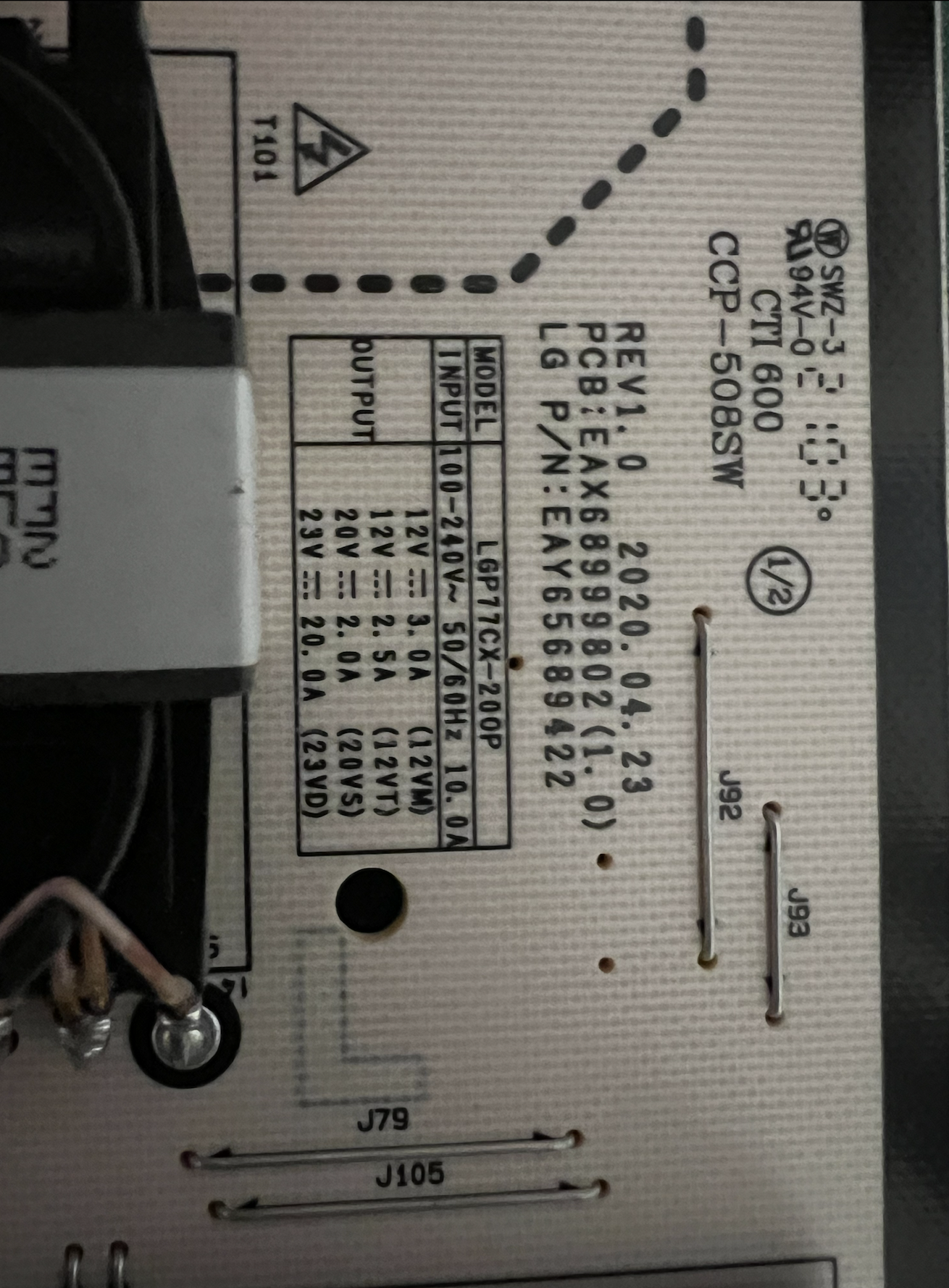

    PSU
    PCB: EAX68999802
    LG P/N: EAY65689422
    He described the problem to me as follows: The device can be switched on normally and does not cause any problems.
    As soon as you switch it to standby, it stays on for about 3 minutes and then switches off. It can then no longer be switched on.
    If you then disconnect the power using the plug or a power switch, the TV switches on normally.
    Could this be a defective electrolytic capacitor from the fault pattern?
    As I have read in some places on the net that it is often related to the PSU PCB, I have now received this from him and have it here.
    The power supply is huge and I have hardly any experience with it... but now I want to use it to learn a few things.
    I hope you can help me to find the error and eliminate it. How to proceed etc., that would be great
    Best
    Sebastian

    there are no fault unless if he or any other do before work repair on PSU... its pixel refresh timing., send IN_STOP command via service Rc or APK or DIY wave files could bring the timing Bach as it should... in case the first point i mentioned not account.

                  Put board back in, leave it off stand turn TV on. Use multimeter on the main caps. Hit power, check the readings, see if voltage starts dropping. Or on the 12v/24 line (I can't read the picture) that connects to the main board. See where the voltage is when you turn the TV in die the first time and where it drops to when the TV light dies. Measure before TV on first time, while on, and once off for that 3 minutes. It should always be a constant voltage . That's what I would check. Beyond that if it ALL stays constant I would assume it's probably fine. Would also do as diah said but I would try this since you got 5 minutes

                      I see no problems (never seen this board anyway) in testing the PSB in standby and full ON modes, simply provide the turn on commands (are you able?) and see if the defects are present, for my experience i see no way how it can be the PSB, is trust more a MB defect, maybe bad standby processor if present separately, the sad part i never seen one that shared info or files about those chips.. bye..

                          The standby voltage is normally not present only in st.by state, but always, this rail can be tested easily with a resistor, load it with 0,5A around (5v/0,5A=10ohm/5w), if the voltage remains, the resistor heats, then ok, but i know it's not power supply problem, it is one of these: bad standby software, bad BGA balls on cpu or ram..

                                1) i mean isolate the power supply and load only the standby 5v
                                2) The main processor could have an integrated standby MPU, with separate contact balls, their contact balls could be bad, if the standby mpu is external, it could be the cause, i need EAX code of the main board.. for the RAM discourse, it could be possibile that the standby software, to be more fast, could be copied in a certain area of the RAM, especially if there is no SPI flash, there could be a bad RAM or its balls for that..
                                The economical aspect of doing a reball of such an amount of chips is out of my knowledge, especially if based on my examination, i'm still a passionate hobbist.. even if with years of readings..
