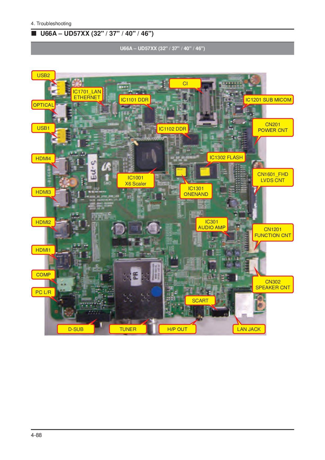

          • Diah
            • Feb 2013
            • 6550
            use freeze sorry on Flash IC1302 until it come on... keep spray until u reset it from service mneu

                            • Diah
                              • Feb 2013
                              • 6550
                              Originally posted by VaporGame
                              I don't have compressed air or anything that will cool it like that on hand, I'll try some frozen veggies though.
                              then sitting and pray it work from alone LOL
                              • VaporGame
                                • Aug 2024
                                • 30
                                • Poland
                                I have sat like that freezing the chip and my fingers off for a good 5 minutes but it didn't help.
                                • Diah
                                  • Feb 2013
                                  • 6550
                                  Originally posted by lotas
                                  No, you entered “MICOM UPGRATE” and clicked “Ok” and thereby deleted the firmware in micom and turned the TV into a brick, now only flashing the Weltrend WT61P805 microcontroller will save your TV.
                                  Samsung never use MICOM patent... just for correction.
                                  • Diah
                                    • Feb 2013
                                    • 6550
                                    you asked for help and i gave you the answer,,, this issue cause also boot loop
