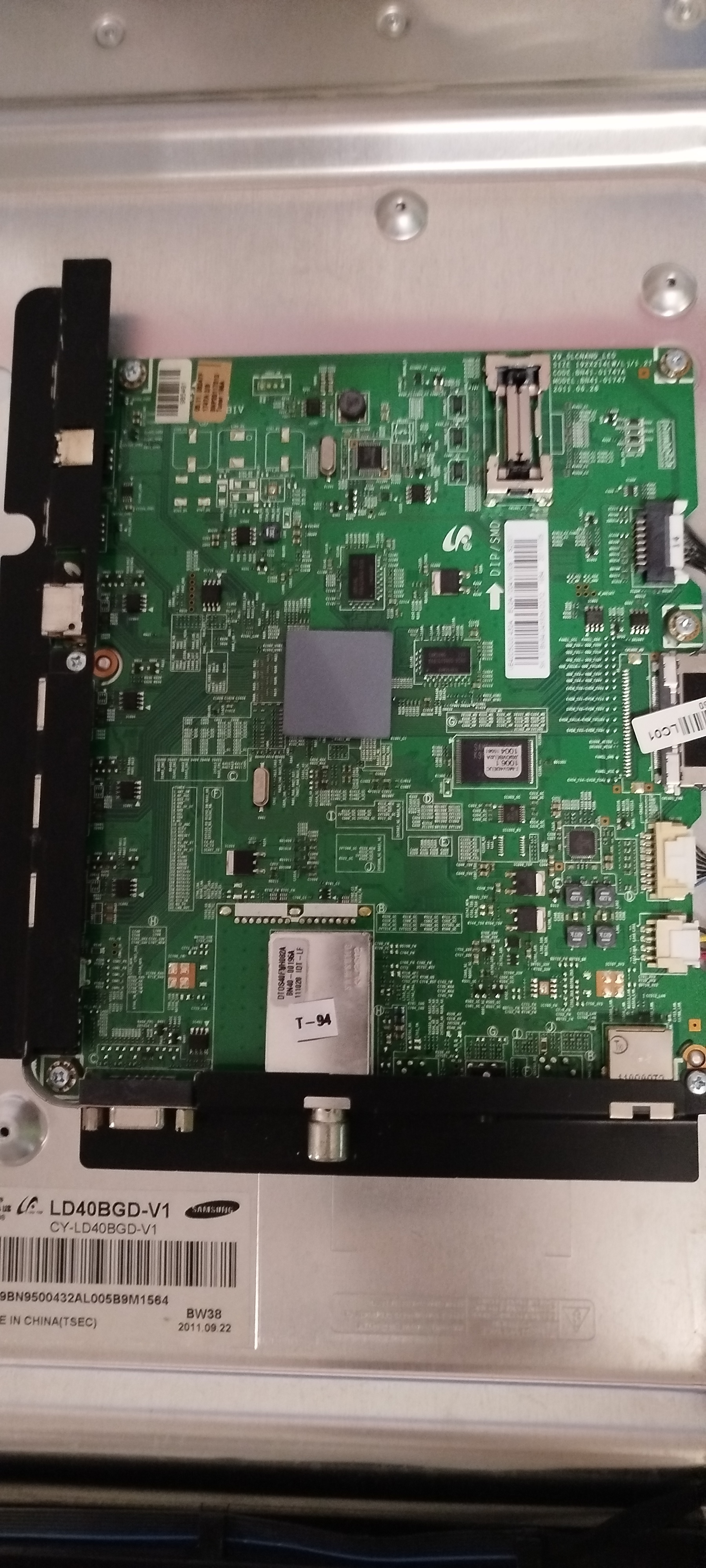

      Originally posted by VaporGame
      Sorry it took me so long.
      Yes, I believed that everything worked out and had no doubts.
      • Diah
        • Feb 2013
        • 6613
        #63
        Originally posted by lotas
        So it turned out the way I described from the very beginning, what happened (MICOM UPDATE) and how to get the TV out of the brick state...
        again... MICOM are LG patent Samsung had nothing to do or used... you have flashed FLASH.. not MICOM
        OP good work.thx for working photo
                      Again, you can’t prove anything! What other FLASH? This is flash according to you, then search for the datasheet on Google and find out what it is!
                      mark yours MICOM pn this diagram and on OP photo
                      one things more its impolite to write my name or any other user name at yours impolite answer,,, lean western respect please.
                        Here...
                        • lotas
                          • Jan 2016
                          • 4905
                          • Russia
                          #72
                          And on this one here...
                              so he did flash SanyGo on the set.... LOL--- any way good job for all... OP CI now can replaced with OSCAM binary can all scramble / paid channel clear displaying via CS
                              this is black hole at Samsung D serial... but good it worked it seem this set never upgraded
