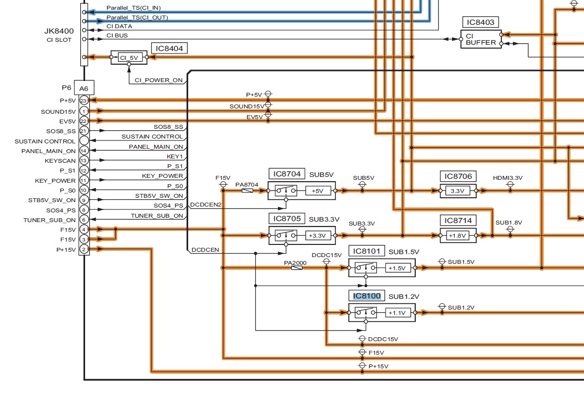

    Looking at this more closely... Vsus, Vda, +15Vc/+15Vs aren't powering up. These all get their signal to start from U207, the PSU micom. This in turn is given the signal to start from the A board CPU via Panel_Main_ON, which is not going high when the set is switched on. STB5V and F15V are both good, so I'm starting to think this isn't a PSU issue.
    Next checks will be on the A Board for IC8704 - SUB5V, IC8705 - SUB3.3V, IC8101 - SUB1.5V and IC8100 - SUB1.2V. I don't think the main CPU will give the Panel_Main_ON signal unless all 4 of these are present and correct.
    Fuses on the A Board, PA8704 and PA2000 are candidates for investigation too.

      Hit a wall with this now...
      SUB5V, 3.3V, 1.8V, 1.5V and 1.2V are all present on the A-Board, so all the regulators on there are good. Panel_Main_On is not on, which isn't good.
      On the PSS board, STBY5V and F15V are up and the Power Micom U207 has +5V.
      The only anomaly is STB5V_SW_ON to the A-Board is at 0V, just like +15Vc_ON and Vsus Vda, which all originate from U207.
      I assume Panel_Main_On from the main CPU won't go high unless it sees STB5V_SW_ON from the PSU micom?
      From all this it looks like the PSU Micom has failed, which is an obscure device with on board eeprom, so will be a custom Panasonic one.
      Anyone???
